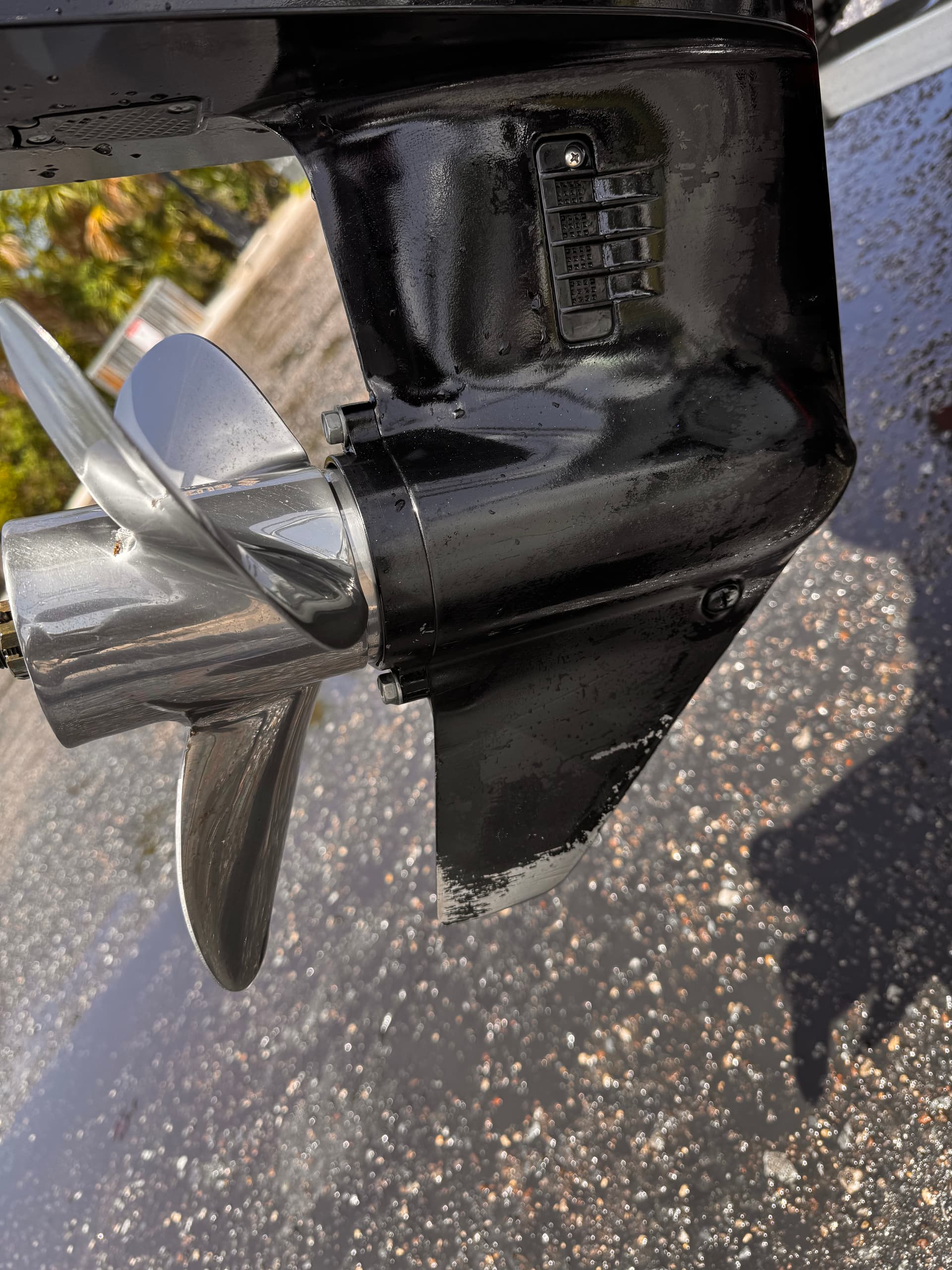

If you are curious about running draft, I have it sorted :joy:
Any mods/changes etc to dialing in the prop??
I’m still working on it. I’m running the Suzuki 3 11.75x17p
It’s a great prop and is probably perfect with a jack plate. I don’t have a jack plate. I’m fooling with the mount height to get it dialed in.
It’s really fast but the hole shot is suffering and my rpm’s are low.
I’m betting the 16p is the all around champ.
I’m still breaking in…but we should start a thread on props and set up for the 17 Evo. I know Jeff dialed in a bunch too.
