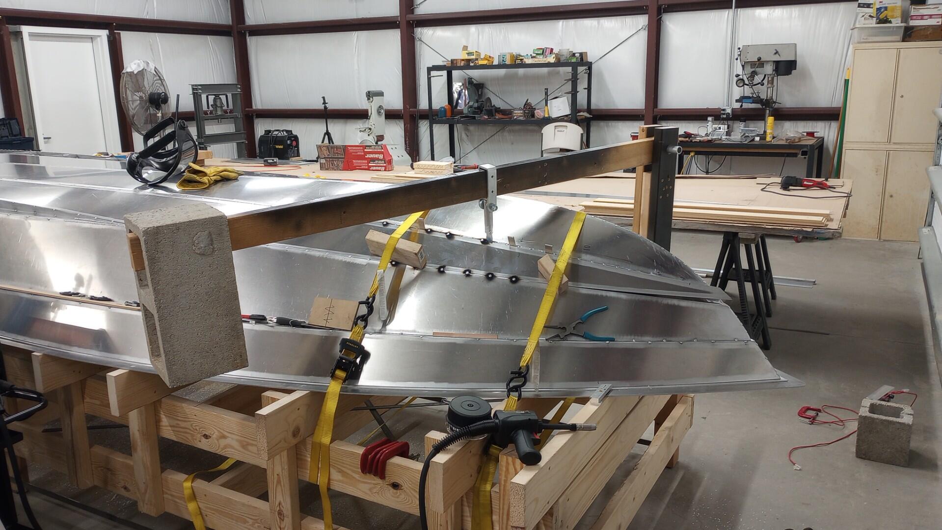

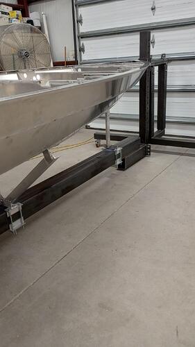

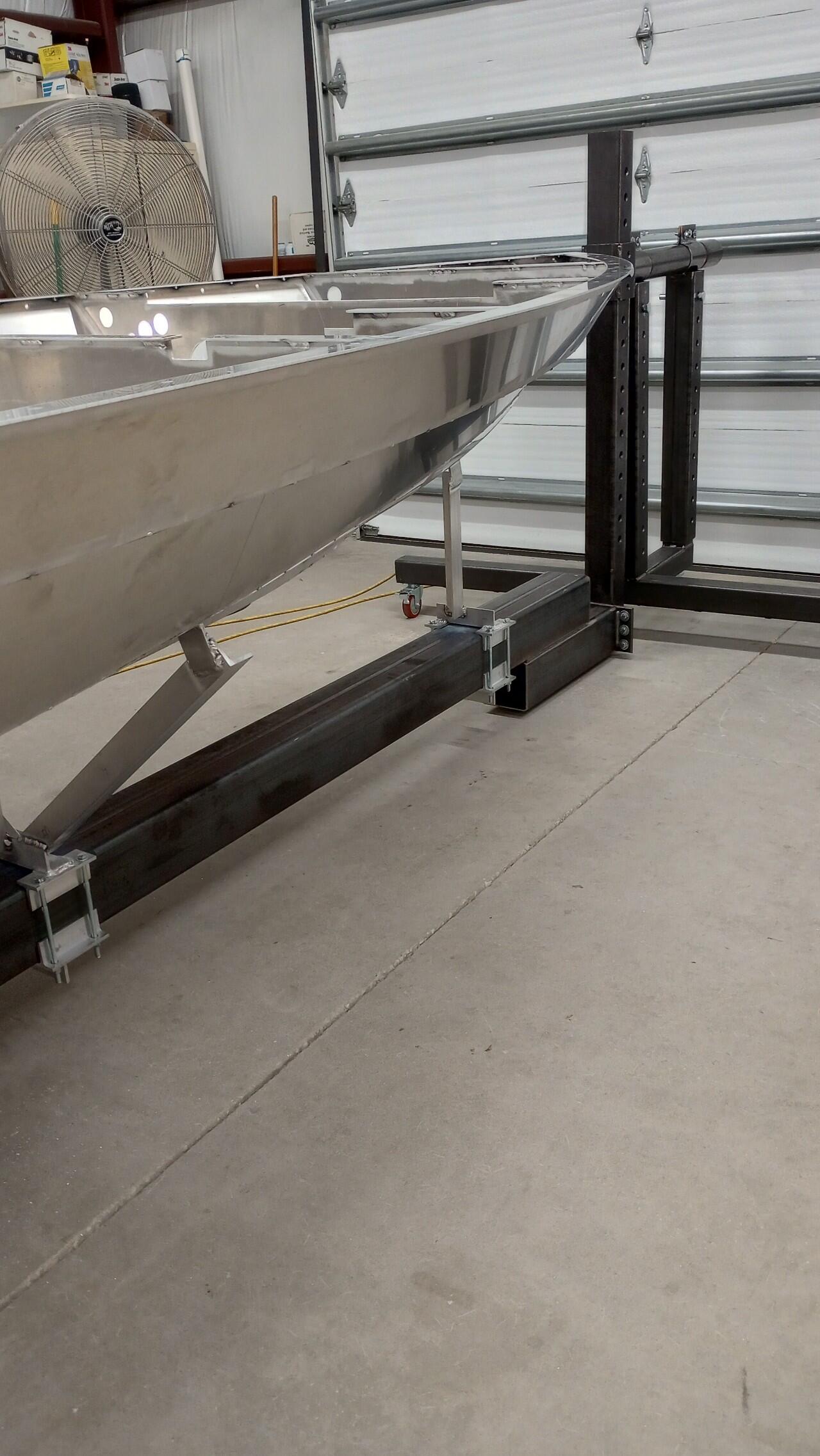

I appreciate the kind words, guys. As Mac hinted, the hull is counterbalanced by the beam. The location of the beam/hull assembly is adjusted to align the center of gravity with the center of rotation. On paper, I can get within a quarter inch of perfect.
Once it is “close enough” the assembly will stay put. When I first turn the hull on its side you can see me step away, no holding.
There are no bearings, just pipe on pipe at the ends. I can clamp the ends down to increase the holding force as desired.
I certainly held my breath the first time I rolled it!

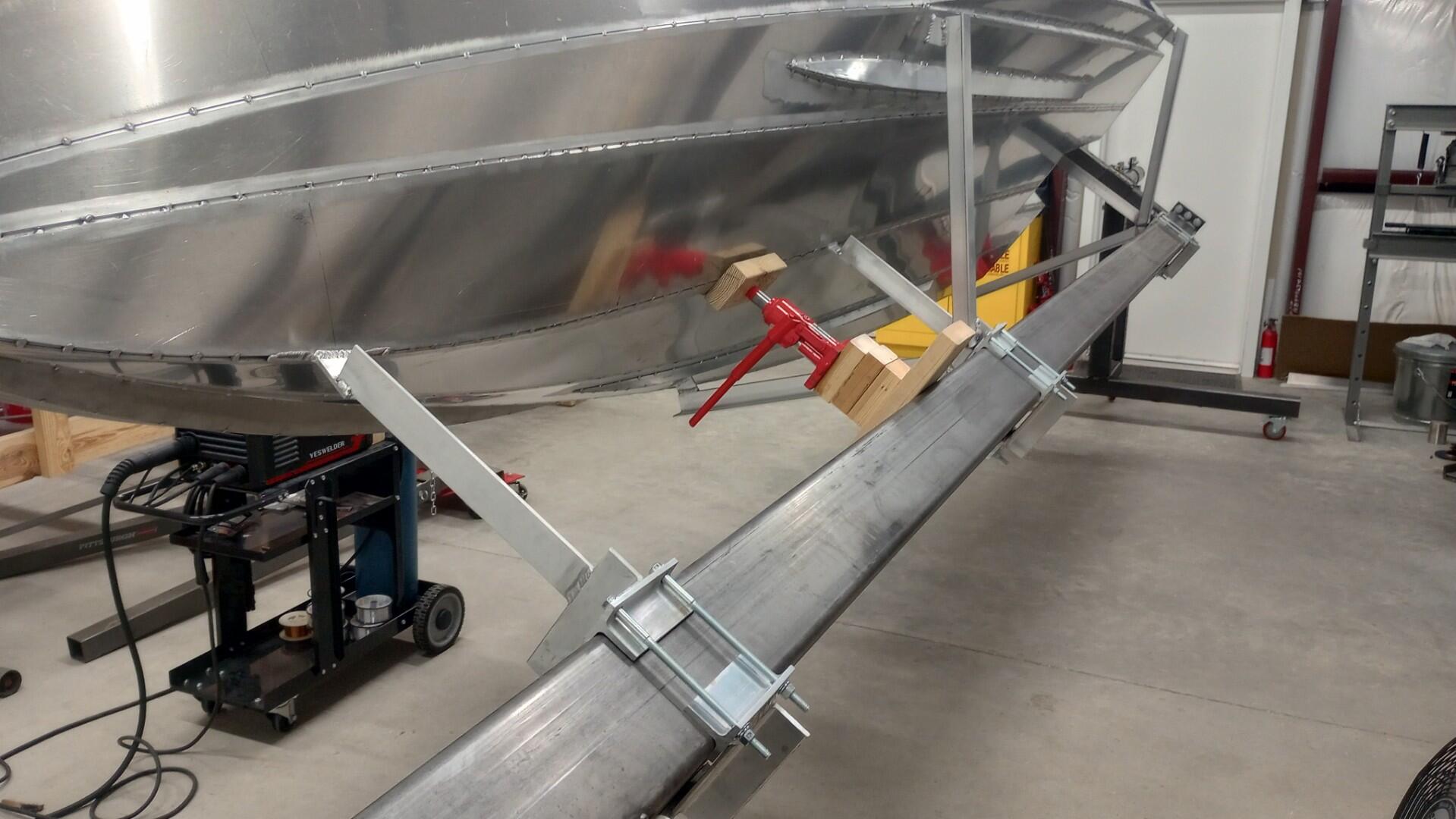

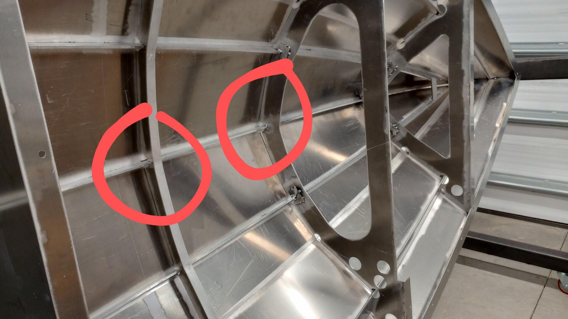

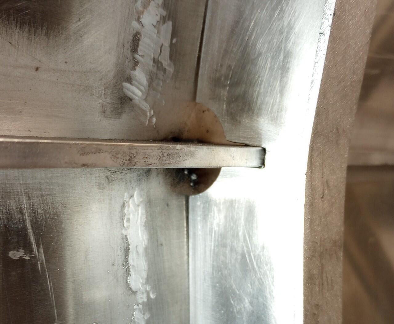

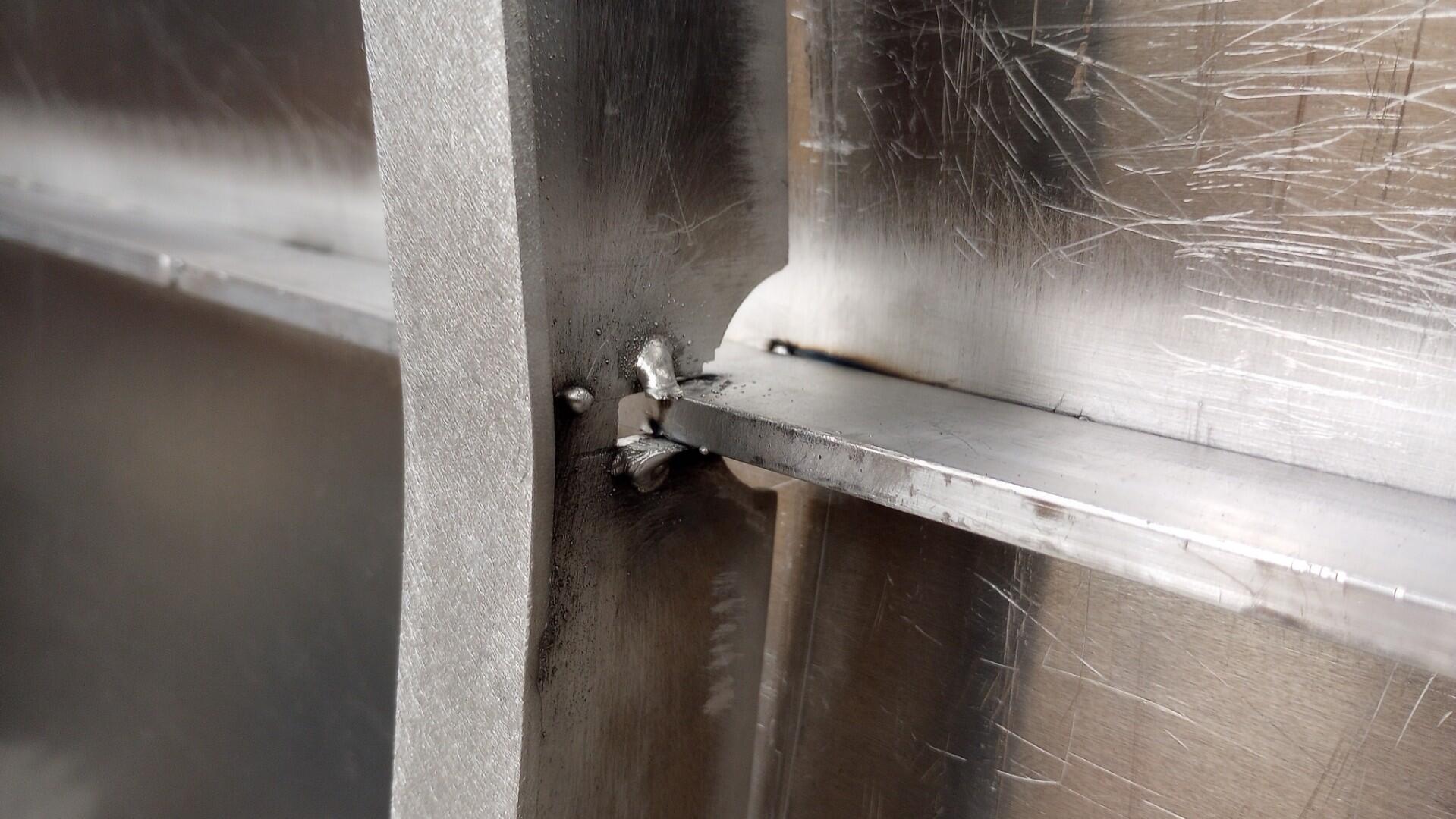

A couple of my vertical keel bar tacks failed at some point, allowing the hull panels to lift off the transverse frames. The fix involved a dog and wedge that let me push down on the transverse frames to pry the panels upwards. Supplemented that with some pressure from a hydraulic jack underneath, then tacked the keel bar back where it belongs.
I imagine some of those panels have some serious trapped forces. Good save!
