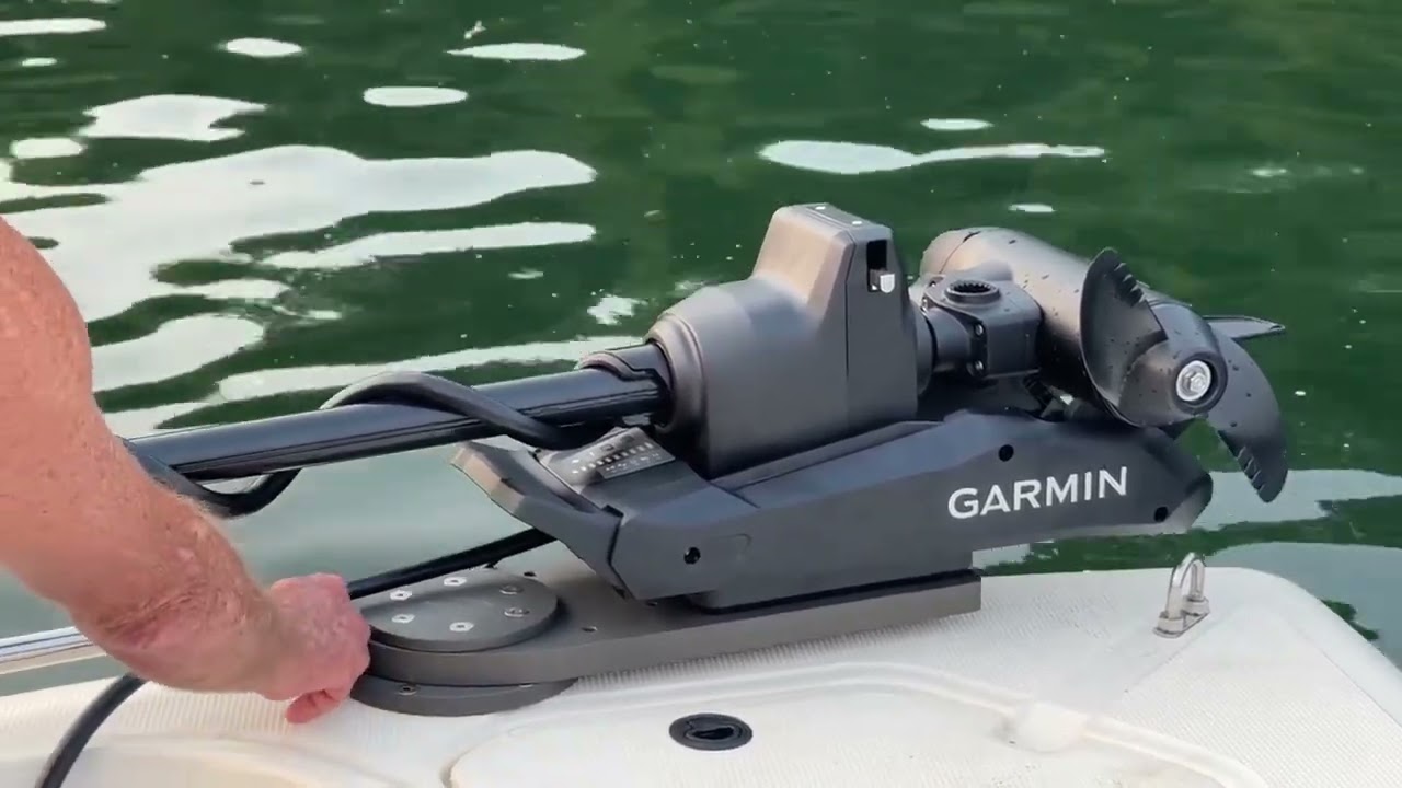

Found two so far, Seaswivel and Shuttleslide rotating mount. Pricing $1K and $750 respectively.
Anyone have any experience with these units? Any other that you’re aware of?

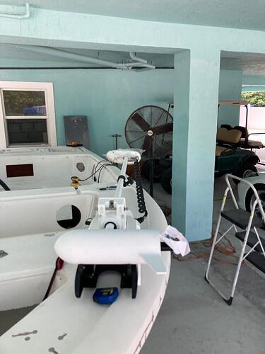

Before we start, motor is too long, but waiting to cut down for now.

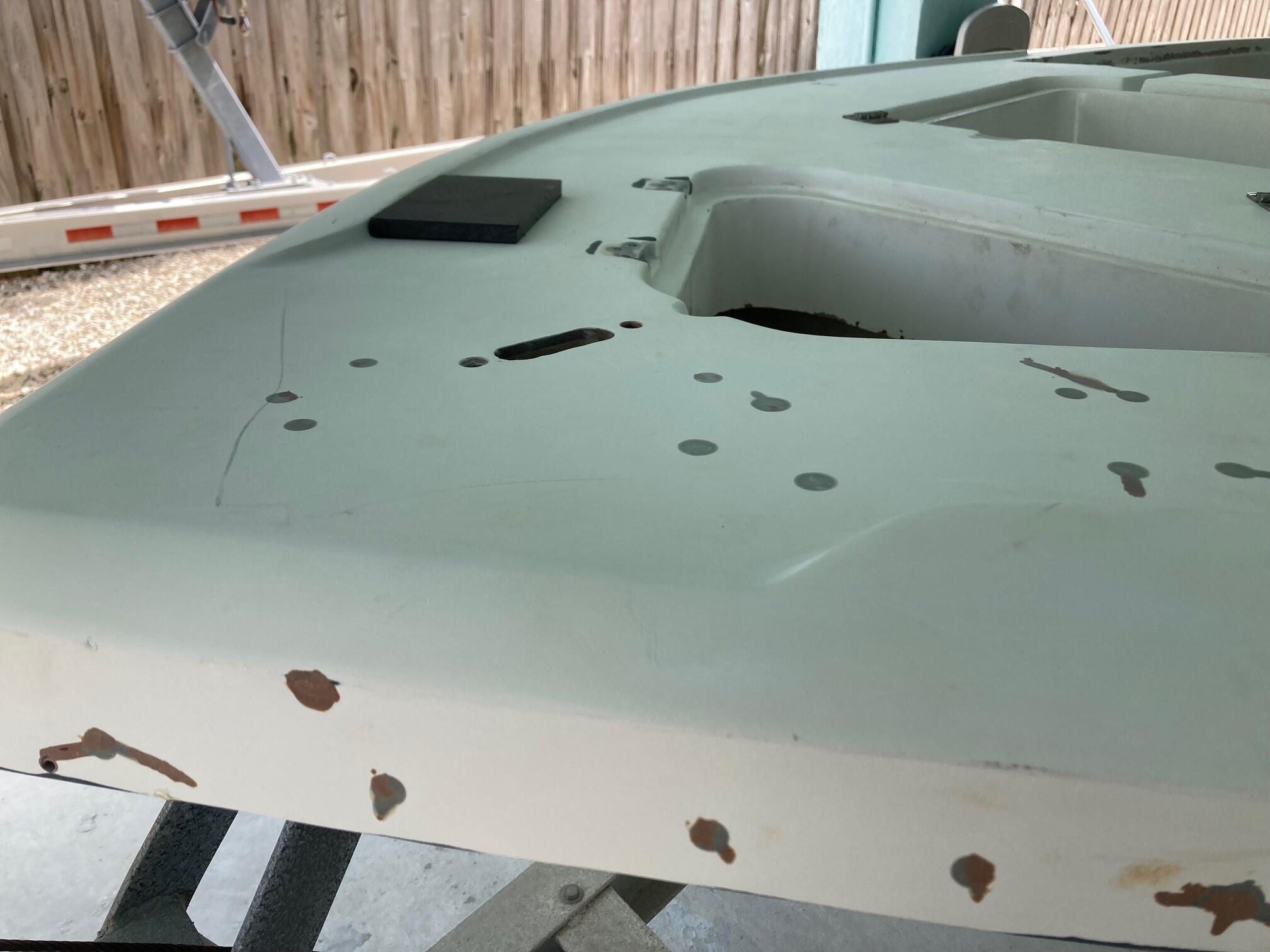

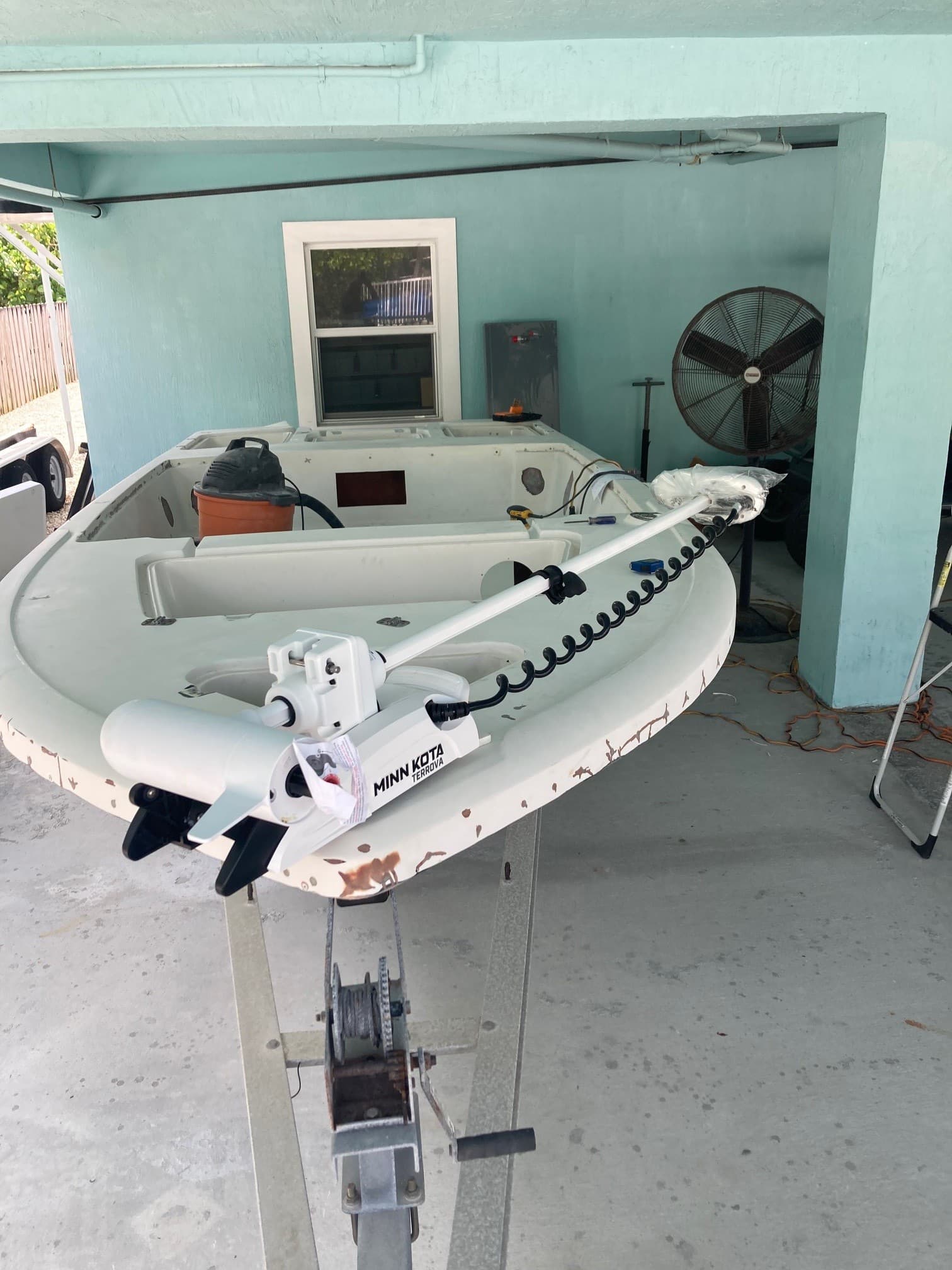

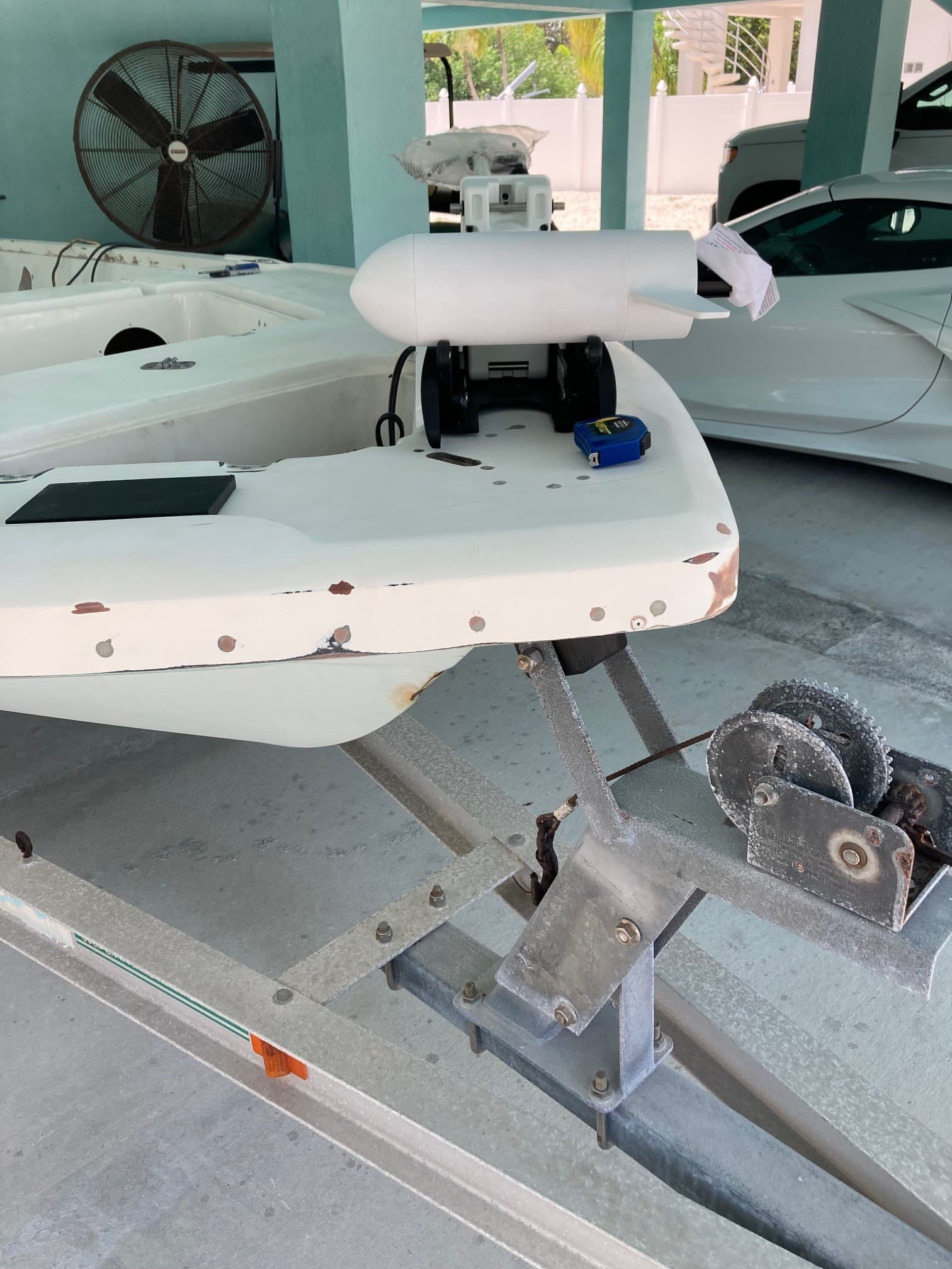

OK, here’s the front deck. The holes I filled I assume were from an old trolling motor, it was long gone when I bought this. You also see anchor locker, and toe rails (note 1/2” black starboard). Elongated hole is recessed cleat which I’d like to keep.

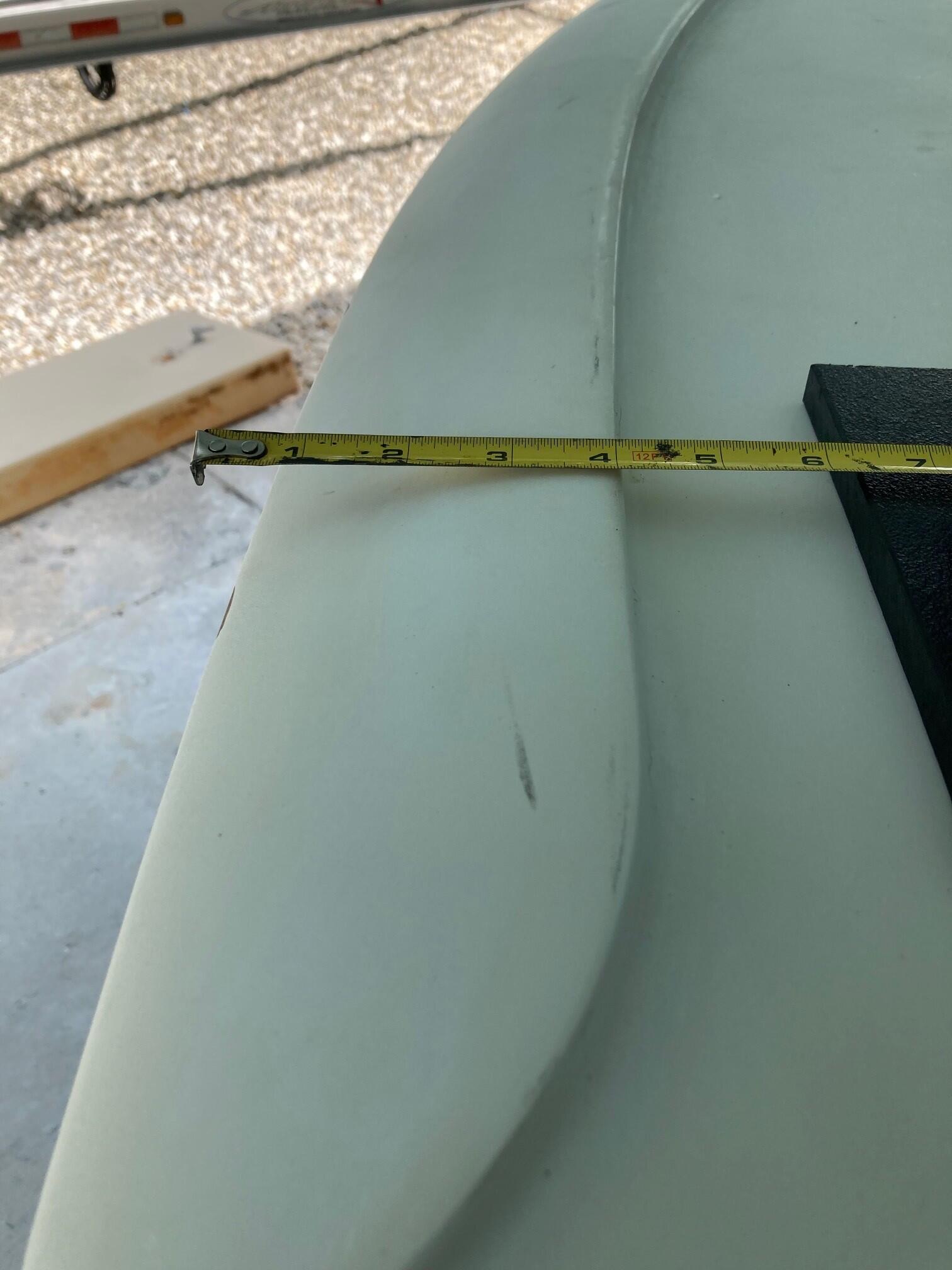

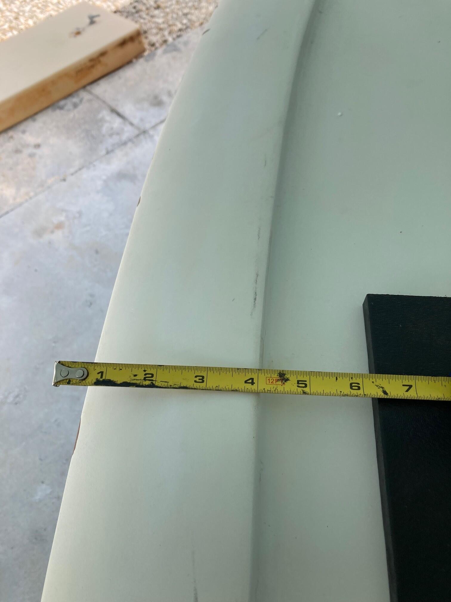

More detail on toe rails,

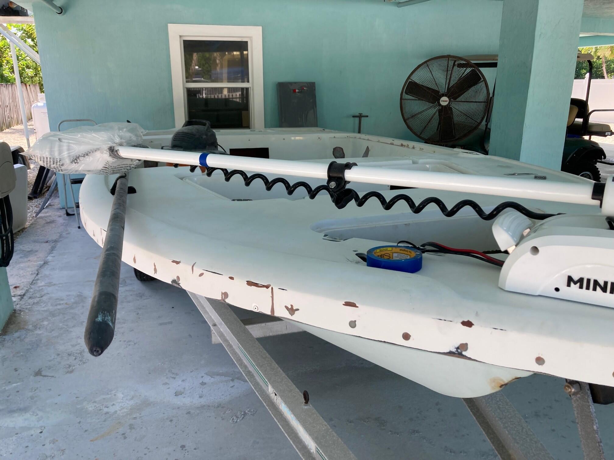

This is what it looks like in a more traditional mount, not a lot of room between toe rail and hatch. Could add a spacer but still have issue with cleat. No wiggle room on edge of hatch (hinged other side). A sliding mount could work here as there’s no toe rail. Head hanging out there pretty good on back side.

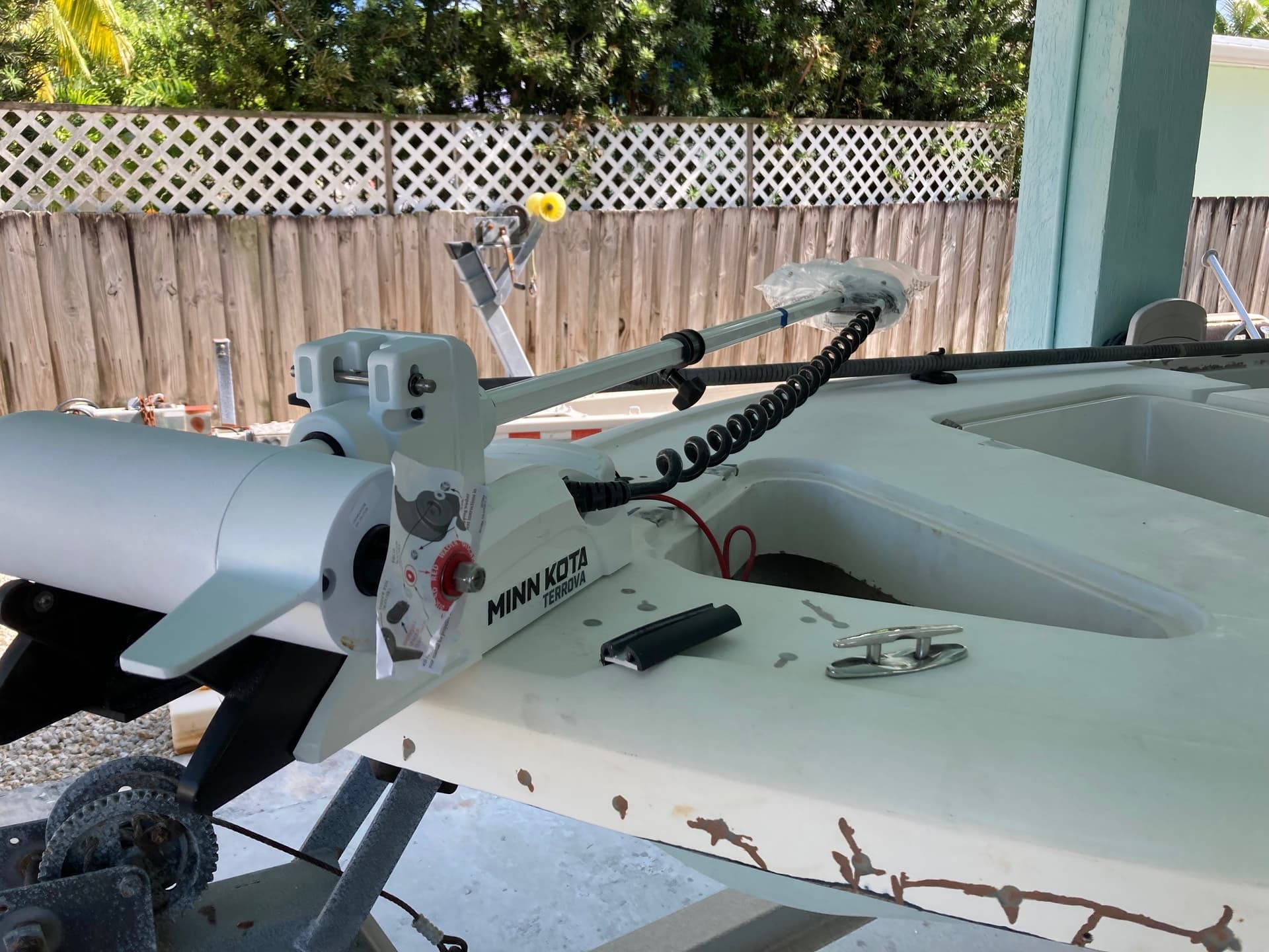

This would be about where it’d live with rotating mount. Pivot point is behind motor, spacer added to get mount plate above toe rail.

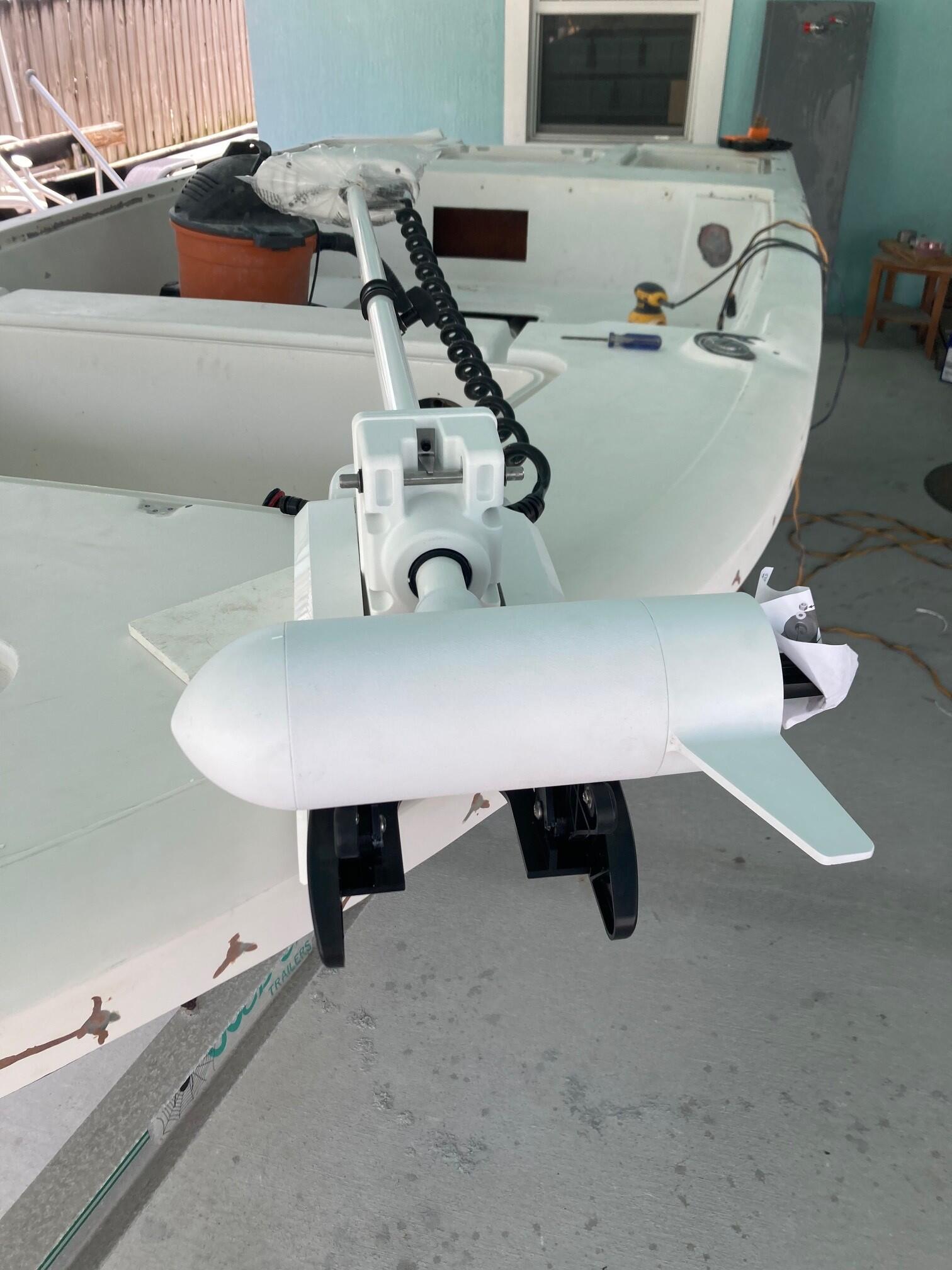

This is how it might deploy, in a more guide position. Will probably have to make holes is larger front hatch to get to underside of deck for mount fasteners.

This by the way is the driver for the mockup. I want to fill all holes and drill all major ones prior to paint and nonskid. Need to know where the TM is going and how wire passes through deck before paint.

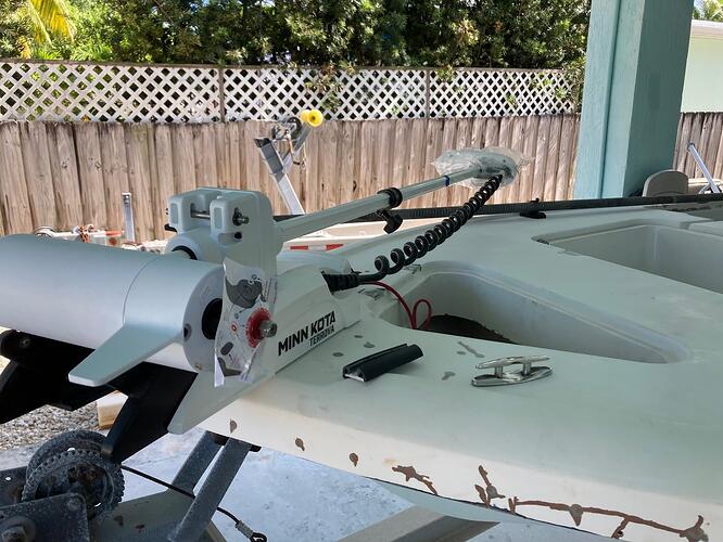

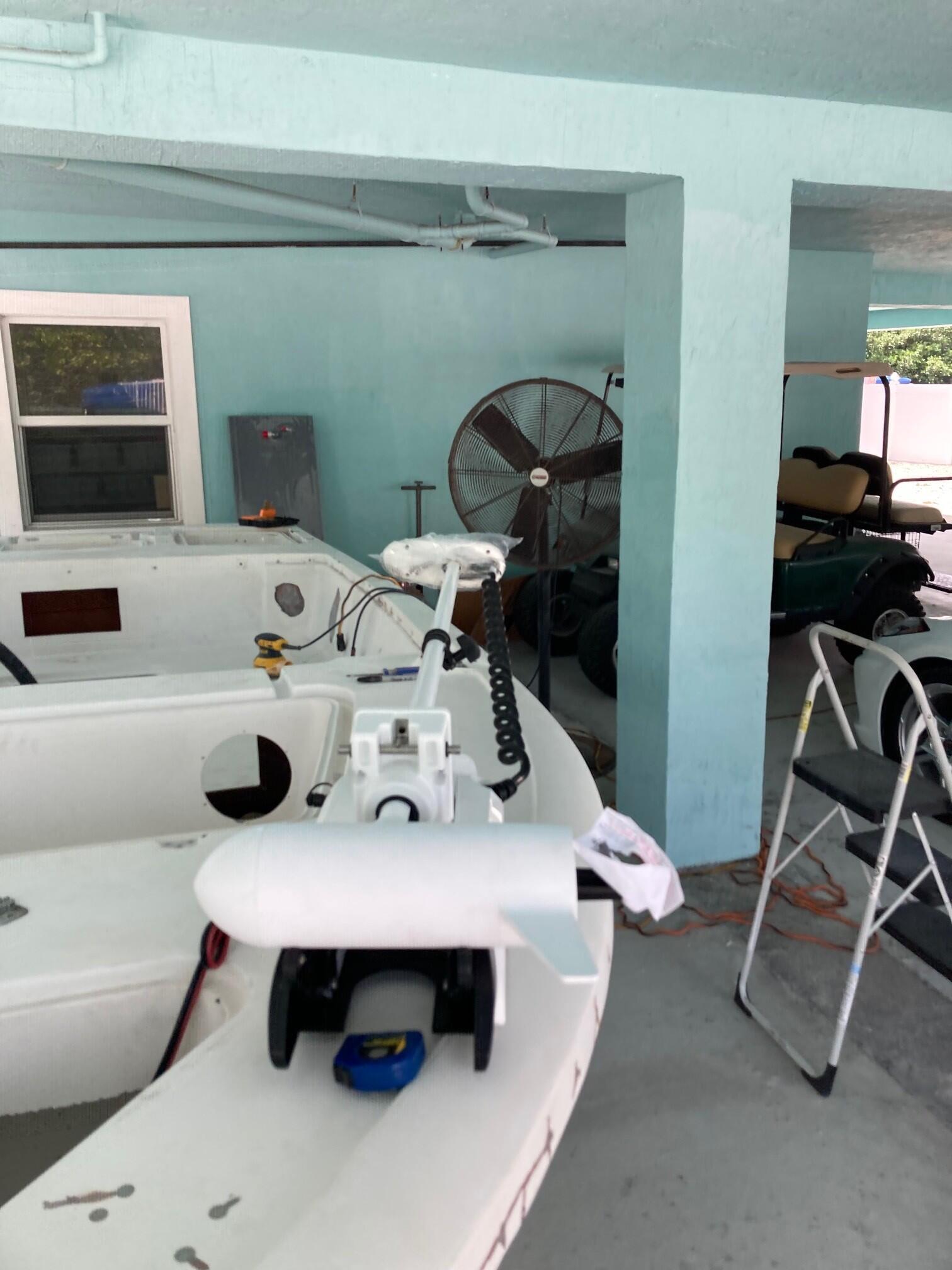

Picture below is how it’ll be. I opt to cut holes for recessed cleats on both side of TM. Ordered another as I only have one. Ordered bow chalks to install on the toe rail to keep the line from chafing the new paint.
blue tape on TM shaft should be bottom of head unit after shortening.

Good call! Looks like you have clearance from the anchor locker. There also appears to be a notch in that anchor locker for rode or the trolling motor power cable. Look forward too seeing the progress!
