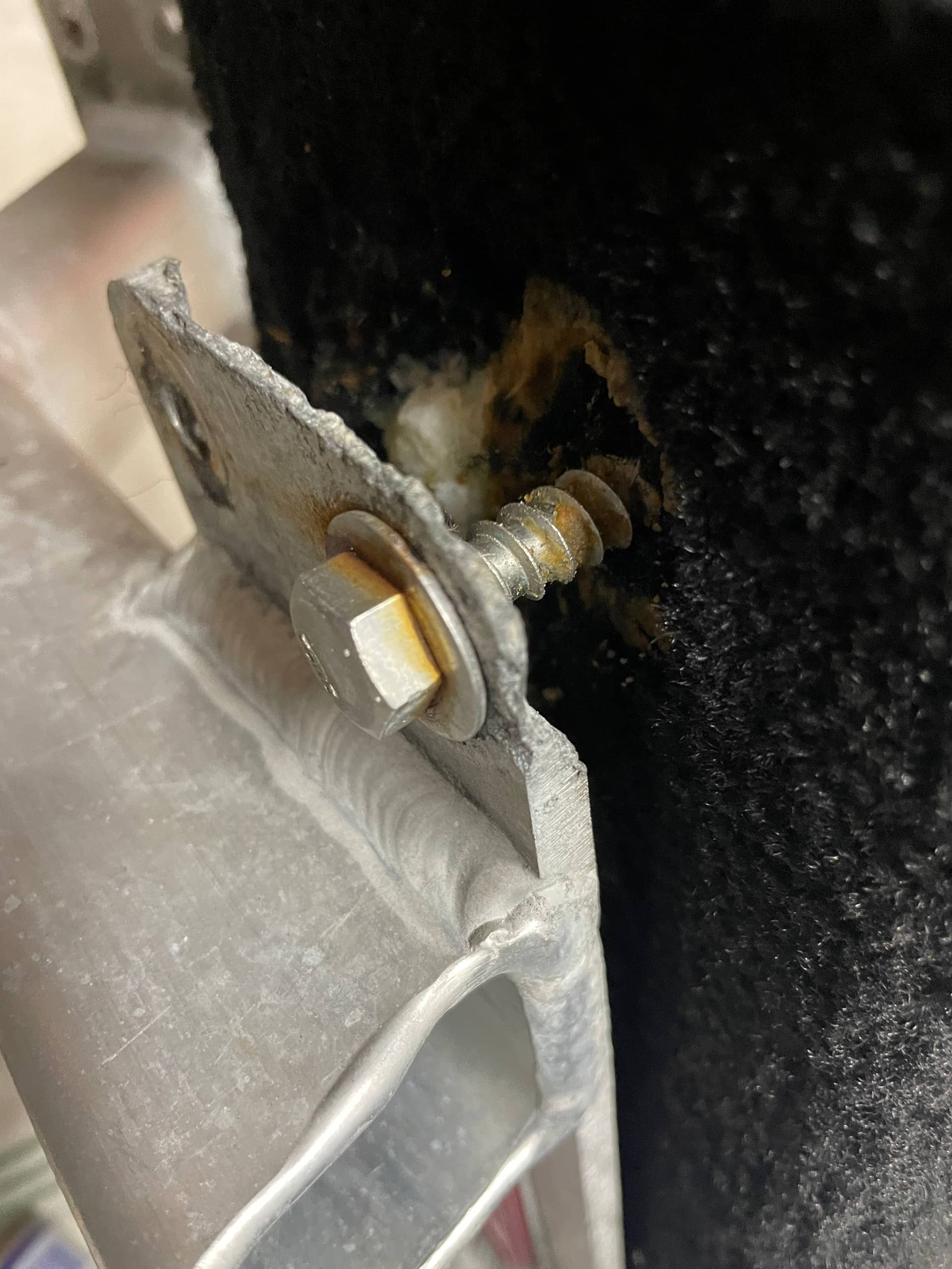

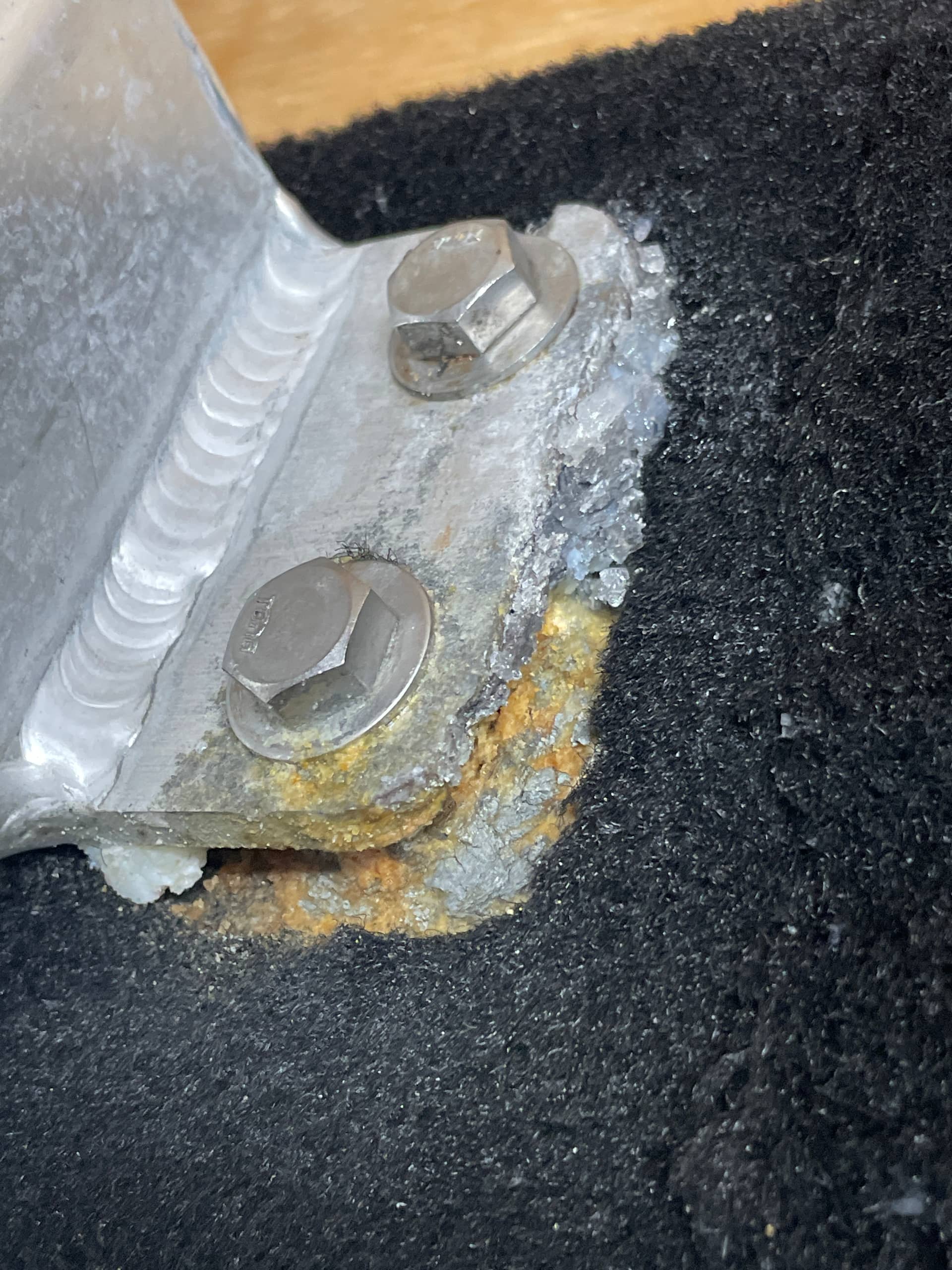

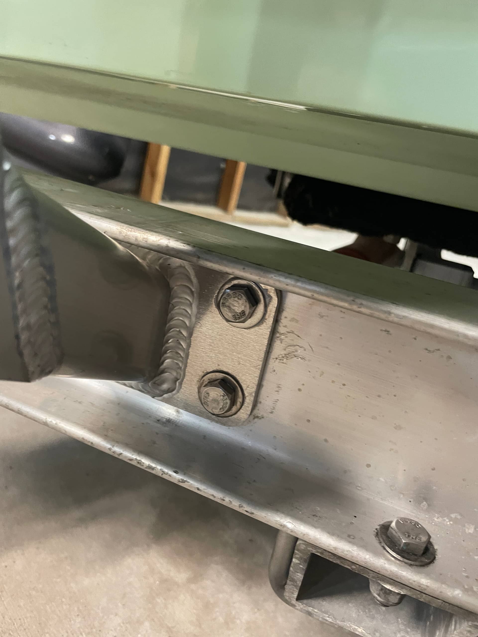

My Ramlin’s guide bunks somehow decided to create corrosion, looks like the stainless screw reacted with the wood and the aluminum and the attachment points. Harry at Beavertail arranged for warranty work on my trailer and they sent me two replacement guides w hardware.
I removed the guides and documented the corrosion for your pleasure!

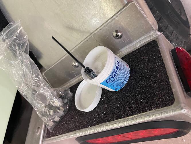

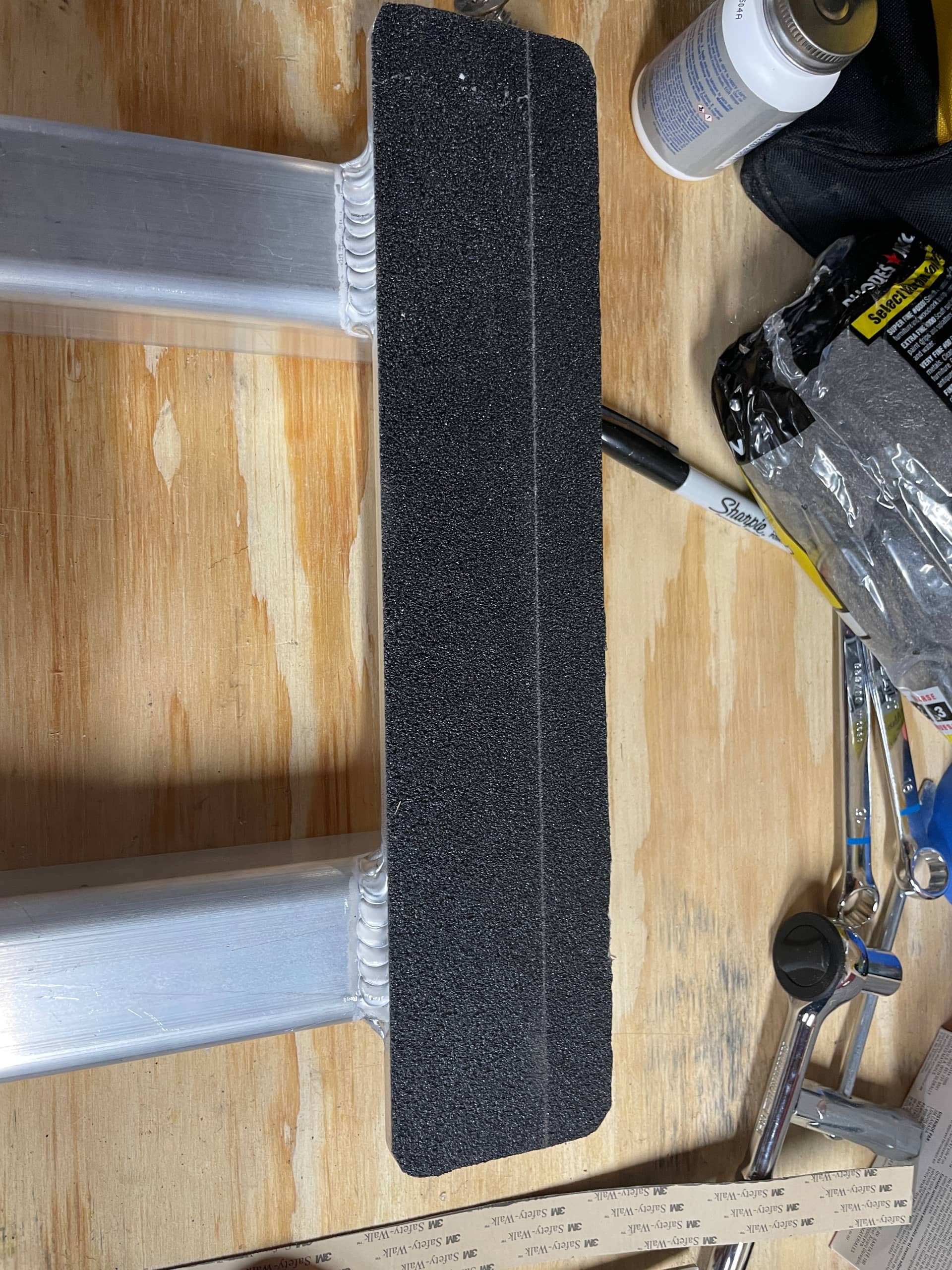

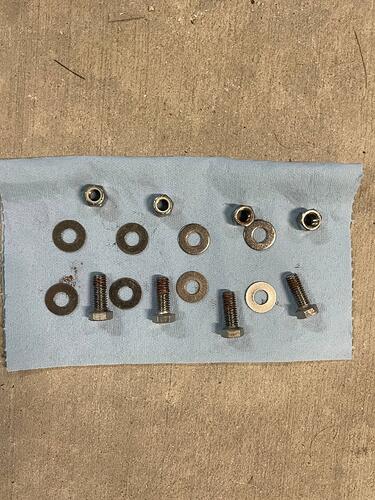

The fix as advised by @Smackdaddy53 was to apply 3M antiskid tape to the flat part of the brace where the wood bunk will get attached and use TefGel on the washers and screws.

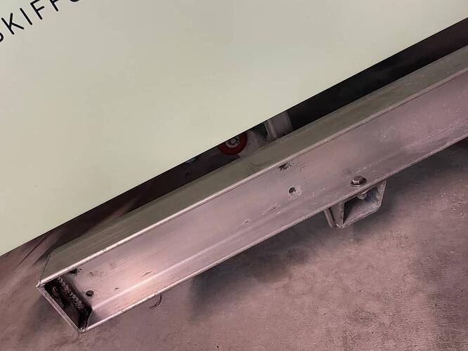

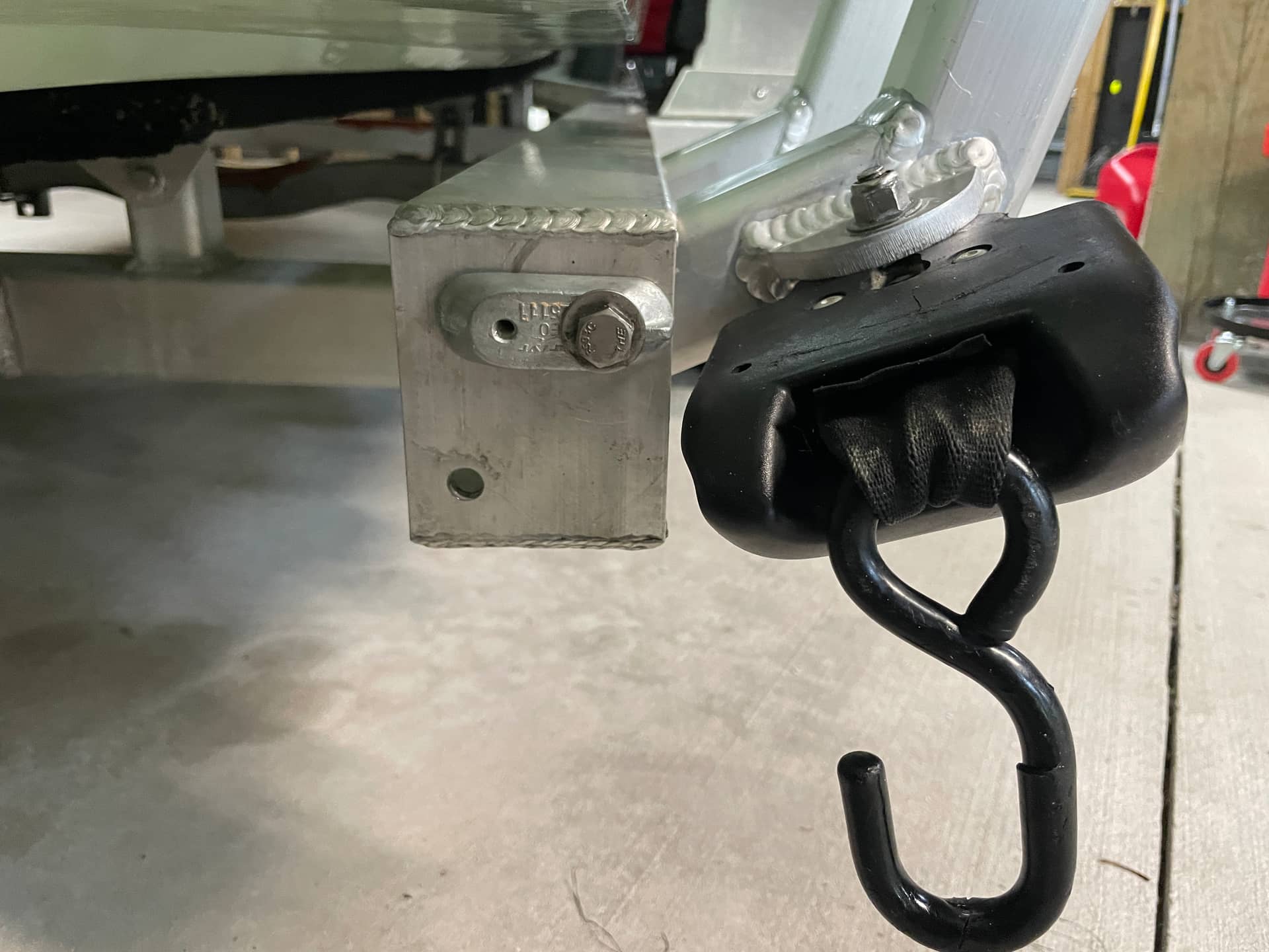

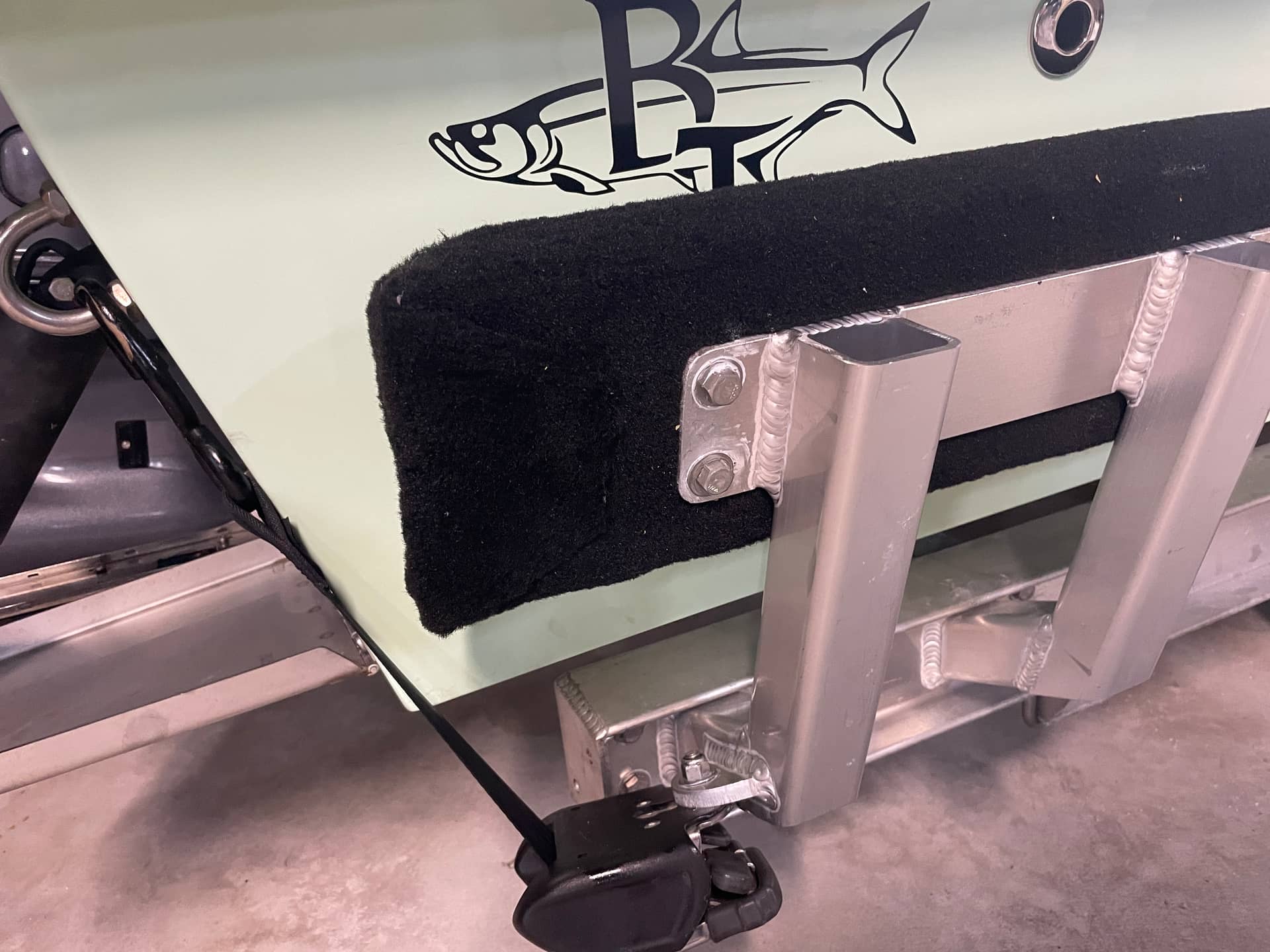

The mounting bolts got some TefGel as well, I added two zinc anodes to the ends of the trailer, I moved the stainless retractable straps to a better mount and did away with the 90 deg phalanges that were bolted to the end of the trailer frame.

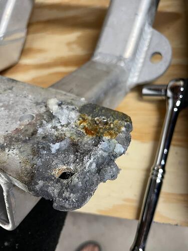

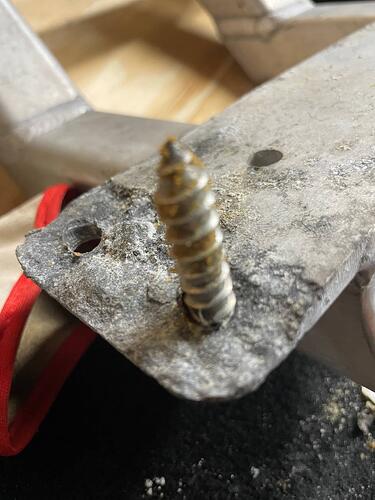

Here it is cleaned up, you can see the aluminum is eaten up and compromised.
There is no wood in contact with the stainless wood screws. Corrosion made a paste of aluminum and wood.

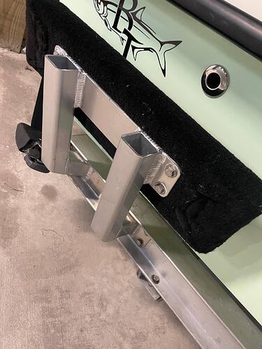

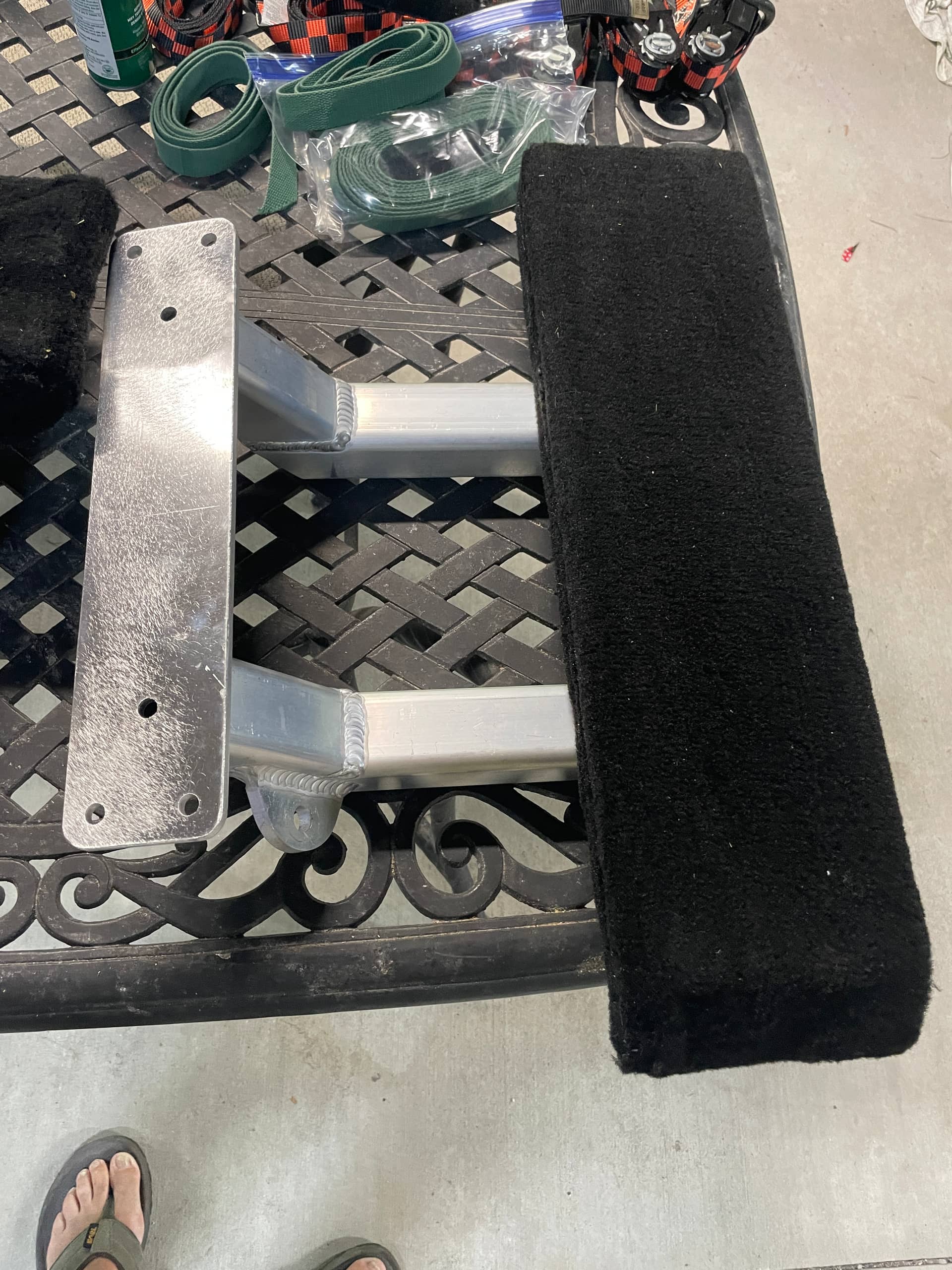

The new brace with 3M tape to isolate.

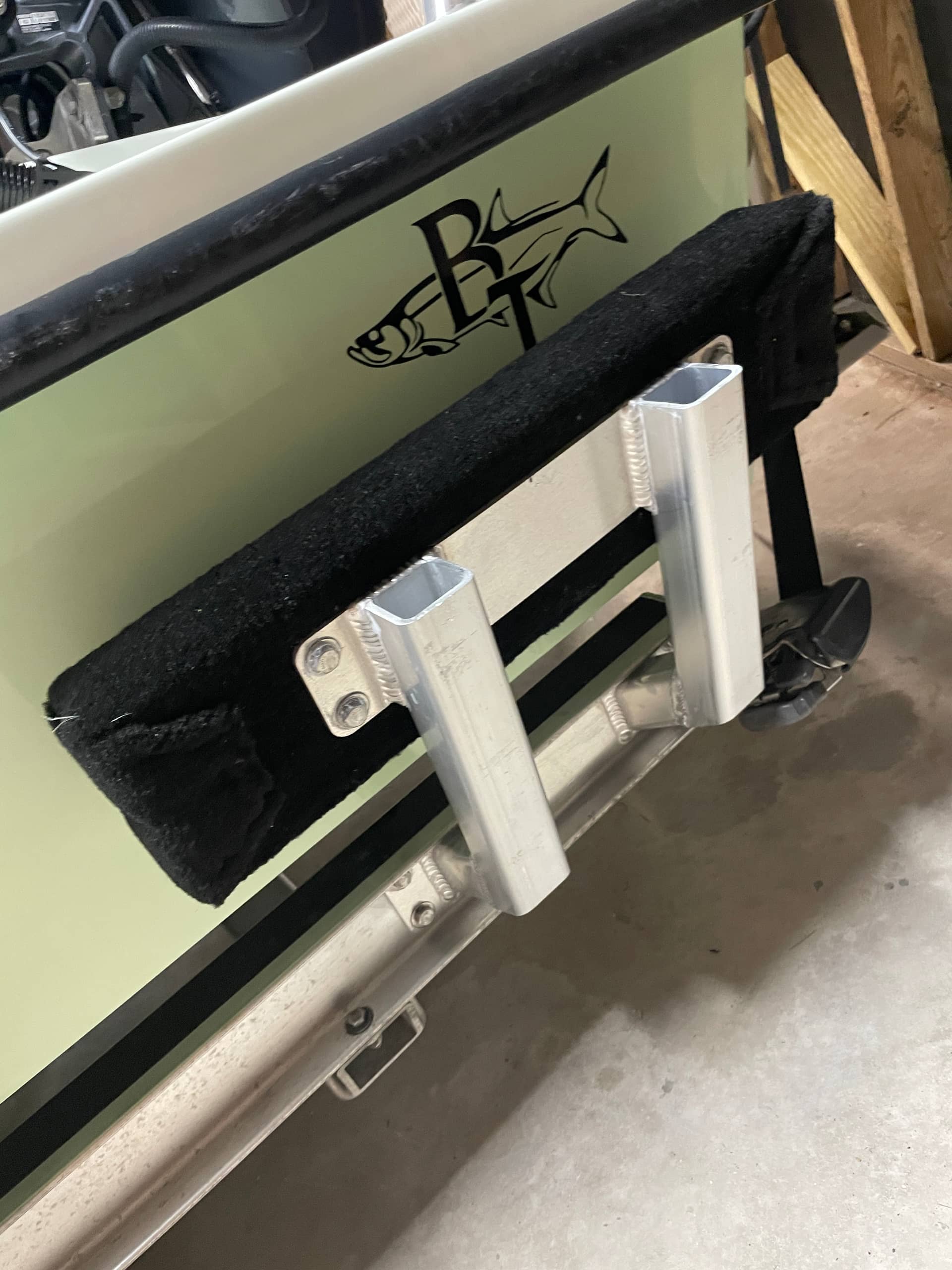

The bunk attached after applying TefGel to the new screws.
The zinc anodes.
Mission complete.
