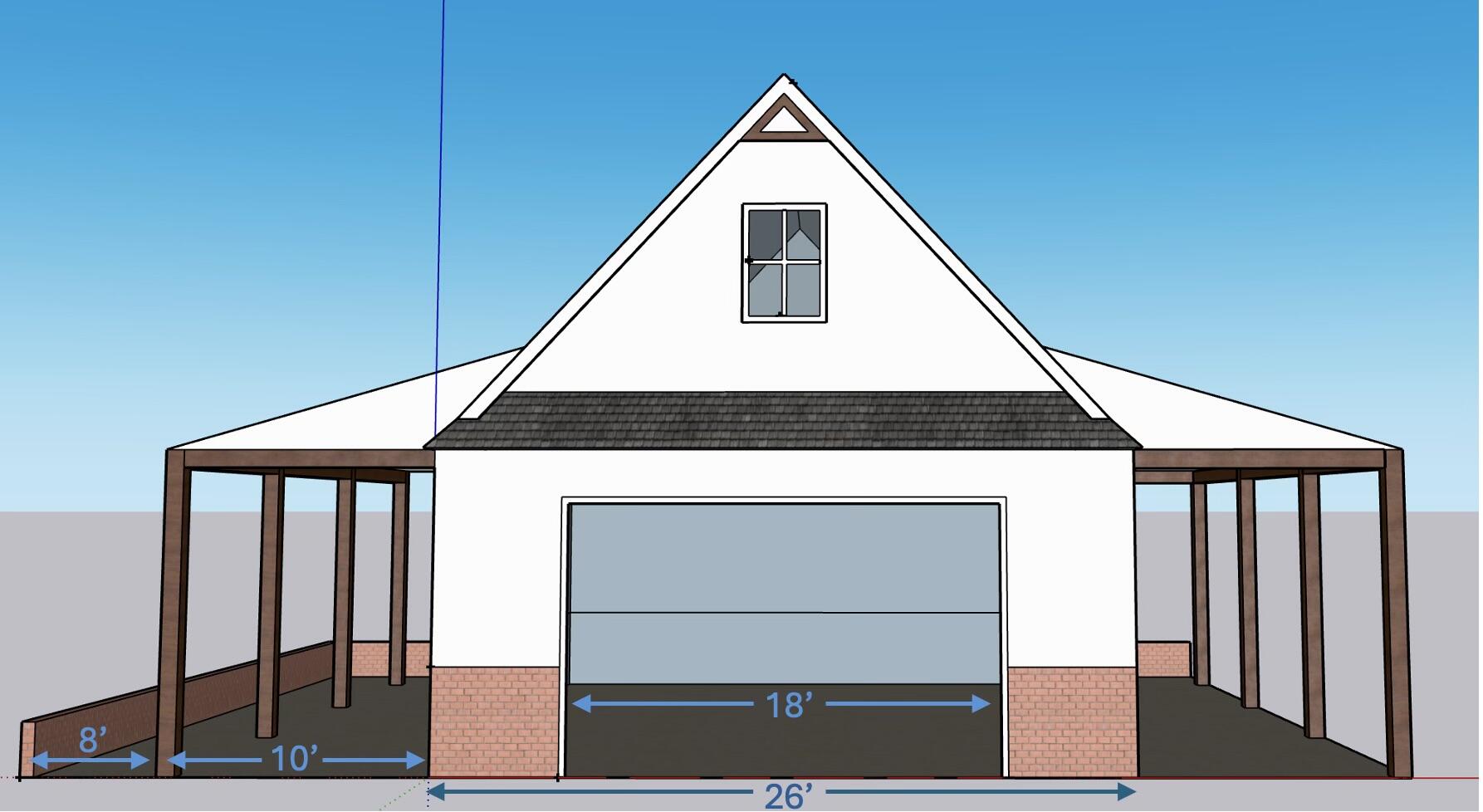

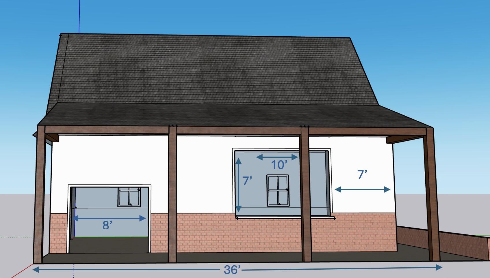

Well we have finally broke ground on our detached garage. I would love to hear some ideas from some of yalls experiences. Right now I’m not sure what kind of lighting I need and I would love to hear some organizational ideas. The garage will pull double duty as a work shop and skiff storage area as well as an entertainment area. The inside will be 26 x 36 with 10’ lean to’s on the sides. Left side will be for my old truck and jeep. The right side will be an entertainment area with a small garage door that closes down on a bar. Below are some pictures of what it will look like. Any help or ideas will be greatly appreciated.
Are you planning on finishing an upstairs? Looks like a fair amount of useable space.

Yes it will be used for storage

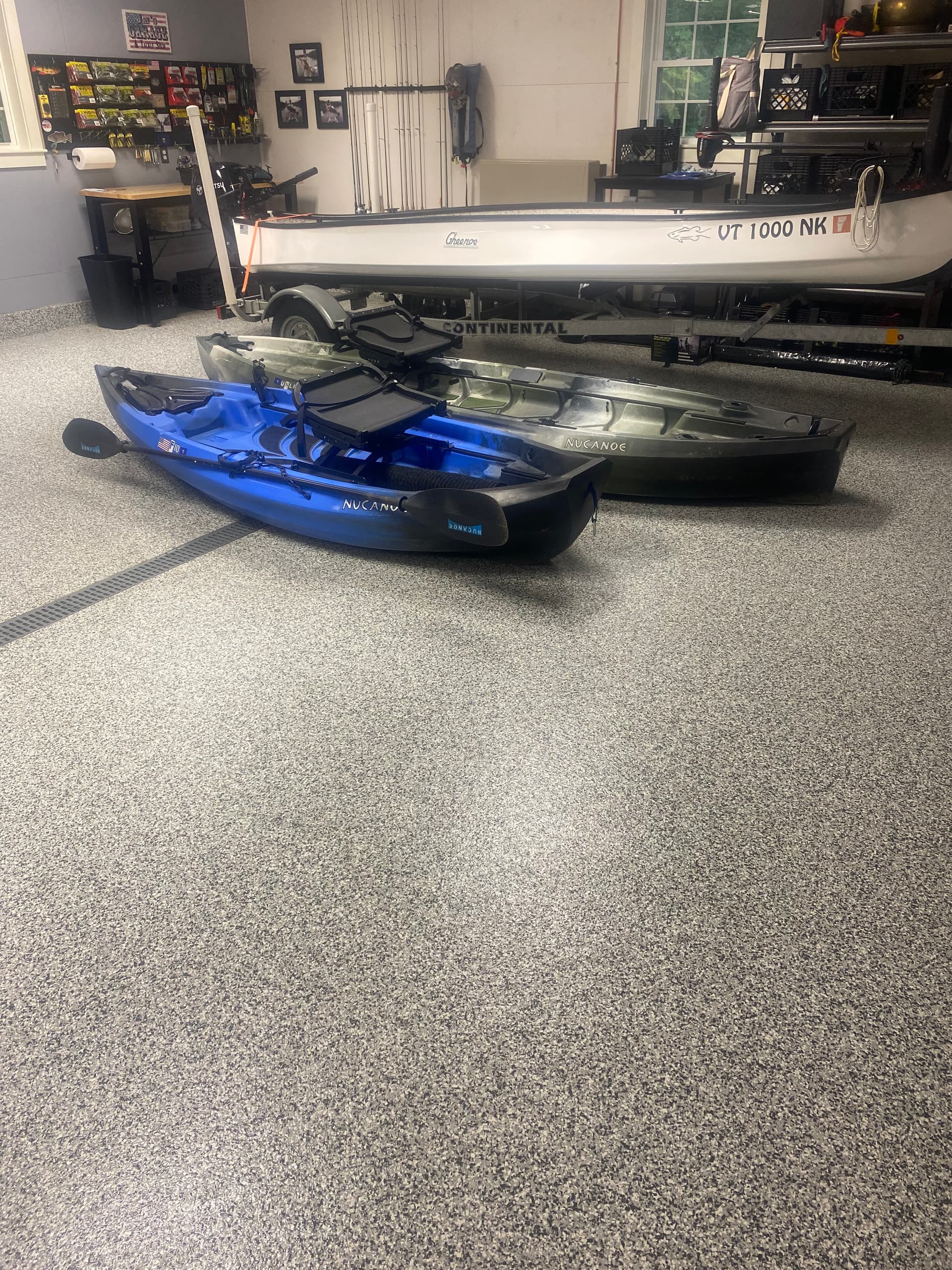

I highly recommend the epoxy coating for the floors. I had mine done when I bought my house last year. Very durable and looks great!

Is that garage door 8 feet tall?

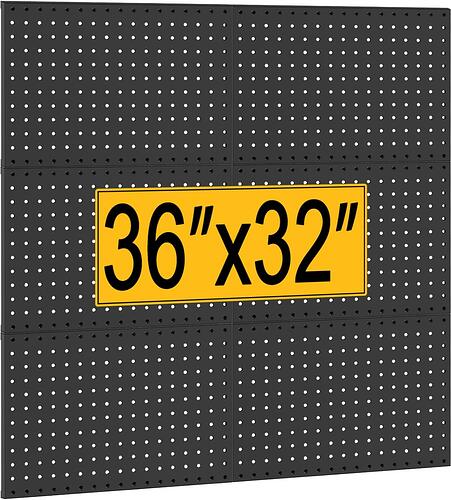

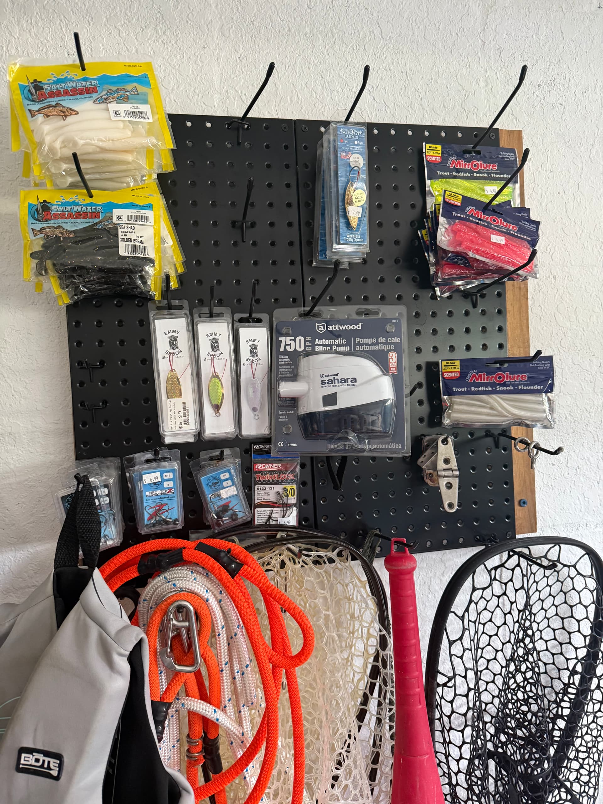

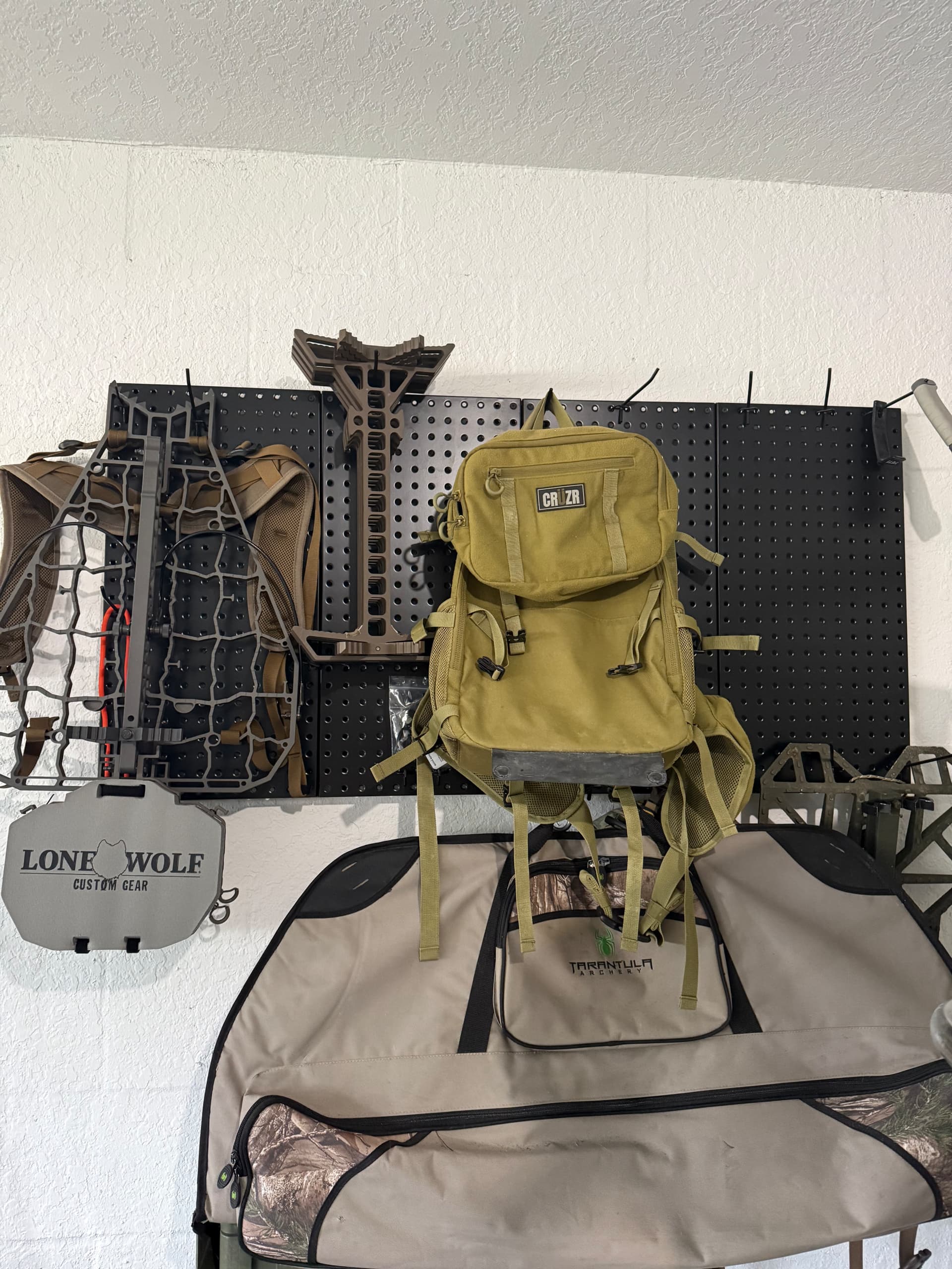

I’ve been a big fan of this metal peg board I found on amazon. Made a section last year for the hunting gear and one for tackle.
Planning a clean out day when it cools off to make room to hang some more to put up my fly rods and extra boat gear.

Seal the floor with an epoxy coat that has non skid in it. Do it first before doing anything else while the slab is new. That is a must.

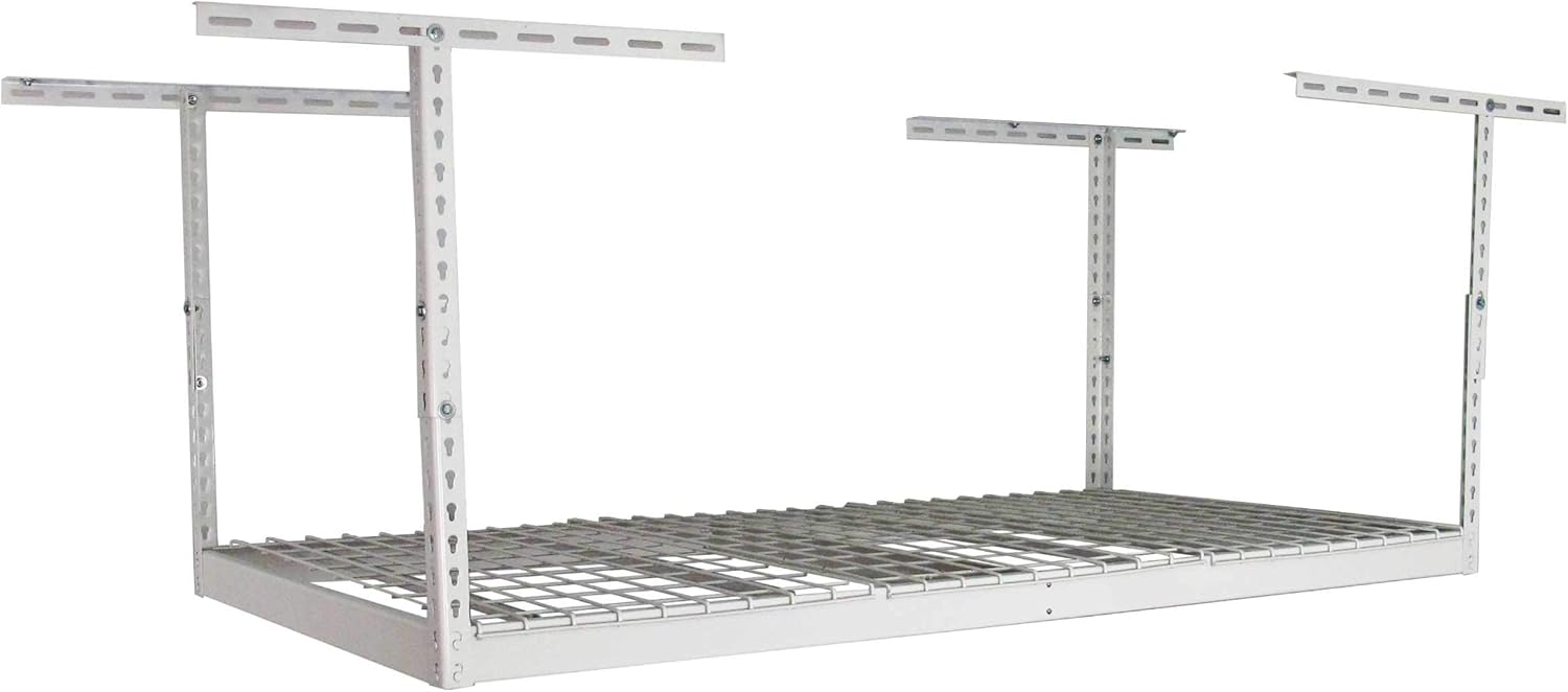

Overhead storage racks are nice to keep things organized. And you can put rod holders and hooks from them:
I installed several of these in different areas - I have storage tubs with boat parts, house parts, paddle boards, my yeti coolers up there away from the day to day stuff.

Yes it will be an 8’ door. The ceiling will be 10’.

You have to clean up spills immediately to avoid damage. I have large mats that my cars park on in the Winter to protect my floors. The Winter is the only time cars are allowed in my garage (snow on the ground).
