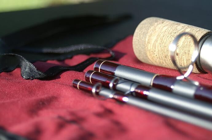

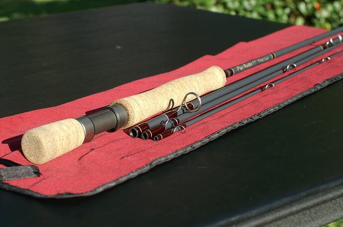

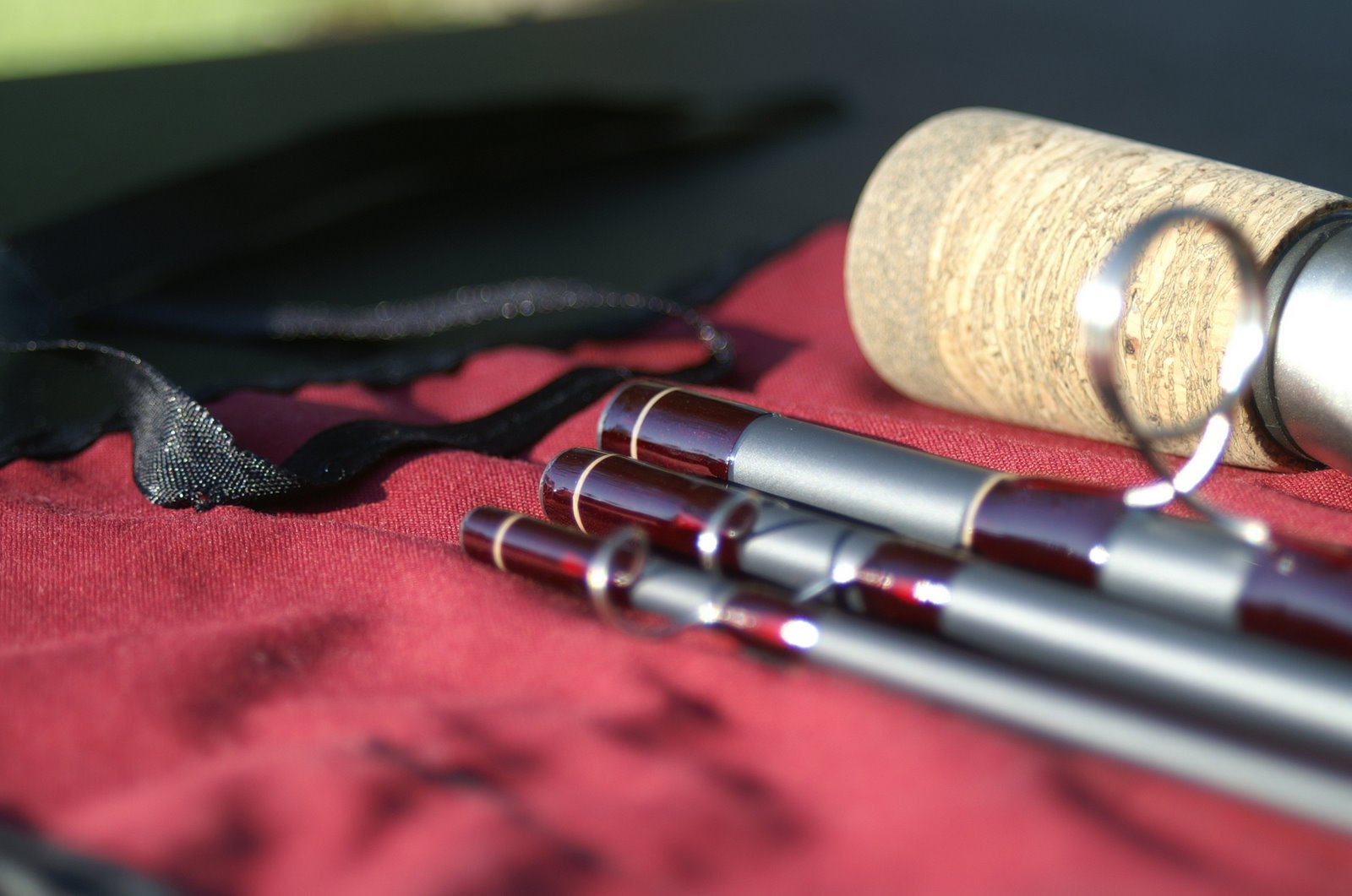

I’ve been building fly rods for a while now and almost exclusively fly fish. One thing that bothered me about reel seats when I used my first store bought set up was that it had the tendency to loosen with use and usually at the worse time.
One of my best friends, who introduced me to fly fishing and rod building was using a Fuji reel seat in an unconventional way and I’ve built every one of my many saltwater flyrods this way.
I mount a Fuji conventional reel seat upside down on the butt of the rod. Same as always, tape rolled up as a buffer and use past epoxy to permanently keep it there.
The neat part is to use a Fuji KDPS quick connect as a fighting butt/reel seat bottom end. The fighting but IS the part that will spin to lock the reel in place. The Fuji set up has high value in that it is inexpensive, will not rust and absolutely will not loosen with use.
The other thing that I like to do is to not use color preserver on my main thread color and then use a color fast cream or other contrasting thread color and not use the flash tinsel thread. Just something that I do and I’m not sure others do this as well.
I learned my rod building from a book by Clemens called Advance Custom Rod building published many years ago but still very relevant, especially as it comes to modifying a blank, etc.
Bart
I have a few NFC Gamma Betas that I built with Alps aluminum double locking seats that are very nice and do not loosen. I happen to also have oneI bought from a MicroSkiff member who built it using a Fuji graphite seat like yours and I like it as well, it’s just not as fancy or flashy.
Also a fan of alps reel seats, haven’t tried the triangle taper but a couple others I’ve tried have been solid. Also like rec but they’re seemingly always out of stock when I need one
I like it.
I like your threads work as well. It reminds of a buddy of mine. I had built him a few rods, and he had decided to try to build one himself, for his wife. He Did a AL Roll tide color scheme, got it all put together and epoxied it up. He called me and said “man all my thread disappeared” :joy:
Looks great! I used a a Fuji reel seat on my last build.
