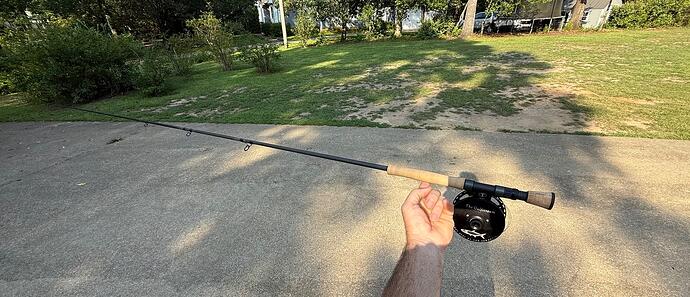

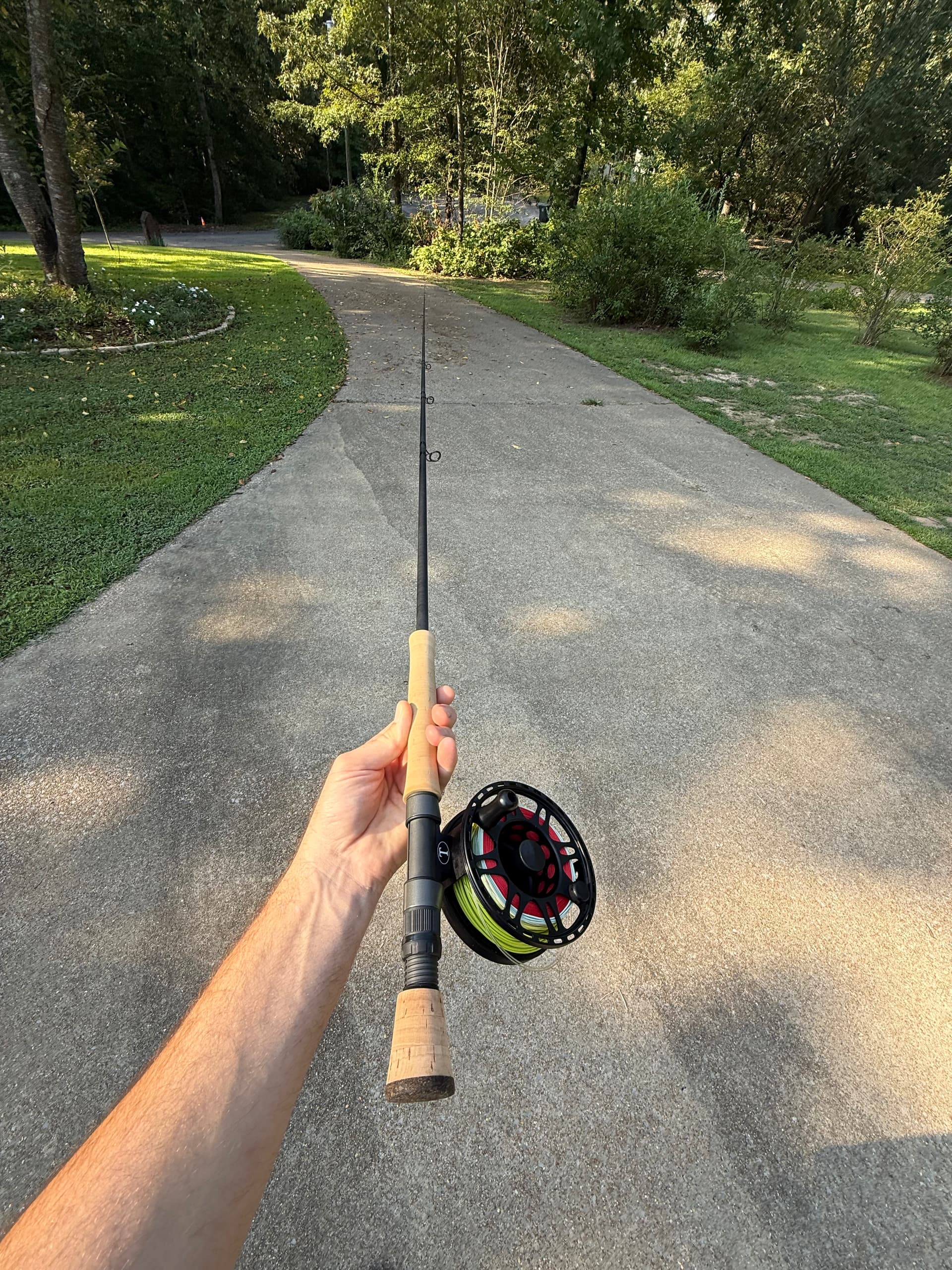

Blank - NFC PSI 12wt Components from Butt to Tip
  • Fighting butt made by myself
  • REC cork check 2216
  • Fuji DPSM 17 Gunmetal
  • Fuji LOGR17/AN Lock nut
  • 17mm arbors
  • Fly rod crafters super fine Fulls wells grip
  • Fuji T2 KWSG size 20, 16 , 12
  • REC RSNX/B 6,6,6
  • REC RSNX/B 5,5,5
  • REC RTTULB-XL size 6.0
Guide spacing from butt to tip in inches
32, 43 1/2, 53 1/2, 63 1/2, 73 1/4, 82, 89 3/4, 96 1/4, 102 1/8
Looks good👍 How do you like it? I built the same rod a few years back. F1290-1 psi

I haven’t really got to fish it yet. I had 3 fingers get caught in the forks of a lull so my dominant casting hand is out of commission right now. So far I’ve tested it with a 240g head and a 330g head. It casts both lines fine but I honestly like the lighter line on it better right now. We’ll see when I actually get to fish it though.
