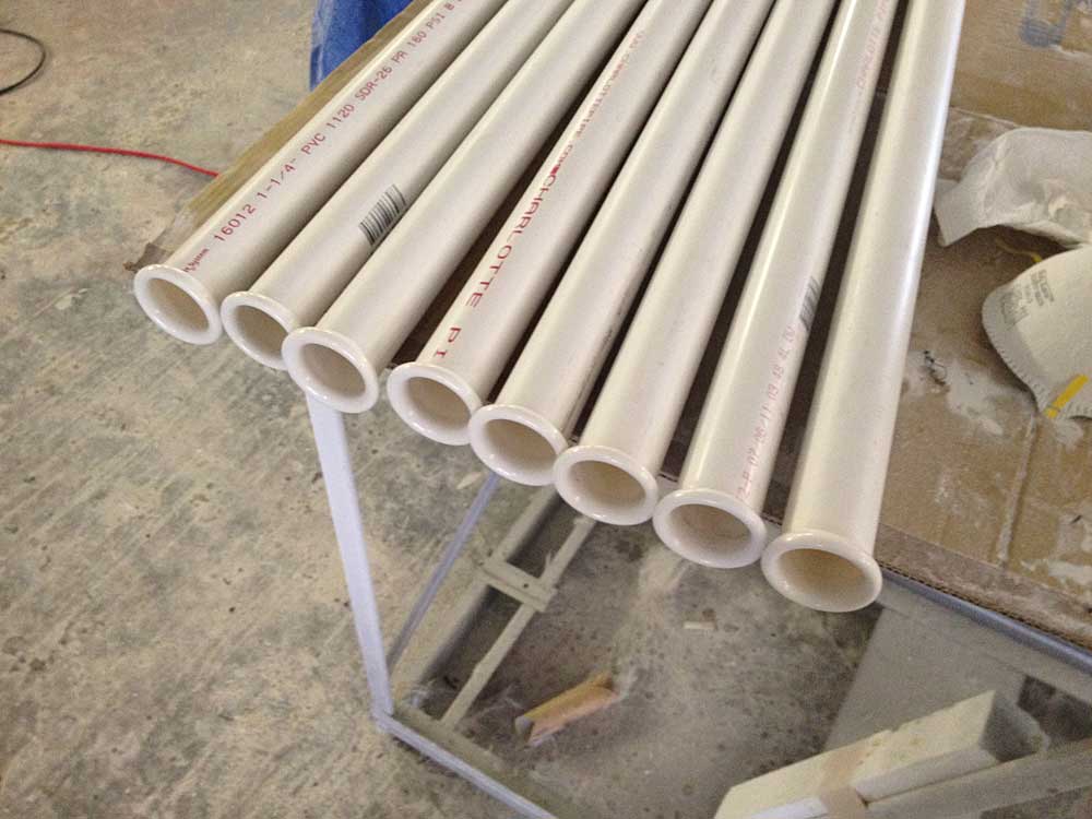

I’m using 2” for my rod tubes. Look for DWV pipe though. It’s lighter than scd40 PVC.

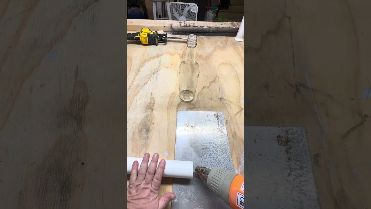

Another option is to use heat to flair the PVC tube.

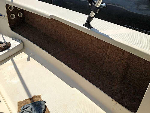

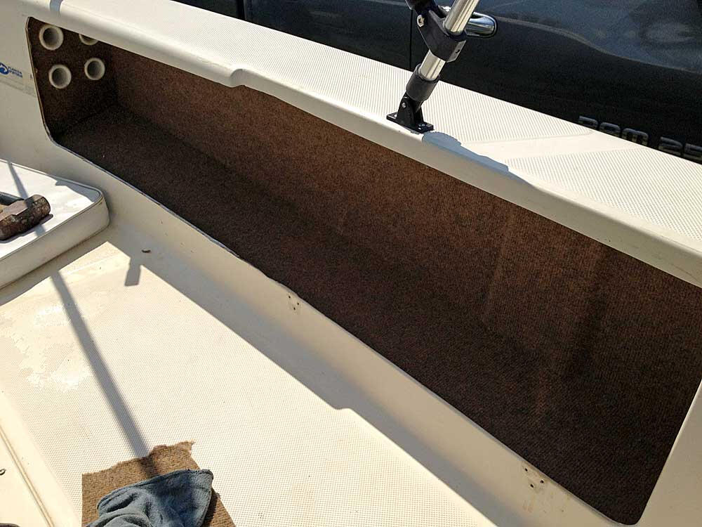

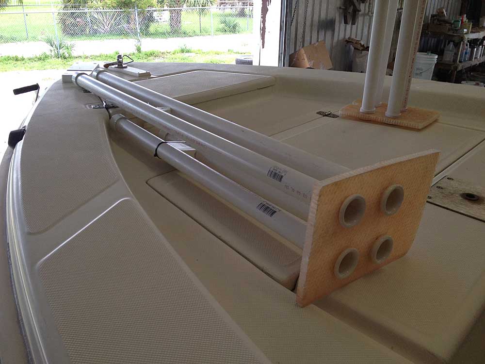

Several years ago when I cut out the stupid rod lockers from my old Scout 192 and made real rod storage I used this technique to flair the ends of the tubes when I mounted them under the gunnel.
Here is a video on Youtube I found this morning that’s very similar to the method I used.
1 1/4” thin wall, then flare the end with a coke bottle/funnel/wine bottle and some heat like iMac said.

For what it’s worth, if you don’t have a heat gun. Dip that PVC into a pot of boiling water. Turns it into a wet noodle without any fear of burning the ends.
