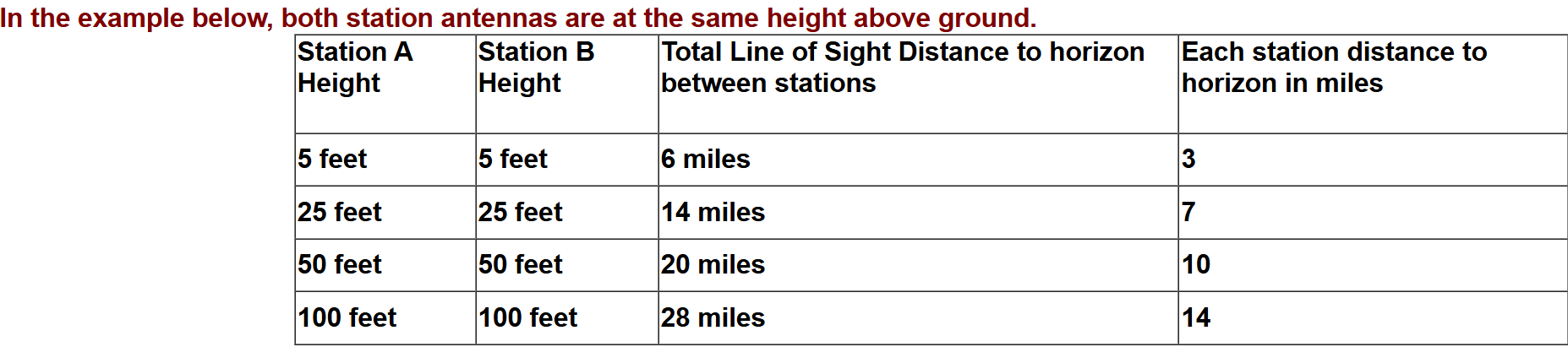

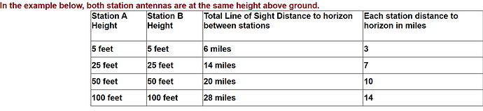

Hey, here’s a topic I happen to know something about. I have an extra class amateur radio license (KE4Y) and play with radios. The ratings on these handheld radios are wildly exaggerated. VHF frequencies are line of sight. Any obstruction will block your signal. Your greatest obstruction is the curvature of the earth. A 25 mile range is theoretically correct, if you’re both standing on a mountain top. If you’re holding the radio in your skiff while on the water, you are at about 5 feet which makes the range about 6 miles before the curvature gets you. Over water VHF frequencies will “bend” a little, giving about a 25% bonus, so you may get 7 or 8 miles. I think the recommendation for a quality handheld VHF radio is a good one. They are typically 5 watts. If you go the GMRS route, which isn’t a bad option though not as universally useful on the water, you can get 5 watts as well, but some radios have a lower power rating. You will get more “push” on your signal so to speak with more power.
If you would like to read more, this is a good resource: Radio Line of Sight Calculator for use on VHF/UHF Ham Bands
Here is a useful snip from the site:
