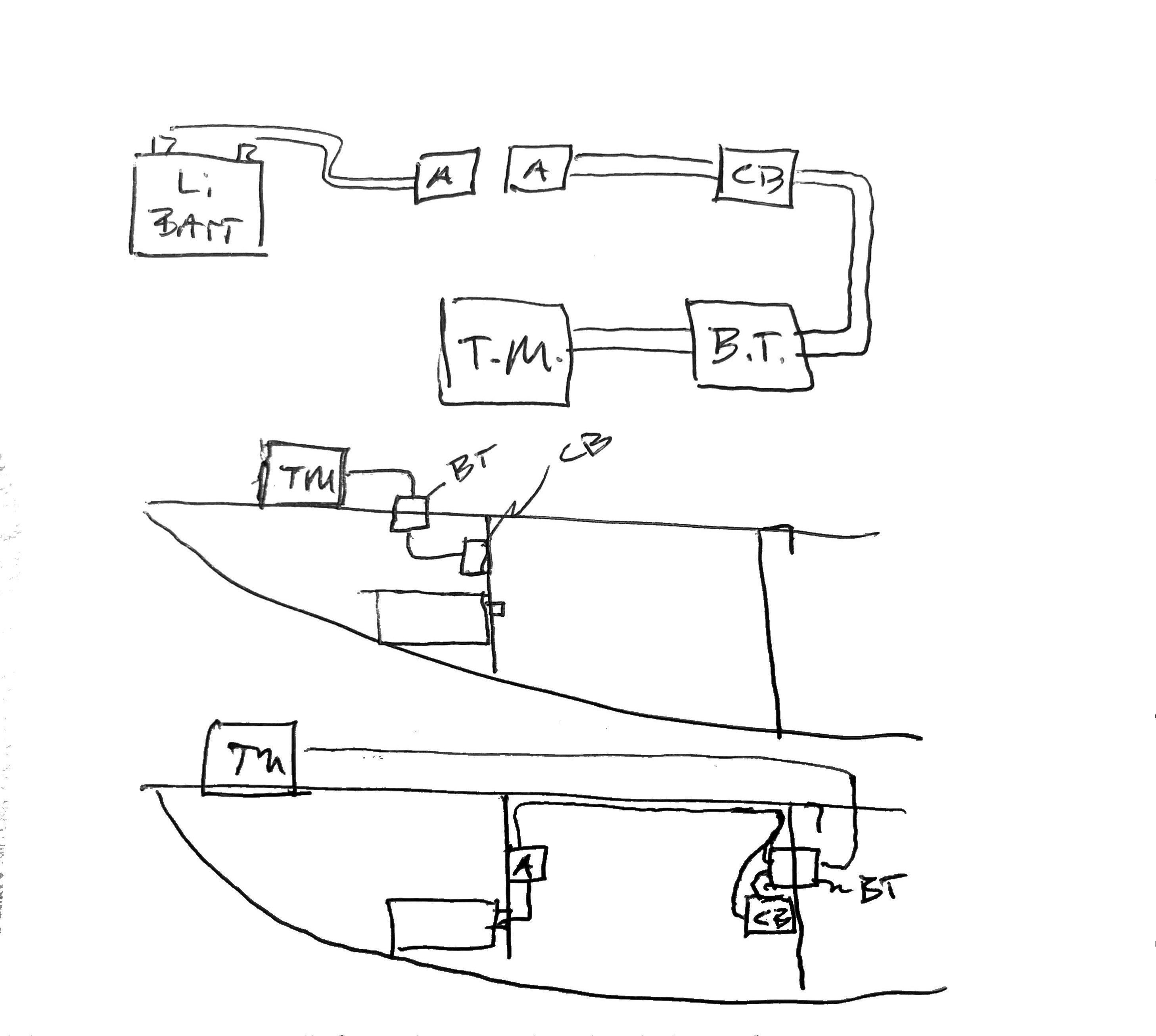

I’m trying to decide between two options for running the wires for my minn kota RT 55 on the Simple Skiff.
The motor is guide mounted on the minn kota quick release bracket (no power puc). I have the battery tender plug. The Simple has 2 forward bulkheads that are open. The battery (LiFePO) will be mounted in the forward section of the bow.
  1. Deck. Mount BT plug through the cap near the TM to install the Battery Tender plug. Under cap, mount circuit breaker and Anderson plug to easily disconnect battery. This seems easiest to accomplish and all wiring would be sort of separated from where the portable gas tank rides. Cons are that it’s a big hole in the cap, hard to access for repair/install, there’s no drain from that section.
  2. Bulkhead. Mount BT plug through bulkhead and attach circuit breaker to inside of bulkhead. Run wire from CB to forward section and mount Anderson plug to forward bulkhead. Pros: cleaner deck when not using trolling motor. Cons: This will require at least 4x the length of wire, wiring and connections in same section of bow as gas tank.
I’m leaning toward deck mount but I’d welcome some input from the community. Here’s a bad sketch:
As close to the trolling motor as you can to reduce trip/tangle hazards. Secondly, forget the plug and wire directly to CB and battery. I’ve never found a plug worth a darn, and I’m not forking out for a power pux.

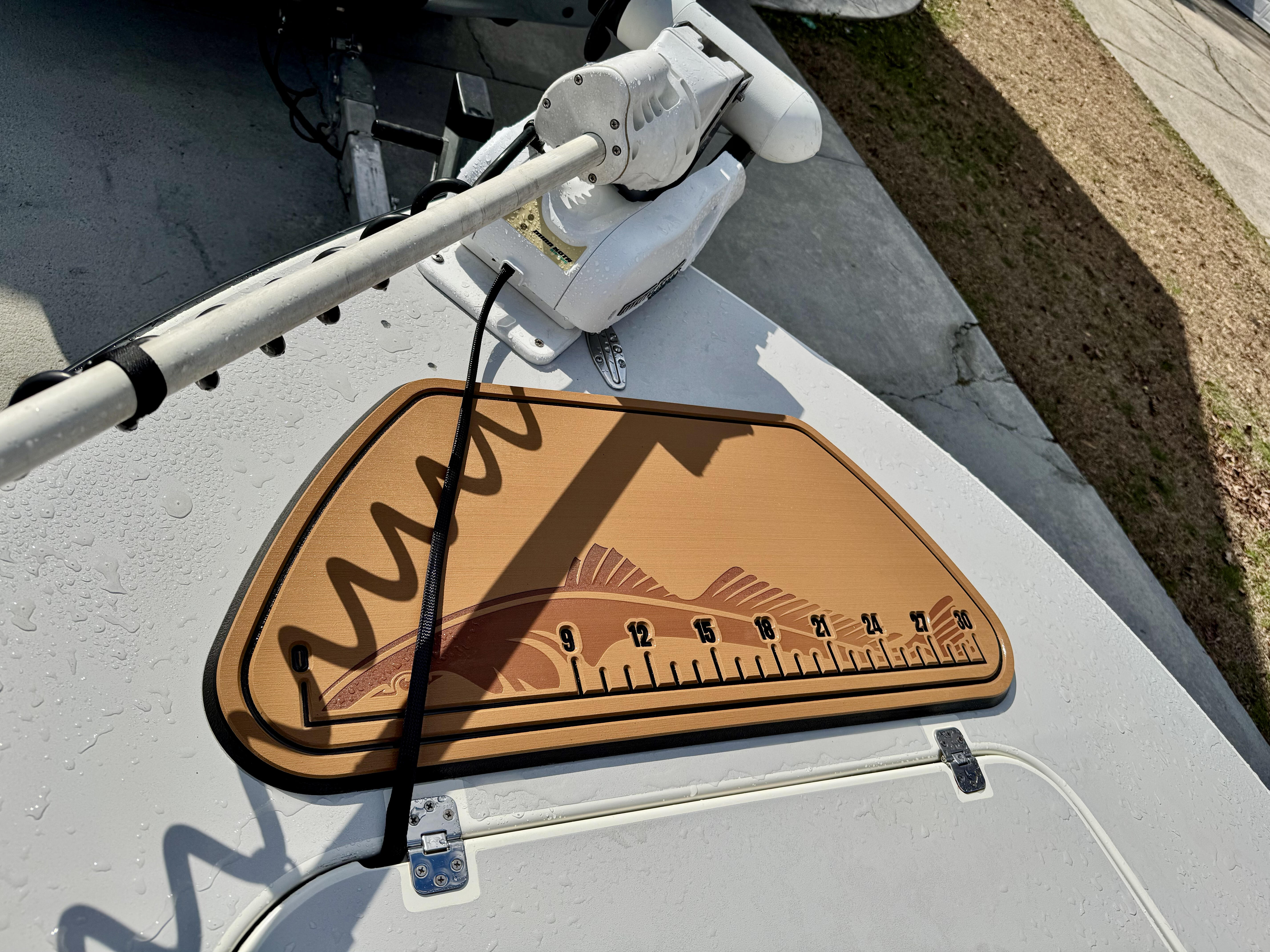

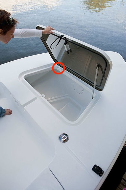

A third option (may require a bit of glass work would be to make a small cut out (sorry can’t think of a better way to describe it) in the leading edge of the hatch and run the wire into the hatch. I know it’s a small picture but the area in red is a small depression in the channel to allow the trolling motor cord to pass under the hatch lid. Then you can see there is a notch in the lid. This is how Egret has been doing it since 1996.

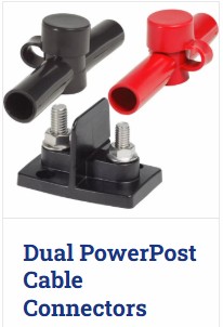

Just ordered remaining parts for mine. In center console for TM power I have 24V battery that connects to mini-battery on/off switch that connects to 60Amp breaker. After that 4AWG wire (due to 20’ length of run) to bow inside anchor locker. 4AWG Wire will terminate inside waterproof box on bulkhead. 4Awg will bolt to Blue Sea dual post 5/16 power cable connectors, other side 5/16 8awg run outside of box to Anderson connectors. Anderson connected 8AWG to TM. Wire will pass thru repurposed fuel fill with rubber stopper to motor.
When I need to remove motor, disconnect Anderson connectors, loosen rubber stopper pull wire out.
I stole this from other form. Wire on deck is short and right next to trolling motor. If it does leak a bit, should fall to bottom of anchor lock and drain out to stern. I have fuel fill, waiting on rubber stopper.

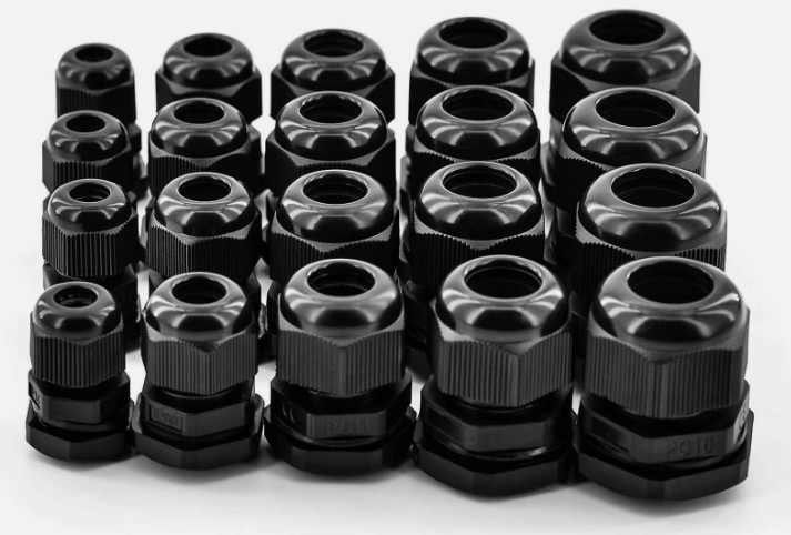

I also had issues with the 4AWG wire, not a lot of choice on connections. This should allow 4AWG in, 8AWG out. Waiting for this to come in to pick out box. I also bought Cable Gland Kit to allow cables a watertight pass thru into and out of box.

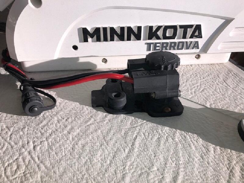

I’ve been pleased with my Battery Tender plug in and located it right next to the Terrova. So far, three years in, it’s never been a problem…
