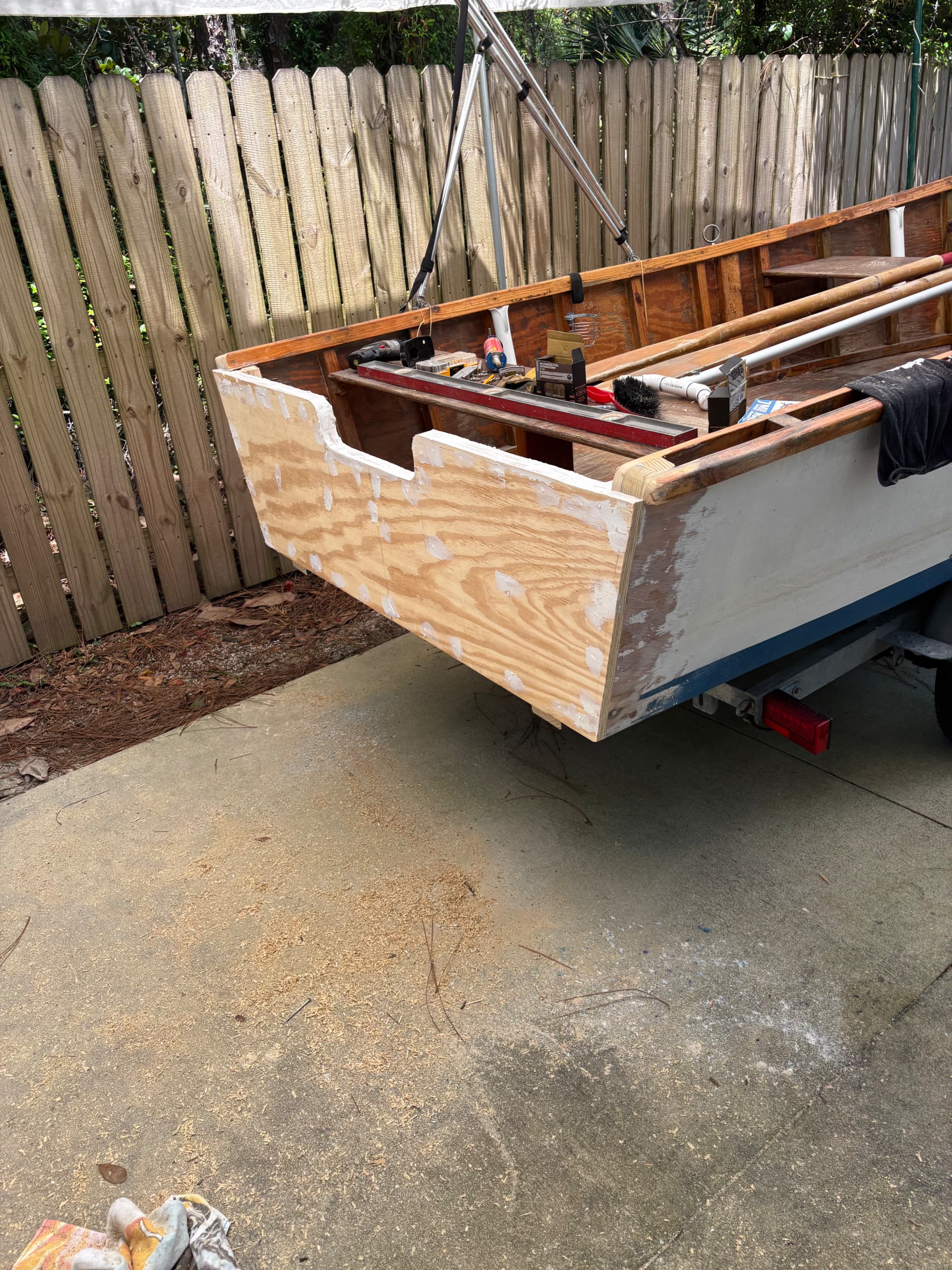

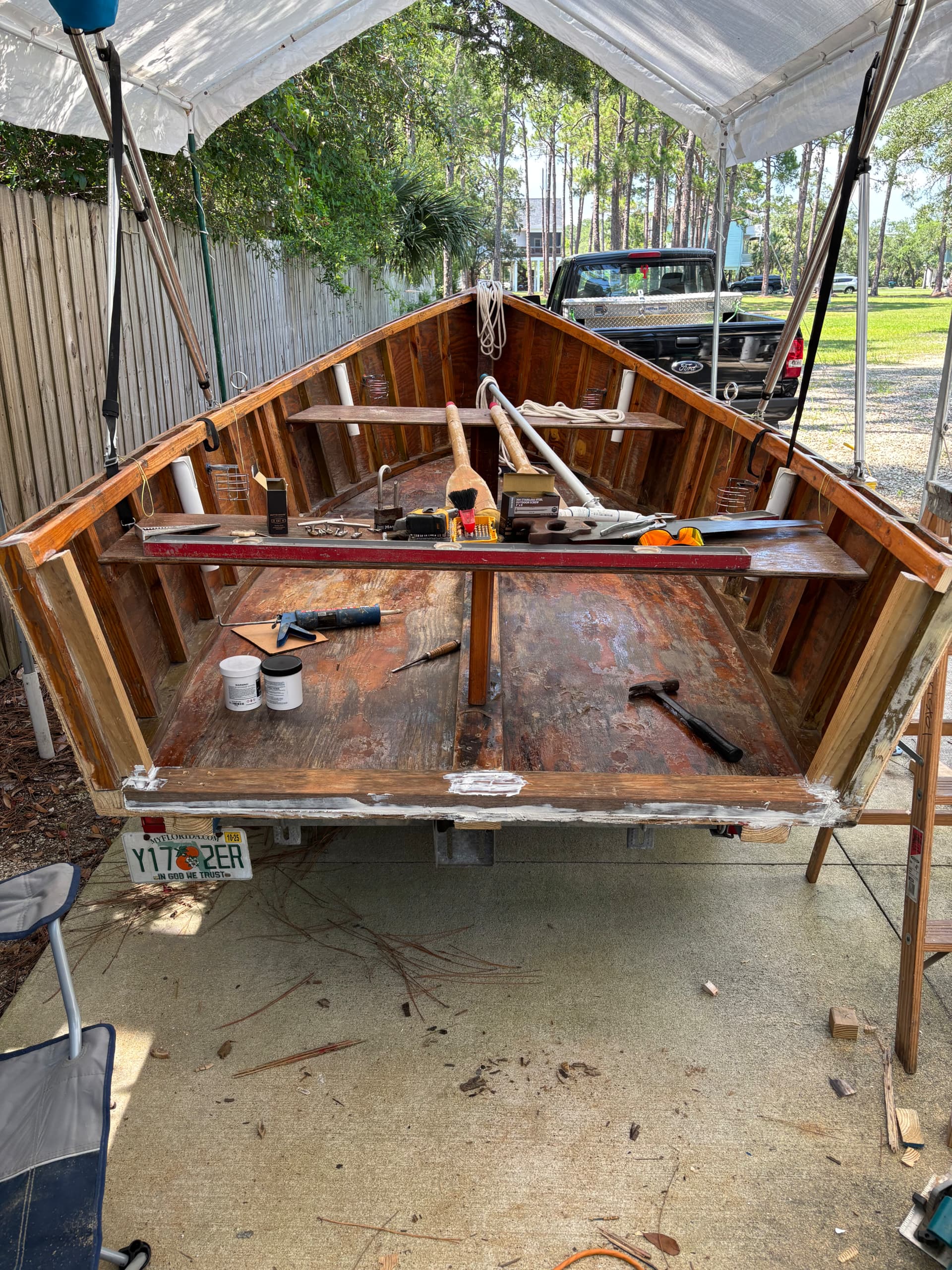

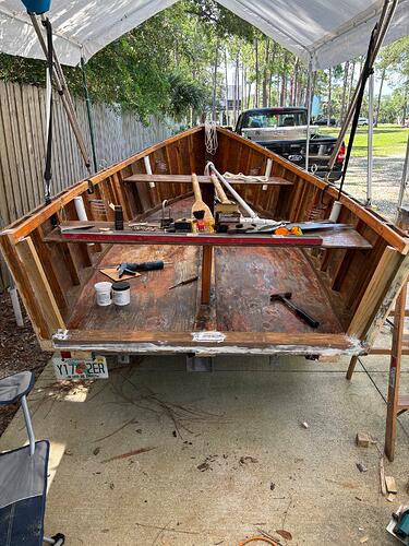

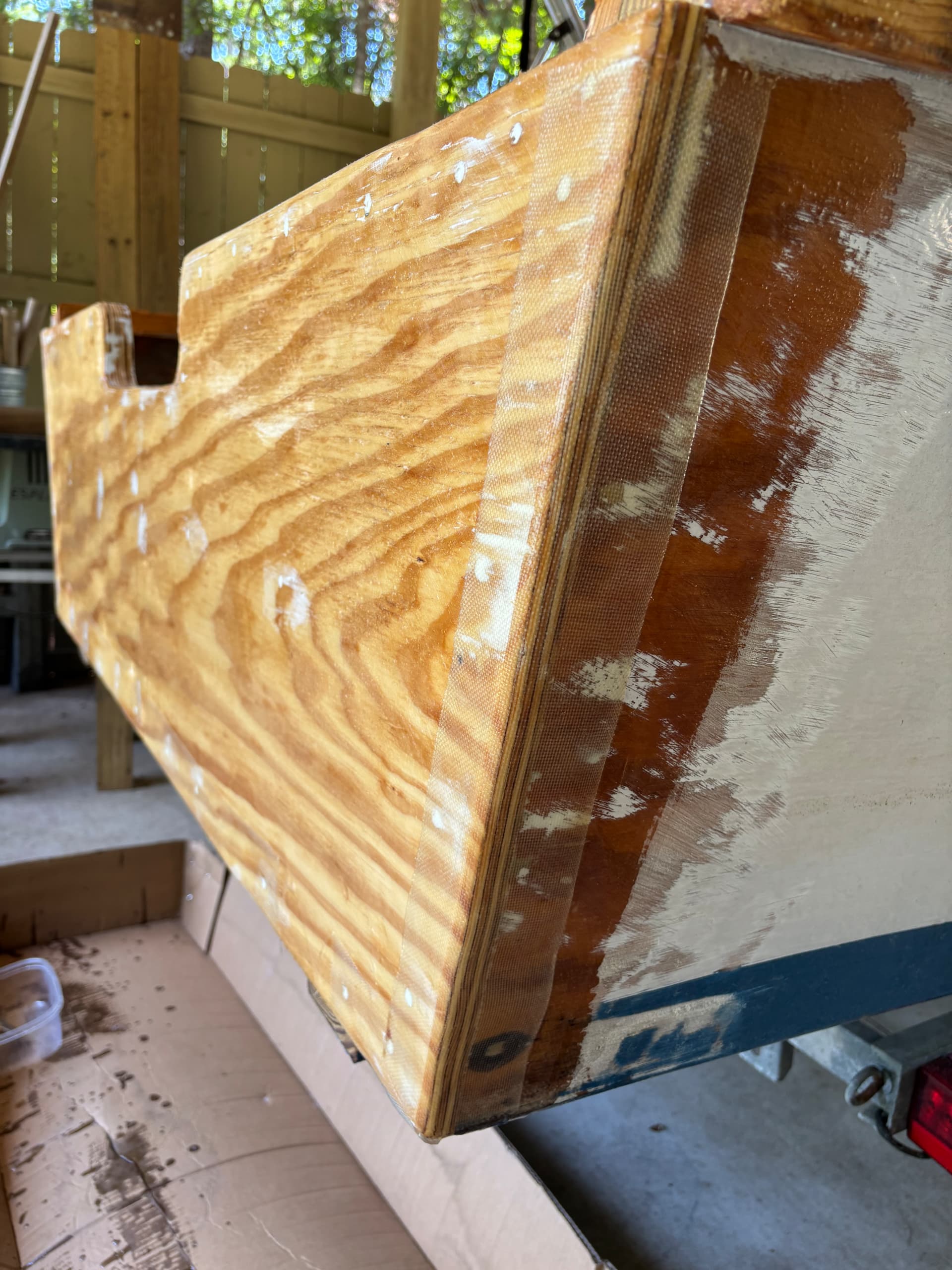

Not trying to make the purist boat builders cringe. Amateurs gotta do what we gotta do. Summer’s here and we gotta get back on the water.
Guests arriving next week so I had to place the “flat bottomed girl” into the emergency room. Transomectomy was nessacary.
![IMG_2992|375x500](upload://fD9gq2fIZT2G7hAkdn6TK
No playing around!!!
Getting it Running > Getting it Right
:rofl:

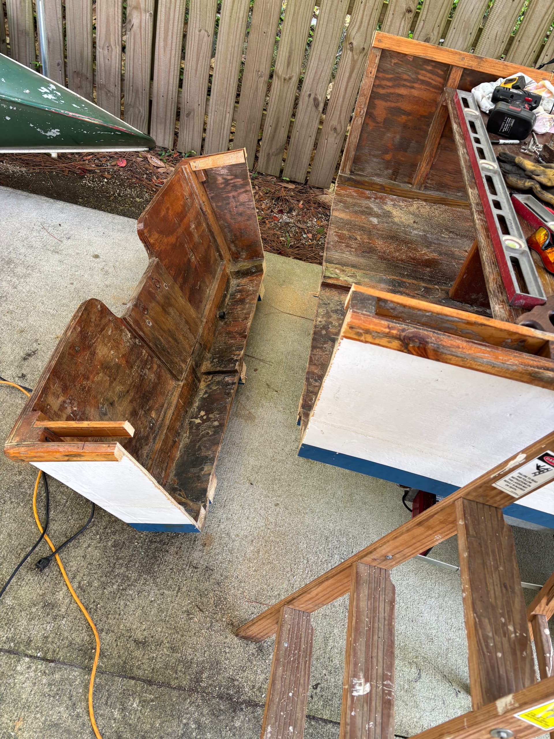

A transomectomy is probably cheaper than a welletectomy(buying a new boat)!
There’s transom replacement then there is Stern replacement :joy:.. I like your approach.
Sawz-all will travel. :rofl:
Well that was quick!
@Smackdaddy53 he ain’t fkn around..:joy:.

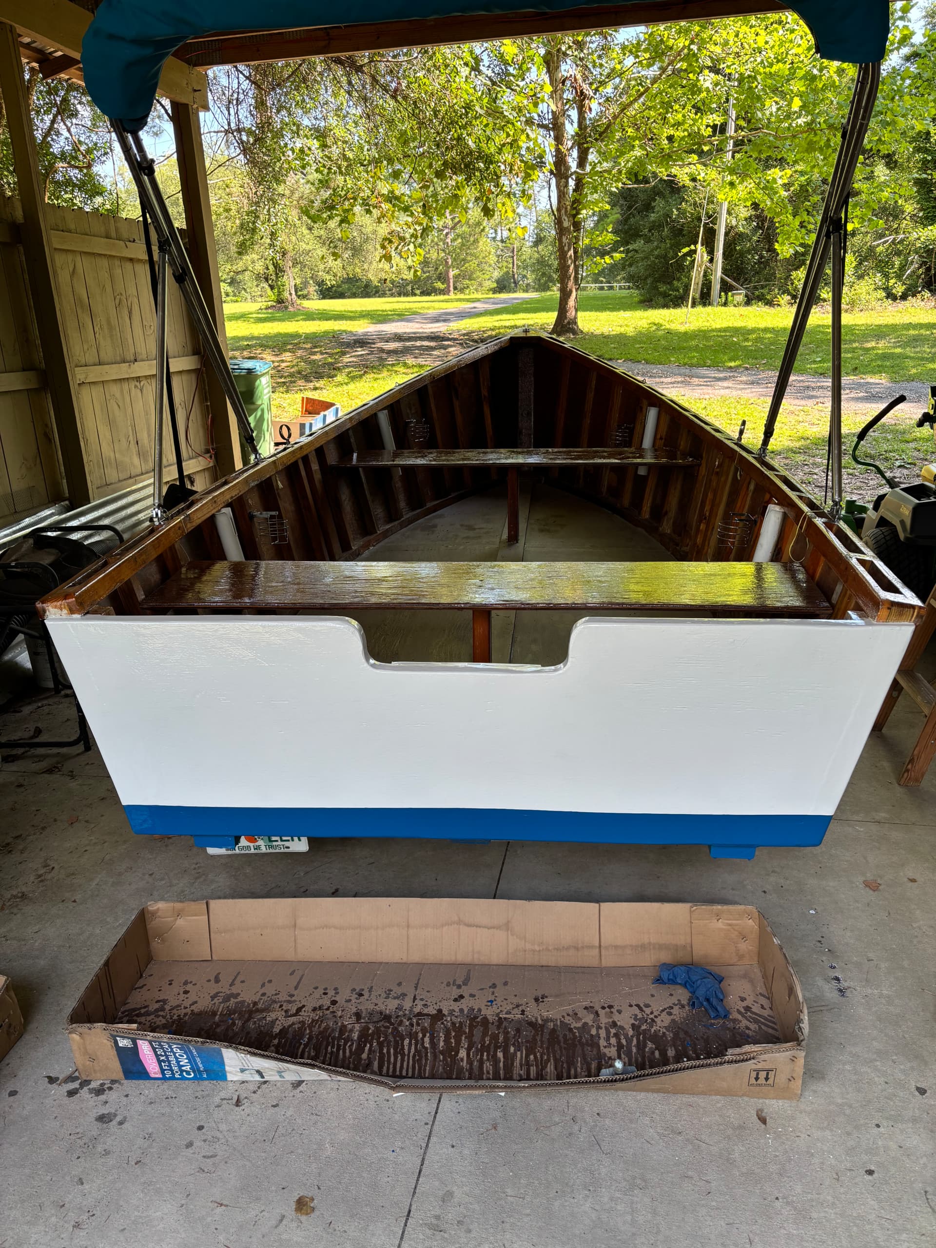

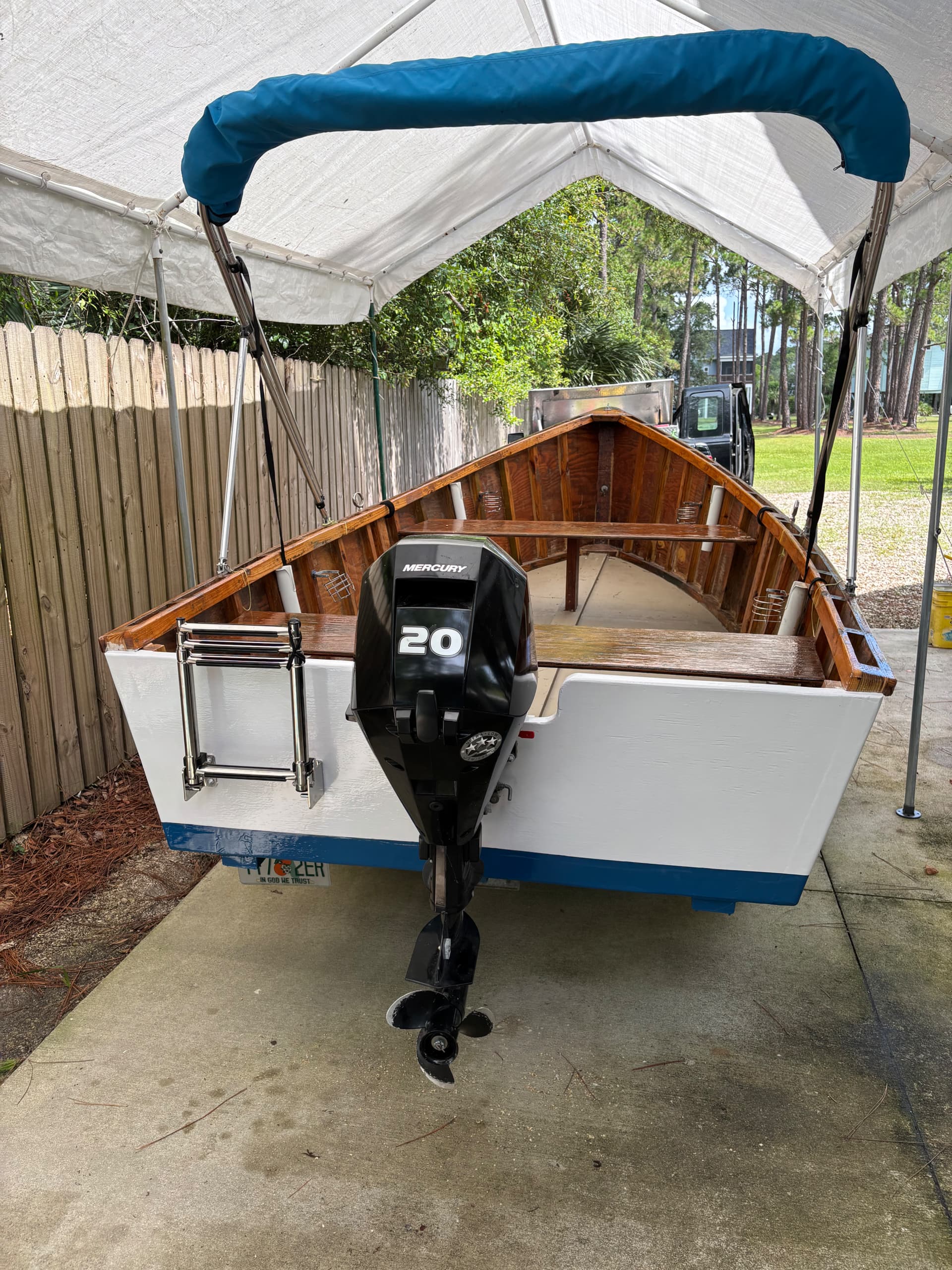

Started as a scrap construction lumber challenge, turned out to be a great family and friend project. On her 7th year.

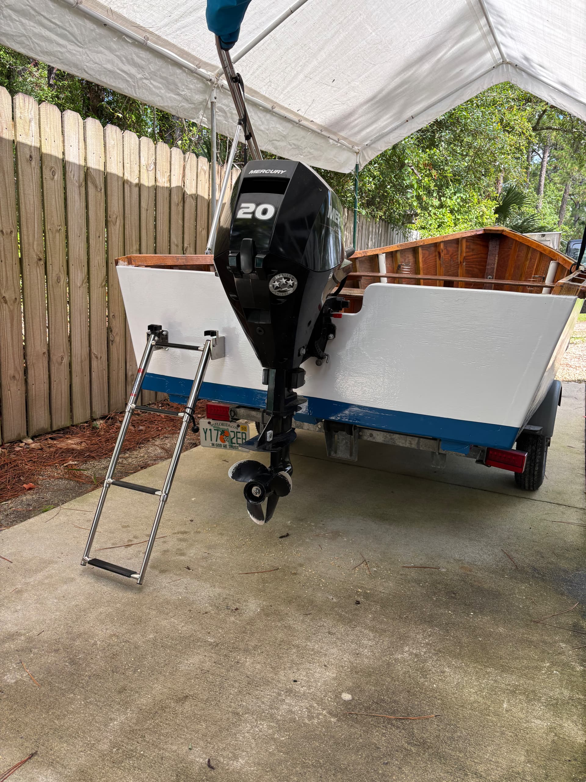

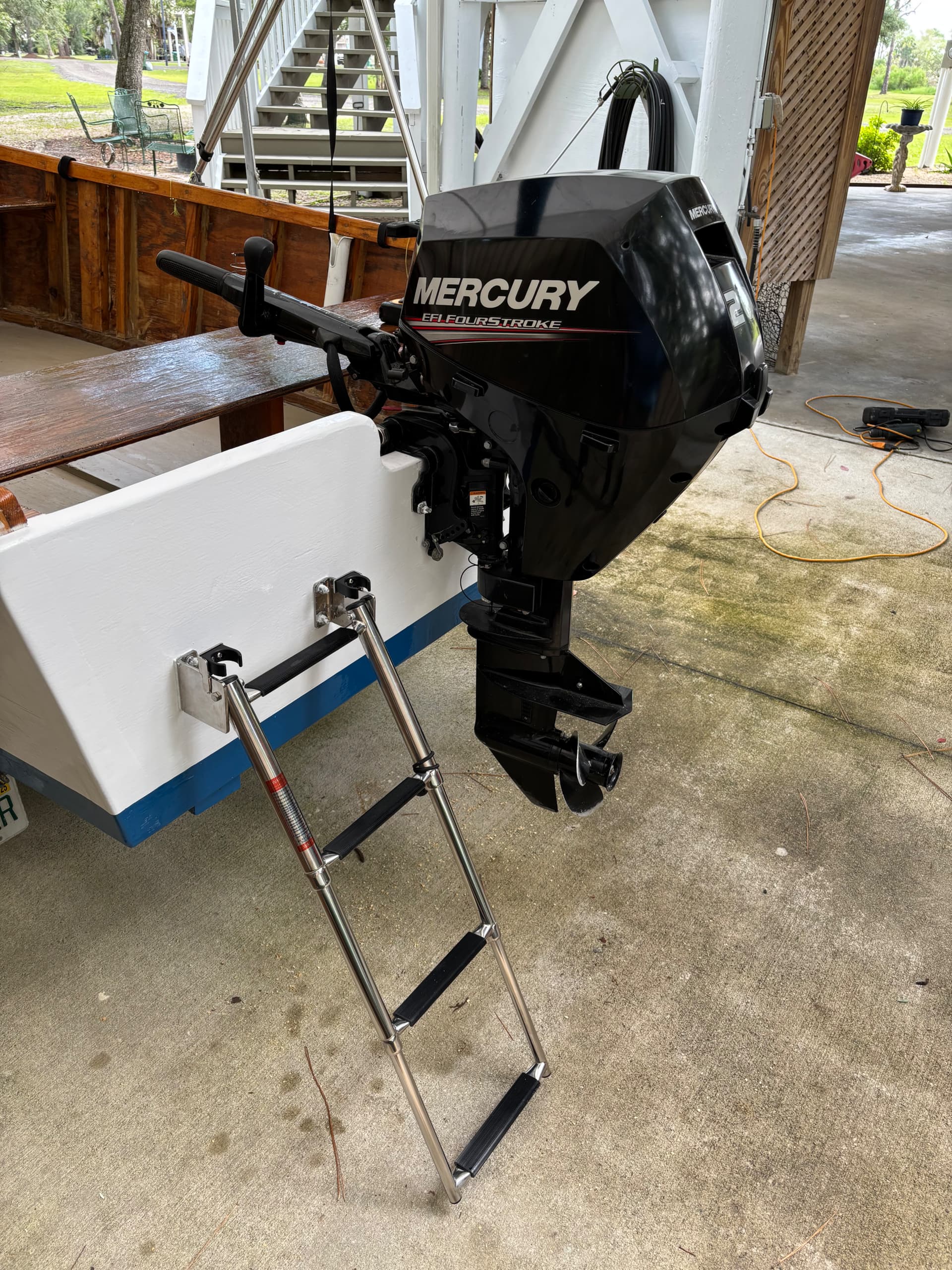

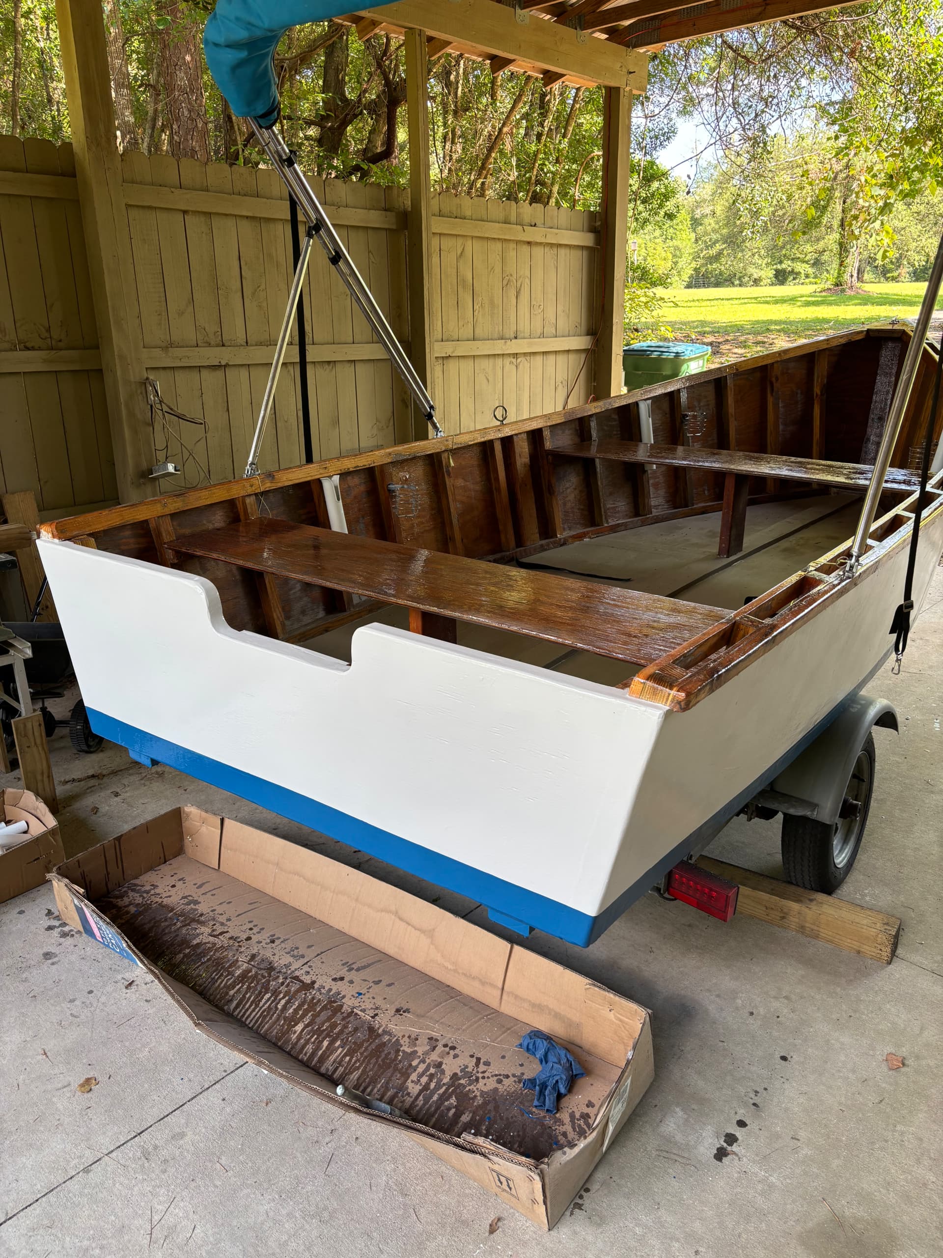

Final pics, 7 day project, about $200 materials and new ladder. :victory_hand:
Plywood boats don’t get the love they deserve. I built one similar to yours when I was 14-15 with my dad with the hope it made it through high school. 20 years later she still catches fish. Keep the leaves out of it and paint every couple of years and it’ll last 20 years no problem.

That new ass looks damn good
