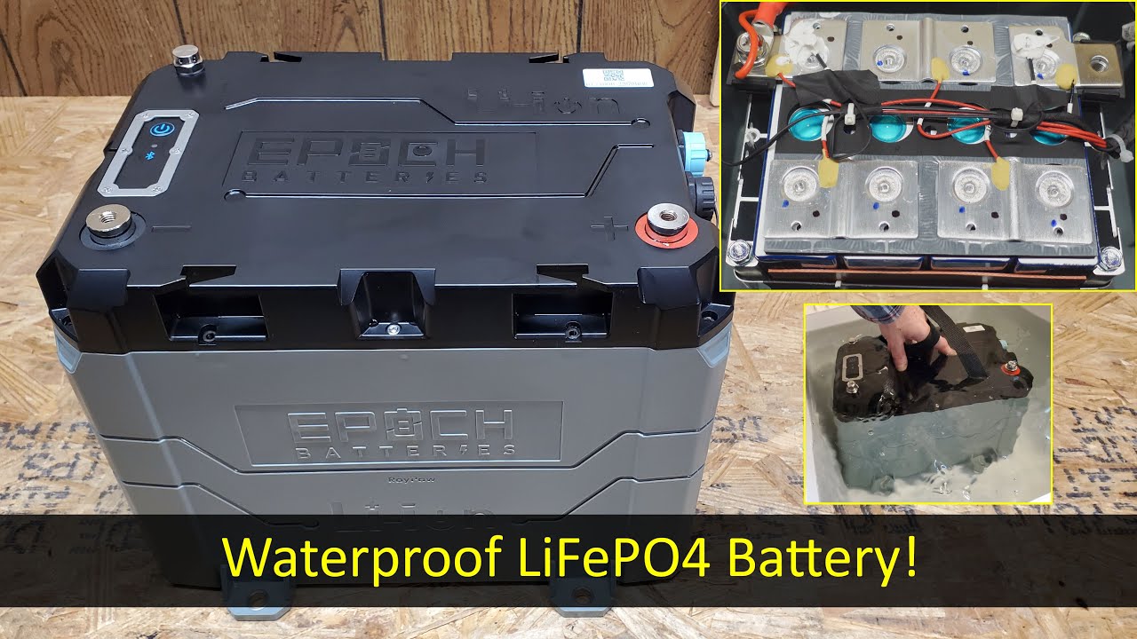

In the end, motivated by Black Friday sales I finally (with my loving wife’s approval ) bit the bullet and purchased a lithium battery solution from Epoch Batteries.
Why Epoch?
There were a couple things that swayed my decision. Most notably is Epoch’s IP67 dust and waterproof rating. In a marine application my opinion is this is a must especially for a lithium battery especially one that has an onboard BMS. (battery management system)
Build quality of the Epoch battery (Epoch Batteries is a division of RoyPow energy. Eve, one of the largest manufacturers of LiFePO4 cells, owns RoyPow) is top notch. The cell construction, packaging and weather seals differentiate it from other batteries. Check out this YouTube review by Lithium Solar.
Or read this review by Panbo Marine Technology Hub.
panbo.com
Epoch Batteries, elegant drop-in LiFePO4
Epoch Batteries’ 100-amp-hour, 12-volt drop in reviewed. Learn about the design, construction, and performance of this LiFePO4 battery
panbo.com
Purchase and Shipping
Ordering the battery and Epoch branded charger was simple and straight forward and three days later I had everything in hand.

Specifications
BATTERY CONFIGURATION
Cell Configuration: 8S
Chemistry: LiFePO4
CURRENT
Ah Capacity: 50Ah
Max Continuous Discharge Amps: 100A
Max Charge Current Amps: 150A (10 Seconds)
Max Discharge Peak Current Amps: 150A (30 Seconds)
Series | Parallel: Max (2) in Series | Max (4) in Parallel
Weight: 34 (LBS)
Dimensions: 10.2 x 10.6 x 13.2 (inches)
CHARGER
  • Voltage: 24V
  • Amperage: 15A
  • Input Voltage: 120V
  • Easy to use: Ready to charge right out of the box.
  • Plugs into standard 120V A/C outlets.
  • Ring terminals connector for output.
  • Lightweight aluminum alloy.
  • Doubles as a heatsink.
  • Up to 95% charging efficiency.
  • Overtemperature protection: Working Temperature -40℃ to 60℃.
  • Ambient temperature protection.
  • Reverse polarity protection.
  • Overcharge protection.
  • Output overvoltage protection.
  • Output overcurrent protection.
  • Output short circuit protection
  • IP67 Rated
  • Ingress Protection: IP67 Dustproof & Waterproof!
  • Shock-resistant design for storage and operation (Can be used in mobile operations such as RVs, marine applications, etc.)
IMPORTANT FIRST CHARGE NOTES
After excitingly connecting the battery to perform my first charge I learned from another Epoch battery user to NOT connect the Bluetooth Epoch App to the battery until AFTER the first full charge. Seams there is a limited risk the BMS and App will not show the correct SOC (state of charge). The resolution is simple if, like me, you happen to connect the battery BMS Bluetooth App during this period, delete the app from your phone and restart your phone. Luckily I did not encounter this issue but I followed the previous steps just incase.
