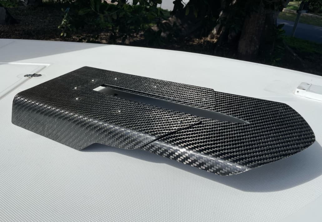

So I’ve been eyeballing this cavitation plate for my tunnel hull waterman. Has anyone pulled the trigger on one yet? What’s everyone’s thoughts on it? It’s a slightly different shape than say the transport plate. Maybe @Smackdaddy53 has seen it in action. I really like that someone has finally made a carbon fiber one for weight savings. I have a tohatsu 30hp and Foreman prop. It likes to run high on the jack plate.

Skiff Research makes this plate. It’s a nice plate, comes in a few sizes and the extreme model has the turn downs on the back portion. They’re really thin but should work well.

It will - I won’t run a skiff without one here in Texas at this point. I am on my third skiff, plate and Foreman prop. His props and plates go together like peas and carrots.

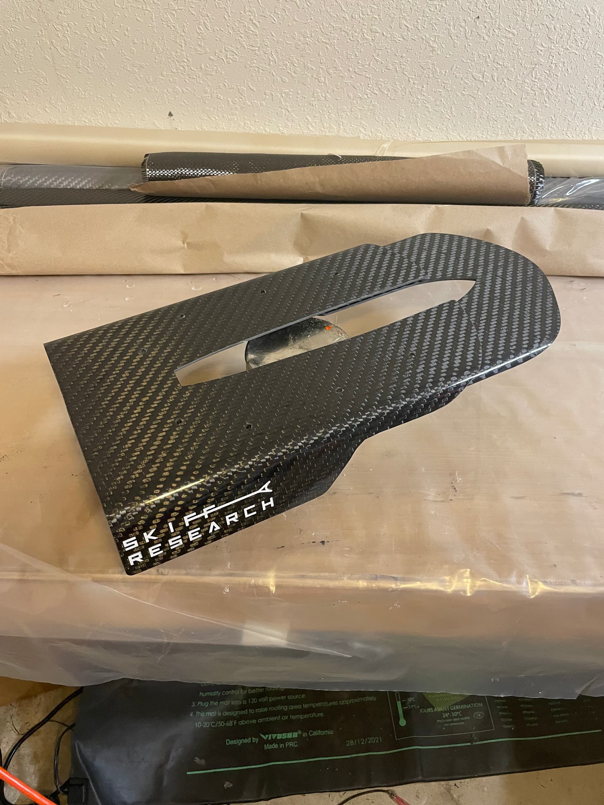

Well I pulled the trigger. I’ll do a full write up/ review when I get it. My skiff already preforms pretty well. I’m hoping for more grip while getting on plane with Jack plate maxed out. Also while running with plate maxed out. Which I already can just looking for less prop slip. Also maybe improve my on plane speed and time to plane out
TefGel Ultra in the stainless fasteners so they don’t corrode. I’d also do a mock up install with just four bolts, trace the cav plate with tape, remove the plate, apply a couple of beads of 100% clear silicone where the plate goes over the LU cav plate, let it cure then install it. This will act as a gasket and keep the plate from sliding around and you will still be able to remove it without having to cut sealant.
I do this on all compression plate installs unless the customer is adamant about a permanent install with sealant around all edges.

After having to spend an hour or more removing customer compression plates that were stuck on with 5200 I came up with the idea. It works very well.

Ready for installation…
Damn that thing is purdy.
