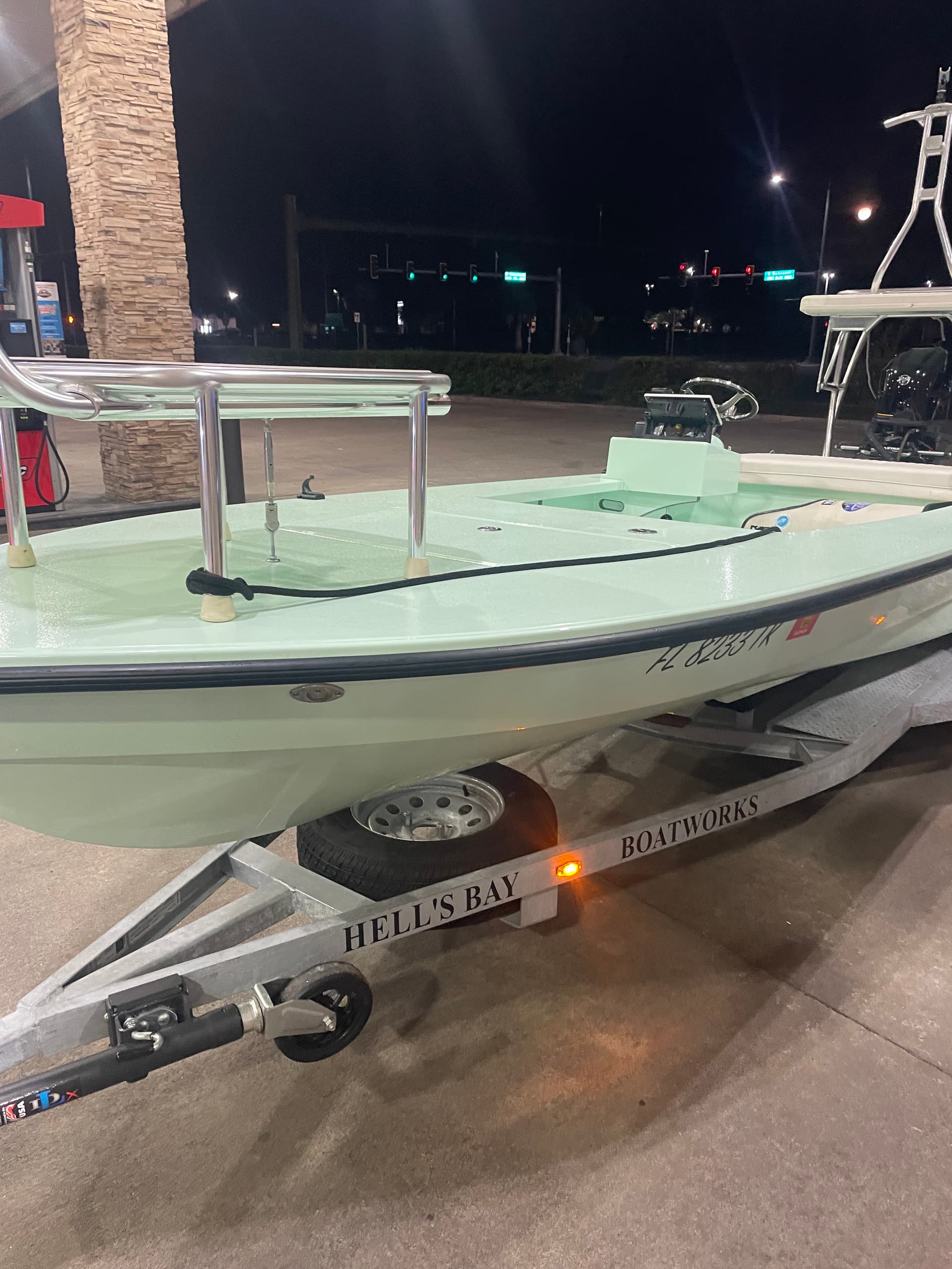

I have my bar mounted on the front of the platform and I’m poling 99% of the time. I’ve never thought it got in the way of anything I’ve done. I’m more afraid of falling into the boat than falling off backwards. Before I get on the pole, I raise my jack plate all the way and tilt the motor up just enough to wear it’s not interfering. I also have a cavitation plate on my outboard. If I were to fall off backwards, I can’t think of a situation where I would ever contact the prop.

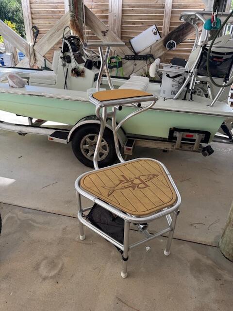

I designed this for my casting platform but I think I’m going to use it on my poling platform for staking out.
On solo days I’ll put it forward of poling platform and use a 5 gallon bucket for rod and line.
It’s going to help on those long days up top.

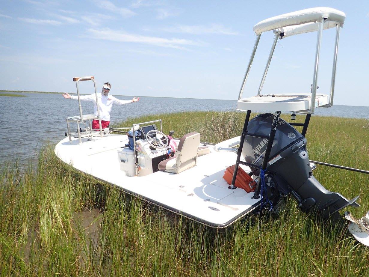

Weld it on. We have both of the platforms basically encircled like the above. For the front, we have one “chair” like design with just the back which is great for calm water. We also have one with a total circle around it for rough water so you dont fall out.

I prefer mine in front and I had it built to top out at 28" above the platform. It’s out of the way when poling and it’s just high enough to grab if I need to stabilize myself. I also like the way that New Water does their rear-mounted bar; it tapers inward to a narrow arch at the top so it doesn’t impede poling but it’s high enough to grab easily when you need to. It’s the best design I’ve seen for a rear-mounted bar.
