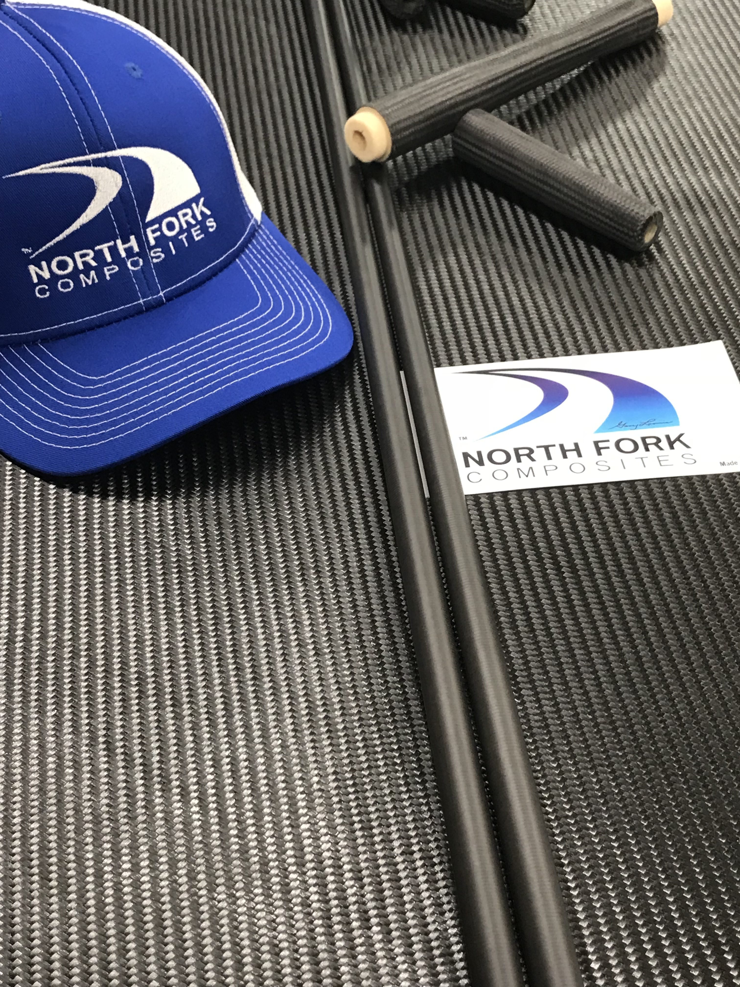

I’ve built several rods on the North Fork Composites X-Ray inshore blank and really like them. I like a 7’6" popping blank and the IS 764 is a really versatile rod - it can throw topwater plugs and light soft plastics well.

I ordered two NFC blanks on 5/5. Still waiting on them. After I ordered they said it could take up to 4 months to get them. All I can say is never again.
I’ve been wanting to try some NFC items but I don’t want to wait 4 months for a blank. Point Blank has discontinued all their previous rods and released a few new lines at cast but they are not available yet, I am interested to try them.
