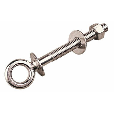

This is what Chittum uses.
Stainless steel shoulder bolt.

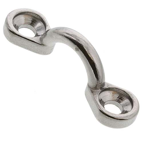

You might not need the steel version…. for many years all I’ve had on my skiff are two “tie down eye straps” in black nylon (secured by stainless screws on each end). They’ve worked just fine in very hard commercial use with leaders as heavy as 80 and 100lb mono at times. Most days the leader we’re tying lures to are only 30 or 40 fluoro… Hope this helps, mine are on each side of my skiff on the gunnels, a few inches forward of the front edge of the rear seats for convenience…. When I’m pulling on them the pressure is to the side never straight up against the screws.
Note… they also make great anchors to hang a chum bag from if desired (something I might do very occasionally…
That’s what’s on my Gordon. It’s my favorite accessory on the whole boat.

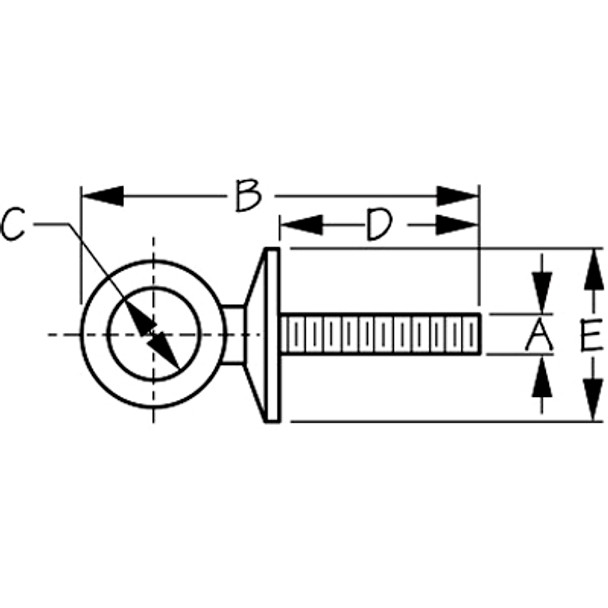

Which size is preferred? A =
6-mm-1mm
8 mm-1.25 mm
10mm-1.50mm
Edit: Never mind, just saw you posted 8 mm. Thanks
