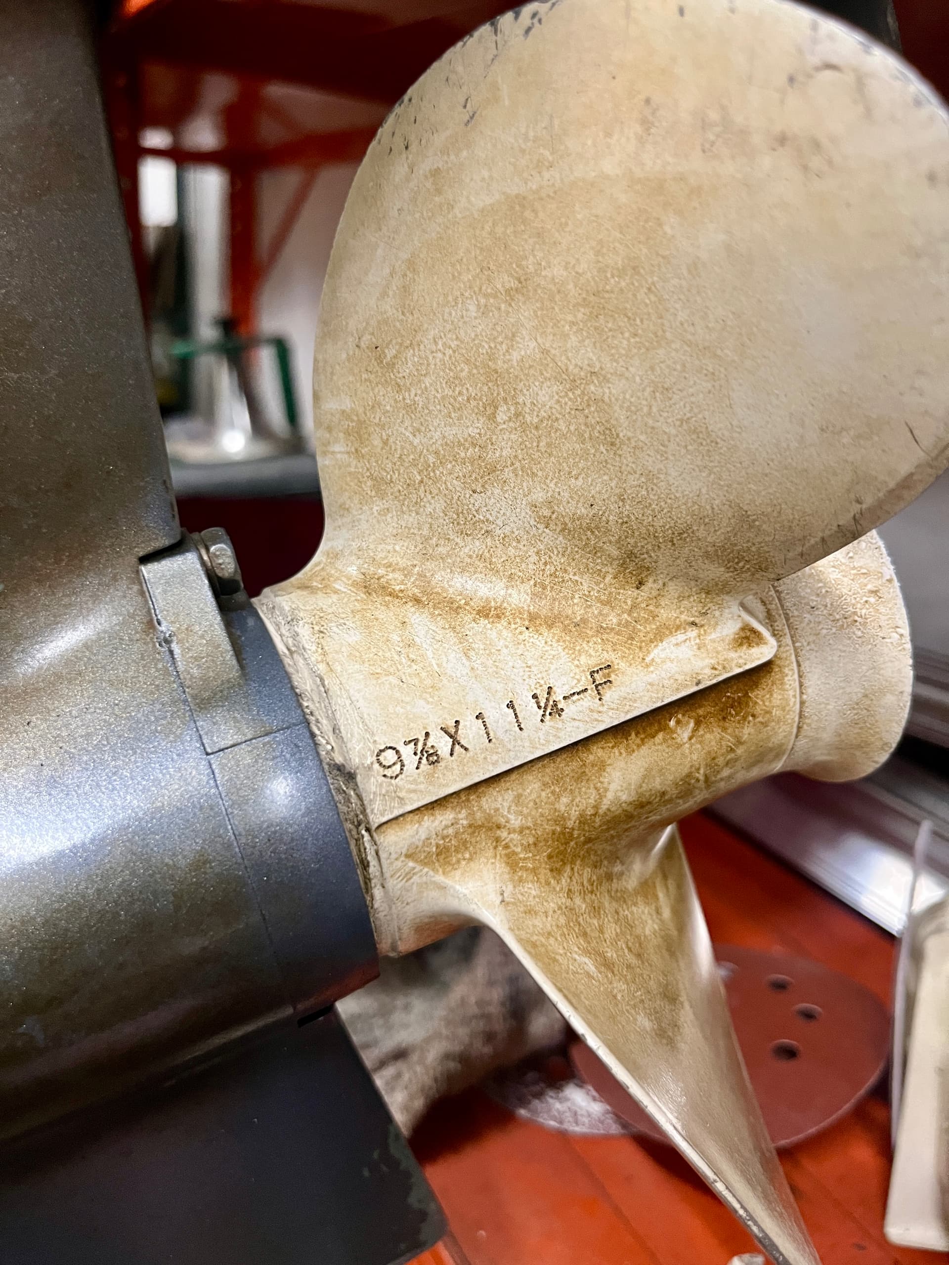

Here is the prop thats on the motor now and what you’re all telling me, this might not be the original prop. What would be the 'general characteristics of a 9-7/8 x 11-1/4 prop? I have no idea what the F means…maybe it’s just the series of prop?
So where would you start on a 25hp Yamaha 4 stroke tiller. No tach. Just match what’s already on there?

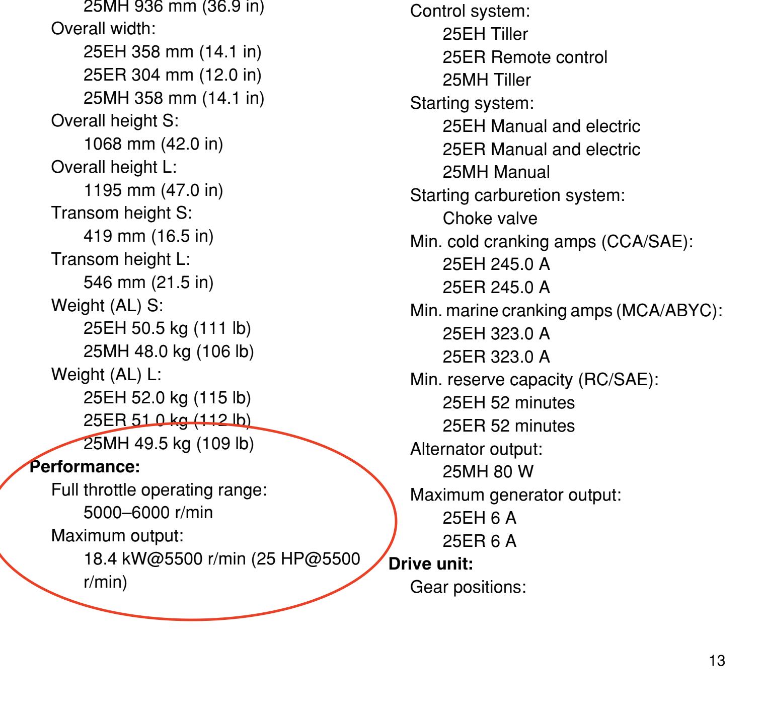

You should be able to throw out some of the goofy numbers because of what the engine sounds like and what the rpm range for the motor is. If you are hitting the rev limiter, you rpm shouldn’t be 3000. You probably won’t go over 6500. A lot of the time the goofy number is half of what it should be. Check the settings. Make sure the pigtail is wrapped around the plug wire well.
Get some good rpm numbers, get a gps speed from your phone app or chart plotter and maybe time how long before it planes?? Call PT or one of the other contacts and let them guide you. They may want to know how long the boat is, what type hull, the existing prop and maybe the weight of the boat. A ss prop will affect the pitch needed and a 4 blade will affect the pitch needed. Don’t just go buy a prop when we have experts that will give you lots of information for free that can save you bundles.
You can definitely do better than that prop if the goal is to get the motor higher.

28/29mph is perfect at that RPM for a 25hp. I believe 6k is max for that engine so 5950 is right on the dollar.
Keep in mind, that You’re always going to have fluctuations in speed and rpm because of winds,tides ect.. If you wanted a little more Rpm you can drop one pitch, which will give you a tad quicker holeshot, and roughly 1-200 rpm more.
