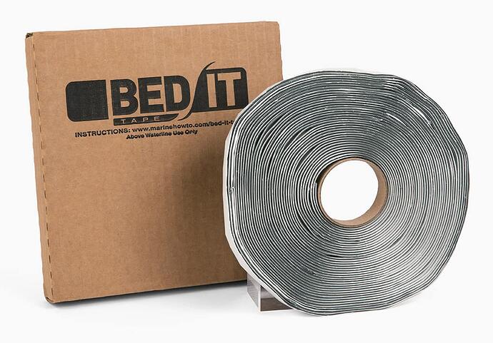

Here is another option I just used on my push pole holders. I like it because its easy to remove and it lasts a long time.
Will be using it when I remount my Poling Platform in a few weeks.
