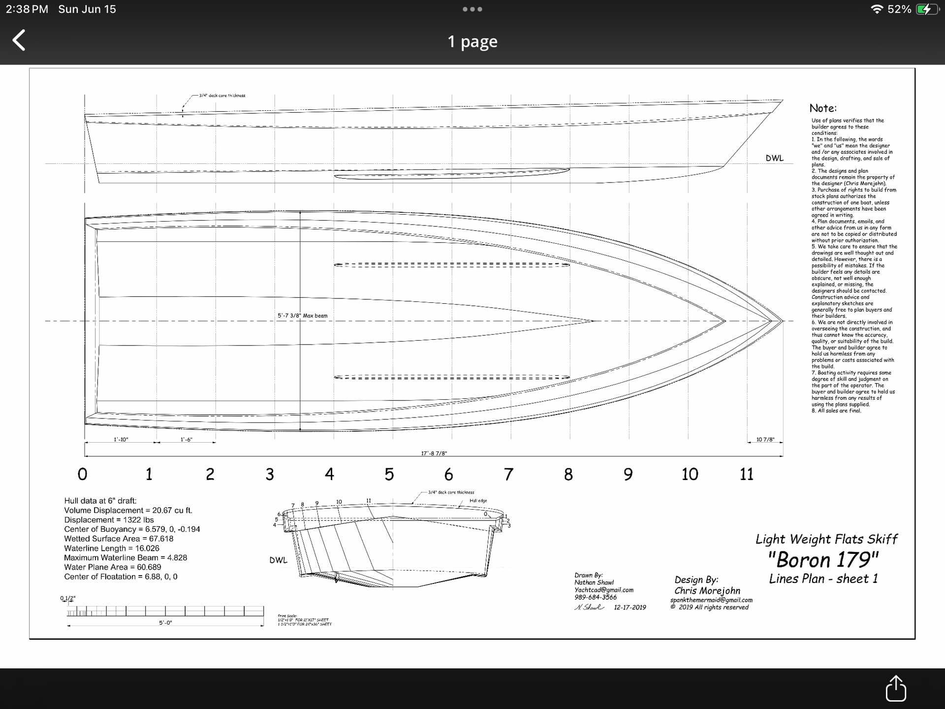

Just don’t add the upper spray rail. Continue the hull side up to sheer height. Simple hull as you can get to build other than total flat bottom no chines.
Thanks Chris! I was hoping you would add some feed back. What is the best way to purchase your plans?

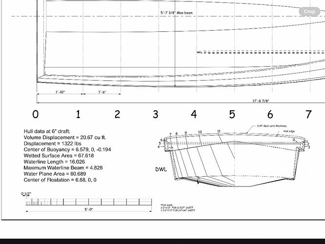

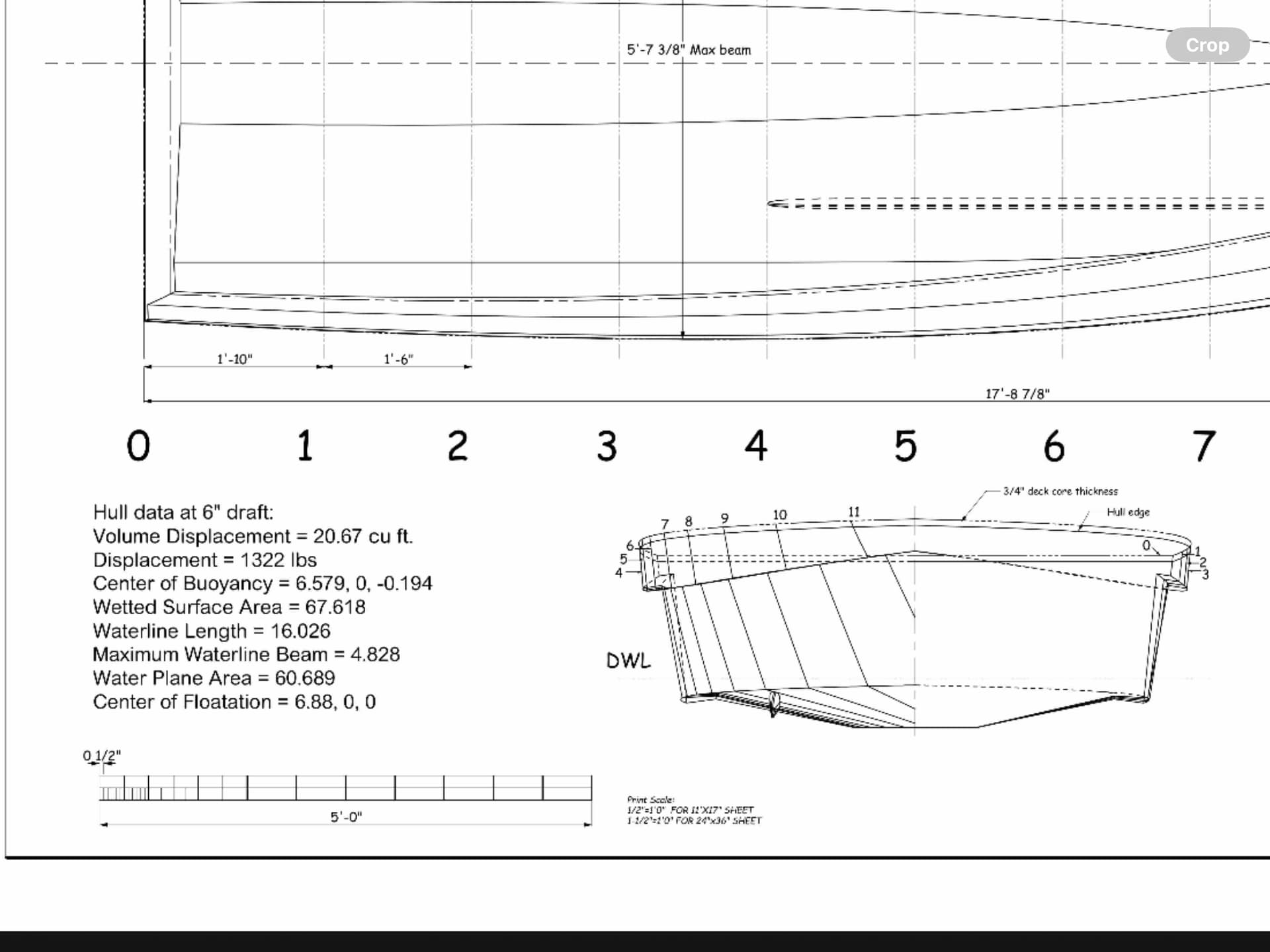

Reach out to Nathan Shawl. His name and email are on th bottom left hand side of the image that Chris posted of the Boron.
Chris Morejohn’s plans are the only ones you need!

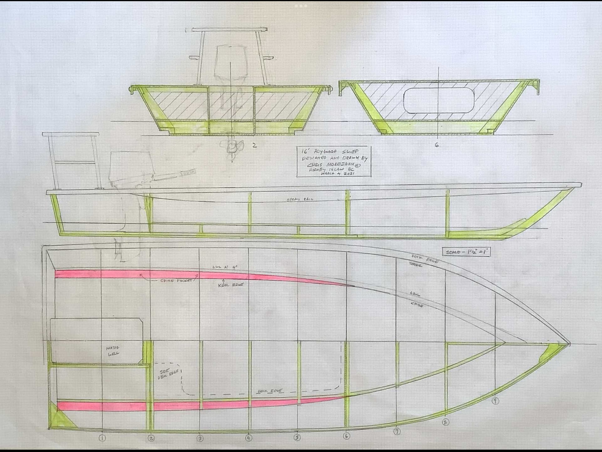

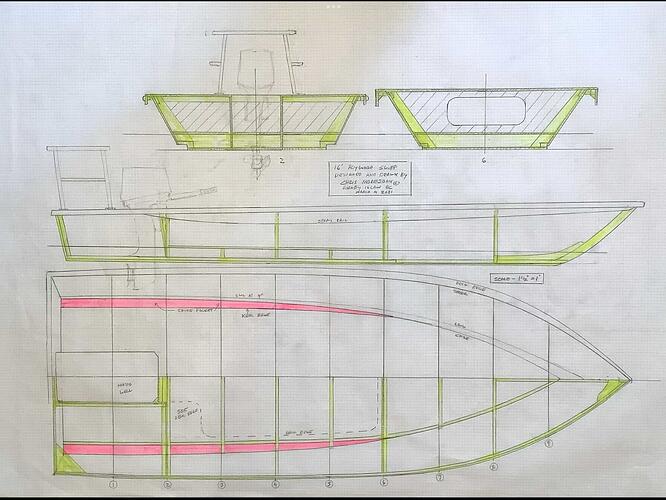

Here’s the simplest design to build.
This hull shape built in ply will float within 1” of Chittum challenger all carbon hulls. Will feel better though under foot.
I really like your plans in plywood. Everyone seems to build core. Didn’t think I would build another boat but maybe something as light, shallow and stable as my little scooter but could be poled in a straight line and a bit quieter.
Chip
Yes, nothing wrong with plywood, and its quicker to build. Just wont look quite as bristol as a nice fiberglass boat with rounded corners.
