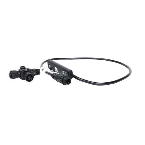

Re fuel burn - I would think you would be able to show that since it is real time data. On Simrad, I have to start a trip (specifically select this) for the value to be calculated correctly. In addition, I use a fuel data manager from Simrad that stores all the fuel data in memory. Link below for reference so other Simrad users can find it.

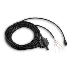

For Garmin, I did some searching and found this:
But I can’t say it is what you need for your combo of engine and GPS. My experience is Tohatsu and Simrad. Eric and Goldenchannels might be good to talk to on this one.
Simrad fuel data manager
Lowrance lists the same p/n for that part. I’ll have to look up install as fuel burned in a trip would be helpful.
