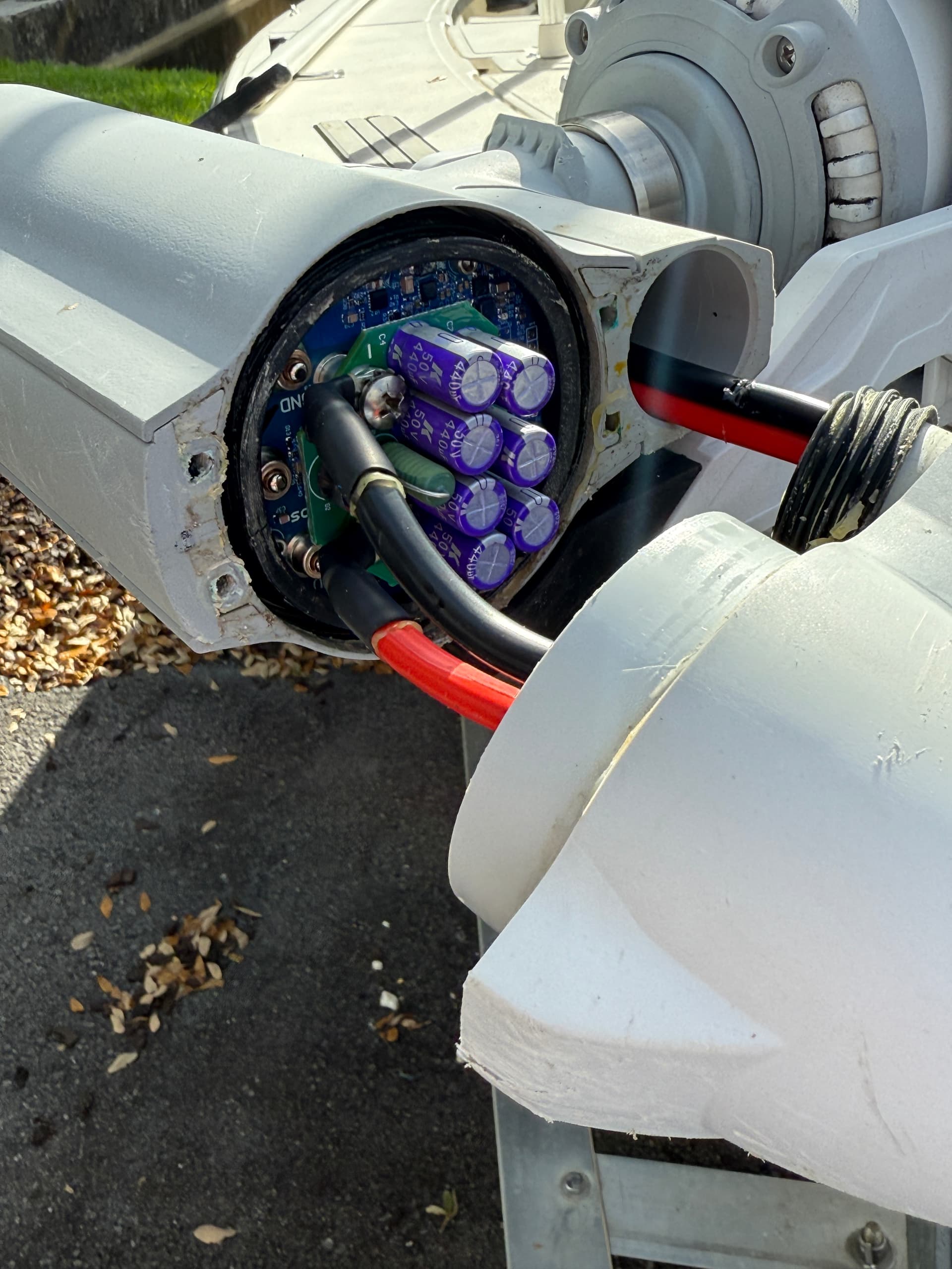

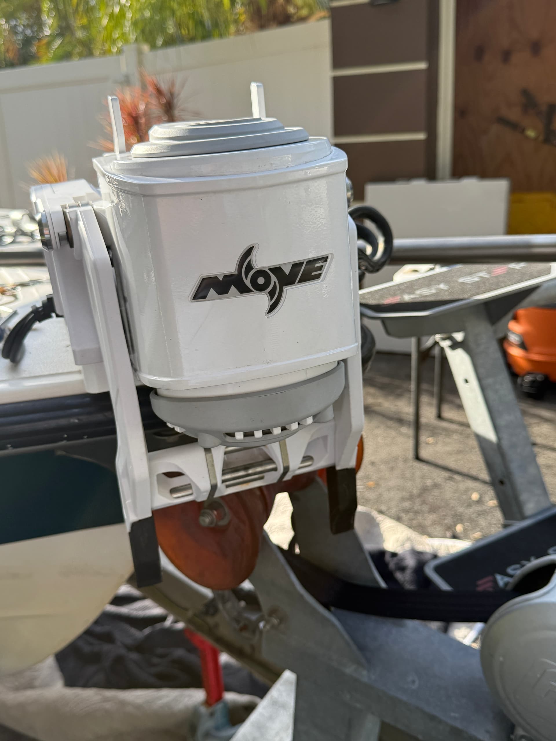

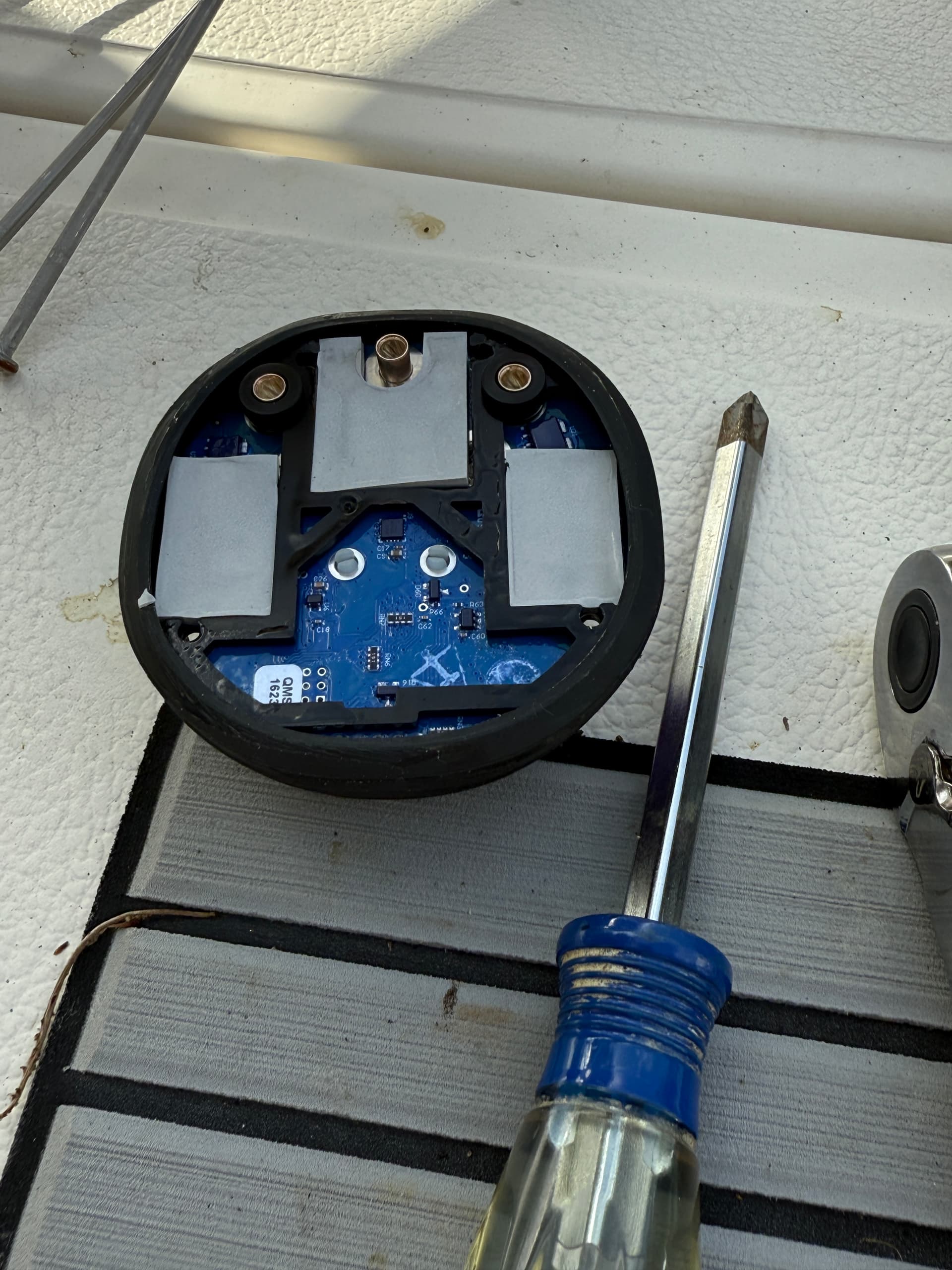

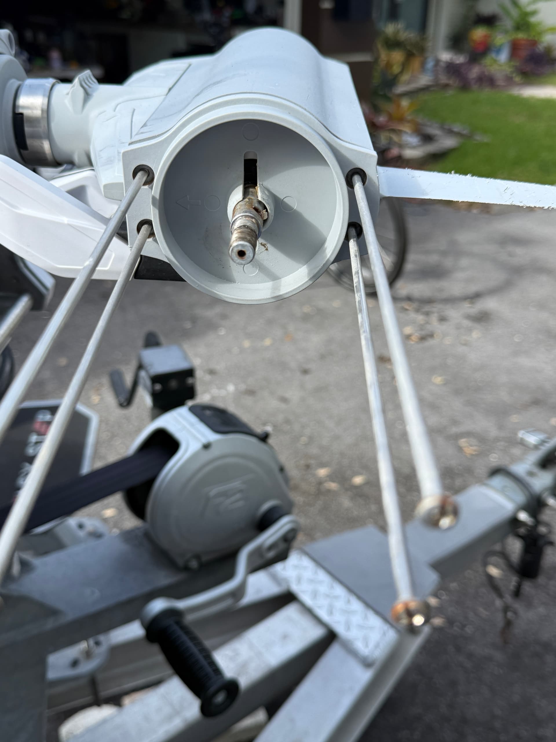

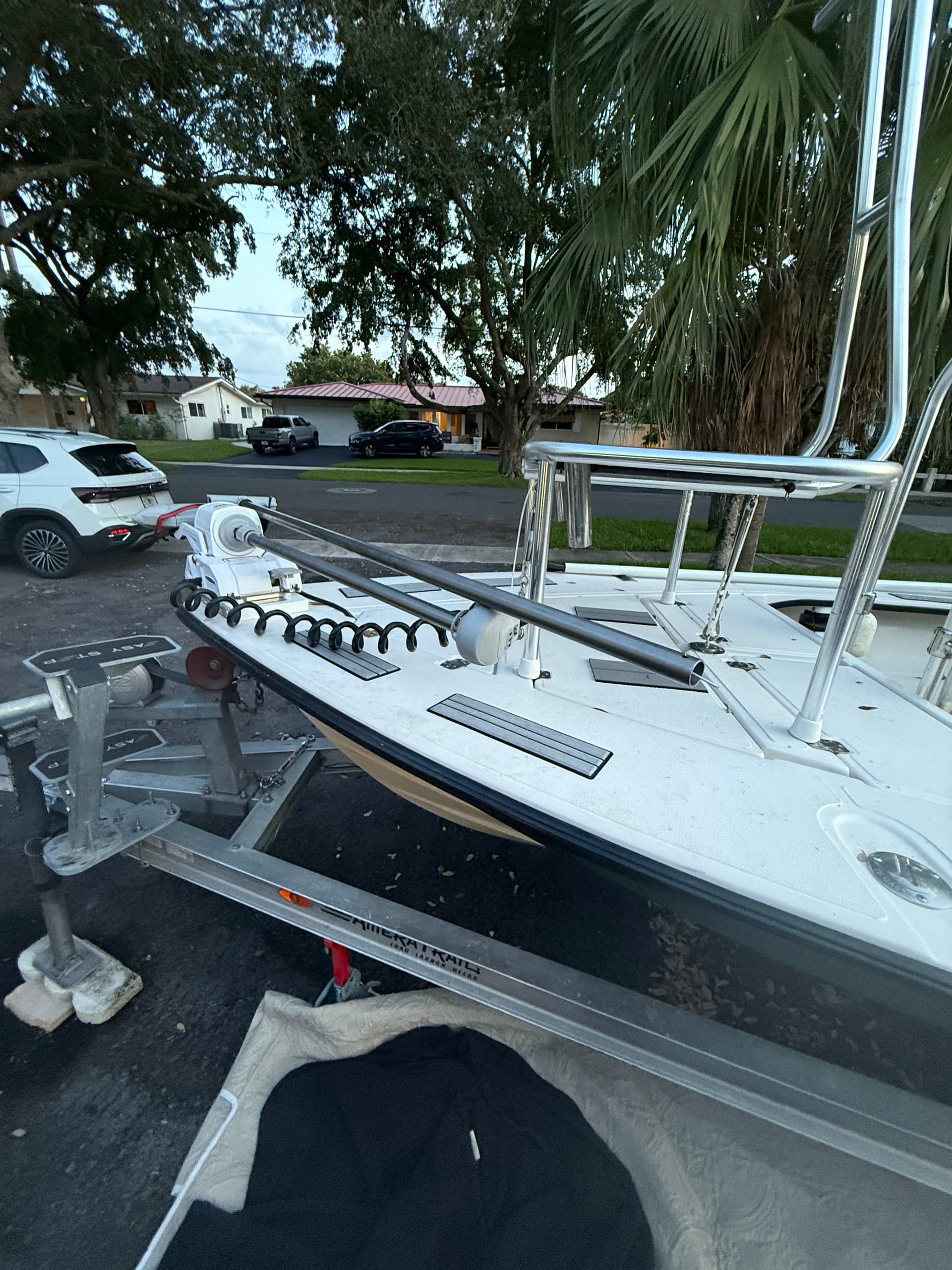

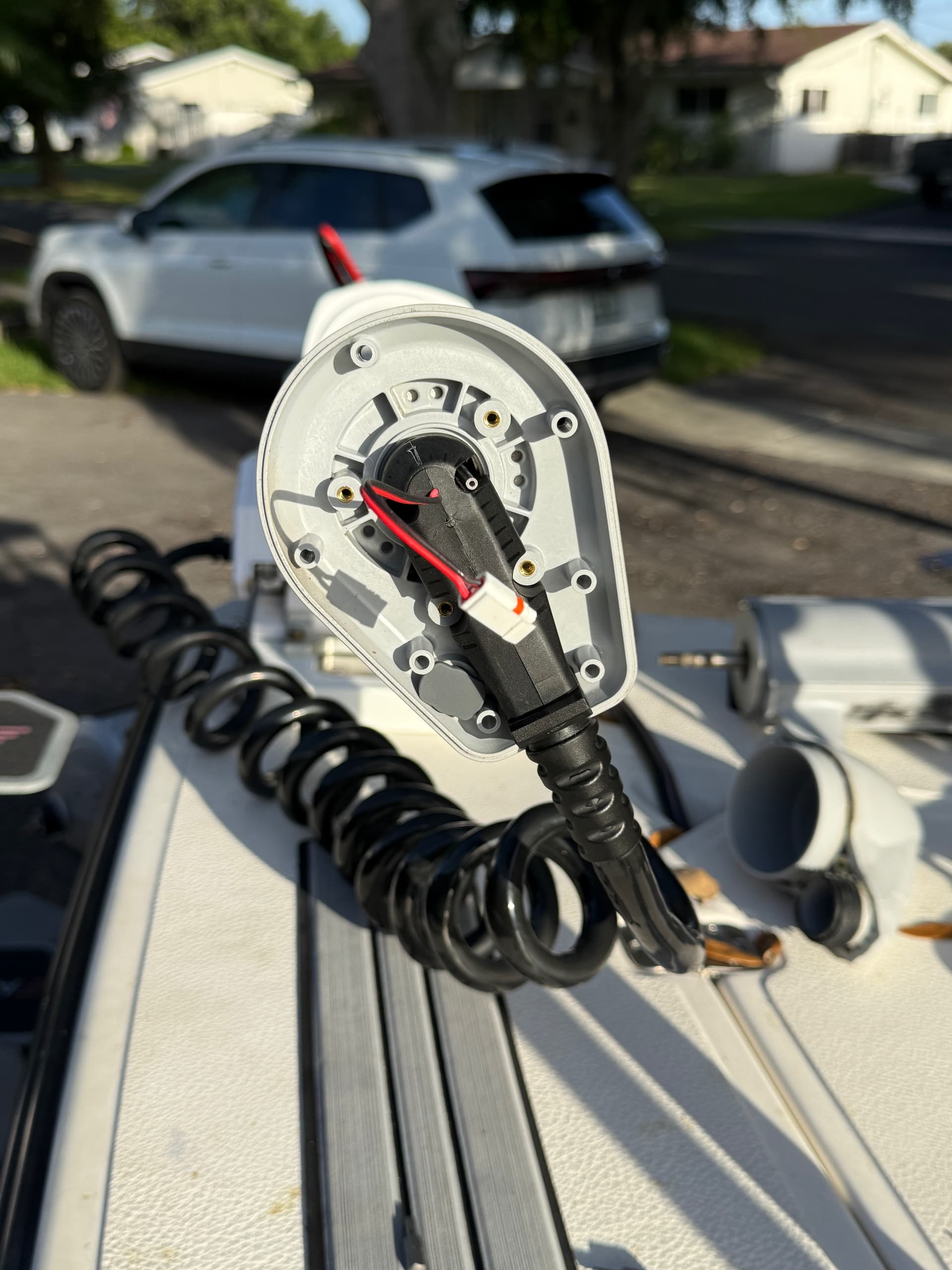

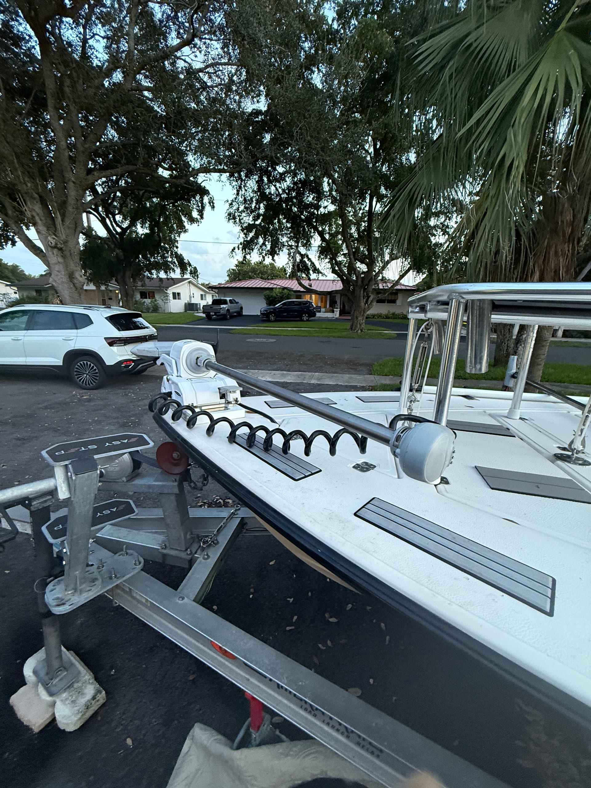

Here are some pics of what’s inside…
difference …one of the things I didn’t account for, while the shaft is 45" to the bottom, the head unit and prop are another 12" from the bottom of the shaft…
