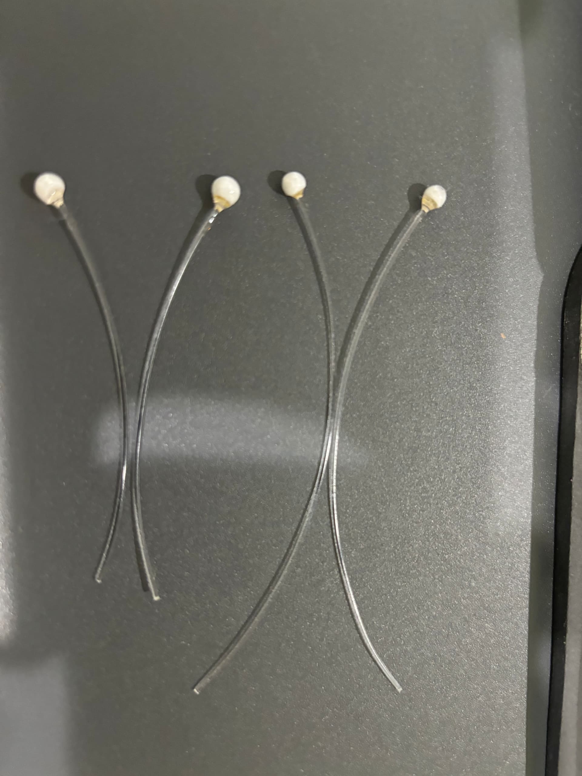

30#-50# test, lighter to flatten one end, glass bead from hobby store(black or orange), then coat with UV.

Following. I’ve made them by dipping in UV resin and curing. Repeat dipping until you have the size you like. Keep it turning in your fingers so they come out uniform as you cure. Works ok.

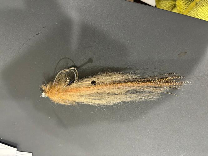

Only use them on two flies, Redfish Crack, and Shrimp Gurgler. The Gurg is best with 60lb mono eyes , very easy to make big eyeballs with 60. They stabilize the shrimp on the surface. Crack flies are inspected by Redfish, so I believe they need the eyeballs…probably not.

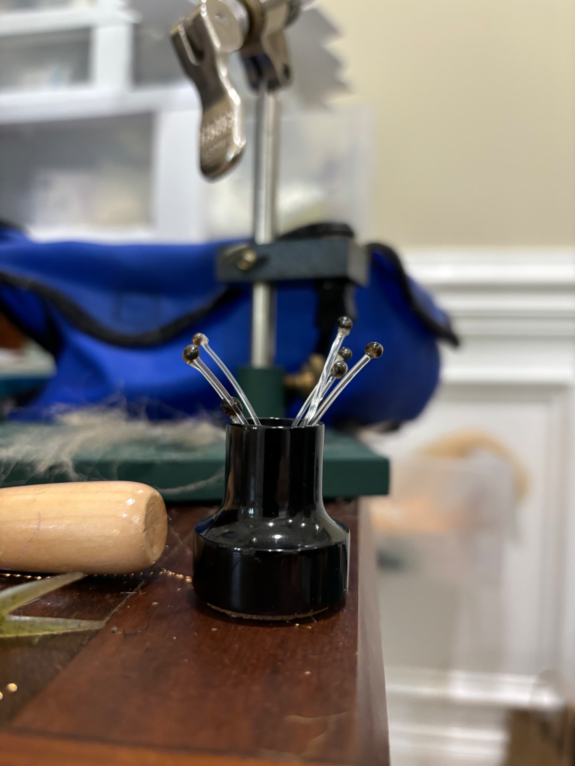

As mentioned above, tiny glass jewelry beads as a translucent pupil and UV adhesive for bulk make for some gorgeous mono eyes.

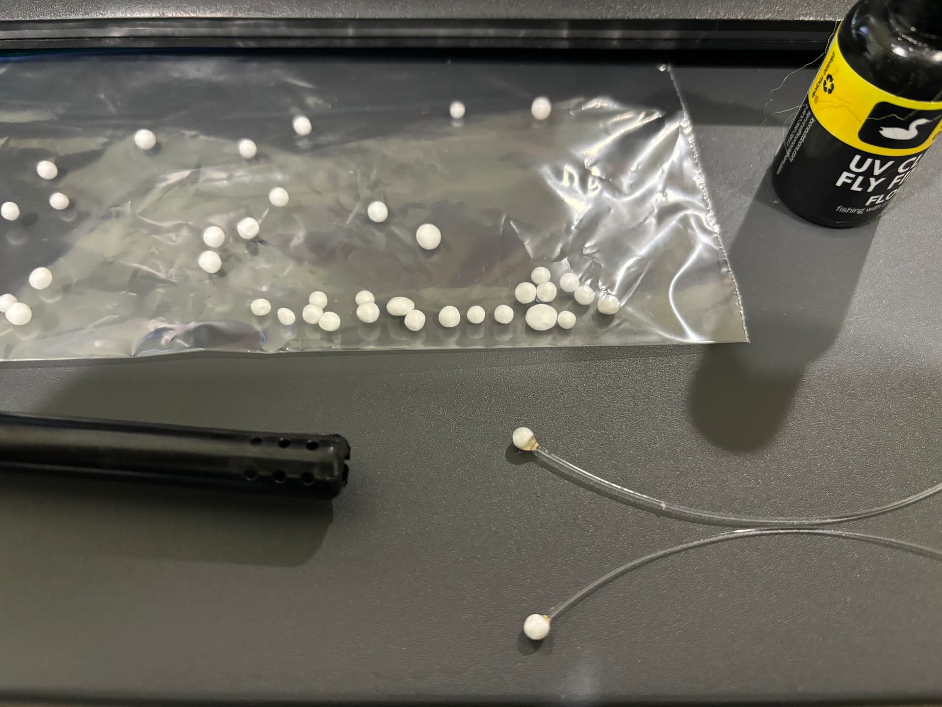

This thread has had me thinking. I saw reference to using glass beads and that seemed really heavy. For gurglers or floating flies, I started wondering about using foam for eyes.
I had to refill a couple bean bags and remembered that the “beans” were timy foam balls. Eureka!
It took a little experimentation, but I was able to melt the 60#mono just enough to bond with the foam ball without melting or deflating it. A light coat of UV flow and the eyes turned out really nice!

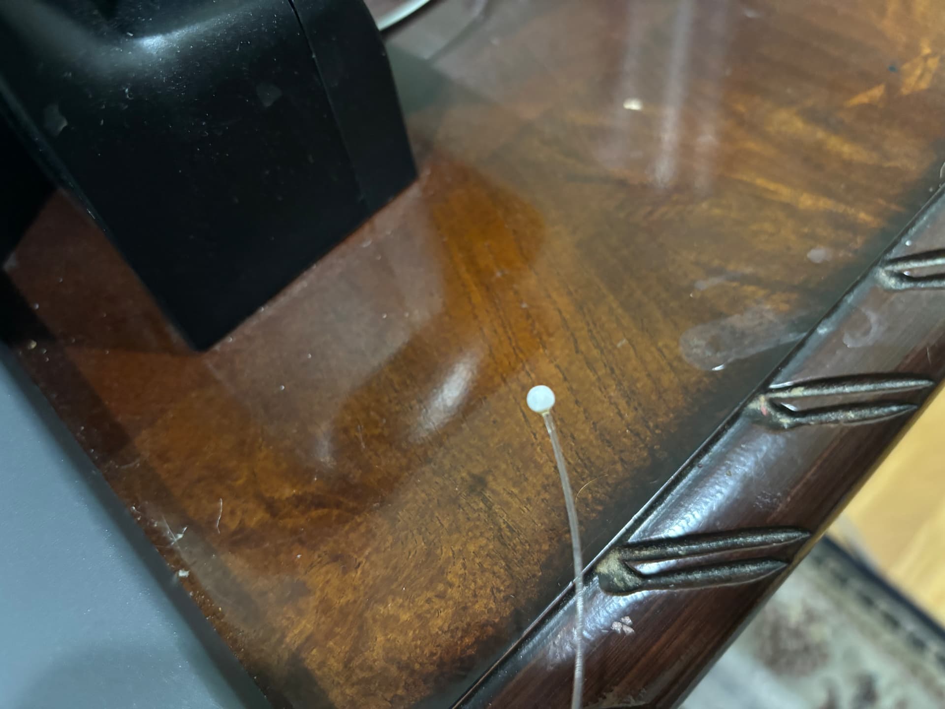

I use 30lb cheap mono so it’s a little thicker. Hold a lighter just close enough for it to “roll” on itself just barely. Really just creates a better bonding point for UV cement. Then I apply loon UV brown epoxy and hit with the UV light. Then add another coat or 2 of cement and repeat with the light. For how long it takes me to tie some patterns I really hate making eyes myself. I agree that they probably are not needed but I think it helps a fly ride more “true” and with gurglers I definitely feel this way. I found some on ebay in packs of 50 for relatively cheap. Planned on ordering some this week to try out (Crab And Shrimp Eyes Fly Tying Materials 50Pcs Per Pack | eBay).

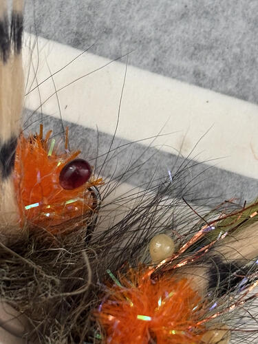

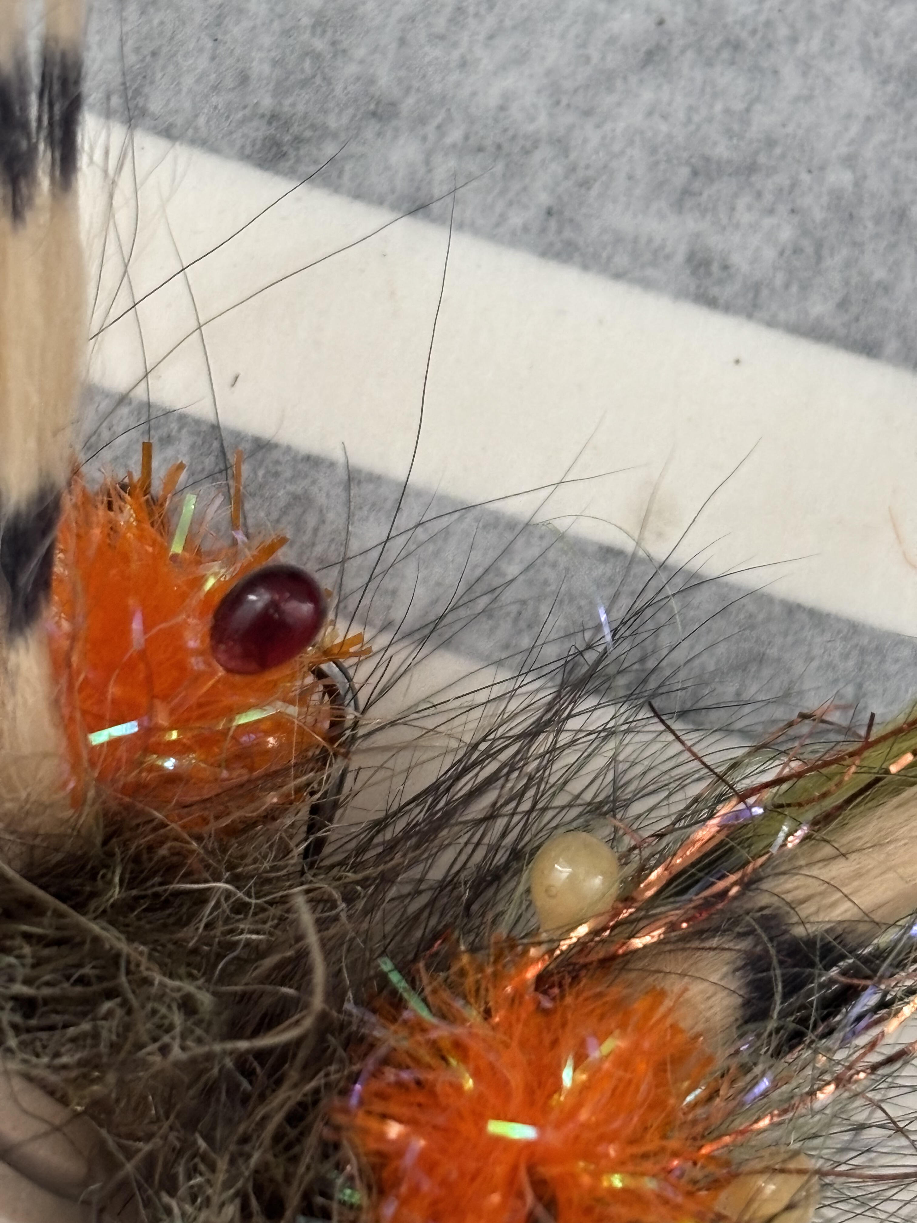

I was tying this weekend and made a few eyes while I was tying when I ran out of store bought eyes. Left is one I made, right is from Hareline.
