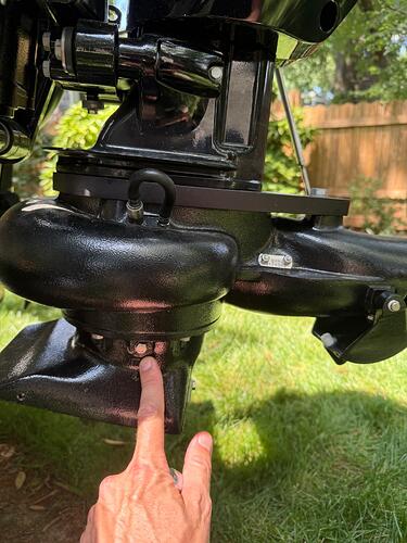

Still feeling dumb here… the bolt I am pointing too in the pic? Doesn’t seem large enough and is on both sides. I’m hesitant to start unbolting random bolts that don’t seem logical.

Negative, that bolt holds the impeller liner in. I’m not seeing the flush port on yours though. It is typically right there where the grease port is maybe slightly higher. Check the other side in that location, maybe they put ig there due to clearances on the small pump.

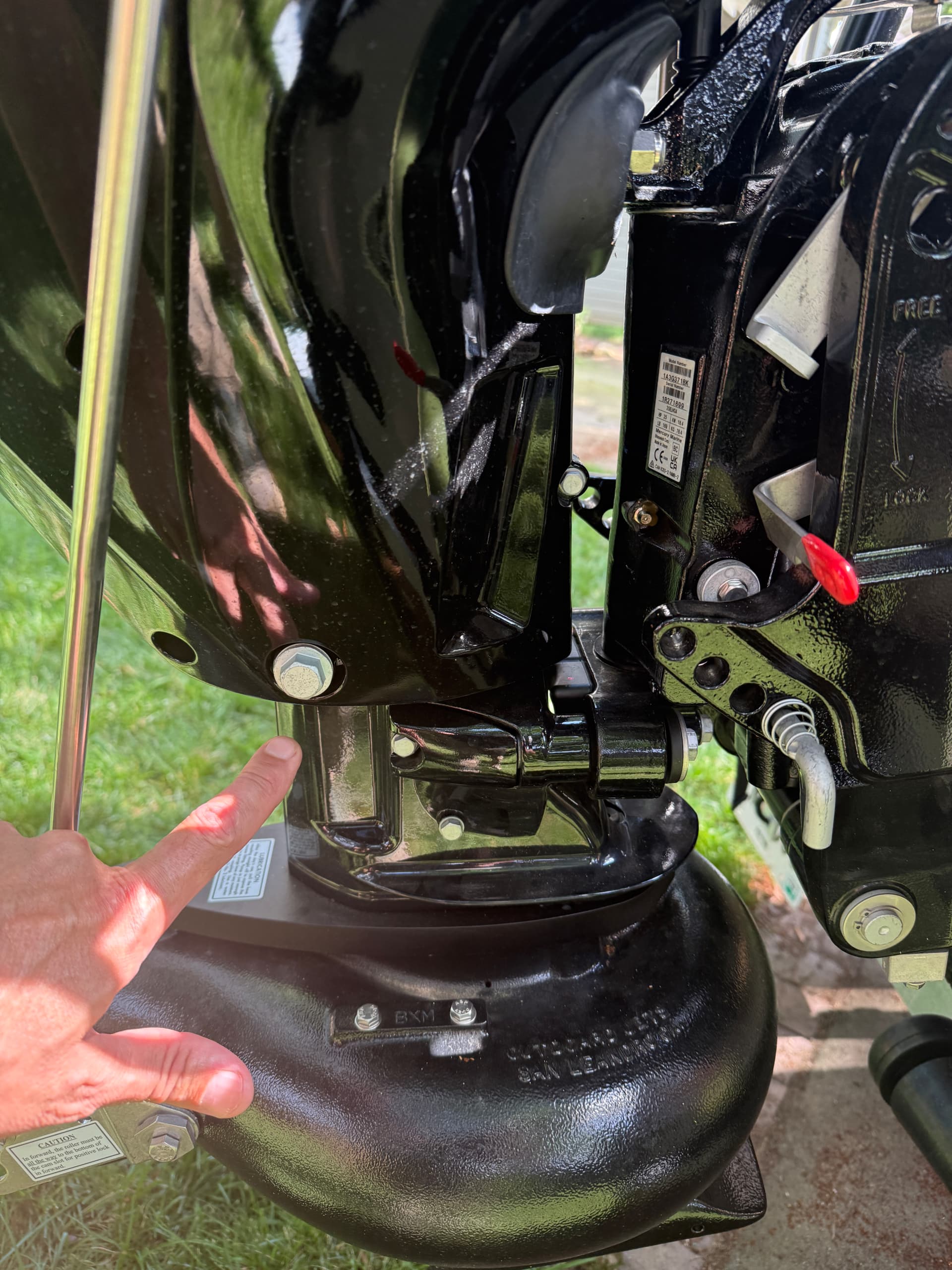

Here’s a pic of the other side. My manual says the bigger bolt I am pointing to is the oil drain plug. I don’t see any other possible flushing bolts.
After lots of searching, I think I found the answer… Finally watched this video in it’s entirety https://www.youtube.com/watch?v=5MGV5imIb5Q (I initially wrote it off bc it wasn’t a merc) At about the 3 min. mark he talks about how small pumps do not have a fitting for flushing. He suggests you can drill and tap in a fitting… So incase anyone is wondering, a Mercury 25 jet does not have a flush port. Luckily, my motor only has 2.5 hrs- all in fresh water. I bought this boat with the intention to sell/ swap this motor for a prop since we will be using it in saltwater and a prop better suits our needs. I won’t be attempting to drill and tap in my own fitting on a basically brand new motor. Hopefully this hard to find fact helps someone who may be considering a Mercury jet.
