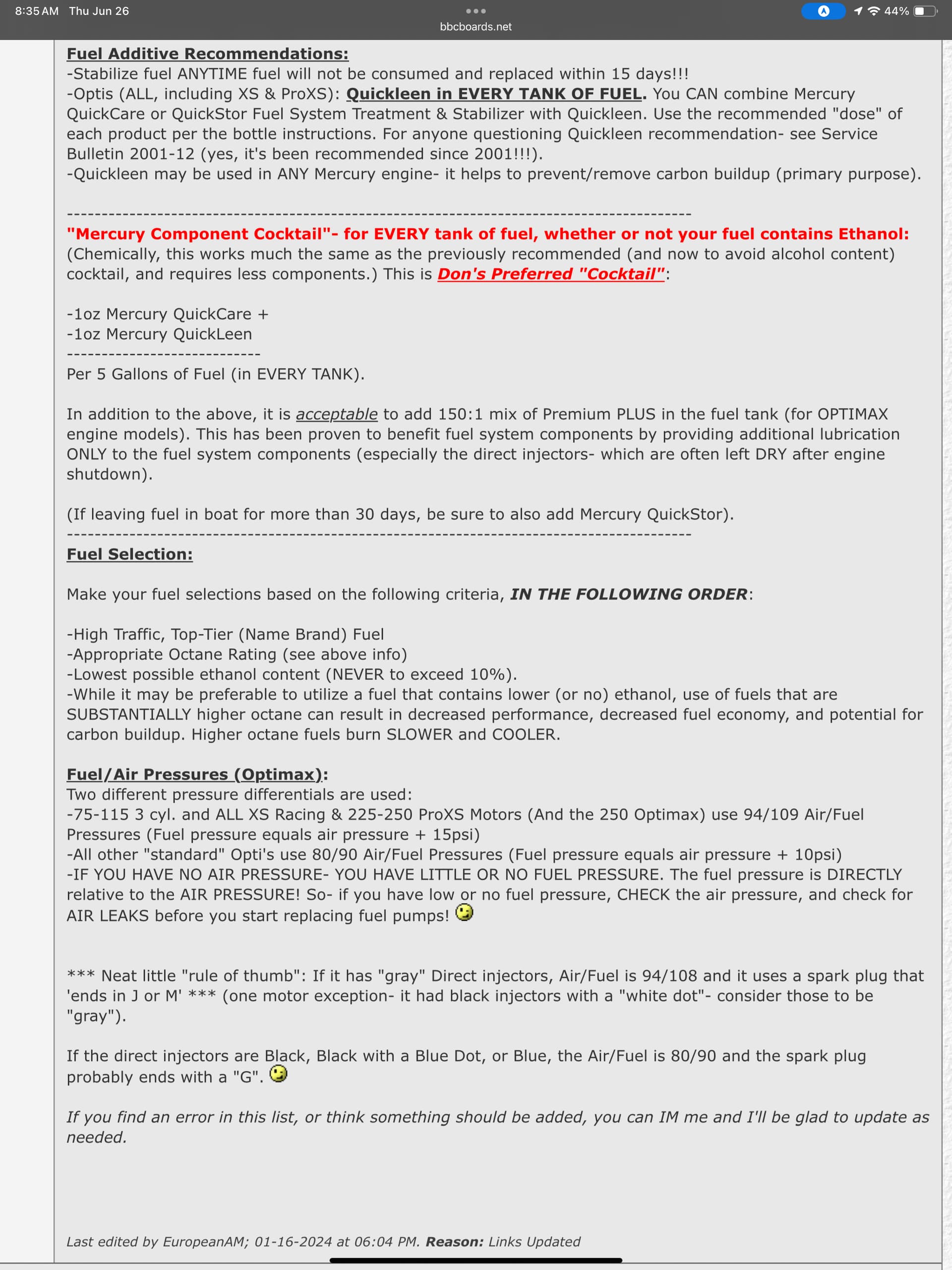

As per my mechanics instructions and I’ve never had any issues….”Don’s Cocktail”
