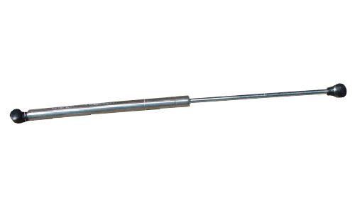

Here are stainless gas shocks that some builders use on their skiffs:
Measurements and lift rating is on the site.
Thank you so much!!
You’re welcome - smaller hatches only need one shock. I’ve seen some full size hatches (span from port to starboard) have two shocks, but maybe only one is needed depending on your setup. I believe the Heron has multiple small hatches, so single should be good.

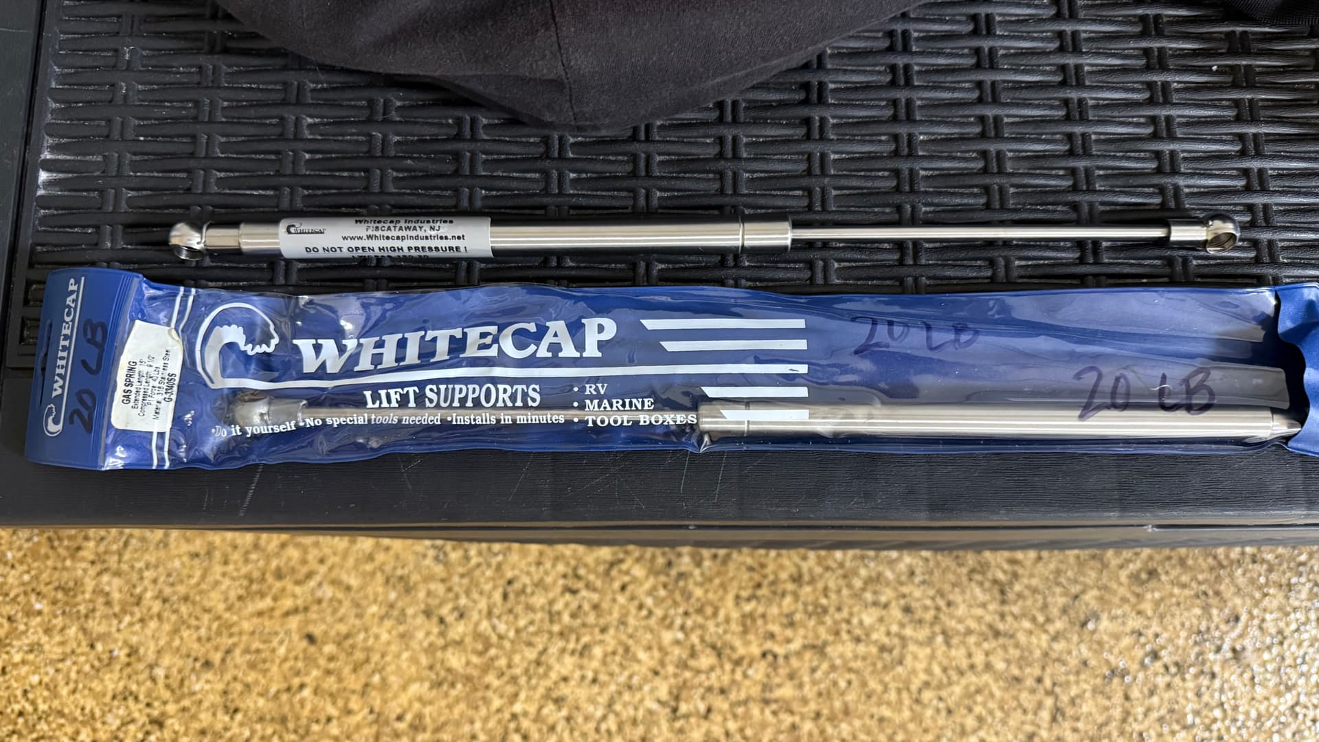

My Waterman has spring hatch supports from Moonlight Marine. They’re solid–well made. I just replaced one of the originals (skiff was built in 2007).
Just a quick story with some information. When I bought the Marquesa new, I did pay for the seat cushions to be attached, which places them on the top of the hatch lids of course! The problem was the gas shocks that Hells Bay used were only 20 pound shocks, which meant they did not have enough strength to hold up the hatches and those lids could fall hard on a hand etc.
I replaced the gas shocks with 40 pound shocks which certainly kept the hatch lids up, but pushed the lids over to the side, causing them to strike the well every time they opened or closed.
I guess it’s a fine line between the weight determined by the shocks or maybe just going with a spring, which is what I did with my new professional.
Here are your quality gas shocks
