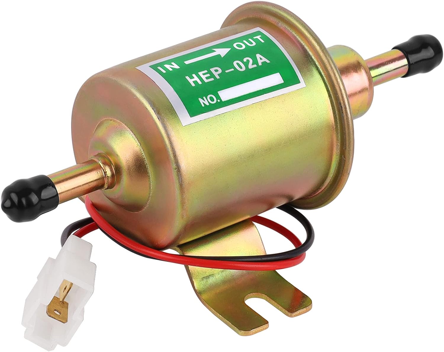

What about a generic 12V inline fuel pump from the auto parts store. Just hook it up to the tank pick up tube, run the hose into the cockpit and start filling up gas cans.

@DBStoots Dave, this should do it!

Get an inline 12V fuel pump, hose clamps, and some fuel hose from an auto parts store.
Disconnect the fuel line at the engine, and insert the fuel pump suction and clamp..
Put a piece of fuel hose on the discharge side and fill jerry jugs until the pump runs dry.
Change the fuel/water separator.
Put fresh fuel in the tank.
