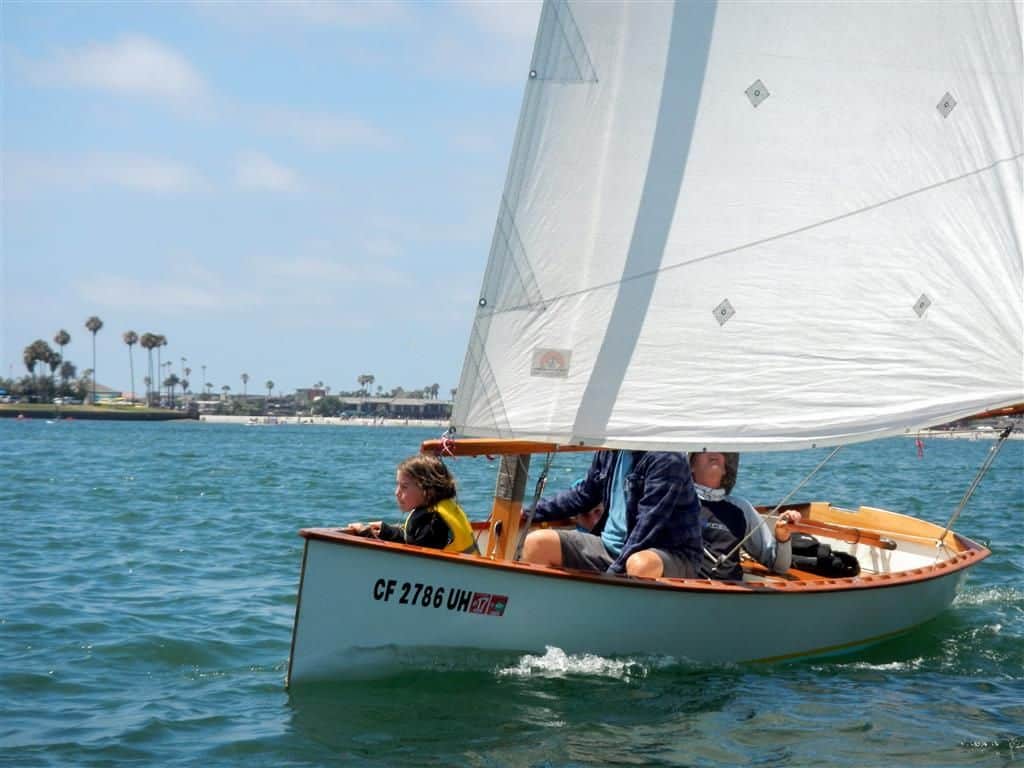

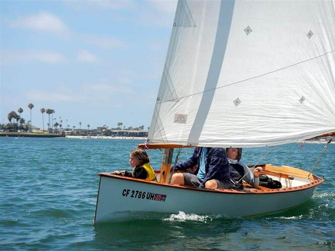

This is the closest I have found:
There are many people out there who have made 5-10lb carbon fiber masts for these boats and carbon fiber spars. Your pushpole could likely double as one of the spars.

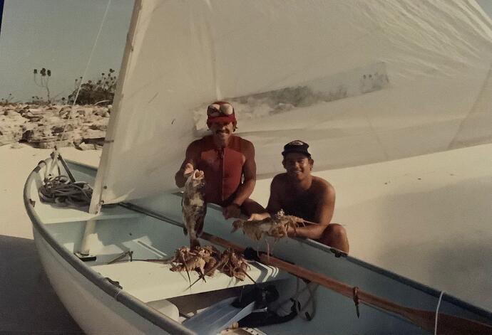

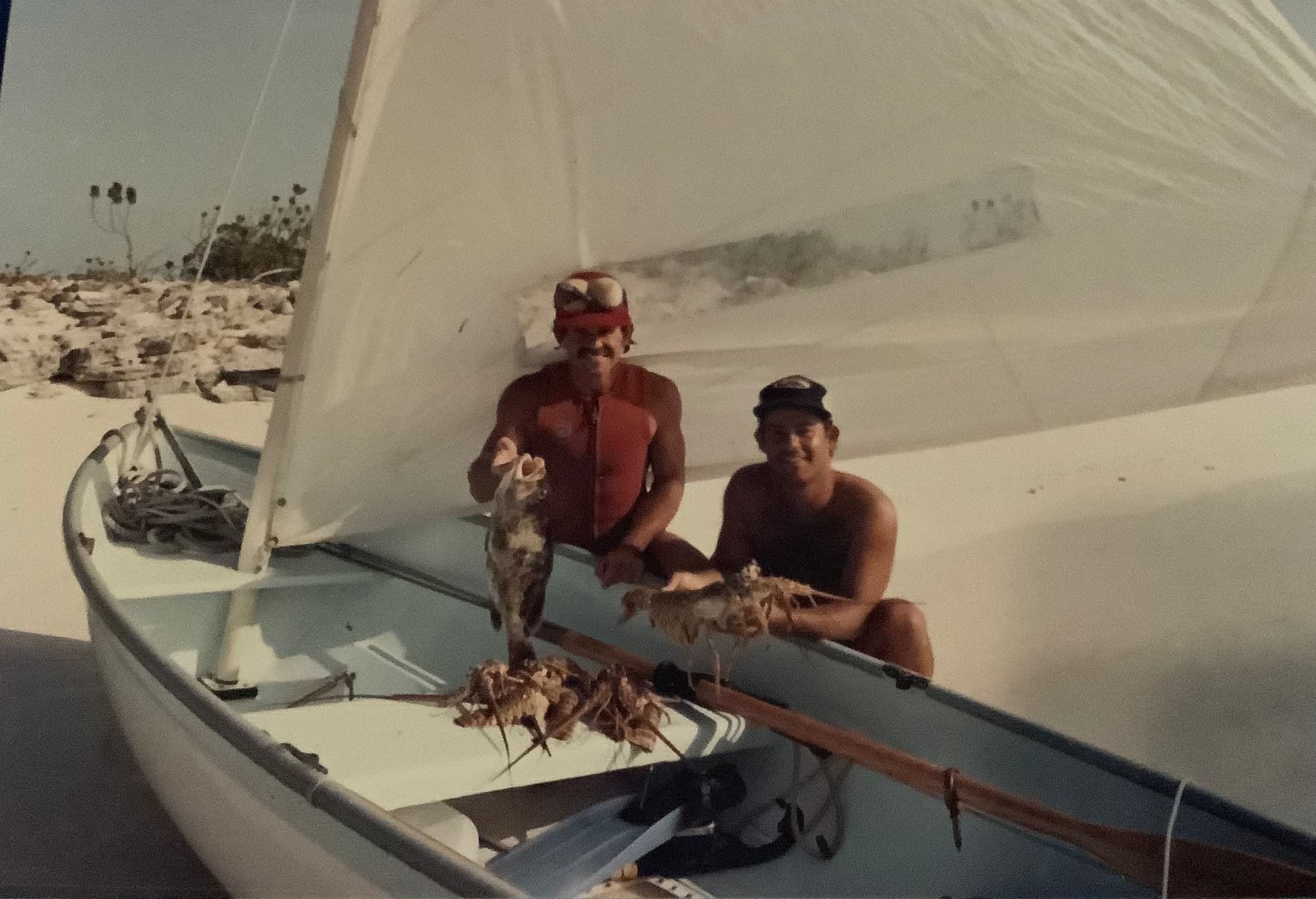

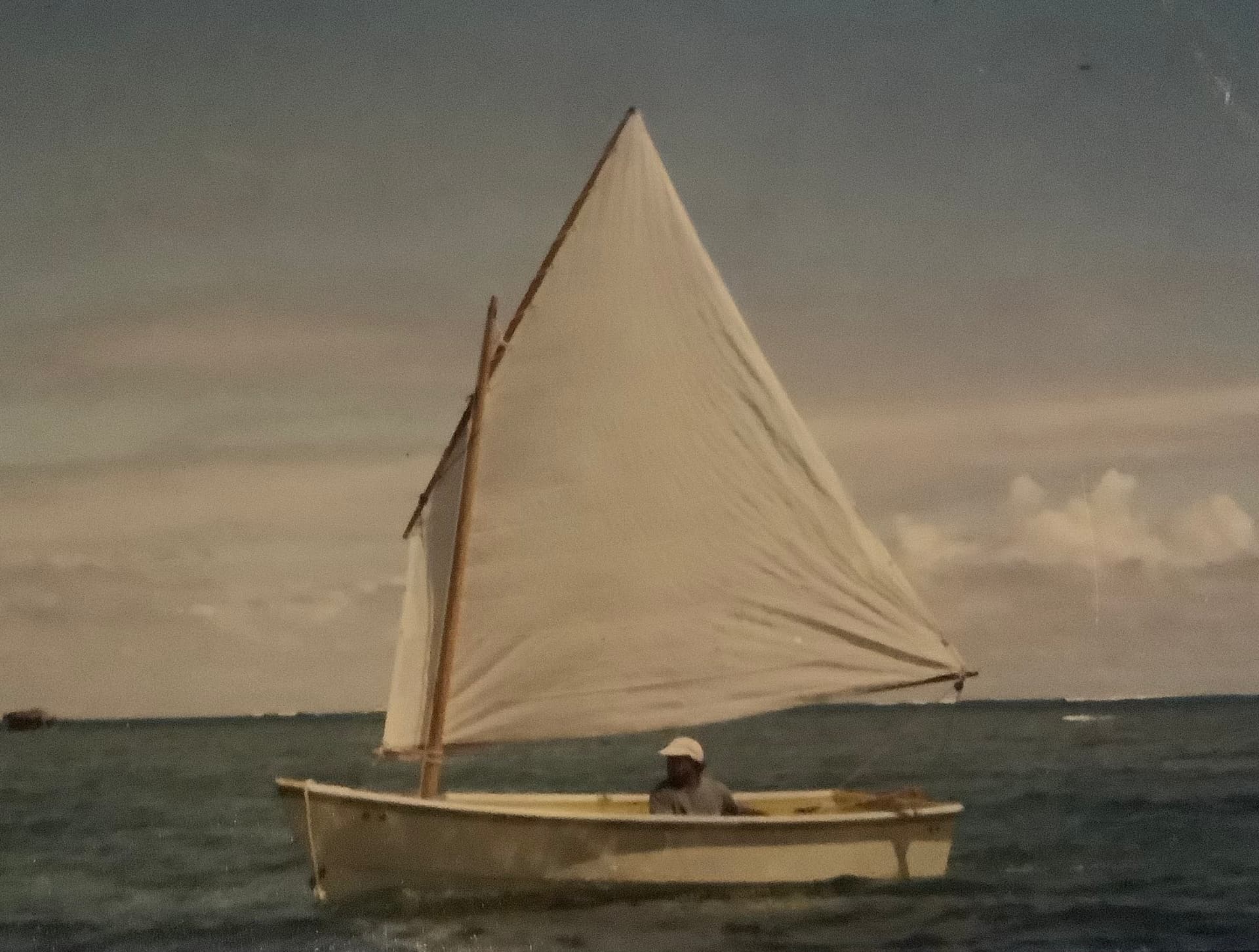

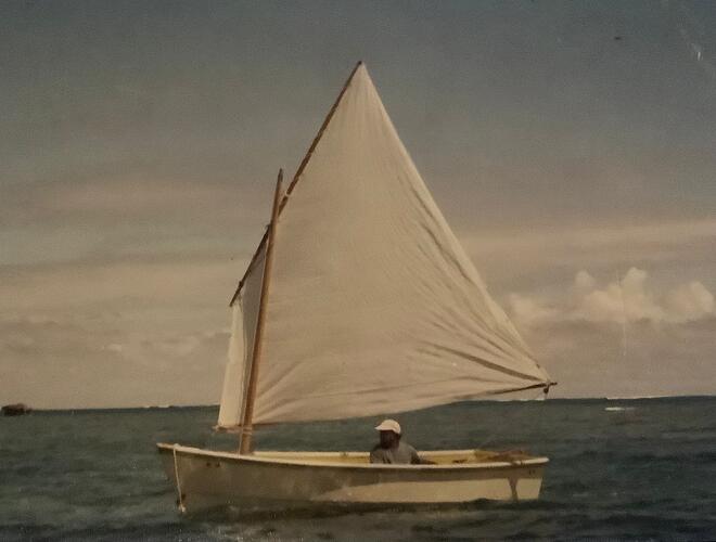

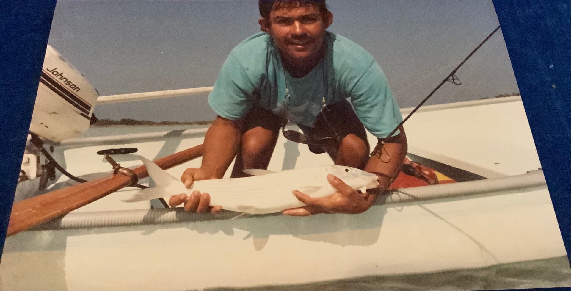

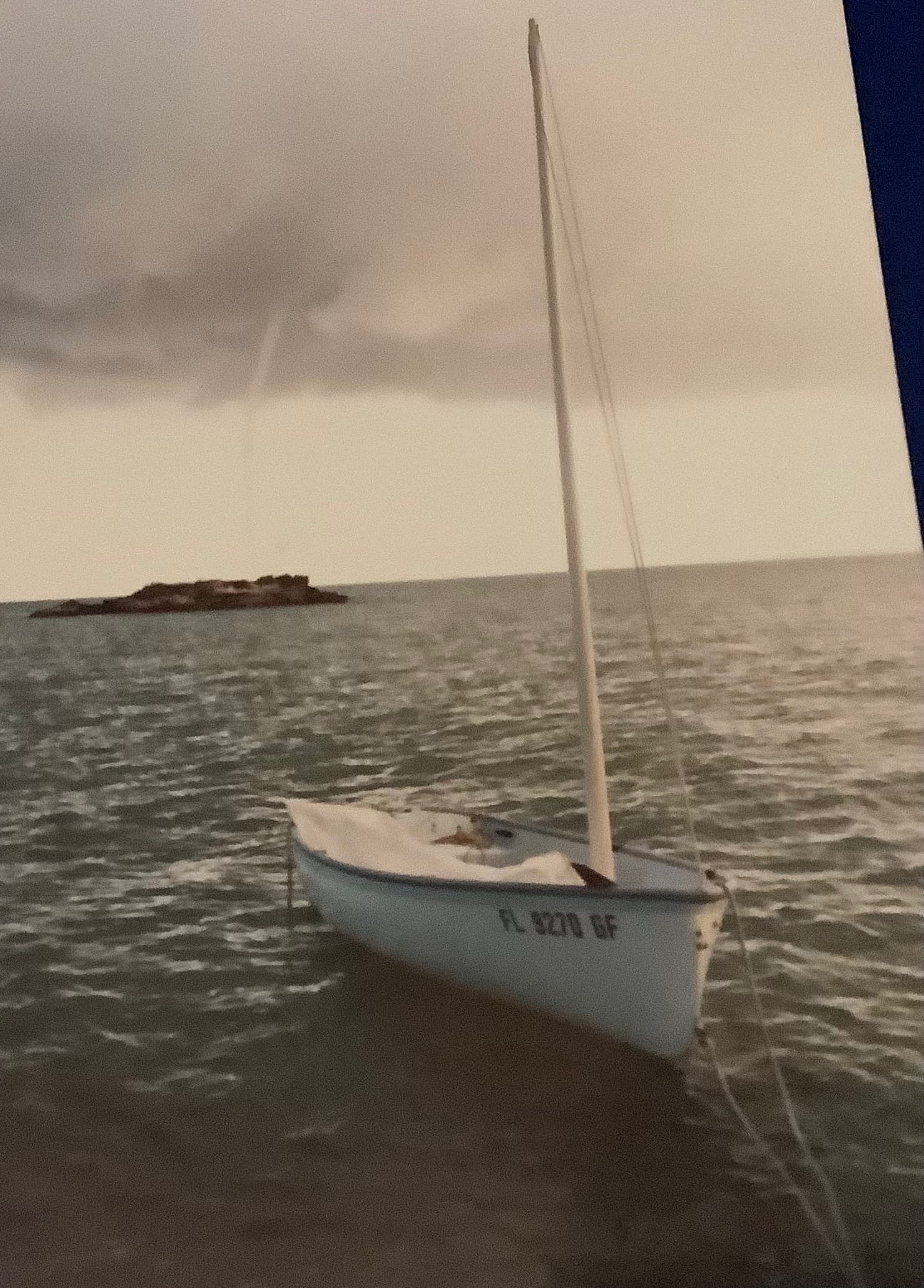

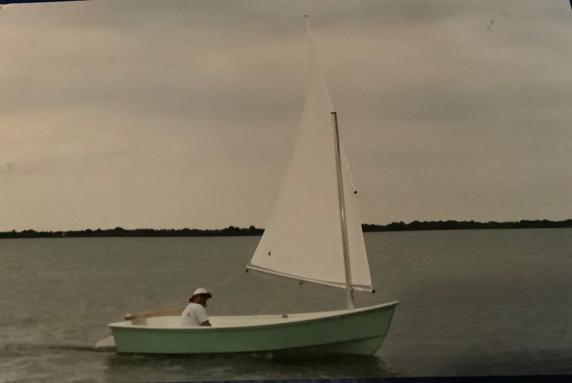

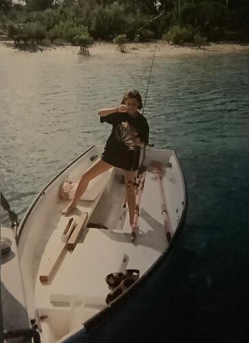

For my own personal use and for others I have designed and built over 2 dozen such skiffs I call the ROMOSA series.
Row Motor Sail.
Here’s some photos of some of these builds, many were built using Kevlar, carbon, SGlass all trying to see how light and strong I could make them. Eventually I have come to the conclusion that under 100 lbs is fine for a rowing sailing skiff but forstand up fishing it can be a bit jumpy. I like em now to weigh around 125-130 lbs.
All these skiffs could plane under sail and under power with me alone would plane along with a 4 hp at 9-10 knots and up to 22 knts with a 15 hp 2 stroke. Using sail got me to places quietly and peacefully. I could then lower the mast to fish or to wade fish, and to spearfish.
Some pictures are of fish I caught by blind casting off the mothership sailboat.

What do you have on that red cap, a shell bikini? :laughing:
Looks like I am on the right path with a gaff rig. Thanks for these photos. Its amazing how simple a skiff can be.
The rig shown with the spar yard is called a lug rig. Many varieties of the lug rig. The ones shown all the spars,mast, boom, Yard and can lay down inside the hull so very neat for stowing and making up the rig.in our world here of flats skiffs and home builders we are a very small group in numbers compared to the rowing sailing fraternity of builders. They consist of tens of thousands of builders. We have only justgot going…. Enjoy your search
That’s my friend Ron with his foam rubber boob hat with the bikini lifted to show his ■■■■.

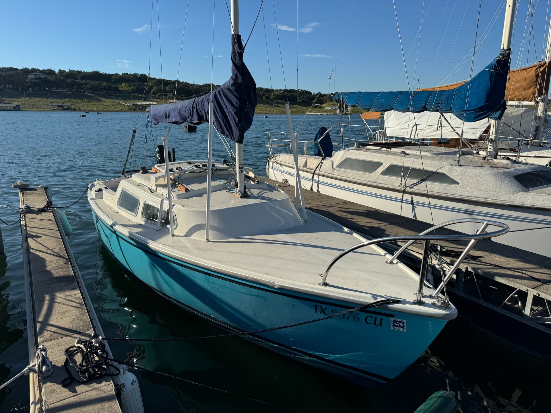

Glad to see there are some other sailors here! I have a '74 Catalina 22.
