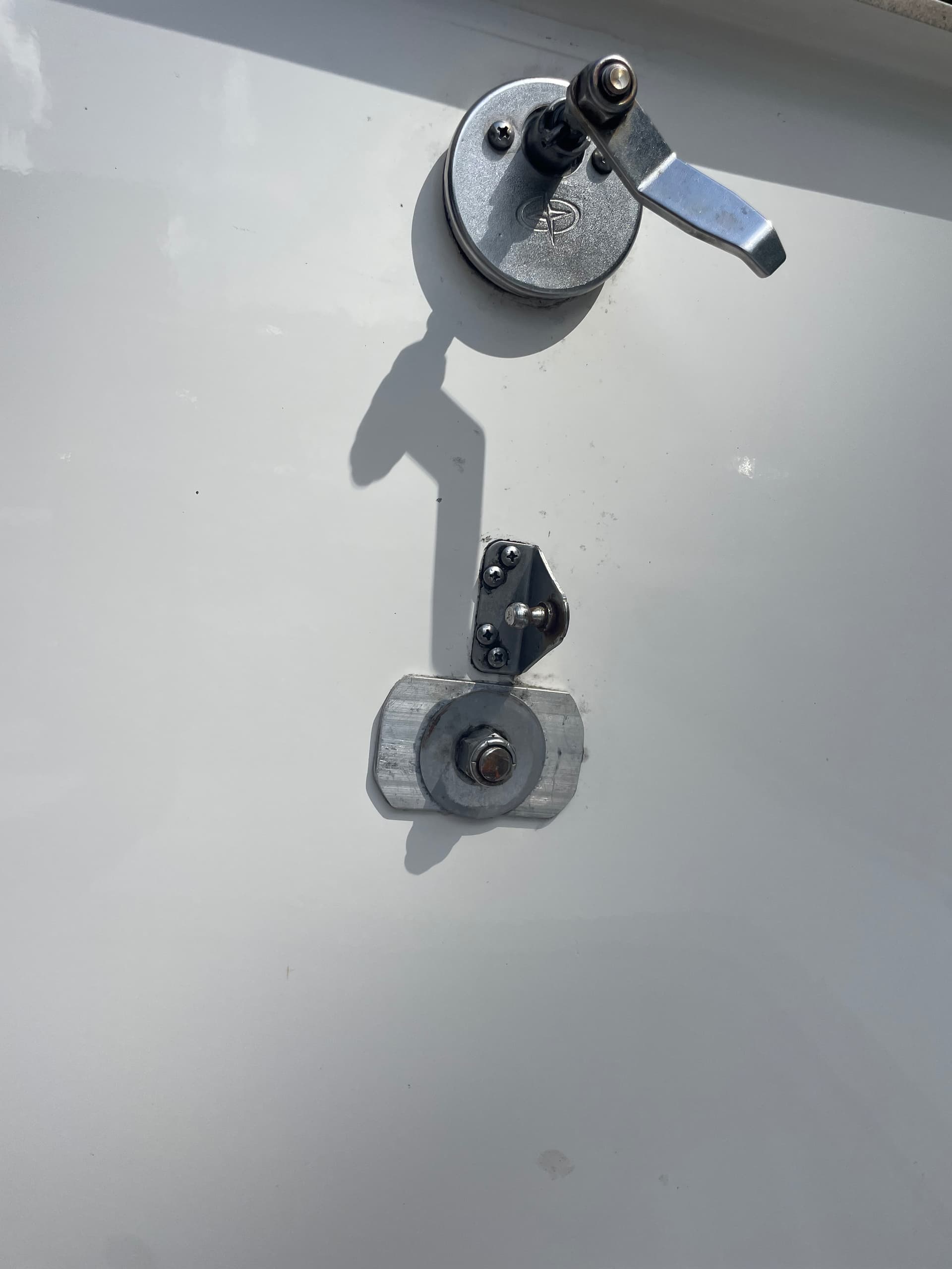

Here’s what I used for mine, would go a tad bigger if I were to do it again

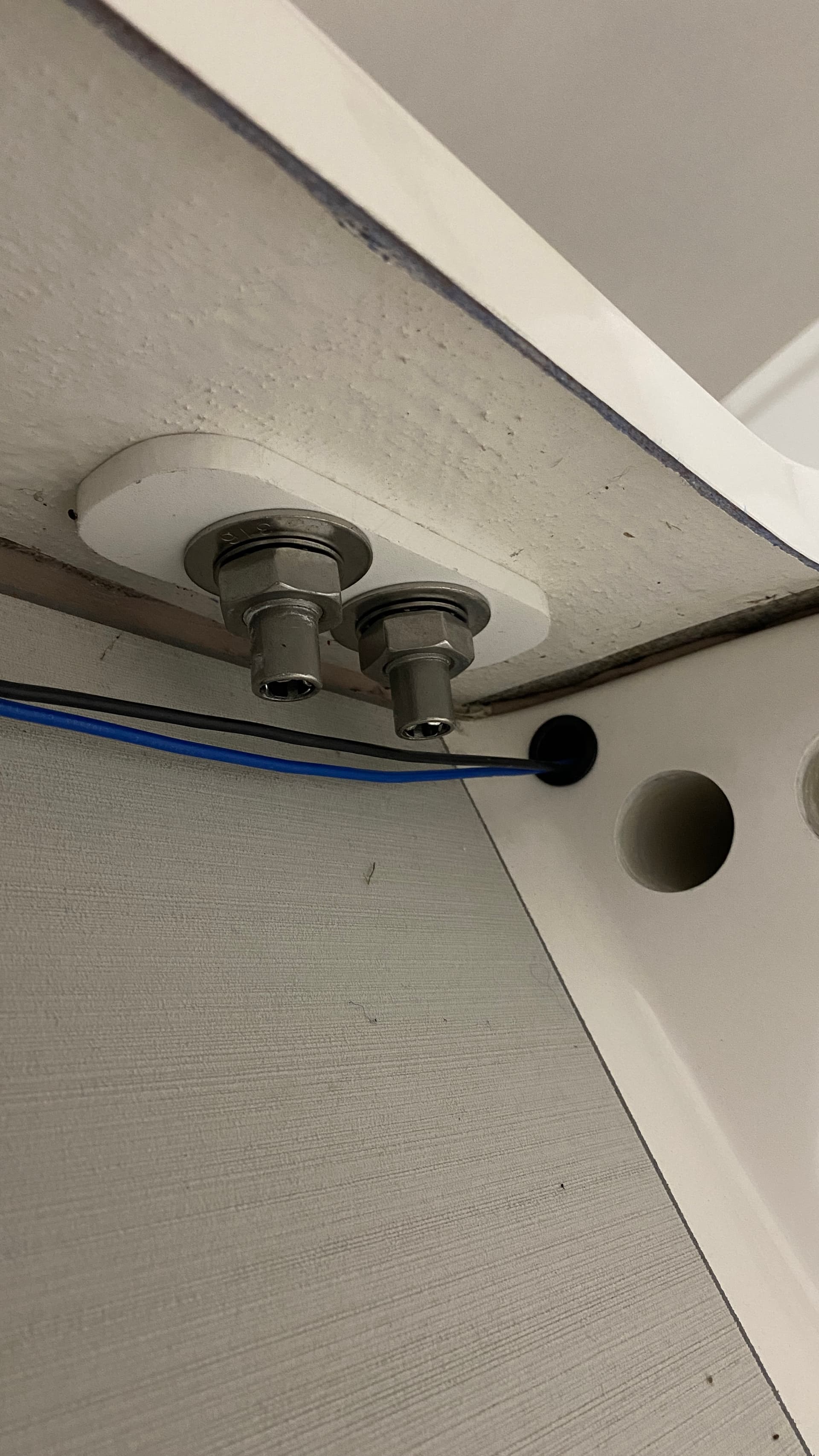

Another option for backing is 3/8" thick StarBoard HDPE. I use it with stainless washers to avoid corrosion by mixing dissimilar metals. Here’s a pic of my Neat-Cleat HDPE backing plate which is rock-solid.
