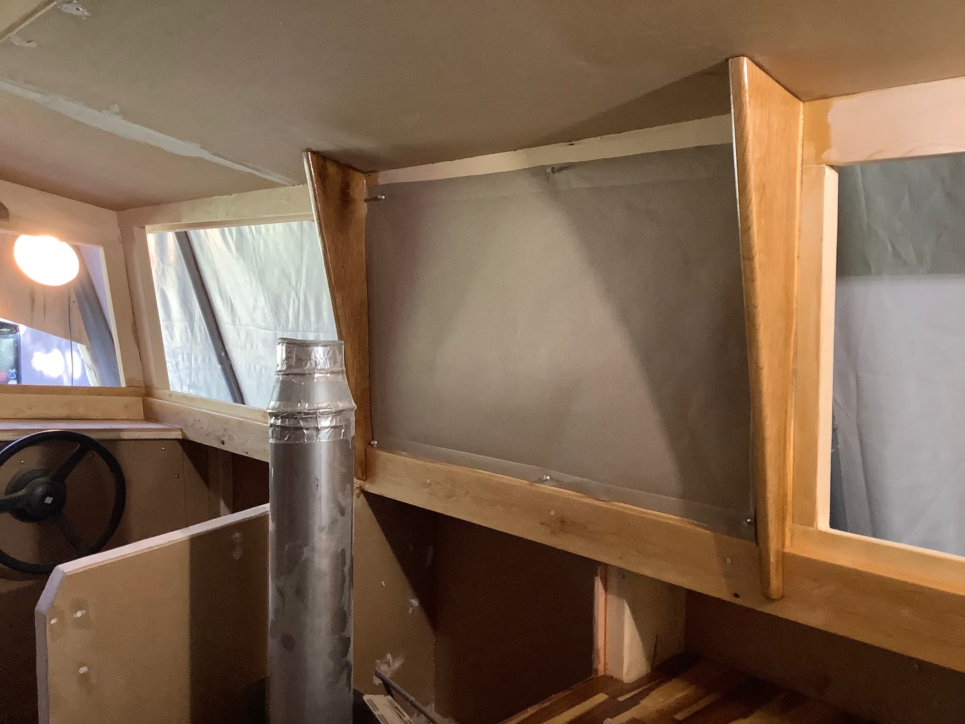

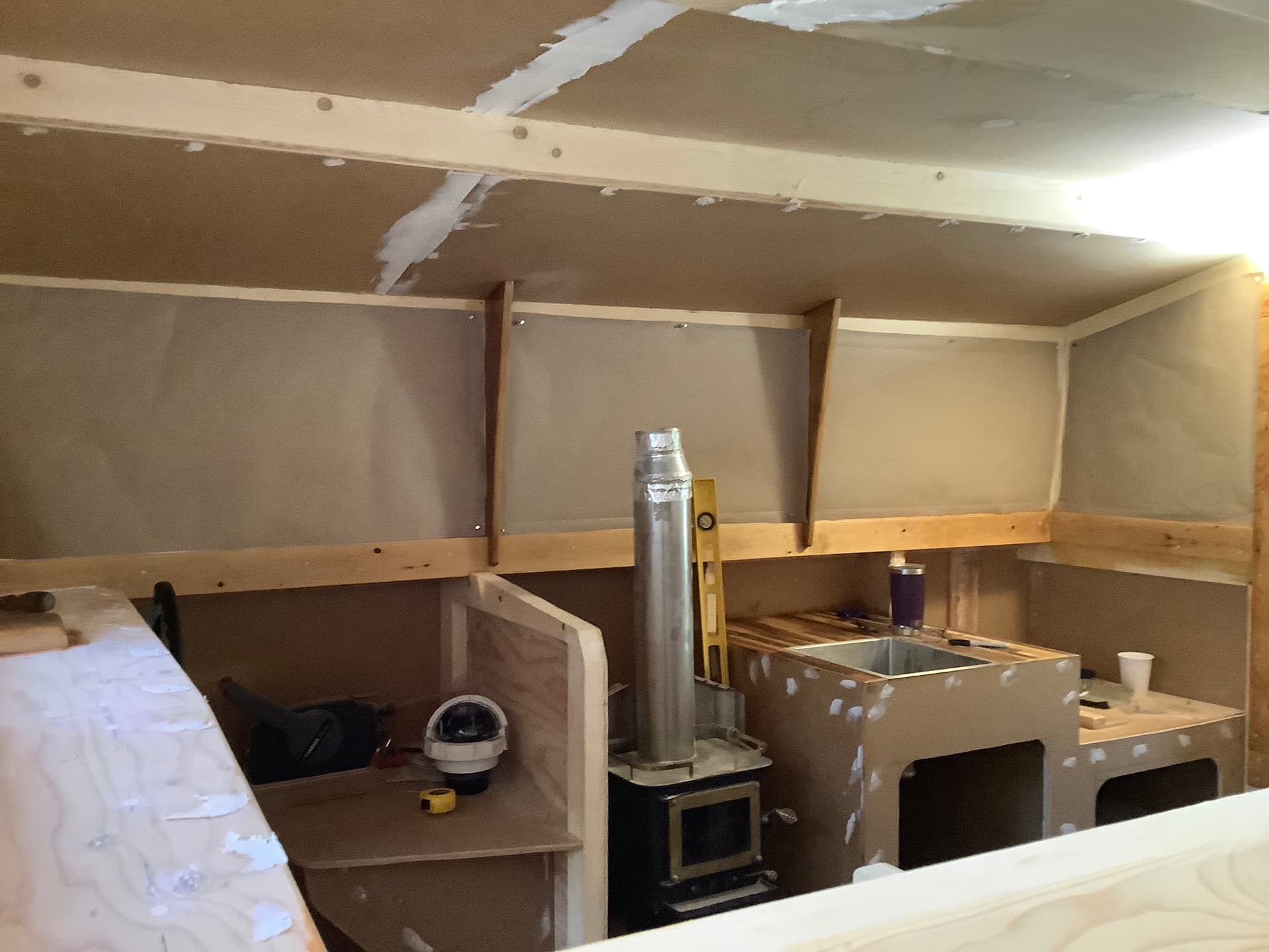

Getting final things done. Will be ready to start glassing the deck next week. Made patterns today for windows, filled screw holes, use resin and fairing powder mix as it bonds real well and minimal shrinkage.
Will sand everything Tomorrow, cut out windows finish up small projects and then get my mind set to get her glassed and faired.

Is the type of wood cut as a triangle and rounded supporting the ceiling Cherry? Nice interior accent regardless of the type of wood.

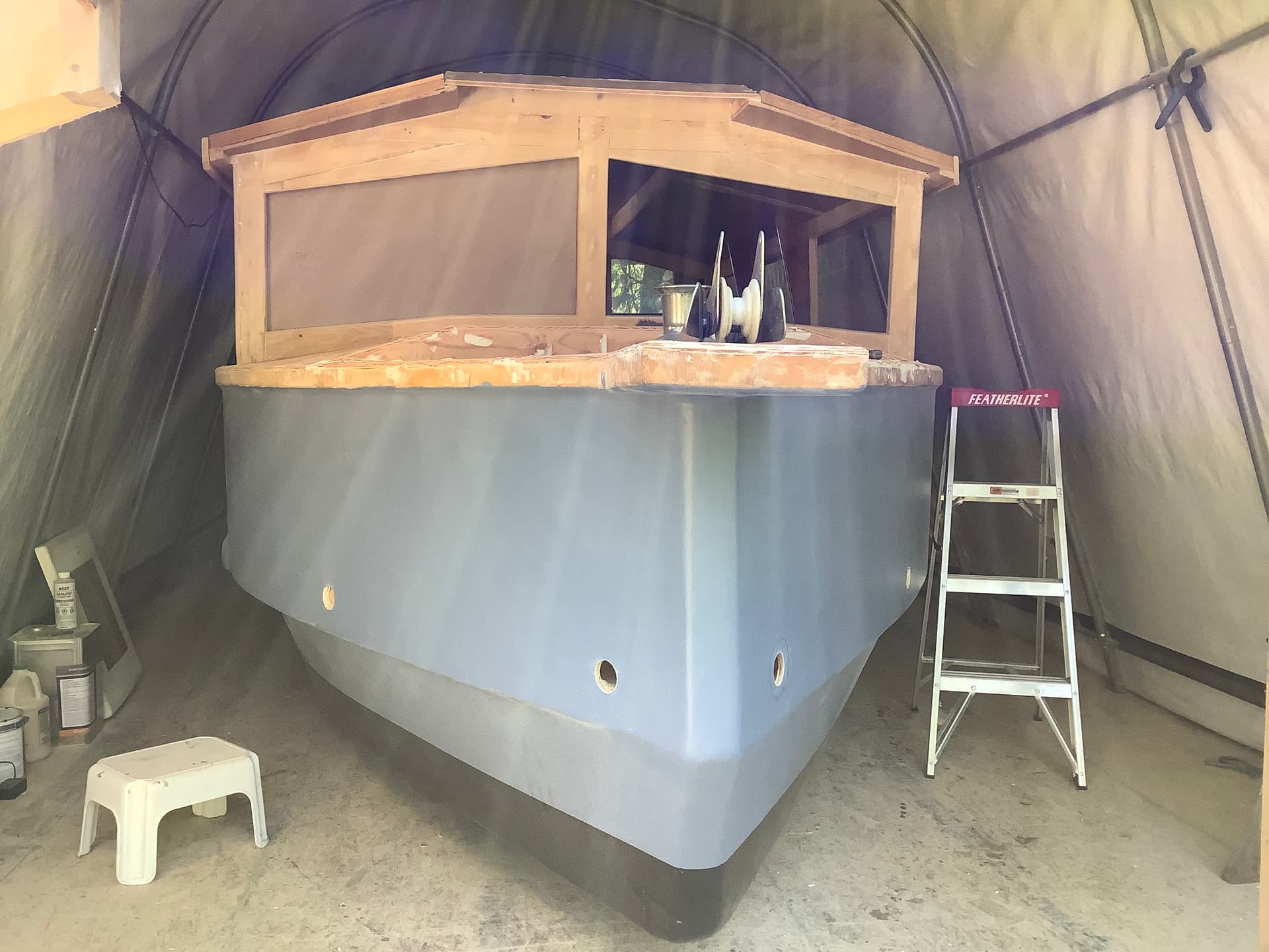

Why do you have holes in the hull?
That’s the bow anchor well. I like to stand in this well when retrieving the anchor rode. It’s a better angle for your back and all 300’ of 1/2” nylon rode and 100’ of chain all sits inside this well. The holes are big drain ports. I will glass them in. The two forward ones a line can be passed through them and then it will act as a tow eye for winching up a beach if wanting. You ever have all the mud, sea bottom smell mess inside the boat below with a setup like this. Will post pictures as it’s finished off.
