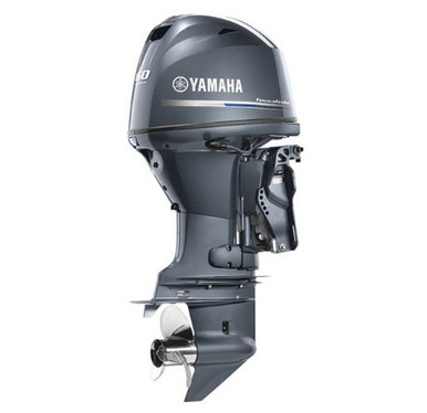

I was thinking 115 for HPX 18, Evo 18, Marquesa and f70 for HPX 17, Evo 17.
Welcome @mt-hwy to the new site.
I had a 115 power Mav 18 like yours. If your fishing doesn’t require you to go skinnier then I wouldn’t make a big deal about it. Mine ran 47-50mph with the 115.
That said instead of deciding between the f-70 and the 115 split the difference with a 90. The Suzuki 90 is 20 lbs lighter than a 115 pro xs command thrust and more than 20 lbs for a yami 115. It spins a big prop well. I’m seeing 38mph in my 22 panga. I do miss the speed of my maverick a little, but I also drive with a heavy foot.
I test ran the first 2nd gen east cape evo v that was kinda pieced together. With a Zika 90 it was still over 40 mph and draft was 8-9” with out many options on the boat. I personally wouldn’t put a 115 on the mav 17 hpxv’s. They were almost perfect with the 90 2 stroke hence the reason you see lots of guys running the 70 4 stroke cause it’s almost the same weight.

I went from pegging out the limiter with the jackplate all the way up in a bay boat, to running at cruising speed with my feet up a few years back. For me it’d be the f70. Well for me it would be the zuke 60
Check out the table I made here: 30 - 115HP Motor Comparison - #7 by Zika
Suzuki 60 to Yamaha 70 is minor weight but depending on your builder - there is a price jump.
Going from either of those to a 90 is where you see the weight pop up.

At 20lbs difference between the 90 and 115, I’d go with the 115.
As they say, when in Rome…..
I have a 115 on my 18v and would not step down to a 90 to save weight. That 20lb won’t make much difference in draft at all.
