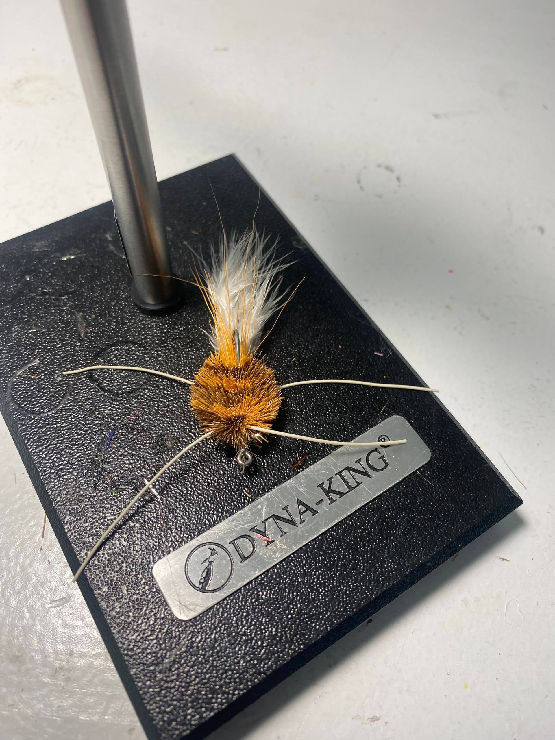

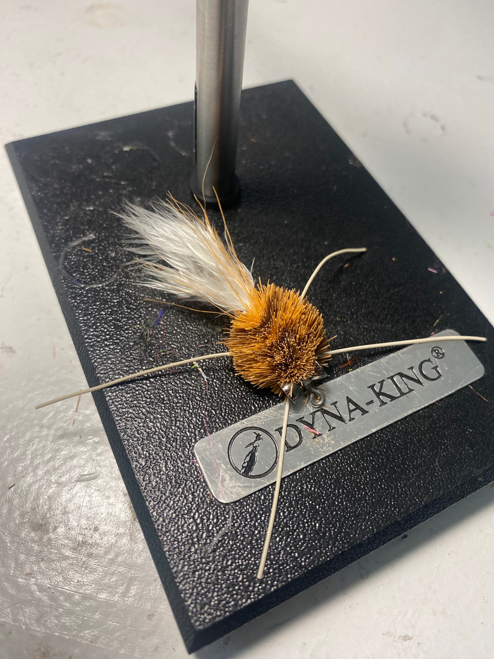

So after messing around with EP for a few different failed attempts, I figured I spin up some bucktail to see how it would turn out.
I think it’ll catch.
Nice looking fly Mike.
Bucktail is buoyant, so make sure it will sink down where you want it.
That looks like a great shallow water fly.
Edit- Just saw the dumbell eyes- it looks like you have enough to get it down!
Nice work
Thanks.
I actually used lighter dumbbells on this one, but the intended area for it is skinny mudflats/flood grass areas. So it should sink and work out just fine. If not I can added heavier dumbbells on future ties.

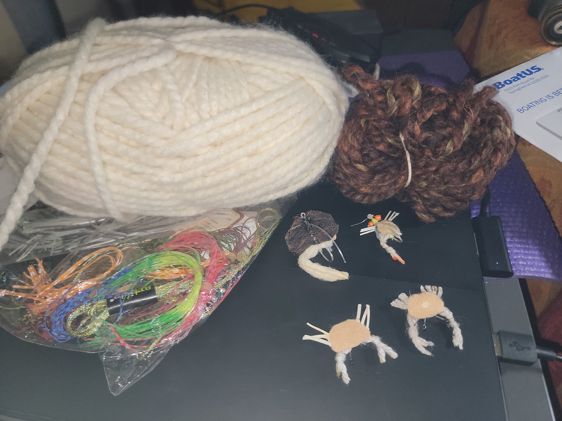

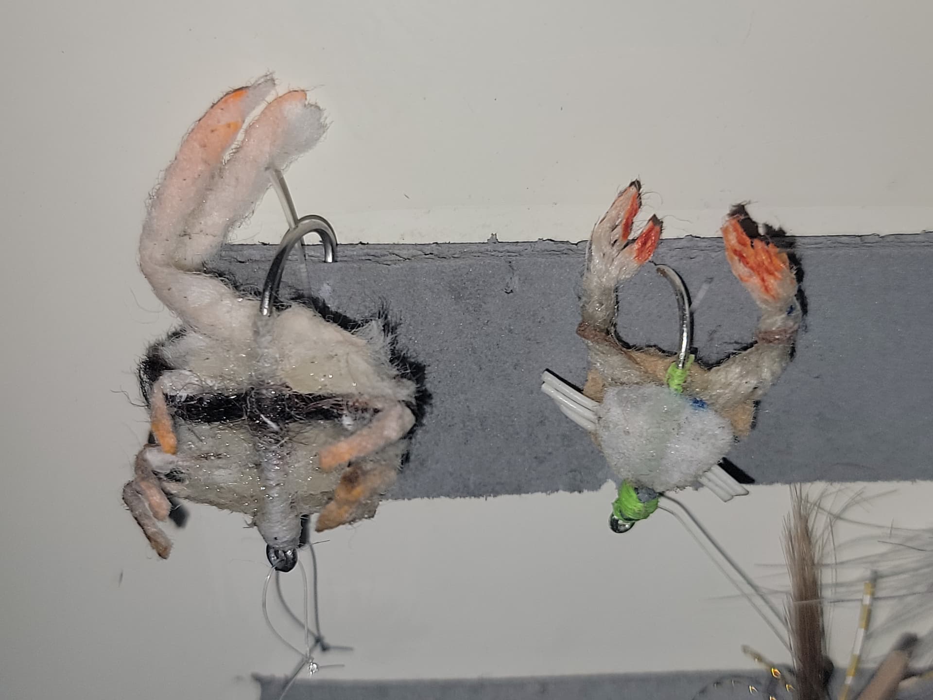

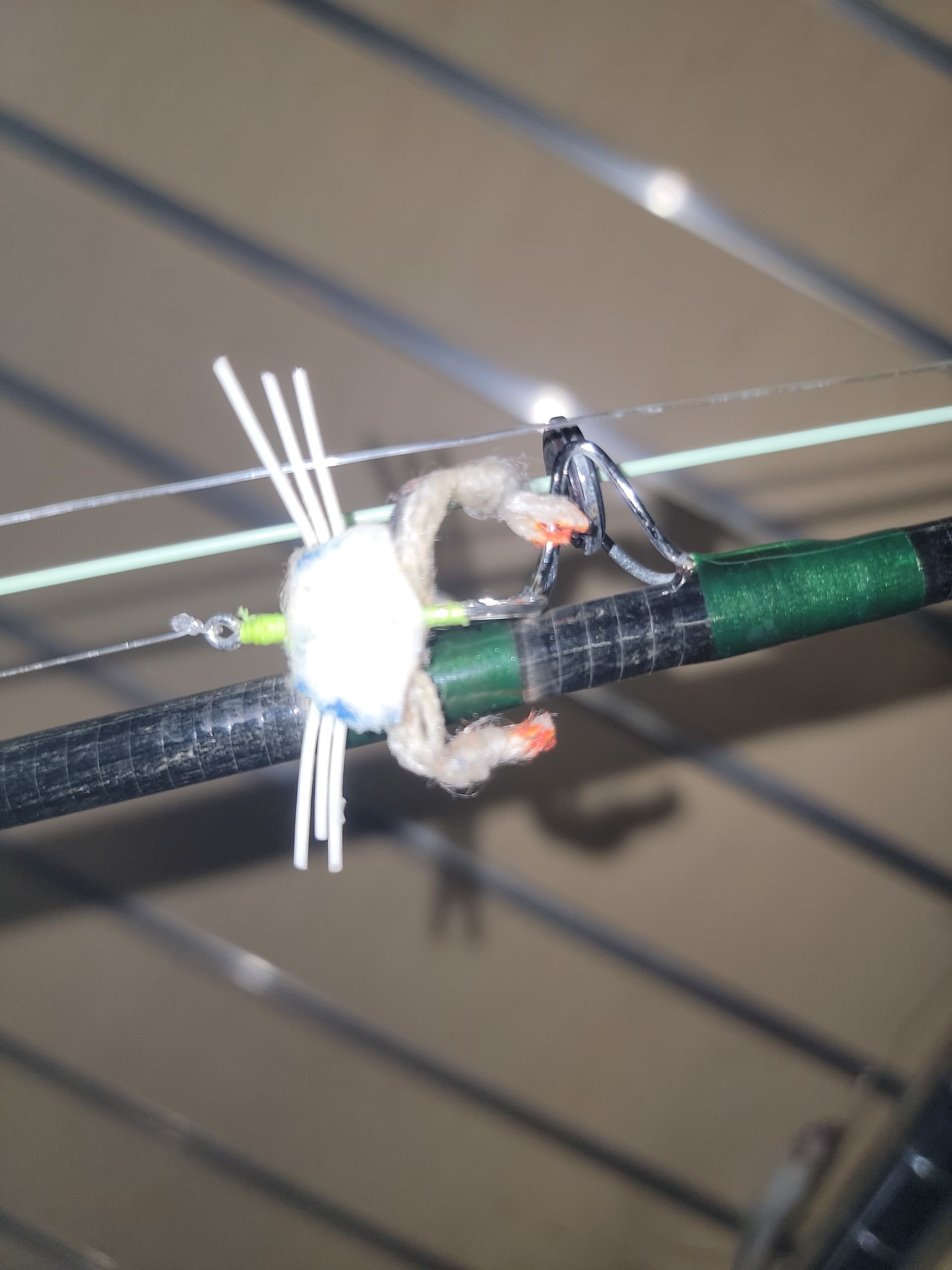

For my area at least, any yarn Merkin body will work. For picky or tailing reds, where you have to slide the crab under their nose to get their attention a merkin with some kind of large claw is better. Keeping in mind that fiddlers (the crab with one big claw) are shore line crabs and run in packs of 100s. If you are casting on a shore line or under shallow mangroves then fiddler is an option. Fiddler are not typically aquatic crabs. If your red had a bunch of actual fiddlers and you hooked it in 3ft of water then he likely had his fill before you got to him. More probable, if he was actively feeding on crabs when you hooked up, they were juvenile crabs that live in the grass, not the big claw fiddlers. All that is food for thought when you want to toss a fiddler vs a plane old merkin.
In as far as fly tying. For me a fiddler pattern is a Strong Arm Merkin or some variant of and a juvi crab is regular Merkin. There are a million videos on tying them. They are super fast and super cheap to tye. Use 100% polyester yarn, the big stuff for knitting (2 bucks is a lifetimes worth), and actual “silly legs” or buy some replacement spinner bait skirts and snip off what you need. Again, one pack will last a lifetime.
If you are going strong arm or fiddler variant there are any number of ways to do the claw.
There are also felt crabs but the same purists that would poke you about using scent might poke you for those too.
The magic with crab patterns is how you weight them. That depends on what debth you are fishing them and is there any current, but generally you want a negative buoyancy (crabs almost never swim up) but you want still want some hang time and a little flutter as it sinks.
If you want more info PM me. Happy to help.
