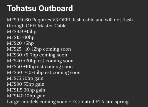

Following this myself. I have a Tohatsu 50 hp just out of warranty that I am interested in bumping to a 60. One path is an ECU swap, but I will wait until OEFI releases their solution.
But that leads me to a question about the Tohatsu mod….
If the T50 is the same block as the T60, I do not understand why the 50 only gains to a 60 and the 60 jumps to 75 hp.
If it is the same block, why wouldn’t the 50 also be able to each the 75 hp numbers just lke the 60 when tuned?
Depending on what I learn, I could take a 60 ECU and then mod to get a 75 from the tune. But I don’t see why that cannot happen with only the tune. Once they release the official tune, I’ll inquire.
You will get 75 without an ECU swap
He has dynos on the site. I have seen the Df60 but can’t find it right now, just the DF40.
On that motor, the torque peak is 4750 but it is quite a bit higher than the horsepower. It inverts around 5700. It’s not 20% throughout but it builds beyond 20% up to peak torque
The Yamaha f70 is essentially parallel until the top of the rpm range.
That is what I would think as well. From their site they are estimating only a 10 hp increase on the 50 hp:
But I’ll wait for the release and see the results. I am glad I waited on changing the ECU - I nearly bought one recently.
