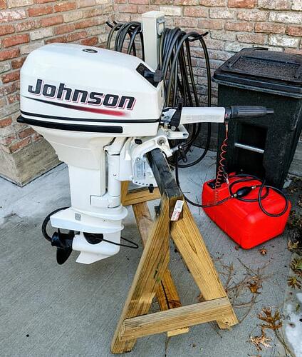

Also, I went and checked out an outboard engine yesterday; a 2006 Johnson 15hp 2-stroke. It’s in pristine condition so I left a deposit and will pay the balance, & then bring it home, later today.
I miss those old Johnson engines. I must have had half a dozen, none newer than a couple decades old or older. Still have an old 1960 something seahorse 6hp that I havent touched in years and am a little afraid to look at it!
It’s all coming together. Be fishing in no time.
