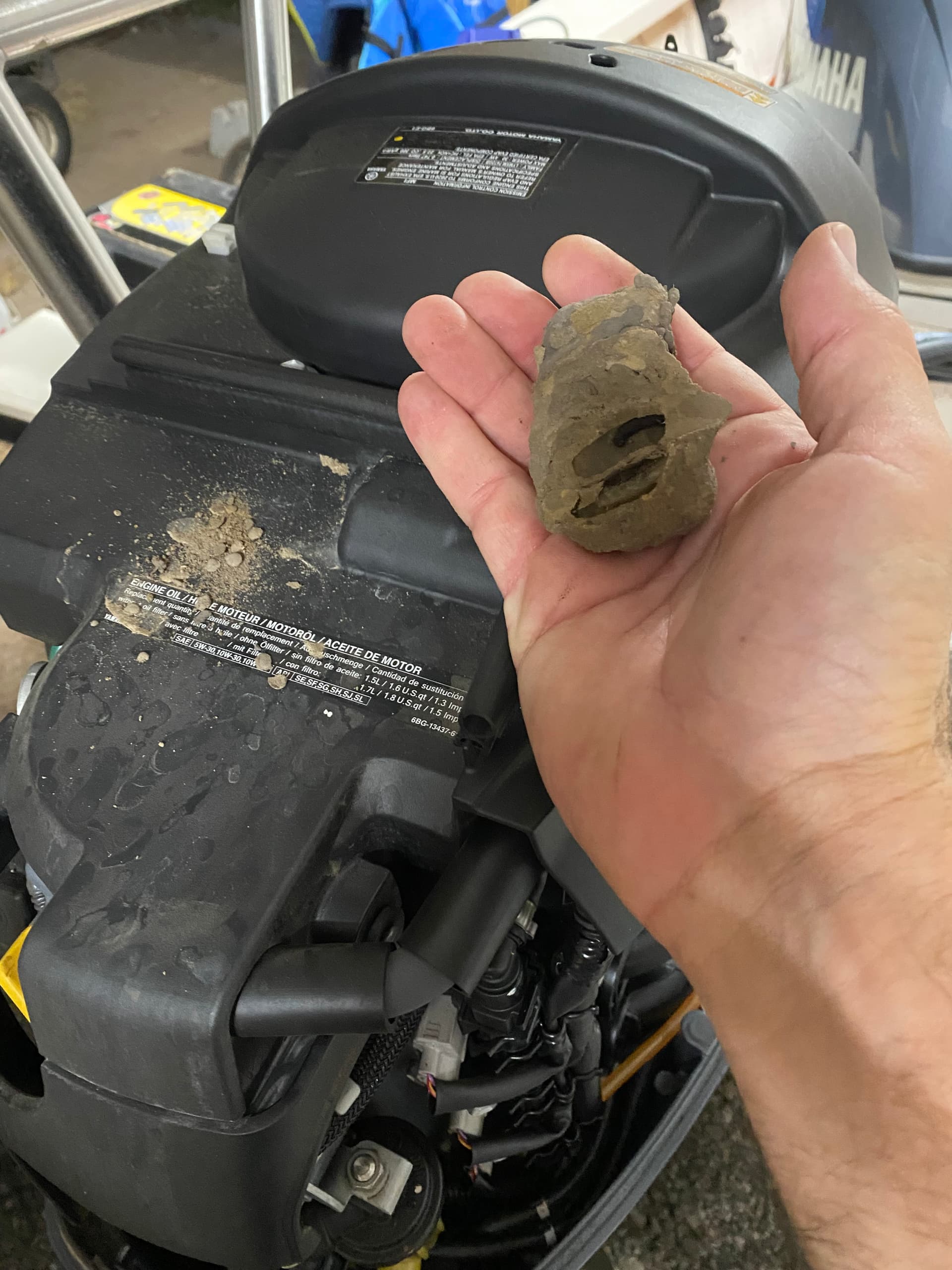

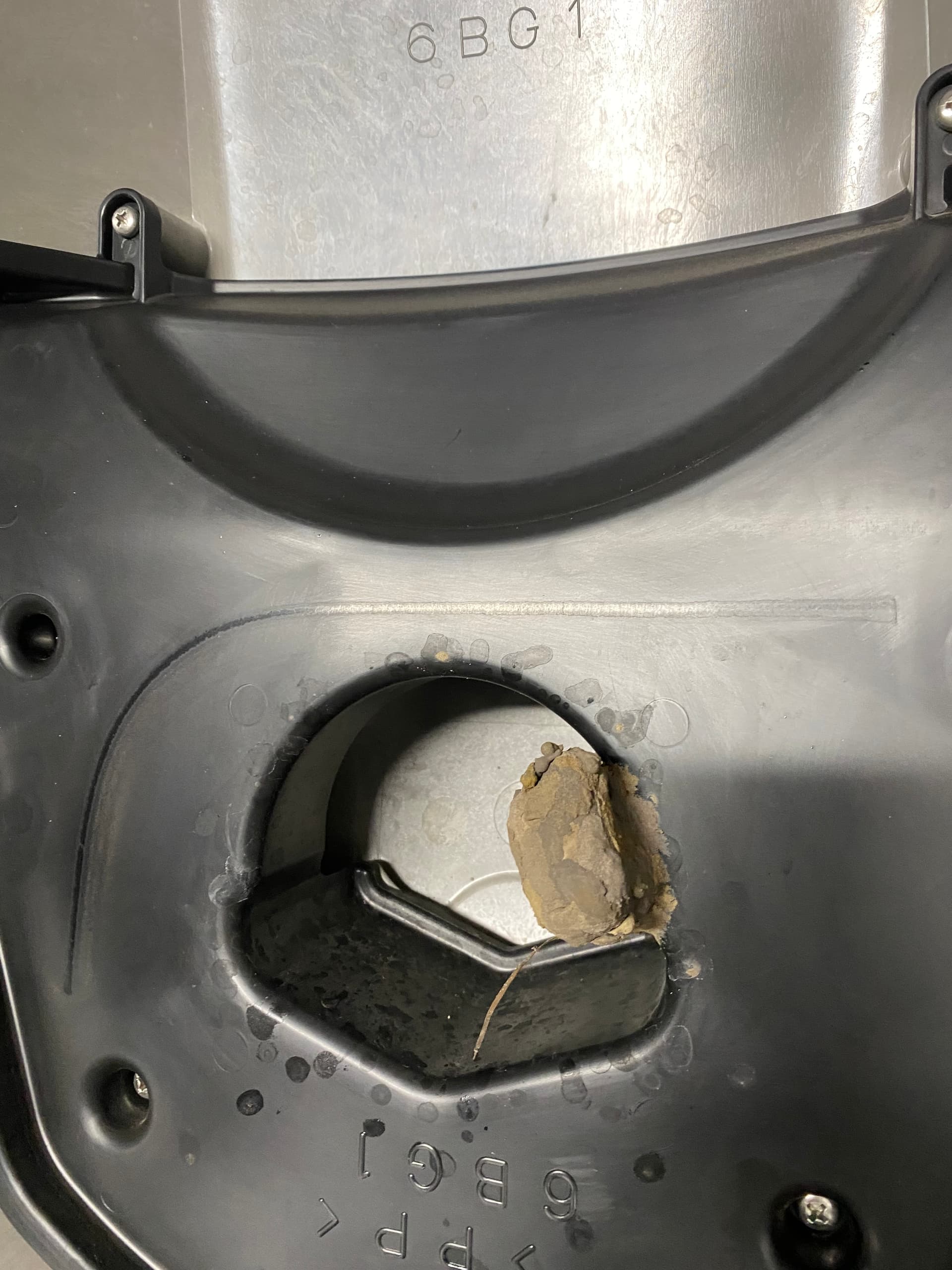

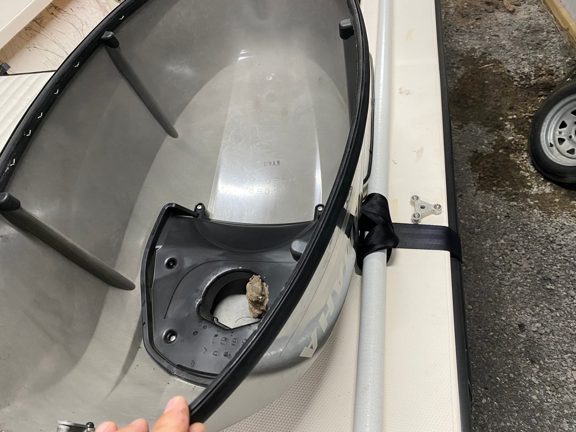

Removing the cowling I found this:
Probably not the end of the world since the mud daubers have moved on… but it could get interesting if they were still there.
As to the nut… I have no idea where it came from. Checked everywhere I can think of, but I am not a mechanic.

Additional update.
When I put the motor on earmuffs and fired it up, the motor did not pee.
I played with the muffs to make sure they had a good seat- they did.
Turned it off and tried to decide between snaking a wire up the pee hole or putting the hose onto the motor’s hose fitting.
I opted for easy and connected the hose- it took about 10 seconds before that punched the build up out- but then it was back to 100%.
Not sure what clogged that line… but I am glad I fired it up at home first to work out any issues.
Any reason for me to worry?
What are normal reasons for the pee vent to clog up?
Muddobbers and or Spiders.
Yeah you could have had some grit that broke loose and clogged it. I’d still snake it and run some Salts Gone.
