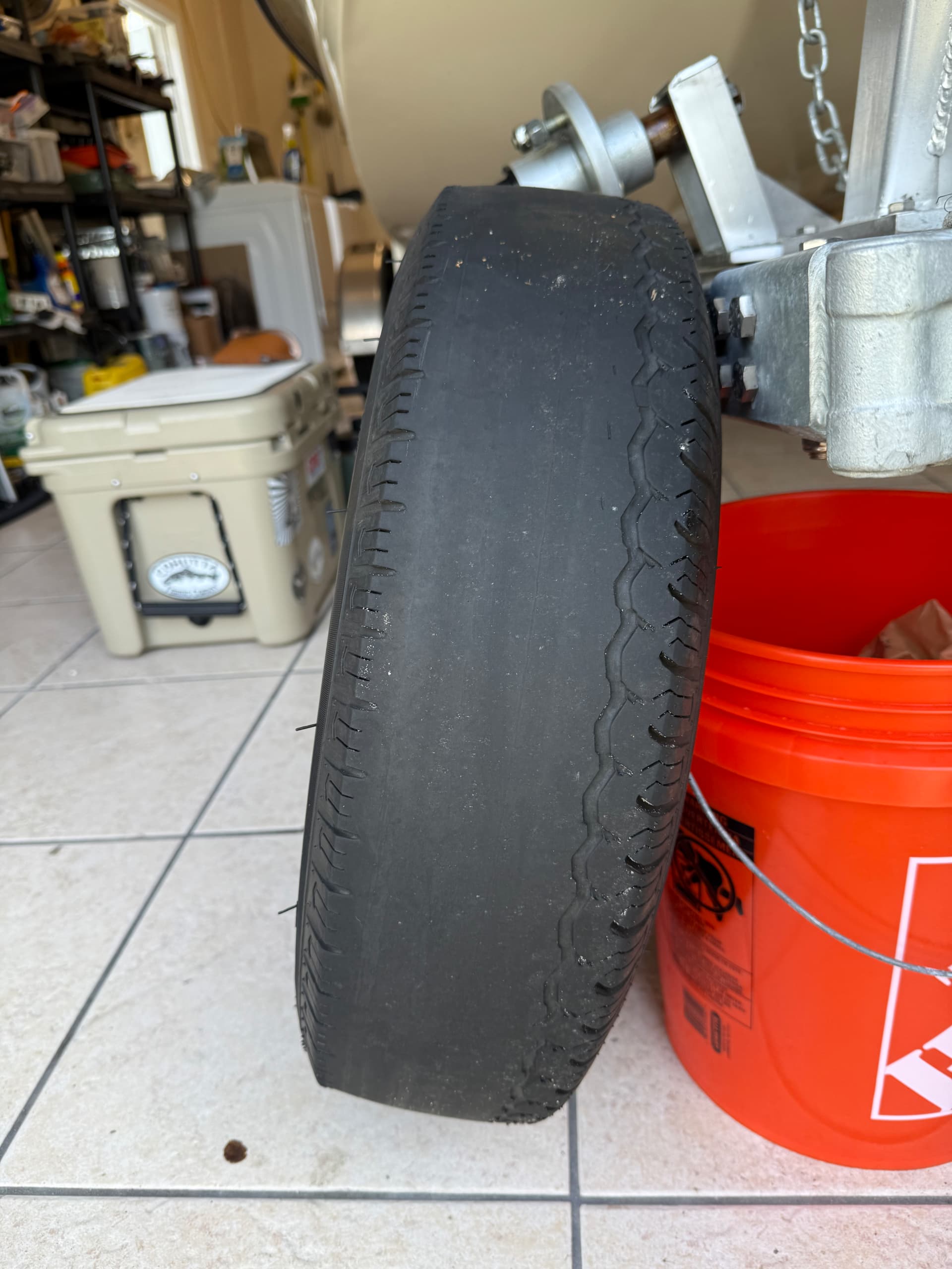

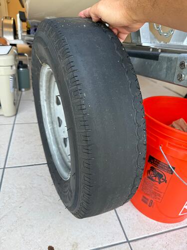

Was rigging rods and setting the boat up to head to Flamingo when I got a peak of the tire under the fender. Approximately 2000-3000 miles on the trailer, towing a 14ft skiff. Removed it and checked the hub, spun freely with no play so that seems ok. Other tire still looks new, thinking axle alignment?
If the alignment is off, how would I go about fixing that, its a torsion axle bolted to the frame. Is that something I could do or would I need to reach out to Float-On.

Wow, but pretty even. Will take getting on the ground , but you can get a string and stretch it from the CENTER of the hitch back to the same spot on the end of each axle somewhere and compare. This will get you close.
How does the other tire look?
And stating the obvious here, and not to kick you while you are down, but that tire is pretty far gone. Good that you caught it now before something bad happened, but that thing has been gone for a while and could have been caught earlier. I double check my tires before every trip.
But if the axle is crooked, that tire is being dragged across at an angle, causing what you see. If your axle is mounted straight the spindle could angled. But start with the string as @Sublime mentioned above.
Hopefully Float On will come through for you to resolve it.
And since you have to replace the tire, I highly recommend ditching trailer tires and go with a light duty truck tire. They have a higher speed and load rating which means they handle heat better and way more durable.
Other tire is good looks barely worn and I agree, I should’ve caught it much earlier. Had a bad habit of just glancing at the edge tread from above and to the side due to the fender and complacency from assuming it’s probably good since it’s just over a year old. Lesson learned, but I guess first thing is to check the axle alignment and go from there.

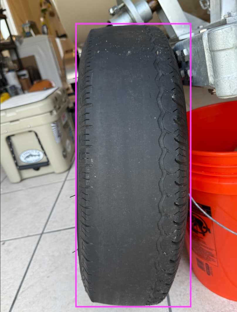

The tire was not evenly worn - the outer tread is thinner than the inside tread. Here is a straightened picture with a straight square around the tire.

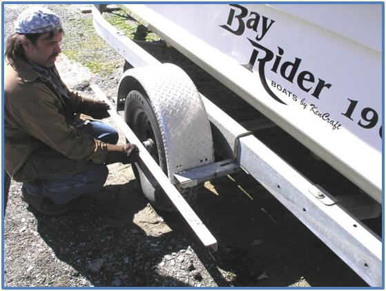

I believe you have one of the following things going on…..
  • Trailer frame is bent
  • Axle is not mounted evenly (more than likely)
  • Bent axle
  • Bend spindle
Here is a good site that shows how to do measurements to identify each potential issue.
Since the outside of the tire is worn down more than the inside, I believe this tire is closer to the front of the trailer - i.e., closer to your truck. It is being pulled at an angle, not evenly, causing the outside to wear down.
Did you measure the axle with a string from the hitch?
Do you have a torsion or leaf springs?
@coconutgroves That’s a pretty good article, good information there.
