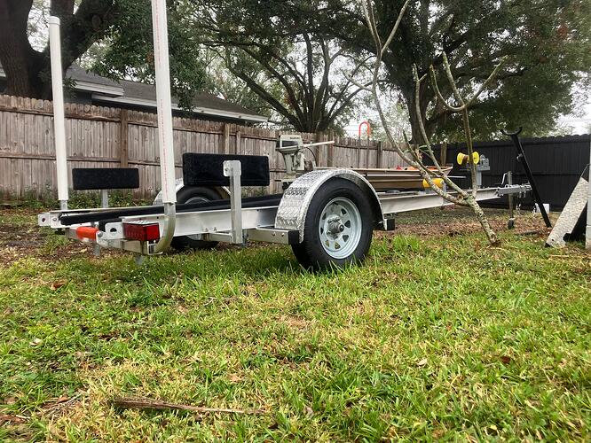

I don’t why an off-brand aluminum trailer that fits your boat would be any heavier than any of the top “skiff” trailers. My trailer for example is 3" x 4.4" I-beam with a 60" wide frame. I would guess that is a very common size. It would fit you Beryllium like a glove.
If I build another Conchfish or the Glades 18, I’m 100 % building my own trailer and sticking probably $3k in my pocket. There is zero welding on my current trailer.

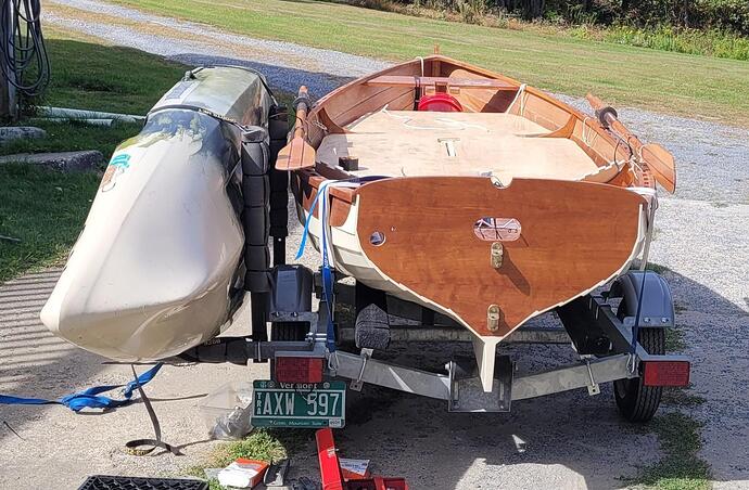

More of my trailer-madness - DRZ400 mounted like a side-car on my FS14 trailer. Worked great for a shuttle vehicle when the RV was setup at a campground. We’ve since switched to a truck-camper and ditched the DRZ. Did 3 round-trips to FL like this. Good idea? Maybe…..
