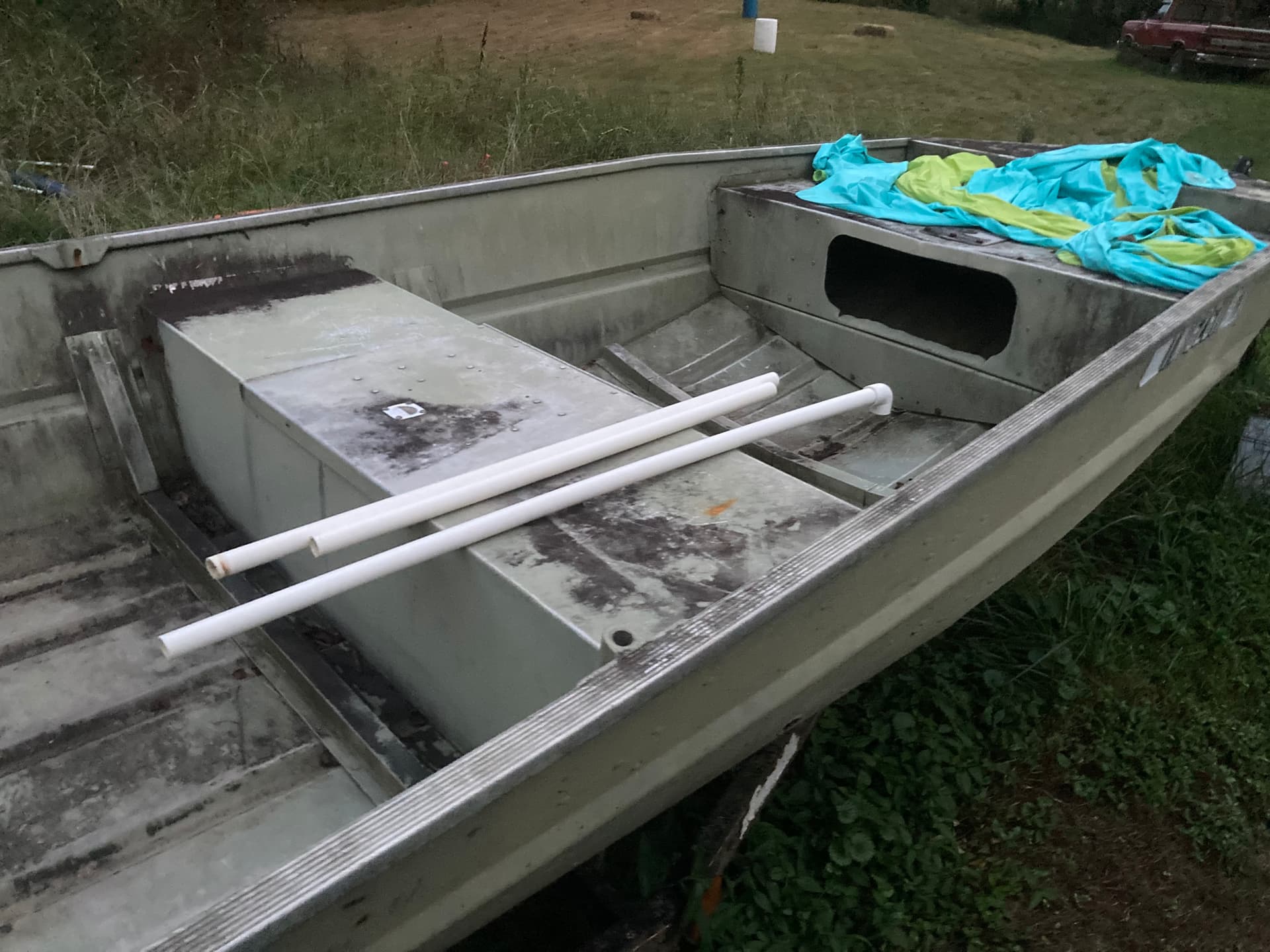

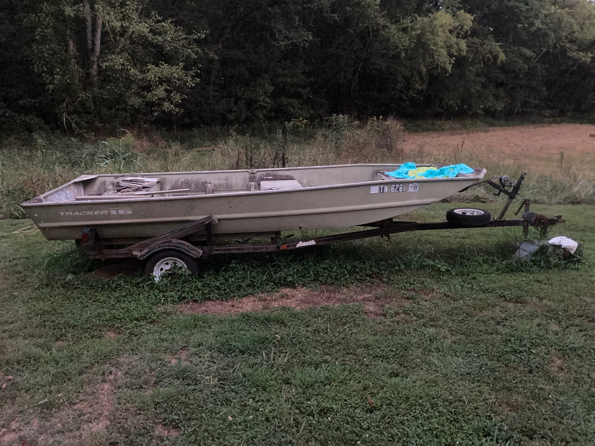

This my project boat. I seen a tracker backcountry one time and going try to turn this into a version of that. That’s the basic idea anyway. Got the rotten transom wood out and work my way forward from there. Lots of work to do but I like to tinker

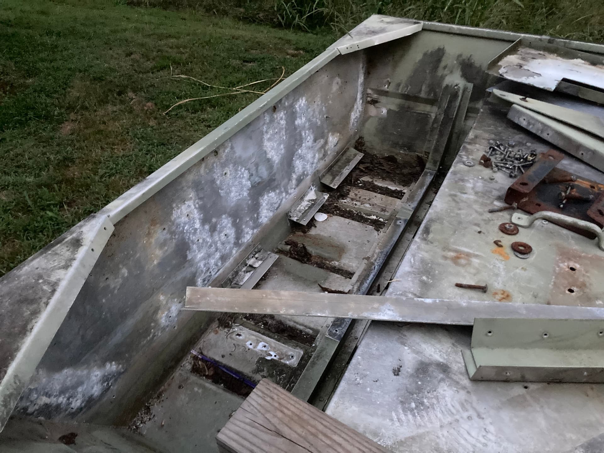

@Butch - does that hull have any pinholes/ galvanic corrosion breaches? If so, curious about how you plan to address.

@MaverickMA Surprisingly no. I filled it with water and had one rivet leak that I mashed back down with two hammers and coated with JB weld on the inside and out. There is some light corrosion on the transom behind the plywood but I’ll and and repaint. The rough part was drilling out the rivets to get all the brackets holding the plywood in.
