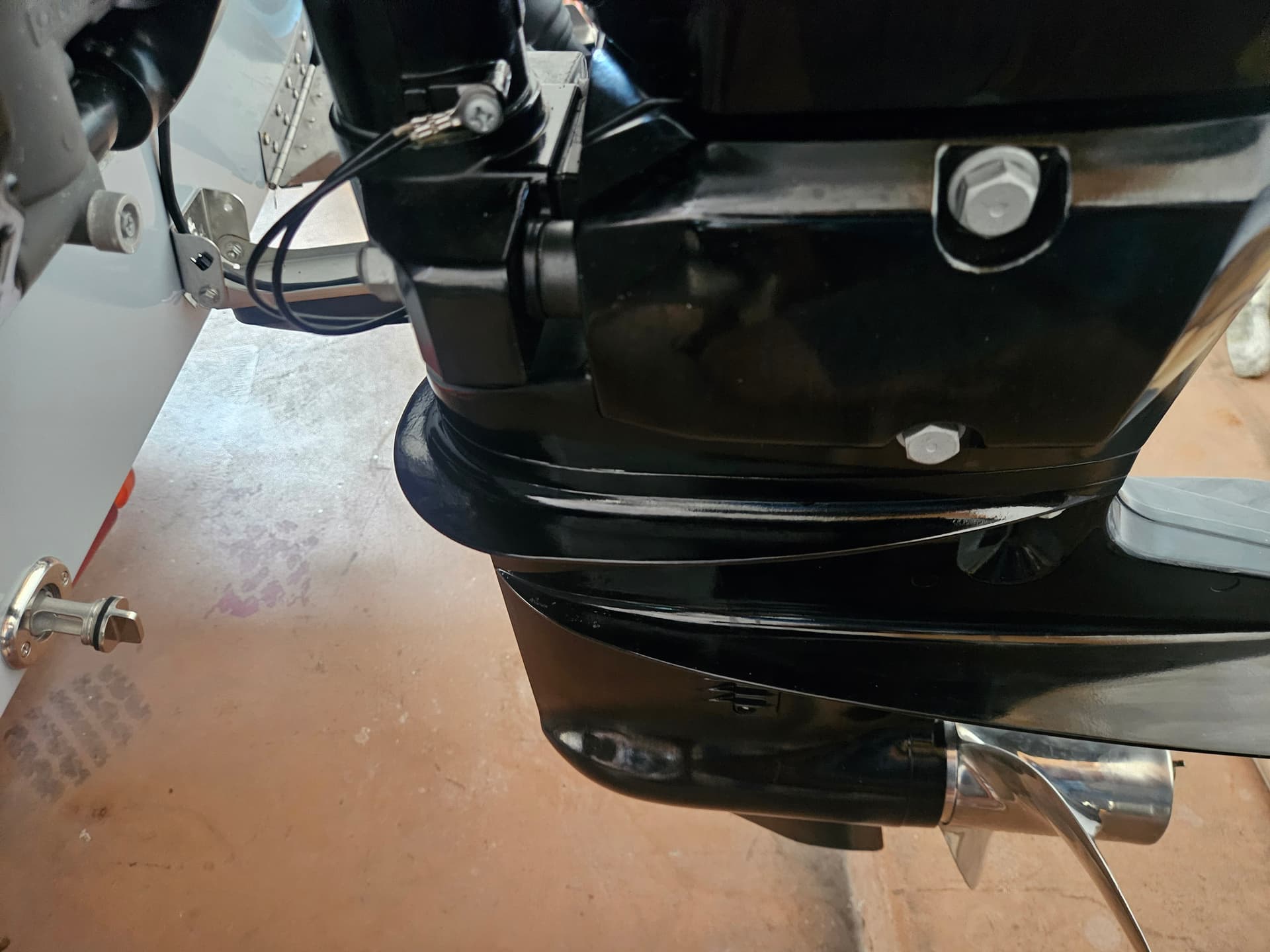

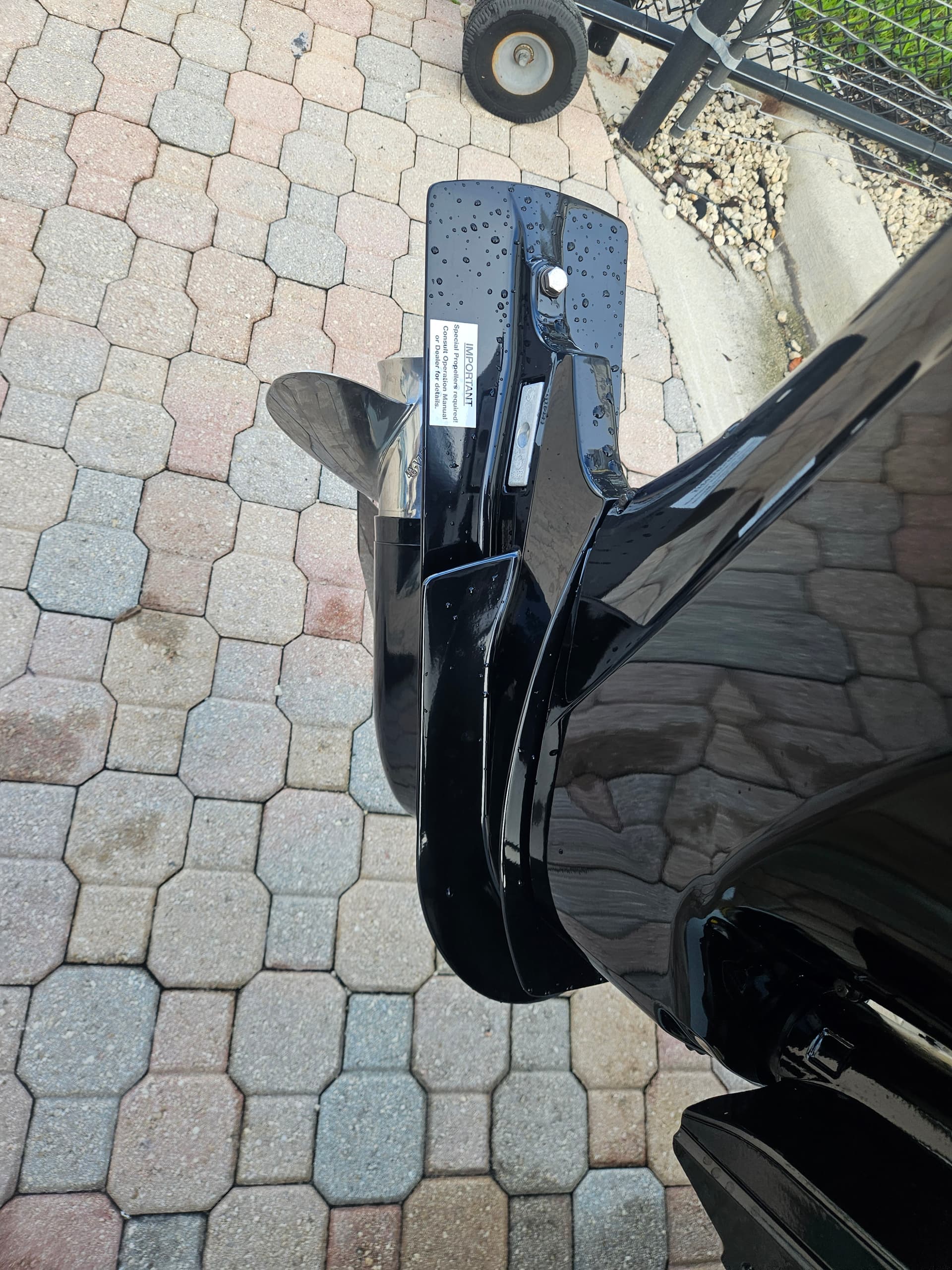

I have a 60 suzuki and have my motor bolted high on my transom. Before it was mounted 2 holes lower. I had a v spray. 2 rooster tails. Reason for raising it all the way. Once I raised it, the spray significantly went away but not totally. I realized the spray was coming from the place water hits the lower unit. After looking at other brand outboards I noticed suzuki has a small cavitation plate above the normal plate. Other outboards are larger and some have 3 instead of 2. Im in the process of making a larger plate out of carbon to fix the issue. Any input is welcome. I’ll post pics and update everyone once I make/ test it.

Mercury vs suzuki big difference. While running the boat i can see the purpose of this upper plate.
I can’t tell how high your outboard is mounted from those photos. I can tell you if water is coming over the bottom plate your outboard is way too low which is the case on a majority of skiffs these builders sell. They are scared to death to raise an outboard to a reasonable height from the start. You probably haven’t done the water pressure valve flip mod or sealed the third water intake which are both the very first things I change when a DF60 comes through my shop. Both improve water pressure and help with overheating.

My eastcape evox17 runs great at this height. Without a jackplate. The point of this post was to compare the secondary plate above the cavitation plate. Reason why im fabricating a carbon plate to eliminate any minor spray. I know set back would help and a jackplate like mack suggests will stop the spray. Thats not the point of this post. Its mainly to show how small suzuki under engineered this plate.
