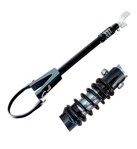

@VinnyL The steering friction adjust will probably not be strong enough; it is NOT for me. I have used the bungee/cord method that @Oyster referred to. Lately I have started using this device as recommended by @DBStoots….
https://www.amazon.com/dp/B00H86JS48?ref\_=ppx_hzsearch_conn_dt_b_fed_asin_title_1&th=1

Never thought about that to be used for both, a transom saver and steering stop. I’ve been using one on the Evo in addition to steering stops
. :person_facepalming:t2:

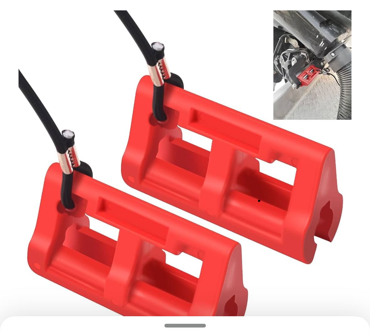

Those won’t work on your tiller. No rods.
I know, it’s what I’ve been using in addition to the transom saver
on the Evo. I never realized the TS also acts as a steering stop.

Unless you forgot to strap your boat down on the trailer it’s not moving on the trailer. That little springy shock absorber on the transom saver is actually increasing stress on your outboard’s tilt / trim hydraulics. A solid transom saver keeps the road bounce from being transmitted to the hydraulics. I imagine it’d do a better job of keeping the outboard pointed straight ahead, also.
Solid TS example please?
Most are solid. Very few have that spring-loaded shock absorber shown in your photograph.

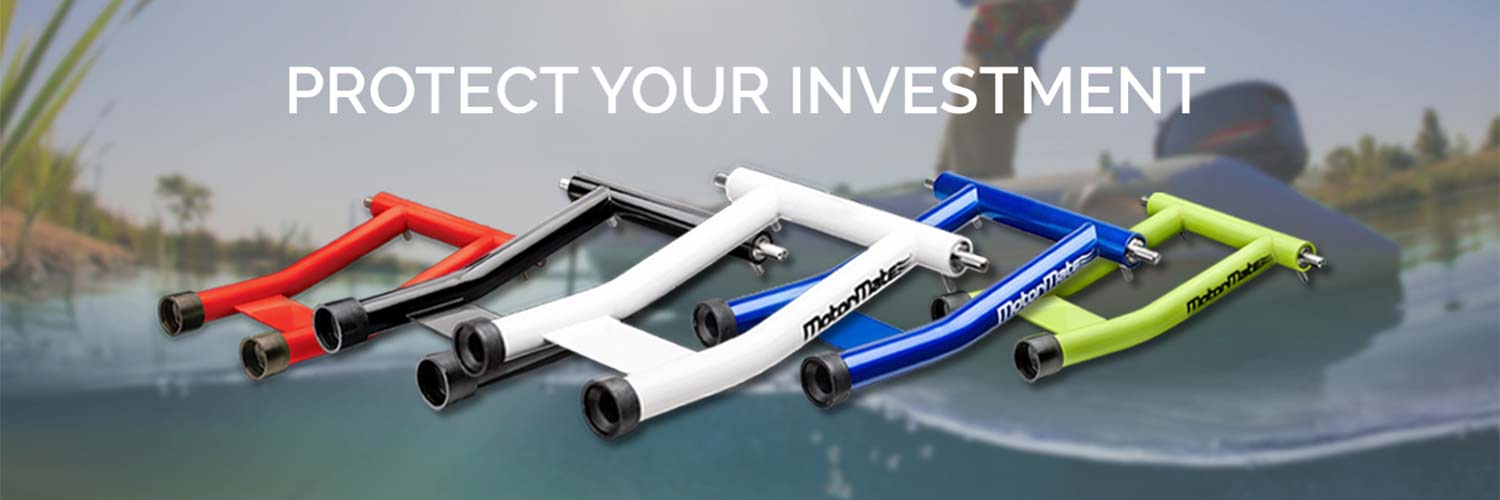

Made in USA and outboard specific…

I went down this rabbit hole with my F40 yamaha. Motormate won’t work. The little yamahas don’t have the place to “push” on. I had to go another way.
I think Vinny is getting a Tohat? Hopefully these will work for him. They are great devices.
They don’t have a Suzuki or Tohatsu application. Motormate that is.
I bet I could make one work
