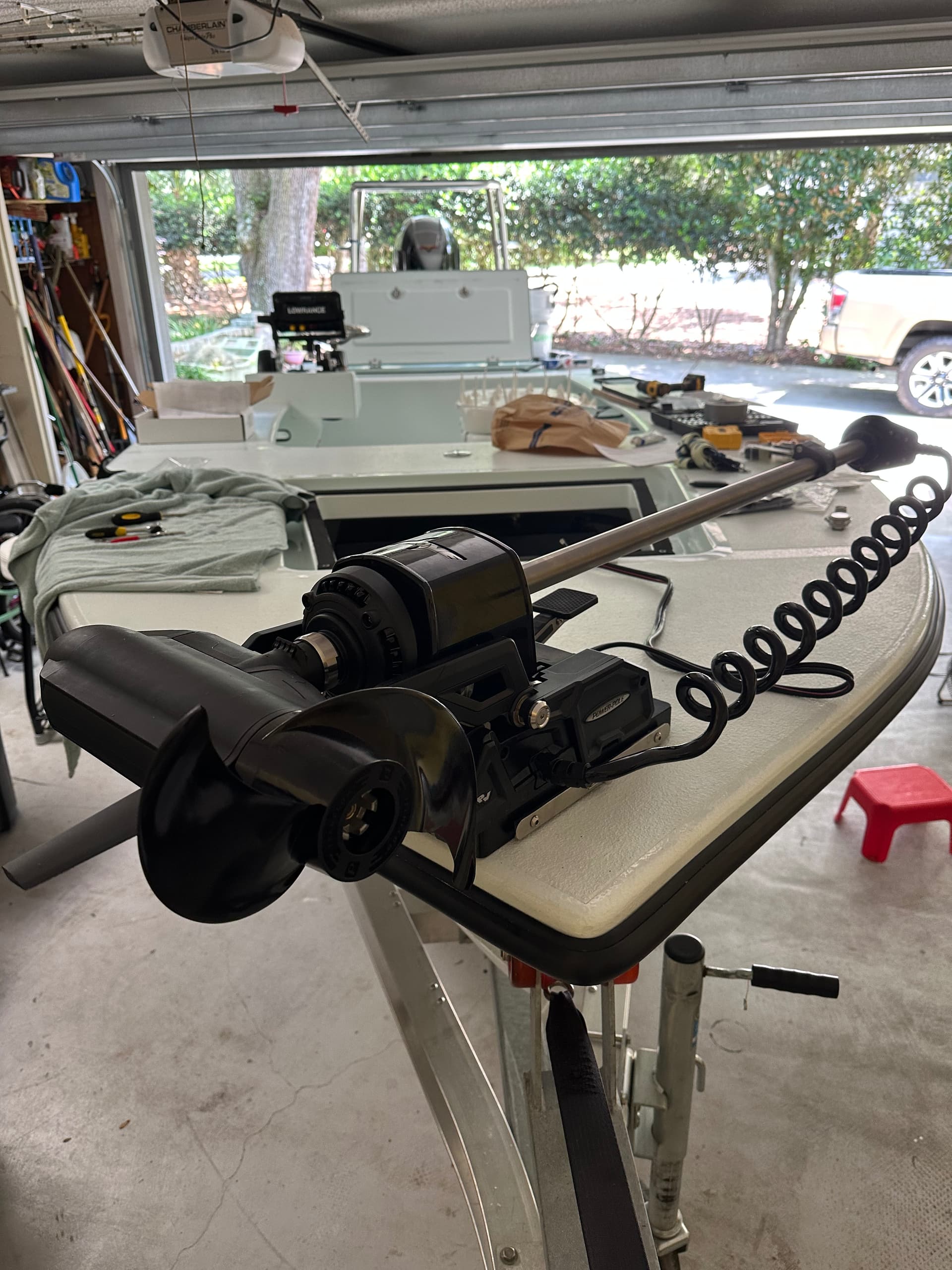

I splurged and got the power pole move pv trolling motor in the 45” variant. The forward deck of this boat was thoughtfully constructed and reinforced with coosa board, and mounting the trolling motor puck was very satisfying because I could comfortable fit inside the forward hatch, and I could really crank down on the installation hardware without worry. I chose the standard mounting position mainly due to the location of the coosa, but I also wanted to keep the skiff as balanced as possible. The front deck of this boat is so large and very beamy so the trolling motor heads sits completely inside the rub rail with zero overhang. The 45 inch length is perfect for this boat even with its extra free board. To power the power pole move I purchase a li time 36v 50ah Bluetooth group 31 battery. I mounted the battery in the aft hatch port side right behind the house battery. This helped balance out the weight of the side console and as well the weight of the trolling motor forward. The power pole move is pretty heavy. I believe it weighs 45 pounds. Everything they say about the move is true: it’s quiet, powerful and efficient.

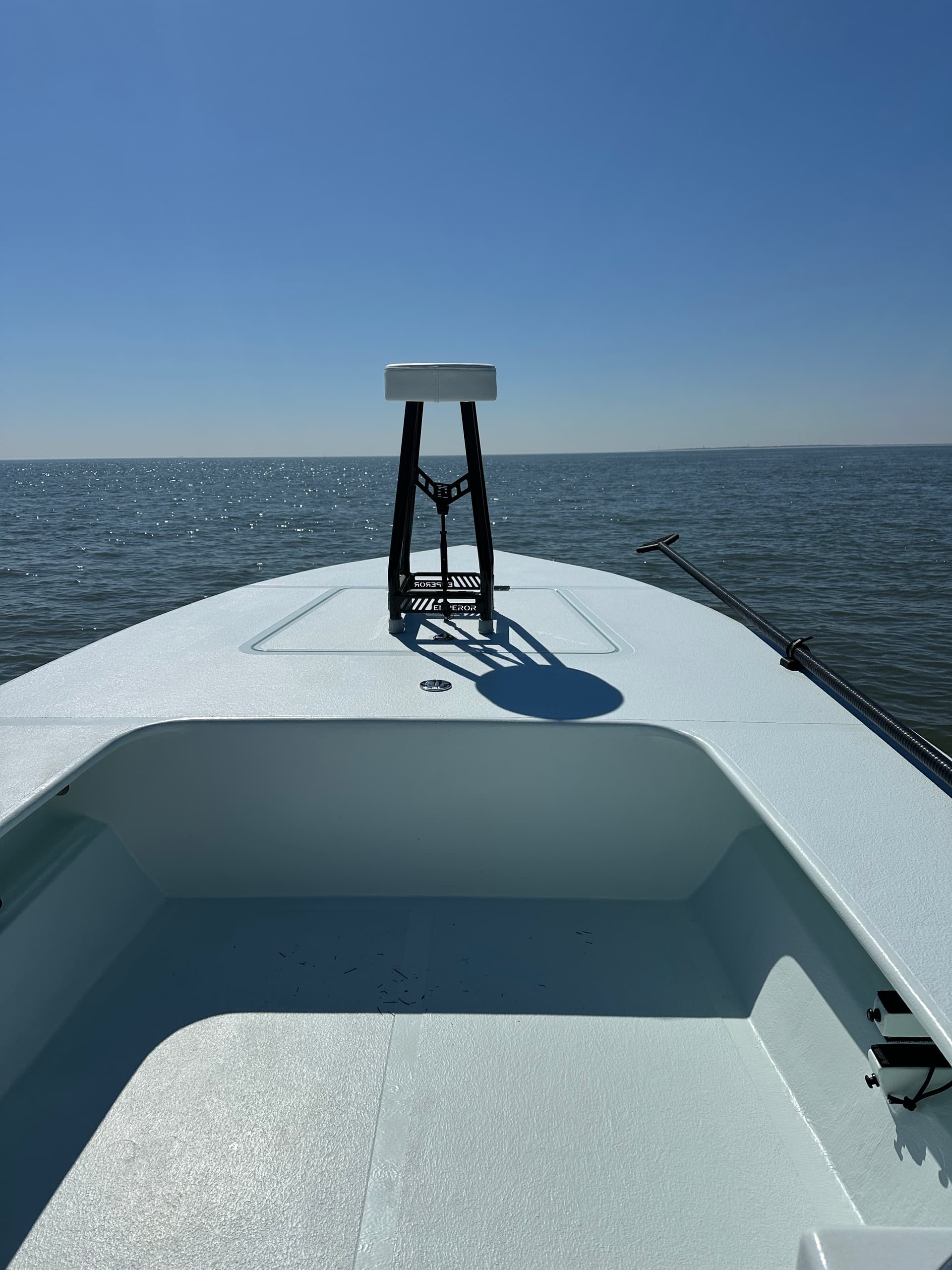

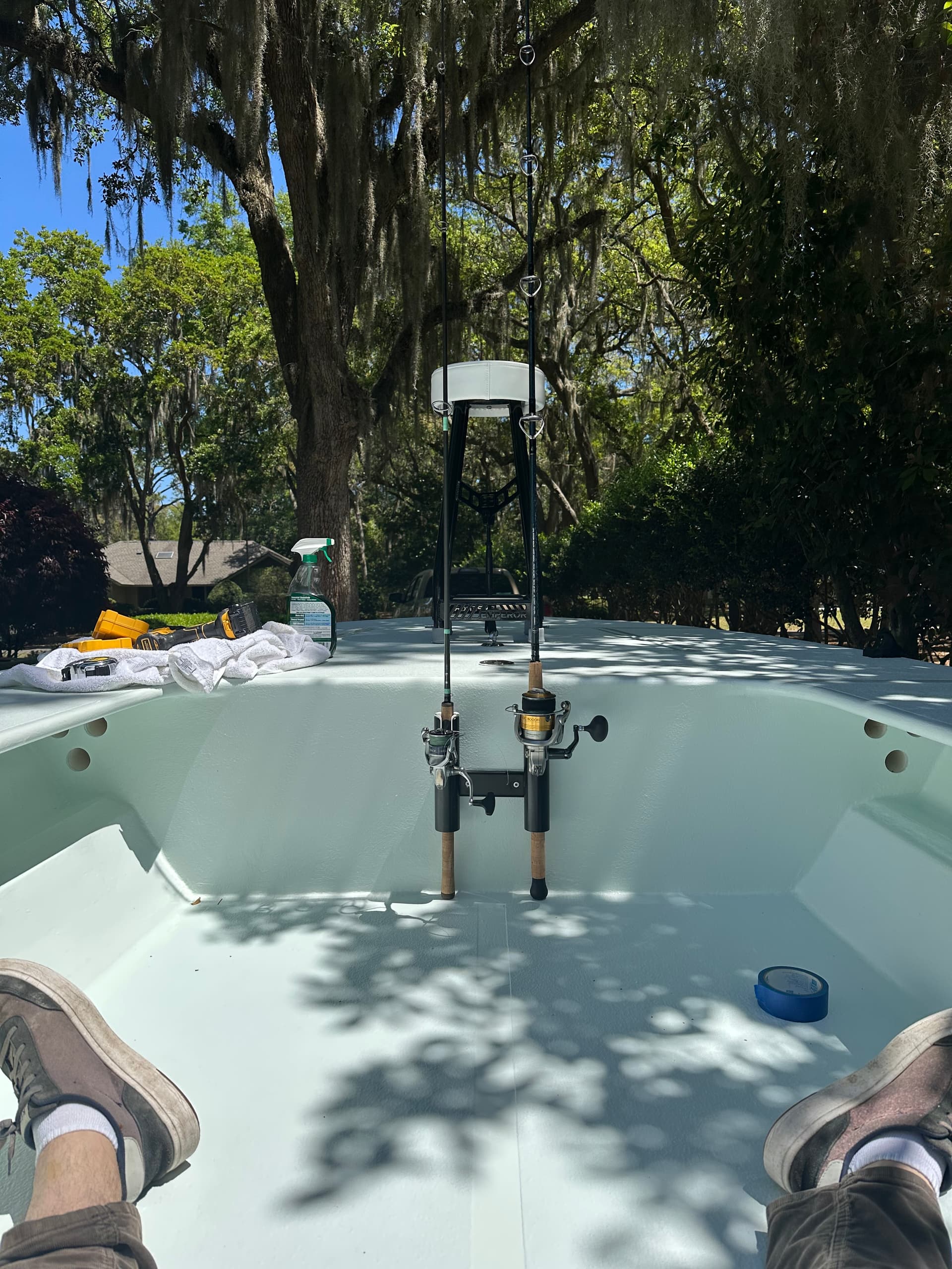

I found a killer deal on a black tip emperor stool from tailwater outfitters during their Black Friday sale. I went with the Kennedy tiedowns, low profile mount, and purchased my turnbuckle from vMarine. I think the turnbuckle alone was $60 but it’s extremely beefy and really keeps the emperor stool secured in place. I wanted family and friends to be able to sit or lean into it without any concern or worry of failure. I’ve seen some of these stools in the past on other people’s boats and they use these little dainty Turnbuckles commonly seen on casting platforms, and it just didn’t sit right in my mind. As well to further reinforce the stool I used a piece of starboard on the underside of the forward hatch lid, so I could really tighten the stool down without worrying of ever crushing any core materials. It’s solid as a rock and I have 100% confidence in this stool. The only thing I might change in the future would be removing the existing hinges to replace them with the most beefy ones available. Between the gas struts and emperor stool they are under a lot of pressure, but as of now are holding up just fine without issue.
The under gunnel rod holder situation on this boat pretty much allows me to only use the port side for rod storage. The side console limits the starboard storage and I have dedicated that to my anchor stick. Port side I can comfortably store two fly rods and two spinning rods without issue, but I wanted an option for quicker storage and retrieval. I ended up ordering a low profile, dual rod holder from Boat outfitters it is open ended version with a nice plastic insert. It is very thoughtfully made in that it can accommodate inshore spinning rods, larger diameter rod butts, and even holds a fly rod perfectly secure with the design of its opening. Initially, I wanted to mount a dual rod holder to the side console, but with the slight overhang of the steering wheel the rod holder would have needed to stick out at least 4 inches for guaranteed clearance. This is why I went with the low profile, dual rod mount from boat outfitters it basically sits flush to a vertical surface. I decided to mount it on my forward bulkhead so that you can grab a rod from the forward deck or the cockpit with ease. I know the placement is a little unorthodox but overall I’m very happy with it. The only slight issue with this placement is that you can’t walk the centerline of the skiff to get on or off the front deck. You kind of have to pick one side or the other (not a big deal at all since the deck has so much room). Another great thing about this forward bulkhead location is that you can place an umbrella in the rod holder and it provides a great centralized spot of shade for the sandbar days.

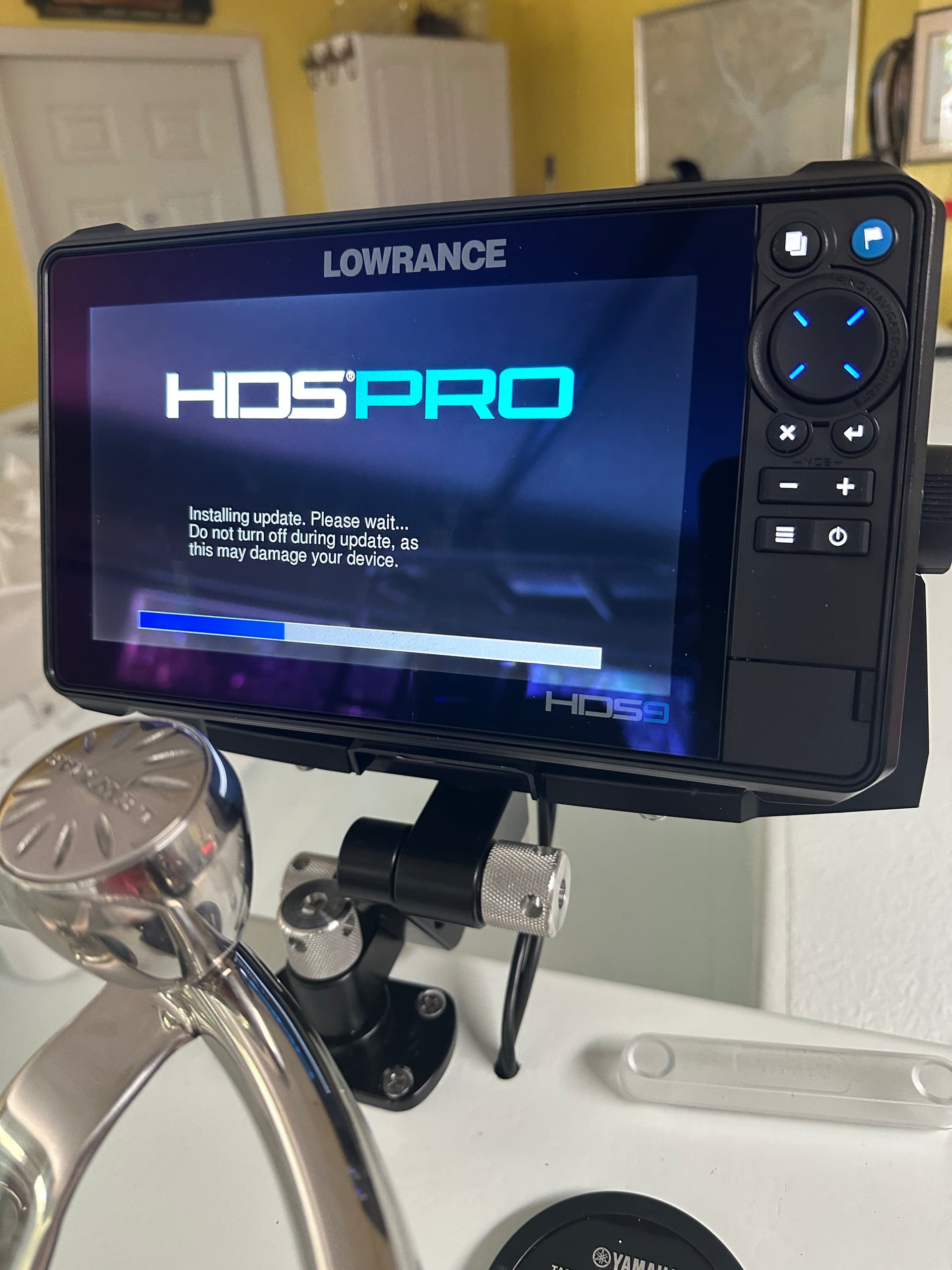

Moving back to the side console, I installed a 4” balzout mount and a lowrance HDS pro 9” unit. The height of the mount and its adjustability gives me complete visibility of the screen and as well I can make adjustments while keeping my hands on the wheel and throttle. I’m very happy with the quality of this mount. It is rock solid, I like the adjustability, and think it looks cool as well.

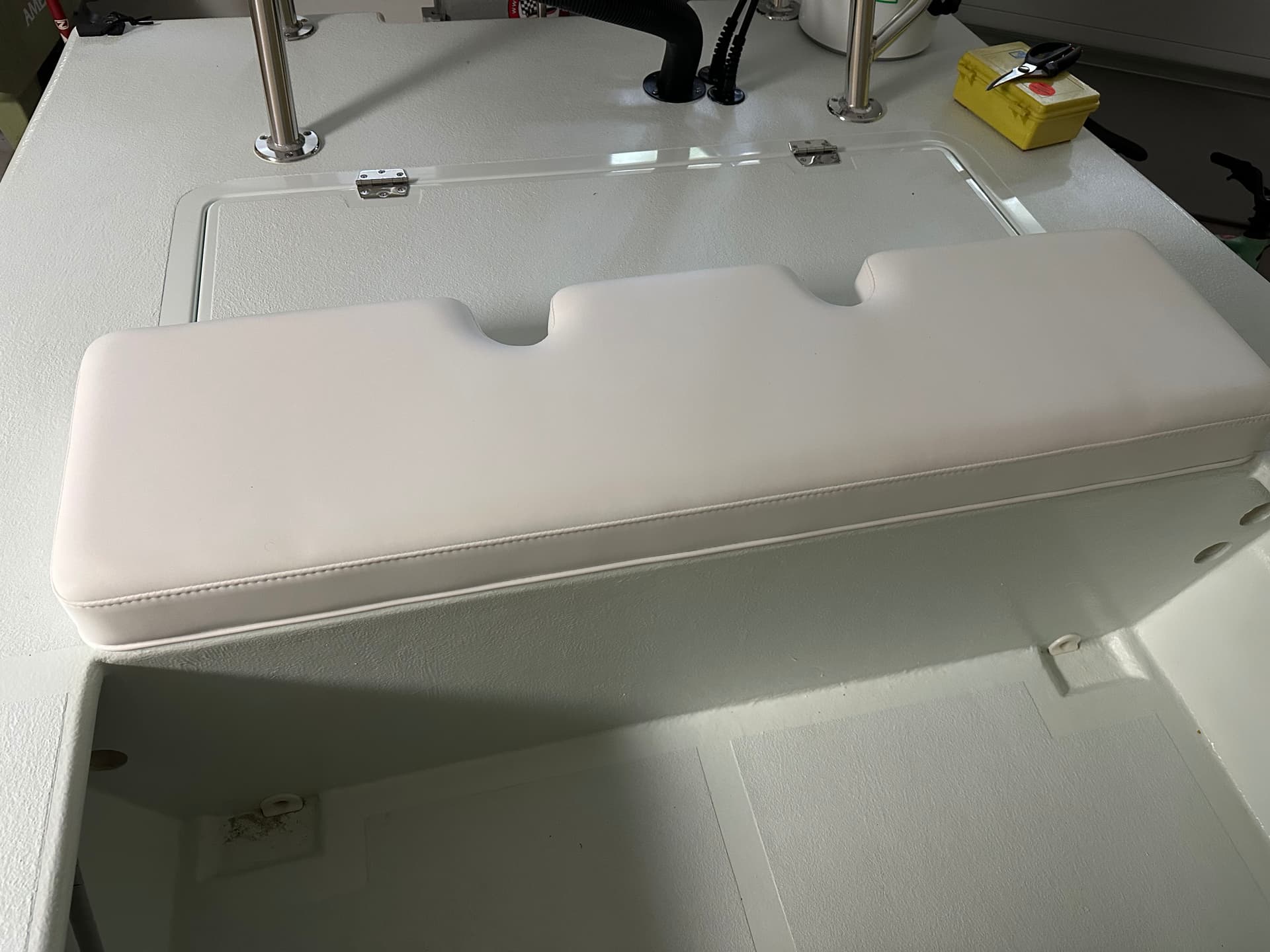

Cass at new Moon upholstery made me a really nice double thick cushion for the aft deck. He was a really nice guy to talk with, the process was easy, and most importantly the product turned out spectacular. He does great work and uses top of the line materials. There’s a reason you see new moon upholstery on high end skiffs. I chose all white with the “smooth” finish.

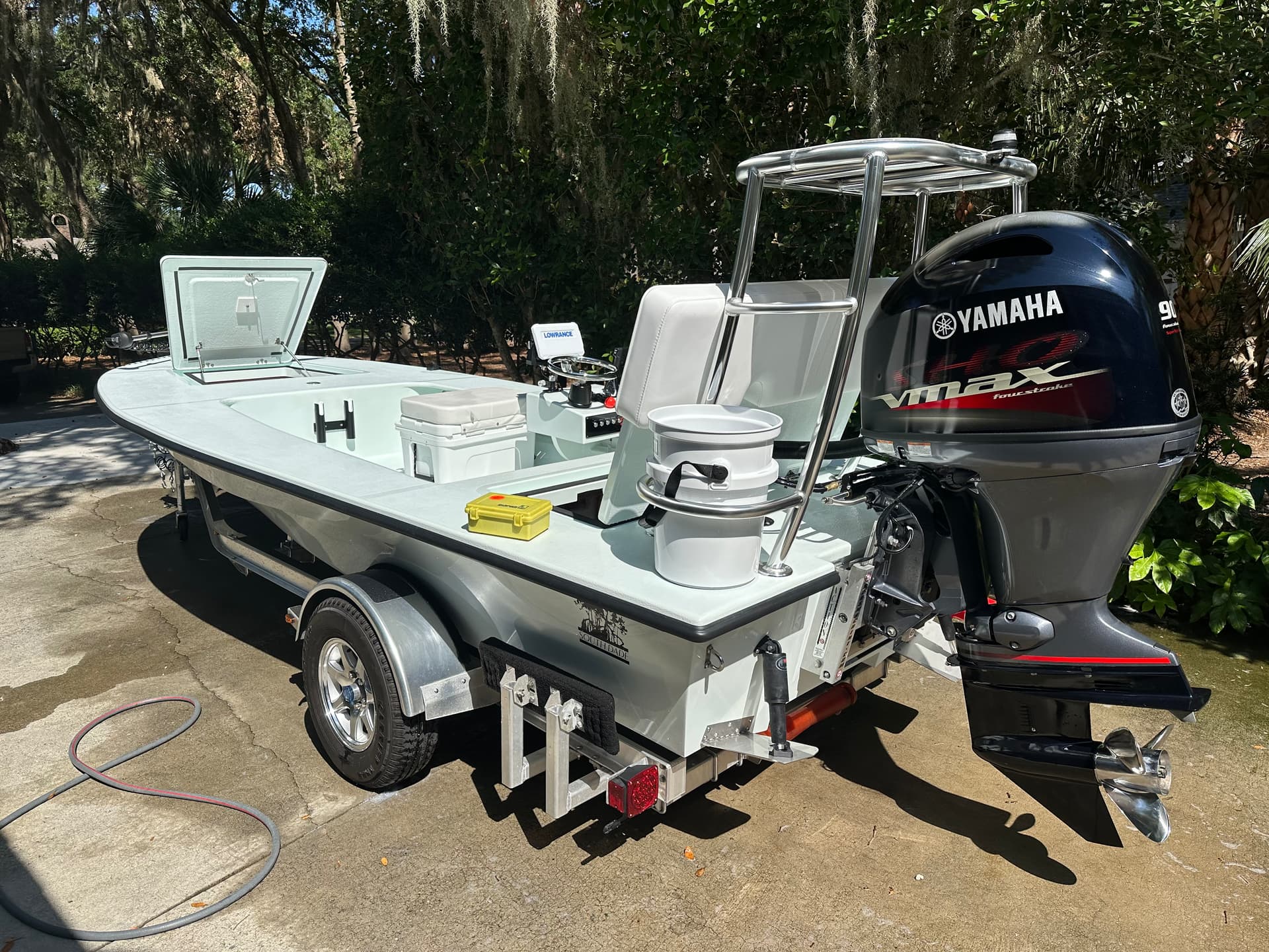

When building this boat with Louis gave me multiple options for engine power, although I’m a diehard Yamaha guy. I went with the Yamaha 90 sho, and I’m very happy with its performance and find it aesthetically pleasing. The mid range torque on this motor is insane and can go from 30 to 45mph really quick. Finding the right prop for this boat was a little bit of a challenge, but I ended up having Baumann propellers do their magic on my power tech PTR three blade. With the stock ptr 3 blade I was getting blow out in sharp turns and when raising the jackpkate. The newest generation of power tech cushion lock hubs is very pleasing, and there is zero clunk or rattle when slowly shifting in and out of gear or at low idle. This skiff can really scoot, but I find myself normally operating around 3700 RPMs and roughly 30 mph.

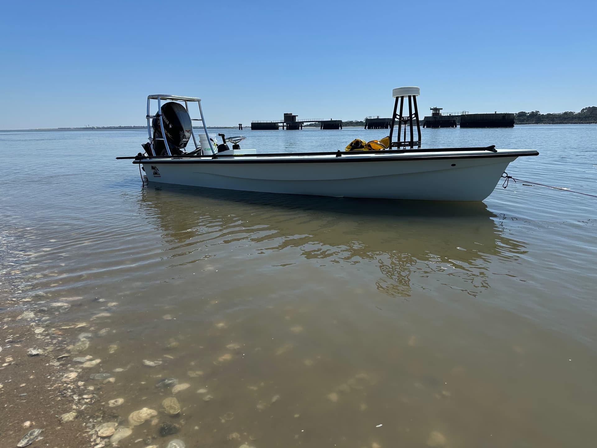

Let’s get down to real world performance numbers.. I’ve found that under normal circumstances this skiff drafts an honest 10 inches of water. The Yamaha 90 sho with a heavy cupped Baumann prop pushes the skiff 46 mph at 5900 rpm’s (almost a little too fast for me). I’m sure others with a lighter example Could see numbers as low as eight inches, especially if they went with the Yamaha f70 for power. I think the Yamaha f70 would be a great motor for this boat, and if I could do it all over I would have gotten the 70. In terms of handling characteristics, this boat has zero bow steer which is something I really like. My old whipray and B2 could throw you for a surprise when crossing certain wakes. The only thing I don’t like about the handling of this boat is that in a beam sea it is honestly a little wet which is surprising considering the massive spray rails. Oceanside on anchor or trolling motor this thing is a beast and it’s hard to take one over the bow. As Luis has mentioned multiple times this skiff rides great in rough conditions. I can cruise the icw at 30 mph and don’t have to slow down for the big boat wakes which is a major plus! I had the boat built heavy, and in my opinion it still poles pretty easily. Once you get it going it tracks very well and can spin/maneuver easily. One cool thing is that if you bottom out on the pole you can use the 12 degrees of dead rise to kind of put the boat on its side and keep on trucking.
