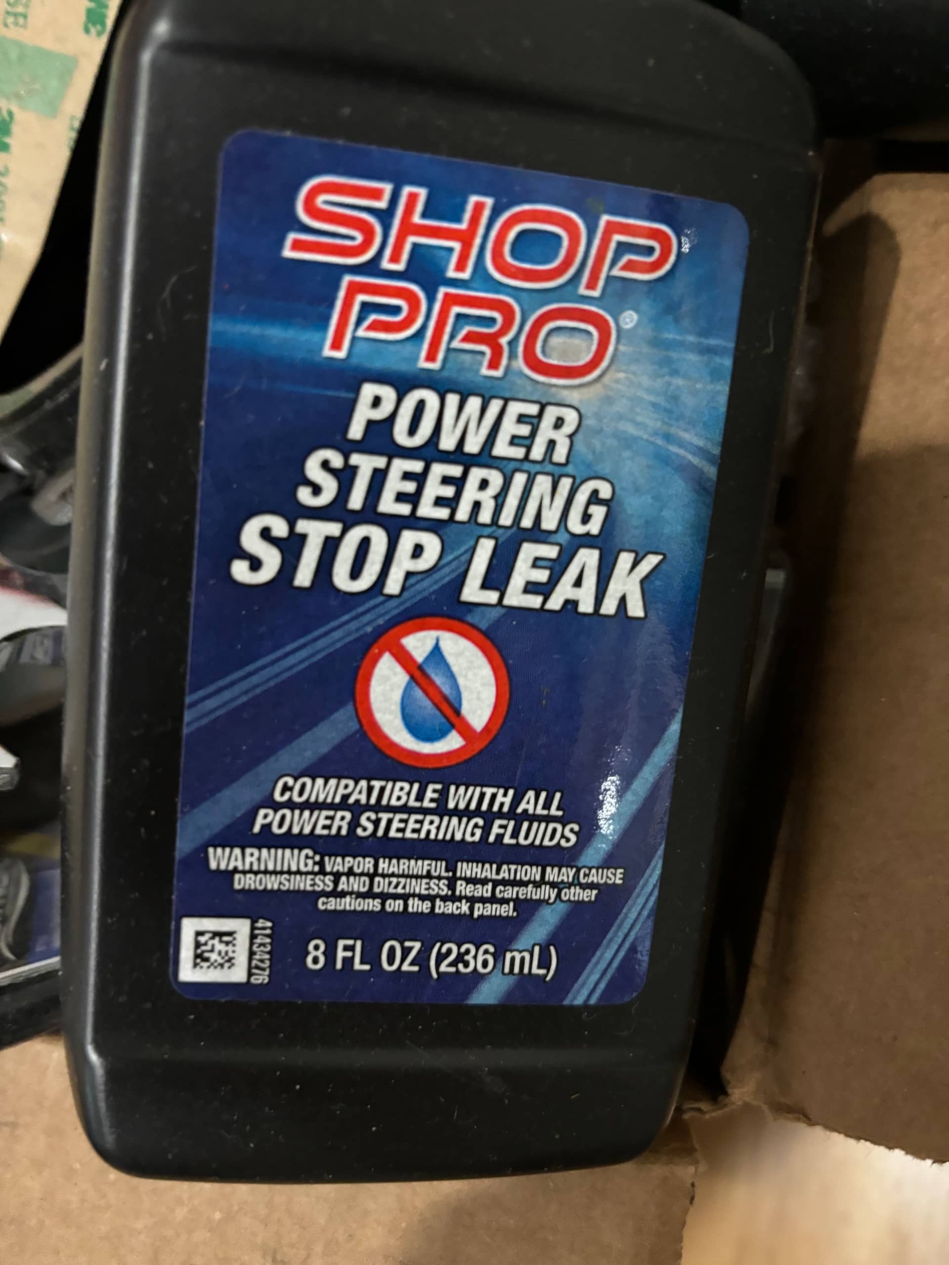

On a separate note, curious if anyone has a reaction to me trying this to continue to loosen that valve. I dont have leaks but this is also a conditioner for o rings.
Thoughts? The recent improvement after the fluid flush has me thinking I am just dealing with residual sludge.
Until you can’t steer going 30 mph on a curve. There is a risk/gain factor in your steering, if it is still happening and it’s not smooth the way it’s supposed to be, the problem still exists, finding out it got worse at the worse possible time is Murphy’s Law. I would either replace or rebuild until it’s smooth the way it is supposed to behave…that’s just my comfort level…
They way any “stop leak” works is by a solvent additive that swells the seals. It will also soften the seal. The downside: the seals wont last as long, and damage easier, creating more leaks.
Im with Loogie, there is no snake oil fix. Its a mechanical problem. Use it until it starts going down hill, then fix it. Maybe you will get lucky and the use will help it to settle in. You have done all you can do.
Fix that steering the right way before you become a statistic…just my opinion!
