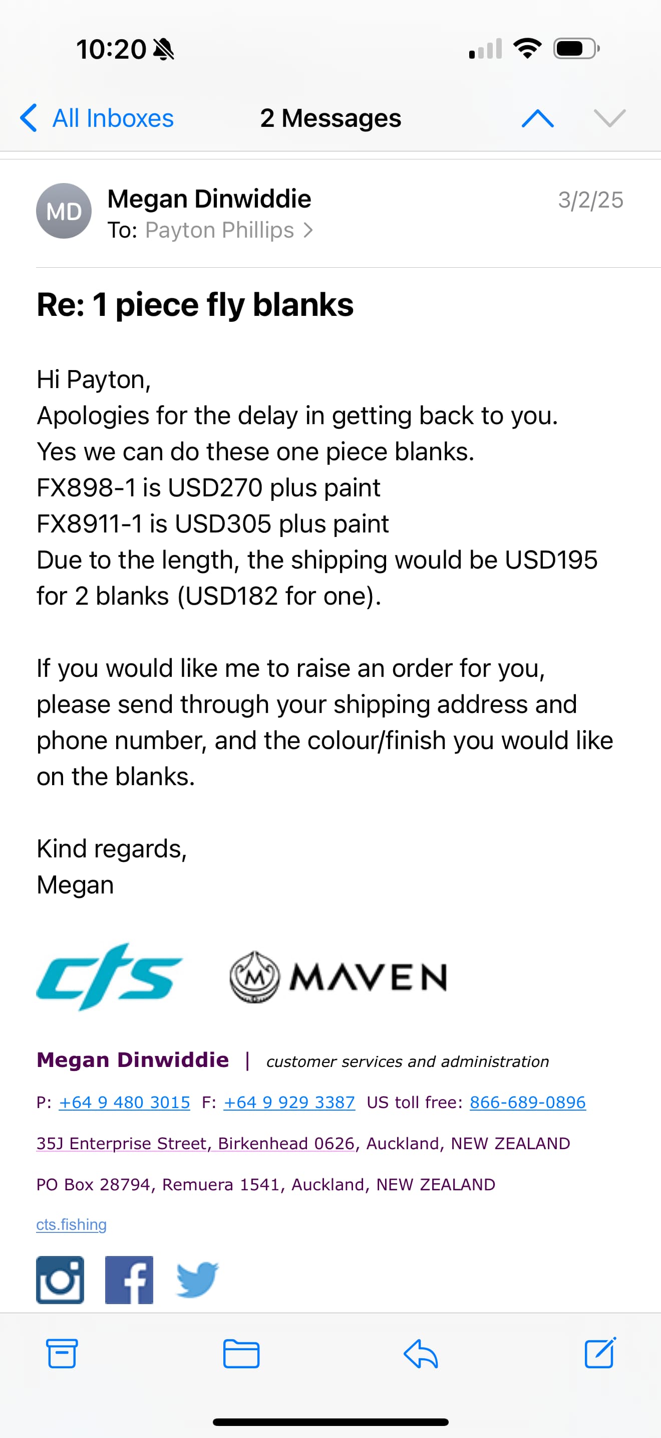

You can buy the Maven Blanks from CTS. My next tarpon rod build will be a 1 piece CTS blank. Here is a picture of an email I received from them and prices for the blanks. Shipping cost sucks but I’m going to to order at least 2 blanks when I make my purchase.
