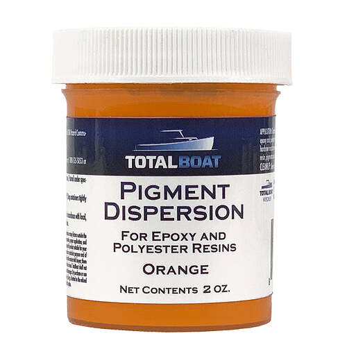

Let’s think about this. The pole is made up of three materials… epoxy, fiberglass, and carbon fiber. Why use anything other than epoxy to refinish it??
Add some pigment if you want total black out.
Mix it up and brush it on, make a rotisserie if ya want to get fancy. It’ll be just like epoxying a rod blank.
