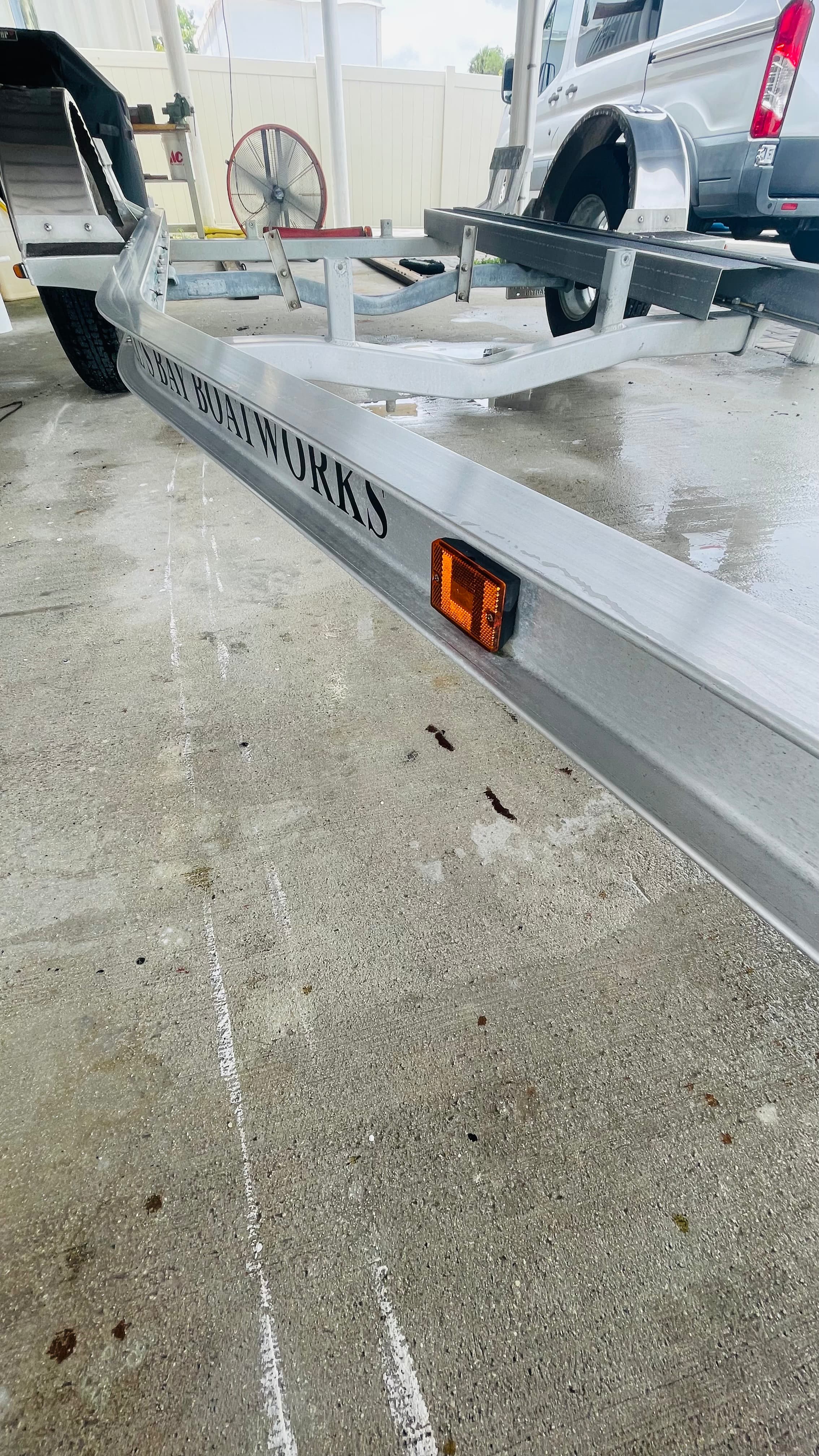

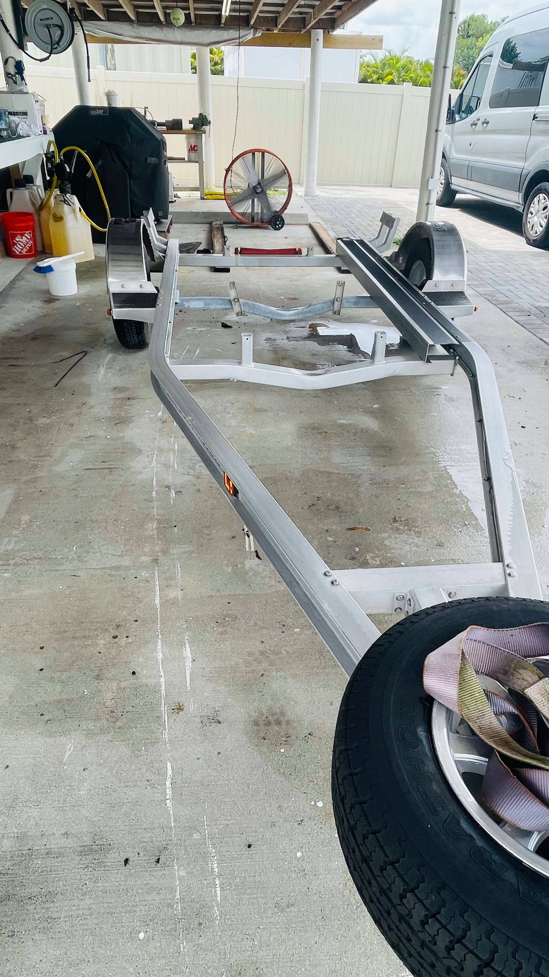

Currently bringing a customers Ramlin back to life with some new bunks. The trailer itself is in pretty rough shape for being around 10 years old. Didn’t have any aluminum cleaner on hand so I checked the google. I saw suggested was using a 1:1 mixture of vinegar and water. I had some cleaning vinegar and an empty spray9 bottle. Sprayed the areas and hit it with a scotch brite pad. Spent about 30 minutes on it all and pretty surprised on how well it cleaned up. I know the aluminum cleaner would have done a better job but for light oxidation I think this worked pretty well. And of course I didn’t take any before photos..
