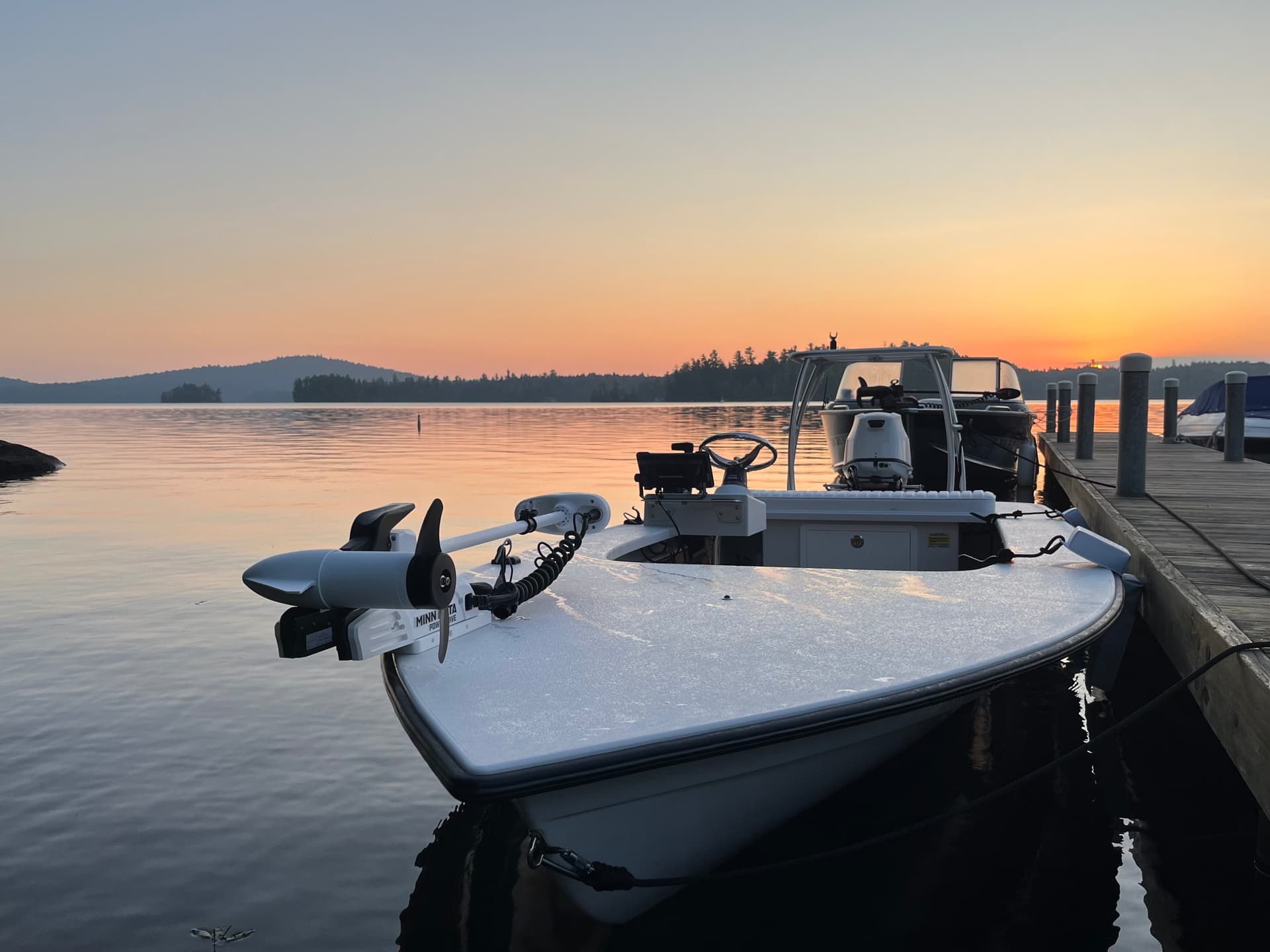

So far it’s providing the performance I was looking for. It poles easier and much quieter than the Towee. I’m enjoying its stability running in some chop or around a lot of boat wake. It’s fast: I’ve seen 32 mph at full throttle. Still feeling out and breaking in the motor. The trailer is super nice. Solo with the TM, it lists starboard. Probably nothing to do about that. I push the gas tank to port. When on plane it’s easily fixed by a little trim tab. I haven’t poled solo yet, so I’ll have to update with that.

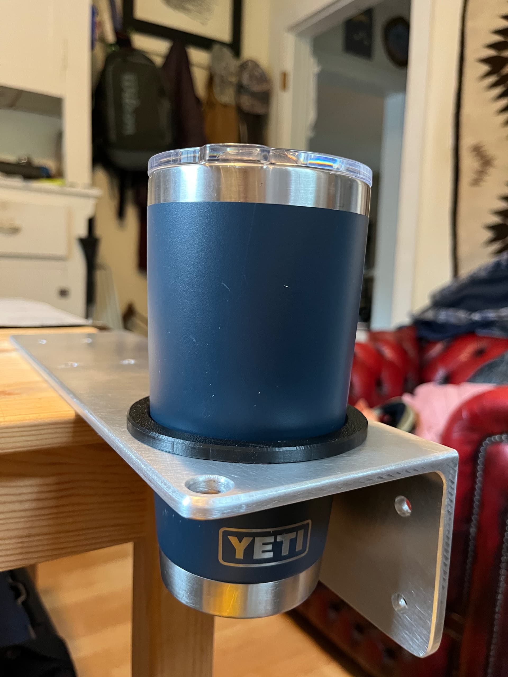

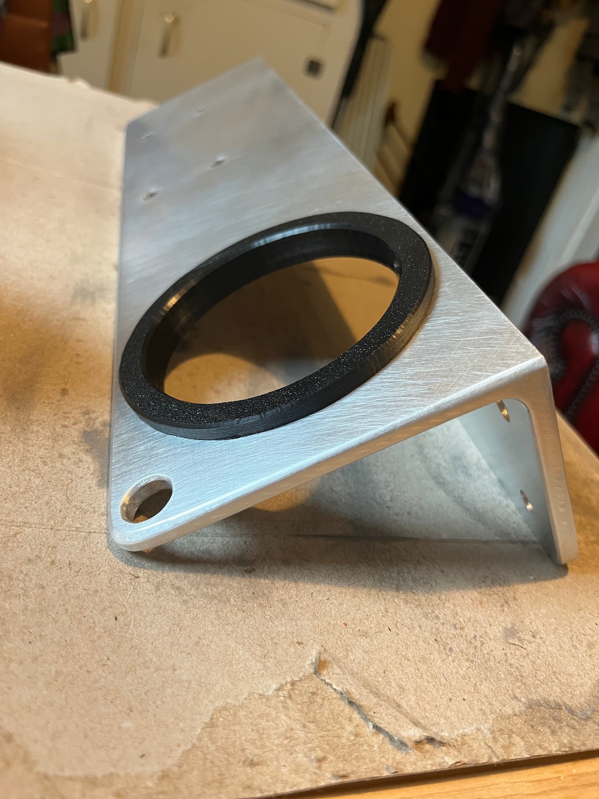

While I was waiting for the build to come together, I kept busy by making a bracket that bolts onto the side console for mounting my 9” Humminbird Xplore and holding a cup.

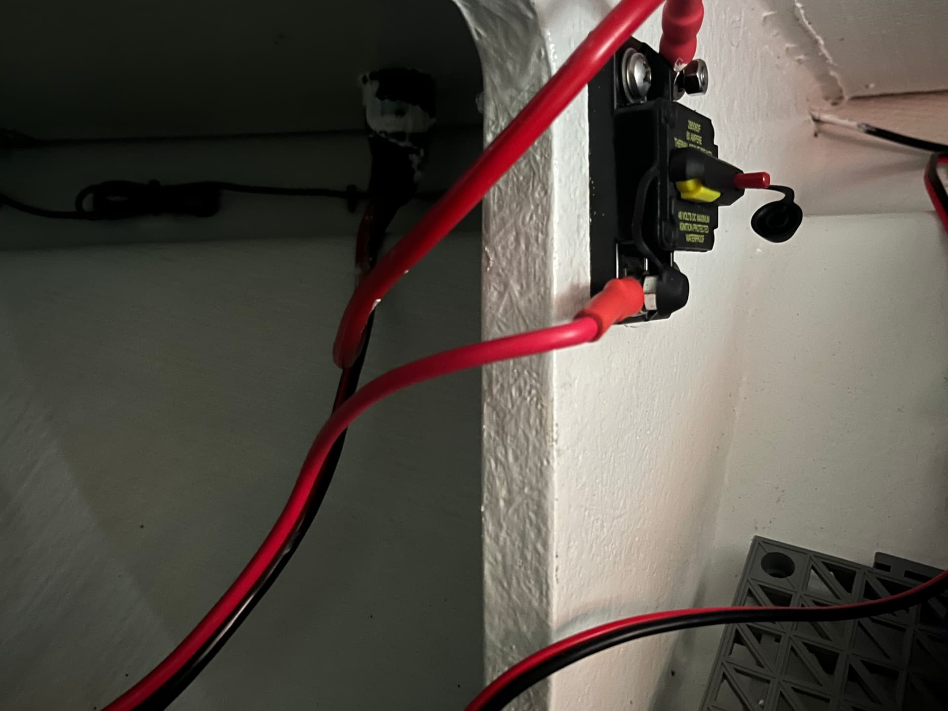

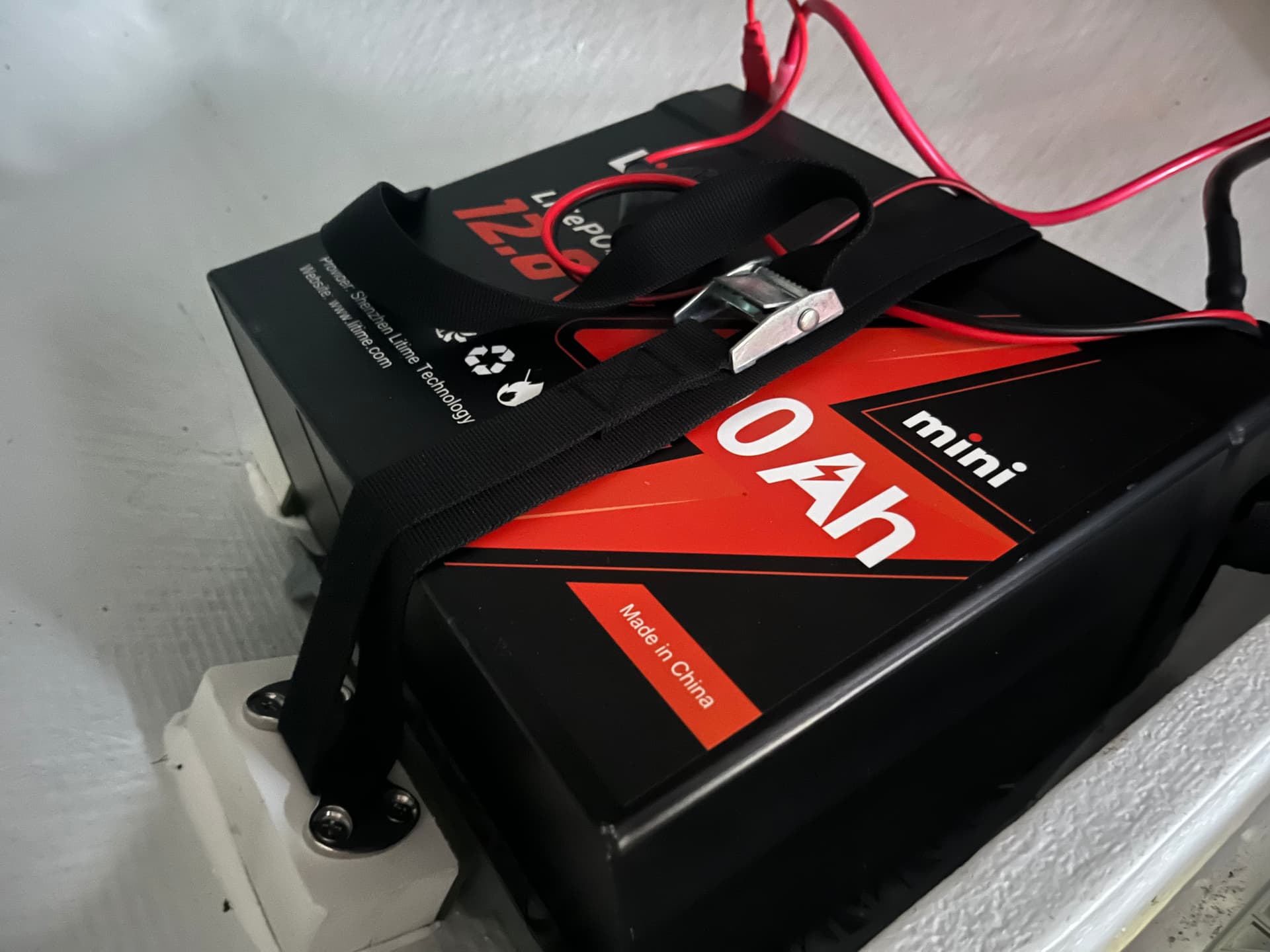

I “guide” mounted a 12V Minn kota riptide power drive with spot lock to the starboard side of the deck. I ended up using the Minn Kota plug because I didn’t think the powerpux would fit. I also took about 12” off the TM shaft and mounted the LiTime LiFePO4 battery in the bow just forward of the forward bulkhead. You can probably see what I did in the pictures better than I can explain it. Basically, I screwed tie downs to small blocks of PVC board and glued them to the hull with 5200. Battery is laid down in between and held down with a strap. I was totally improvising here, but it has held through chop and about 800 miles of trailering. Long-term remains to be seen. Ran the + wire through a 60A circuit breaker that I mounted to the bulkhead. The Li battery lasted a full week of daily fishing on the lake with lots of spot lock and TM use. This is a major performance upgrade.

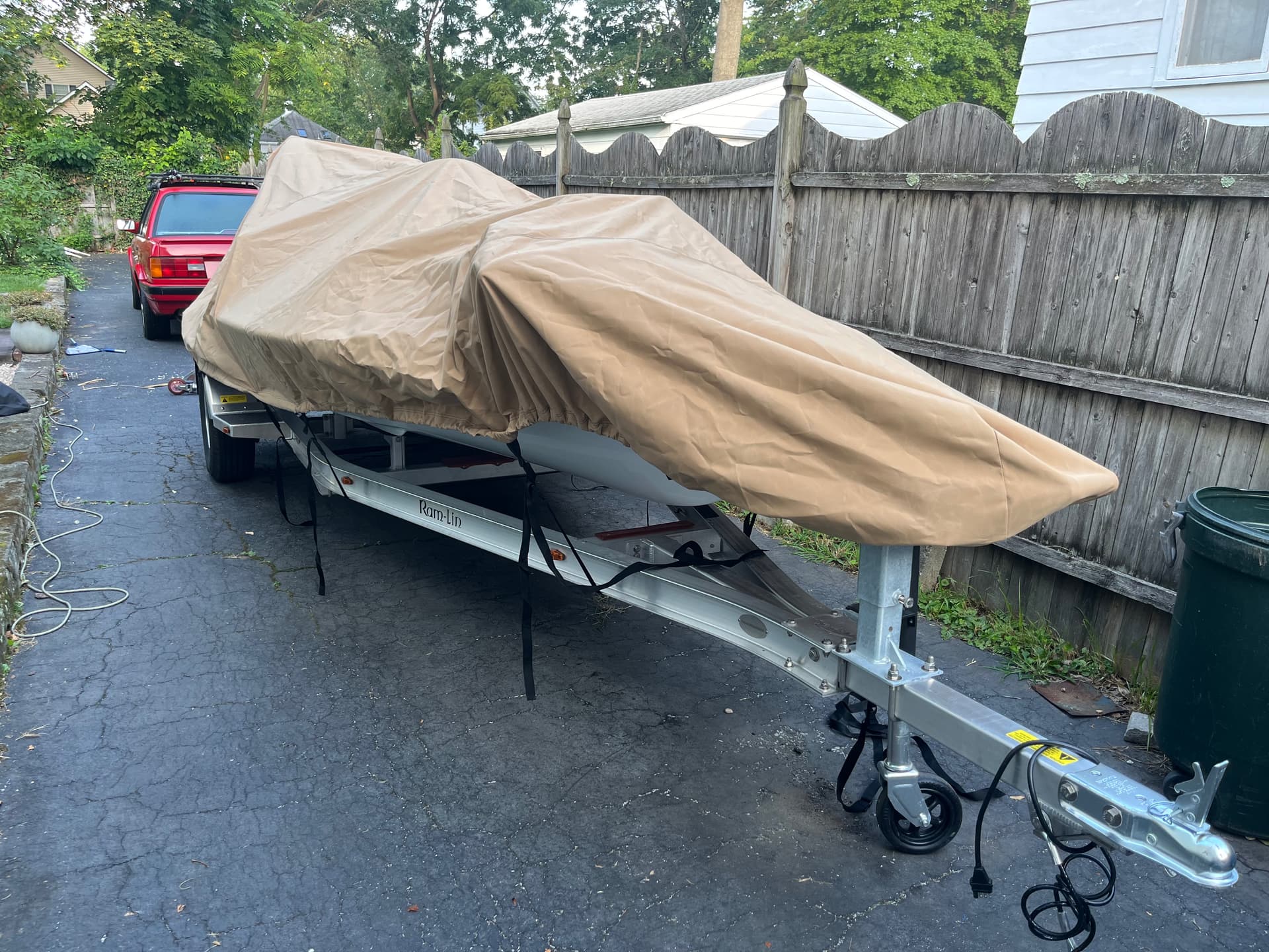

I bought a Carver Sunbrella Cover from Boat Covers Direct (PN 71316ENA). It fits ok. Lumpy looking but does the job. I have a support pole in the center and a cooler on the deck.

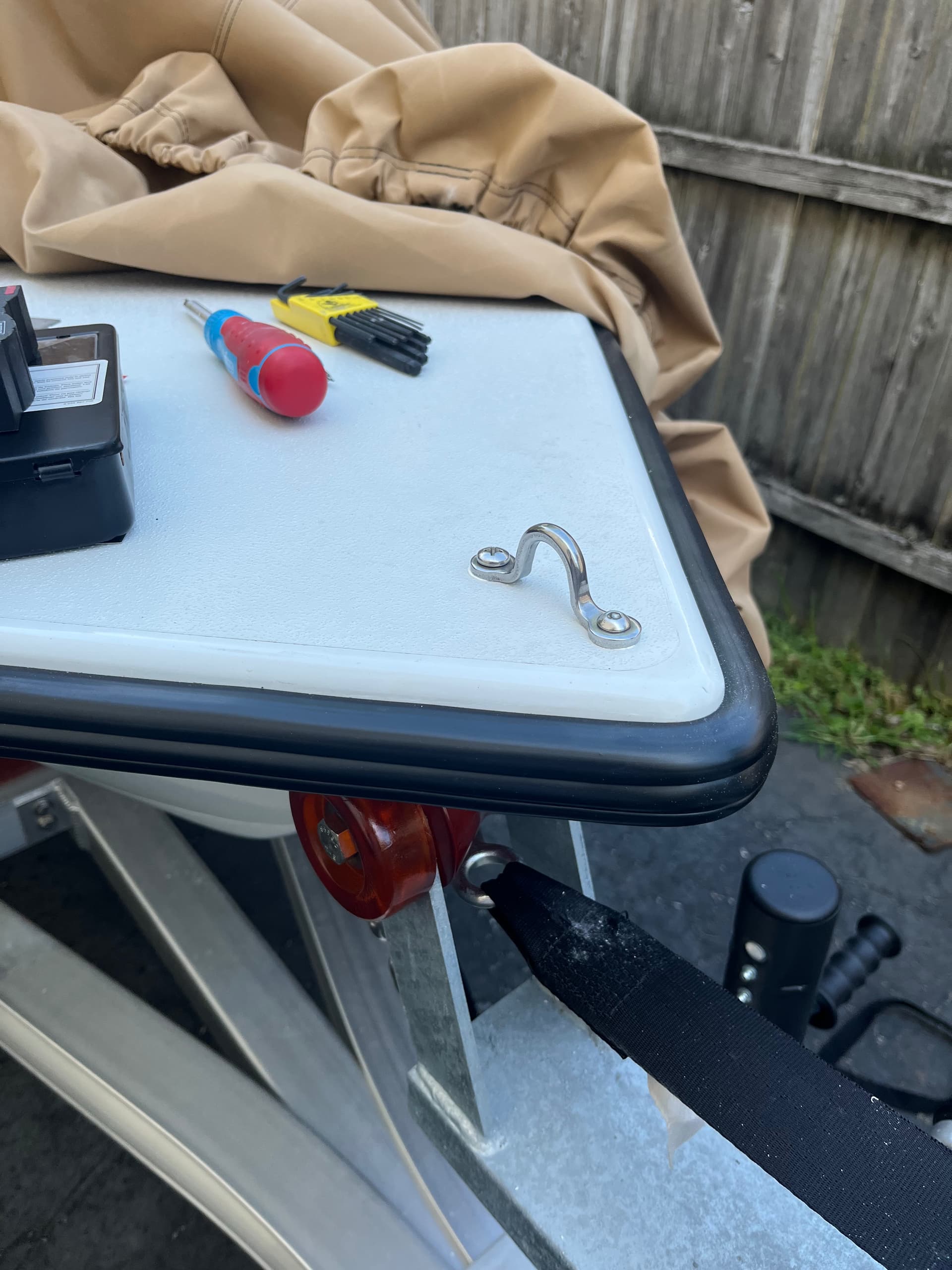

Last thing I added was a padeye at the bow. I put on my Towee after reading or hearing Flip Pallot mention preferring that over a cleat. Loved it on the Towee.

Sweet skiff. Congrats. Nice explanation as well and you did a really nice job on the console shelf.

I would have mounted that TM on the left, counter balance your side console.
I love the Nav mount you made, very classy!

@Zika thanks for the compliment on the side console shelf.
I built it during my skiff gap after selling the Towee.
I’m proud of how it turned out. Built mostly using woodworking tools and lots of guesswork. That one is the second try. I learned a few things on the first attempt.
