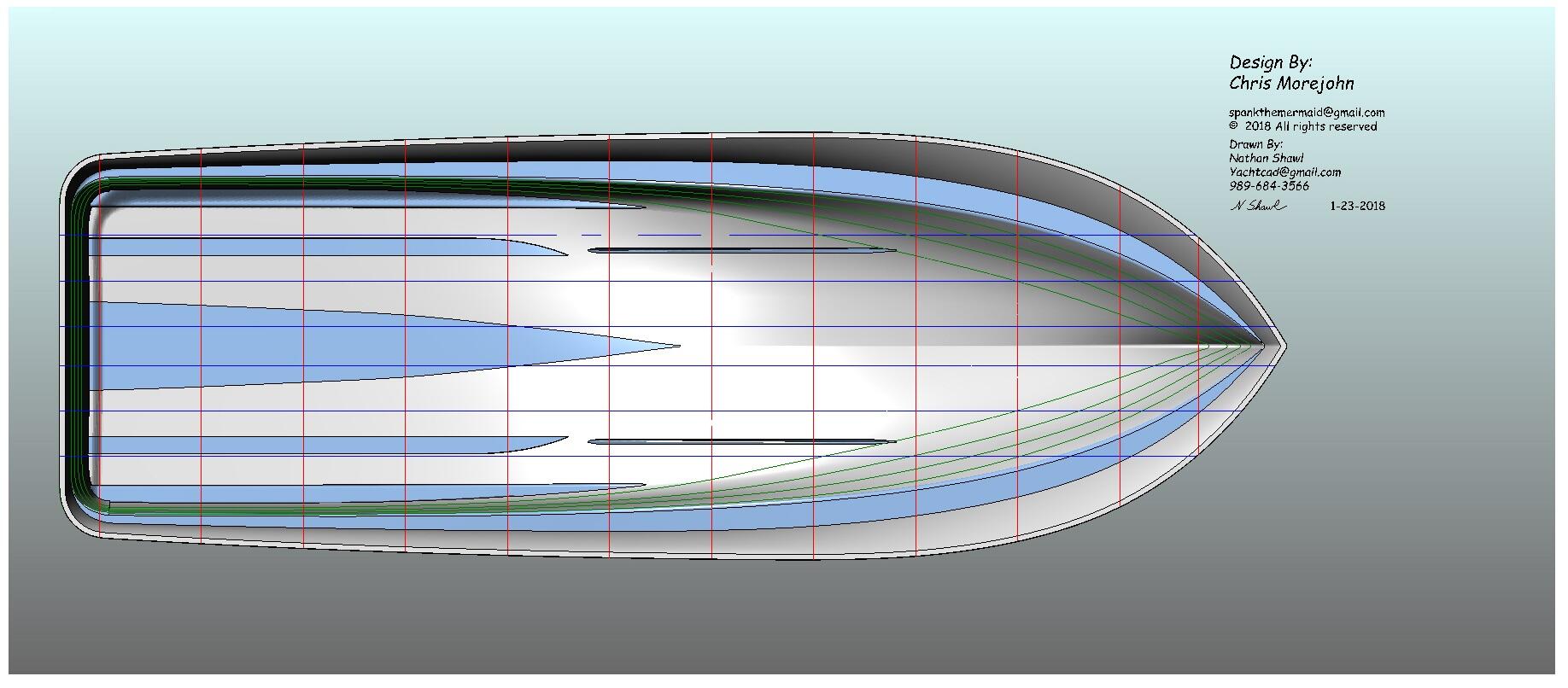

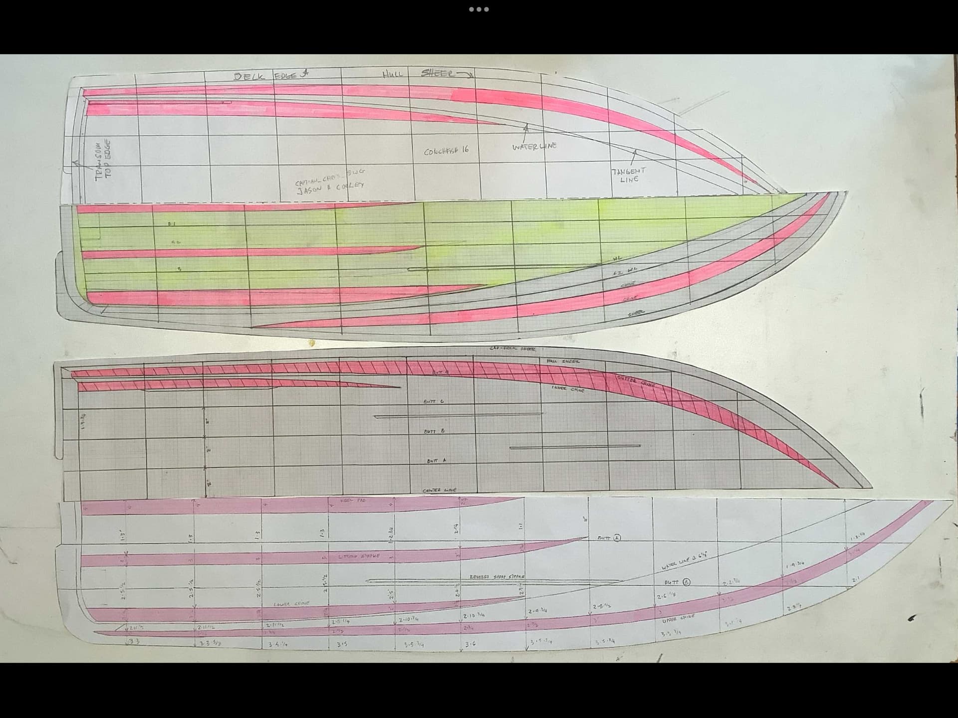

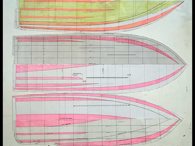

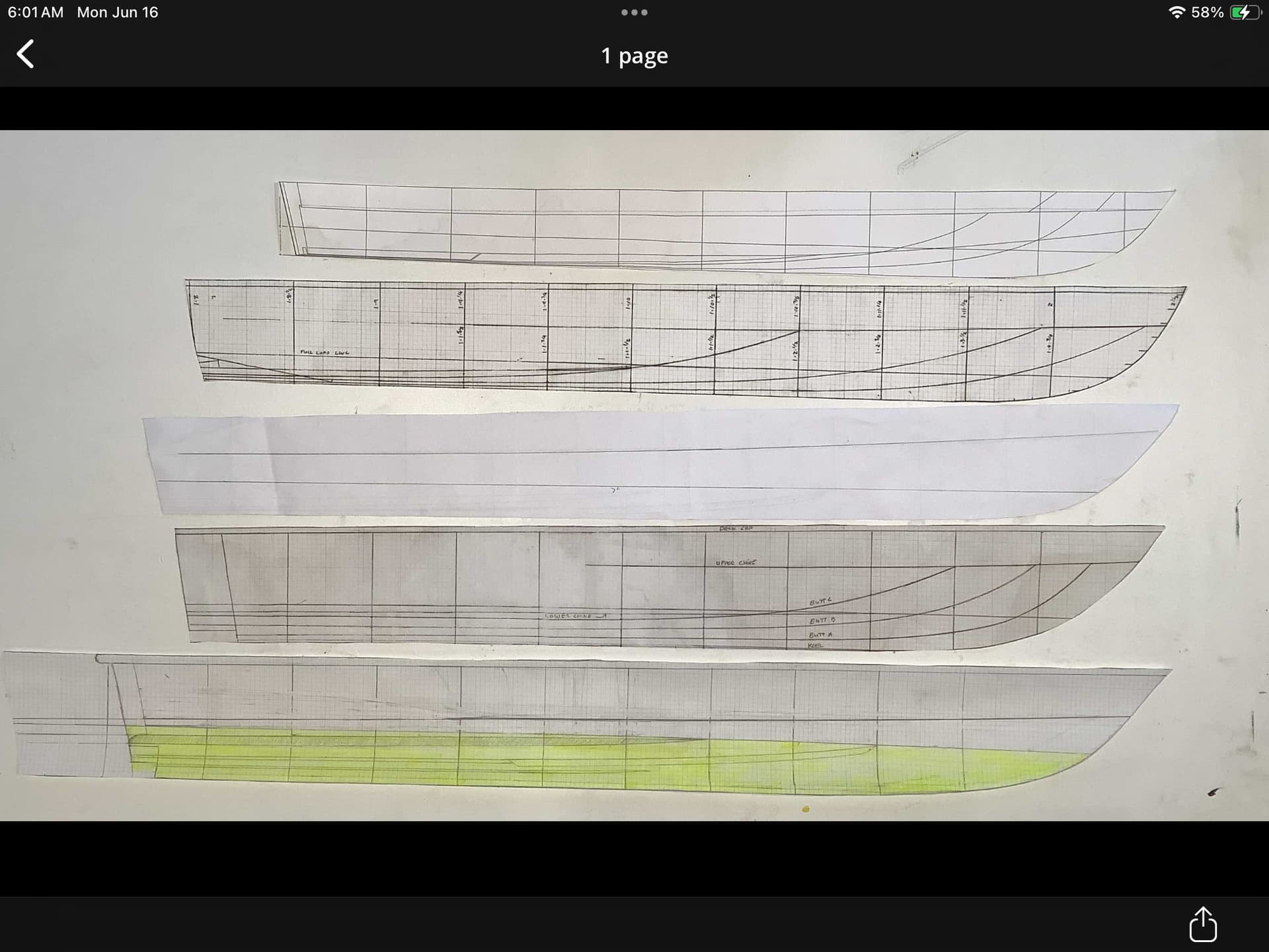

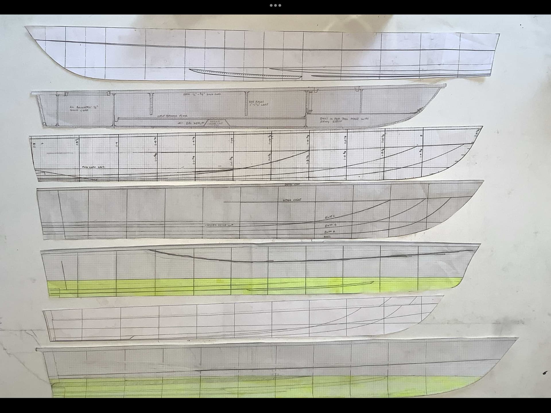

Here are a few of my past designs hull lines to look at for references as to subtle hull shapes in similar lengths. 98% of these hulls have been built over many units.
Conchfish16 on top, lithium 18, Beryllium 18.6, Matquesa 18, Iridium 19.6
Beryllium 18.6, CF 16, Litihum 18, Marquesa 18, South Dade Islandia 18, CF 17.6, Iridium
Piranha boatworks Magro 18, my updated HB Guide 18, Beryllium 18.6,
Boron 17.6, lithium 18 / Matacumbe 18
CF16, Islandia 17.6 first draft, old updated HB Guide, White Tip 21
![IMG_0465|666x500]
(upload://bgAZsTE5eiWOmnag92WiD8YvKtB.jpeg)
I realize this is a bit of a “it depends” question but which design – in your opinion – is the best hull?
Yea, I realize it’s very subjective, but if you took all the different characteristics most skiff owners claim they want, draft, poling, comfortable running, economy, speed, performance etc. which design has the best blend of all those characteristics? May not be the best in anyone 1 category but has the best overall blend that makes it stand out.
Cheers!
I was just thinking that same thing :thinking:
Not a fair question, these are all my kids…..Ha
I want everyone to look at my designs, their favorite companies hull design shape and look at all these skiffs at the hulls shape at Station #5 going forward. I feel between #5-7 this is where your skiff is going to get its best ride from going into chop. Most all my designs if you study this area have similar vee shape here, even the hulls that have a transition aft to 2-4 degree vee aft. So for most all round flats skiff running around at present after much subtle refinement my vote is the Beryllium 18.6 at this length. Then for speed in rough waters the Magro 18 or Islandia 18. I will post all my designs hull lines for everyone’s to use as reference along with all their statistics for displacement draft etc.

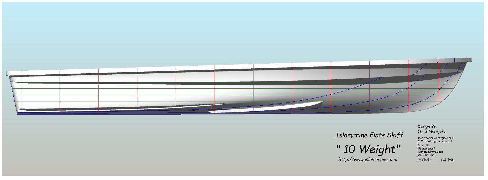

My personal favorite so far… the 18’ Floyd 10wt :grinning_face:

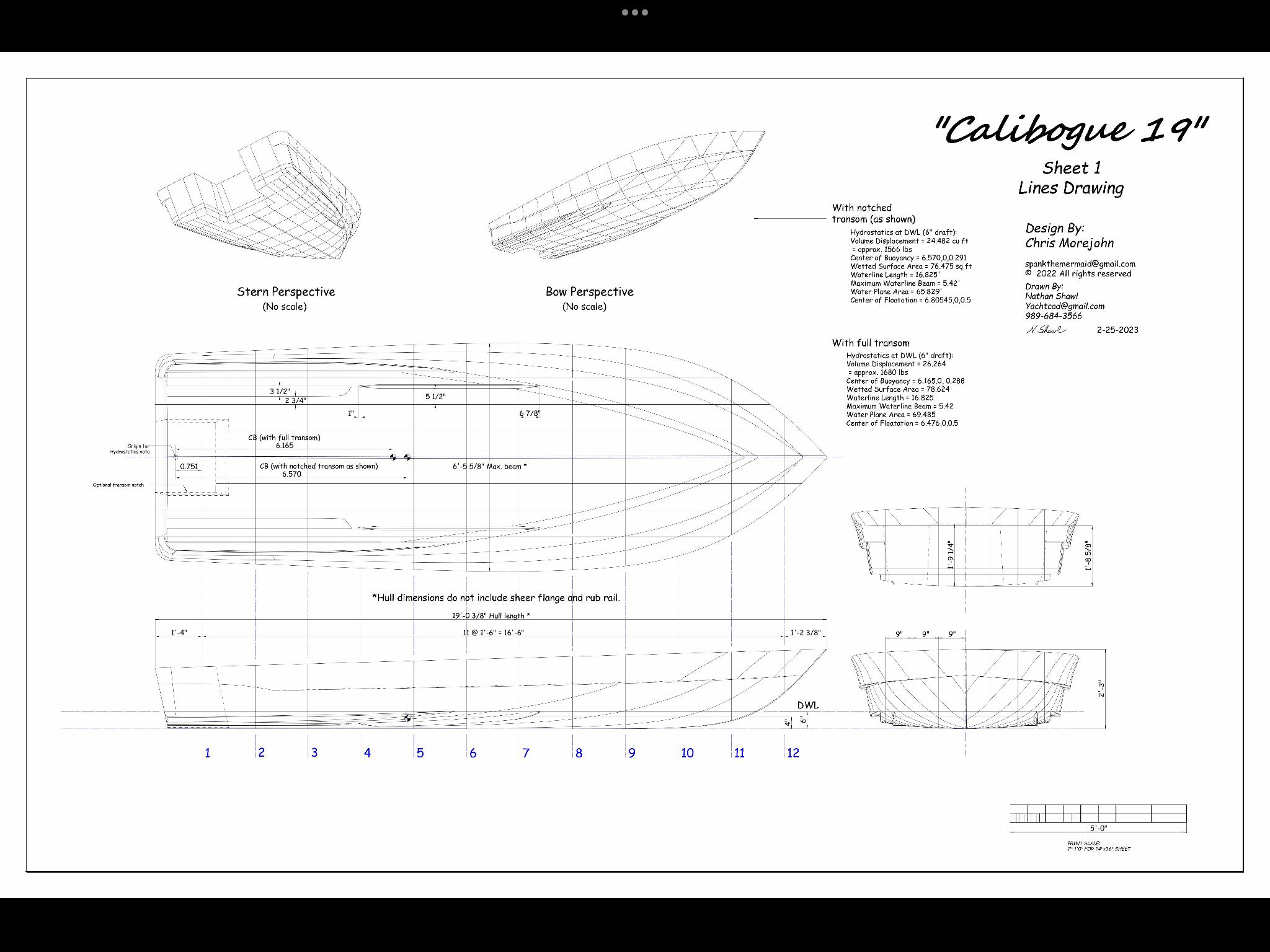

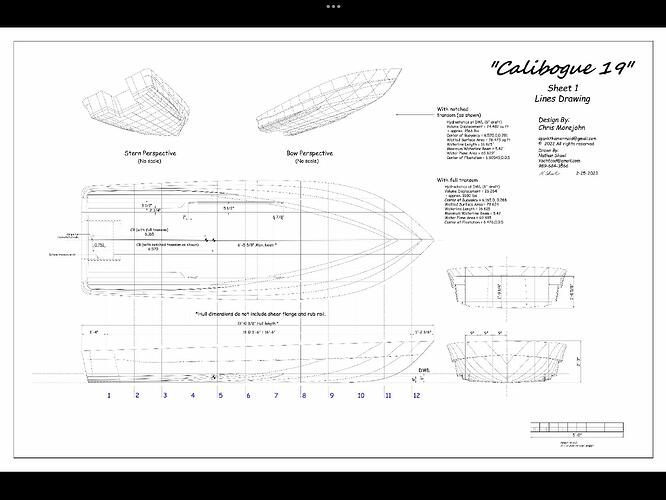

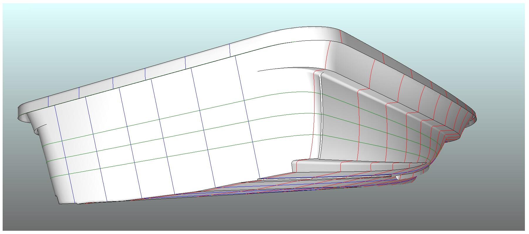

Can you please post the Calibogue Heritage 19 rendering?

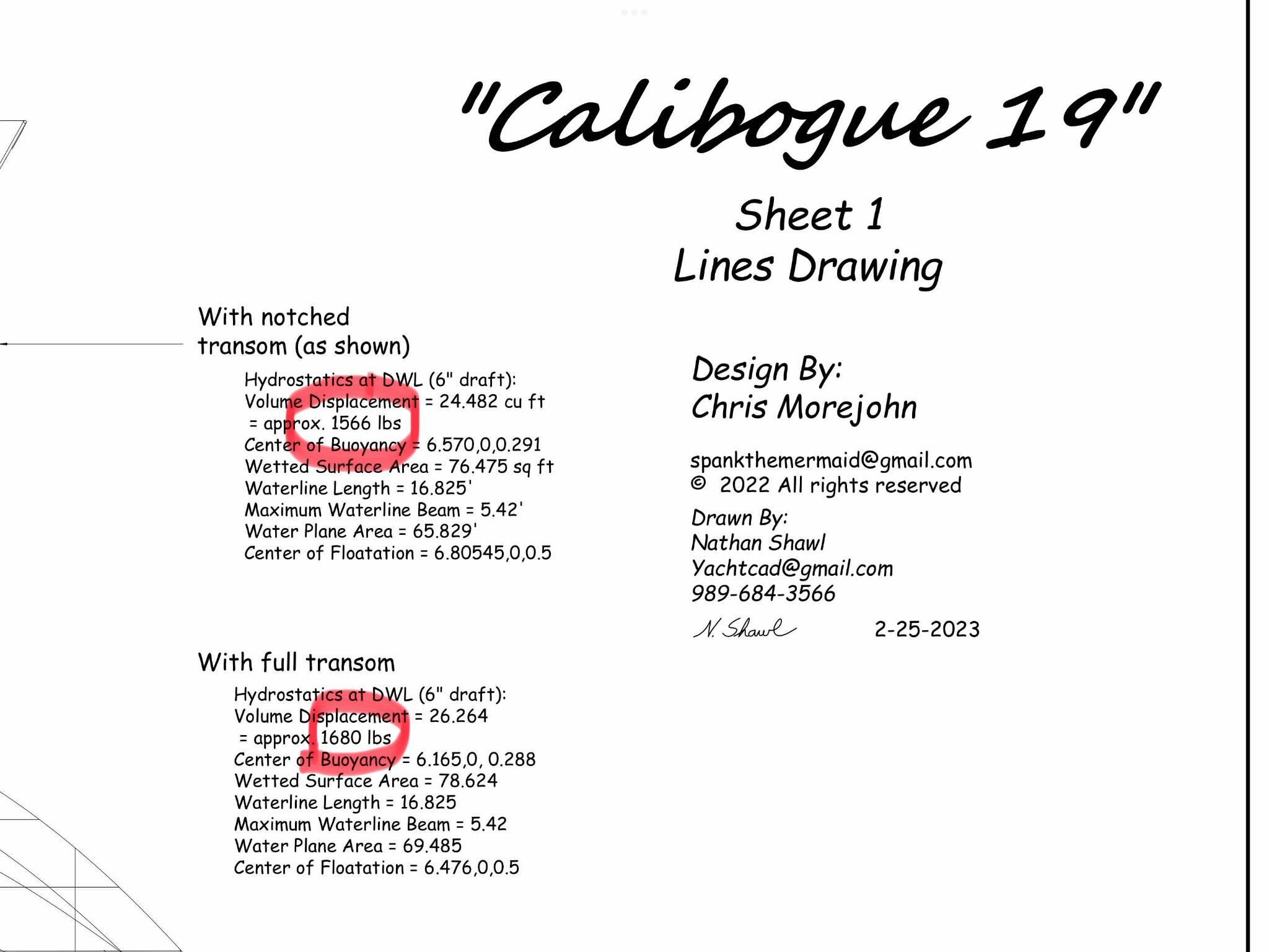

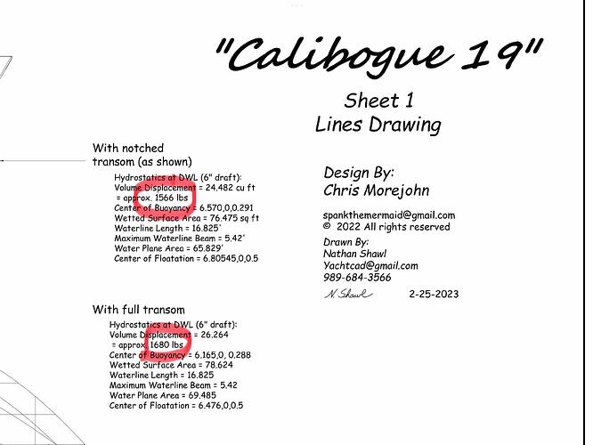

Here it is plus a bigger version. Look at the Displacement numbers and compare to other designs if you can get their displacement info.

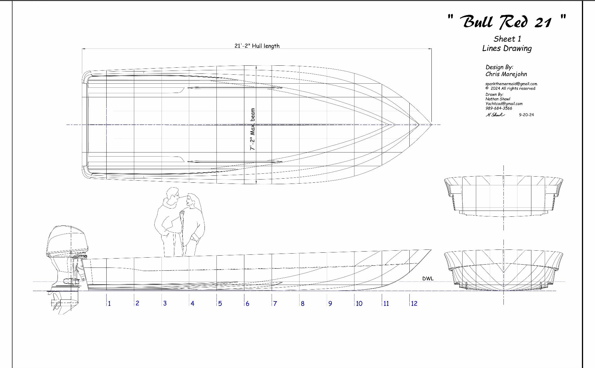

That Bull Red looks awesome, I bet it would make a great Tarpon boat!
Oh I have designe some nice skiffs that clients don’t want to be seen yet. Wish I could show off
