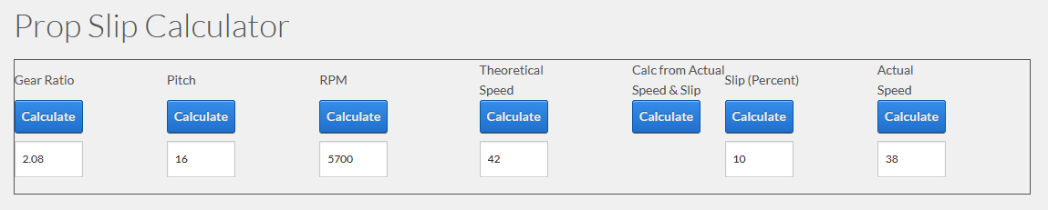

Prop slip of less than 8%
RPMs nearest to the factory recommended maximum at WOT (without going over the limit), with a light load, 1/2 tank of fuel, one person onboard.

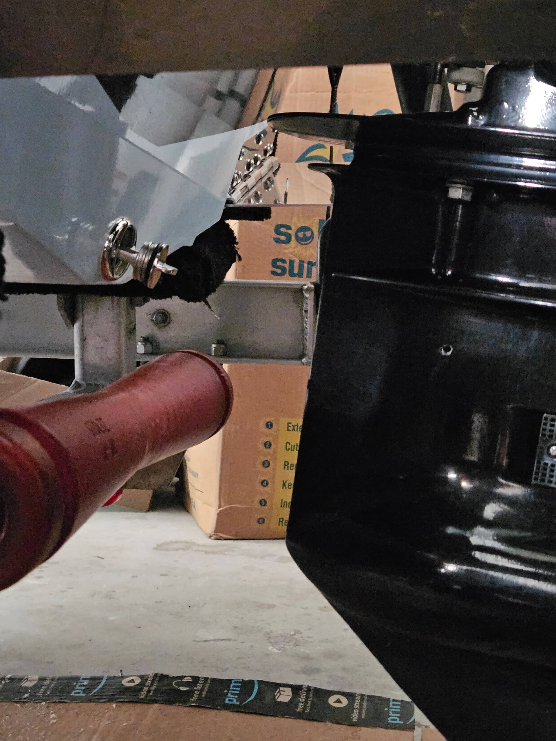

@Jason_M how high is your engine mounted? Grab a shot with it trimmed to running height to see where the nose cone is in relation to the bottom on the stern. Since you don’t have a jack plate, you can’t raise it to gain RPMs, which can increase speed. Raising the engine / prop reduced drag in the water, which increases RPMs. But the prop needs some cup to bite the water.
You may be fine with the prop you have, just with a little more engine height. But current height would need to be checked first. @Smackdaddy53 knows those boats and rigging better than anyone IMO.
This is with the engine all the way down and in the garage obviously.
If I was running on a flat day my approach is to get to WOT and trim the engine until she starts to porpoise a bit then trim down. But we’re talking about slight changes frankly, sometimes I’ll touch the tabs instead of the engine.
Yep, you’re right at 10% slip which is not bad. Your top speed is pretty good for a stock prop. I have an opinion on motor mount-height like @coconutgroves but I’ll defer to @Smackdaddy53 as well.
Thank you for the prop slip info! I actually confirmed the formula in ChatGPT and made adjustments on the numbers for realtime data results by changing RPM, speed and pitch. Very handy!
