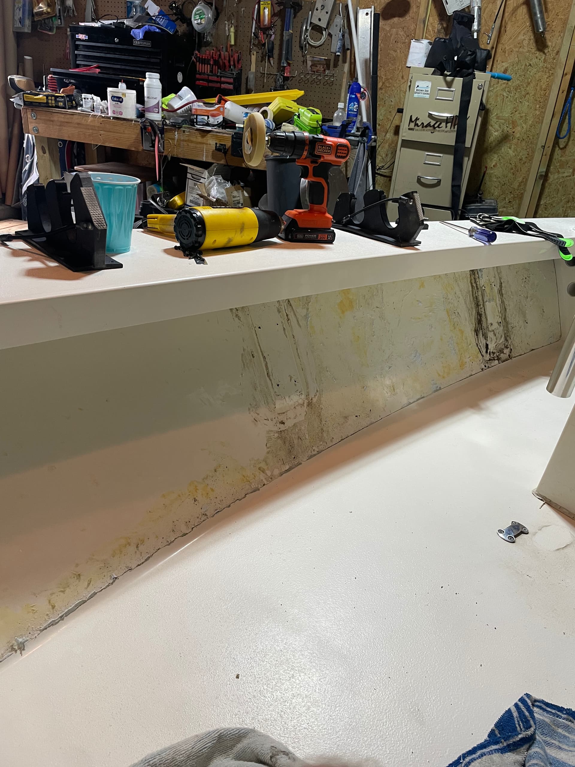

had a gap in schedule due to the weather and have been itching to rip my gunnels out.
I’m about 9hrs in and need to buff it out to be finished.
Removing the foam is the worst part.

Heat gun and bondo spreader to painstakingly remove the foam
Bulk of the adhesive taken off with mineral spirits in a spray bottle and the same spreader
Final removal with pressure washer
Makes a mess
Almost easier to buy new boat!

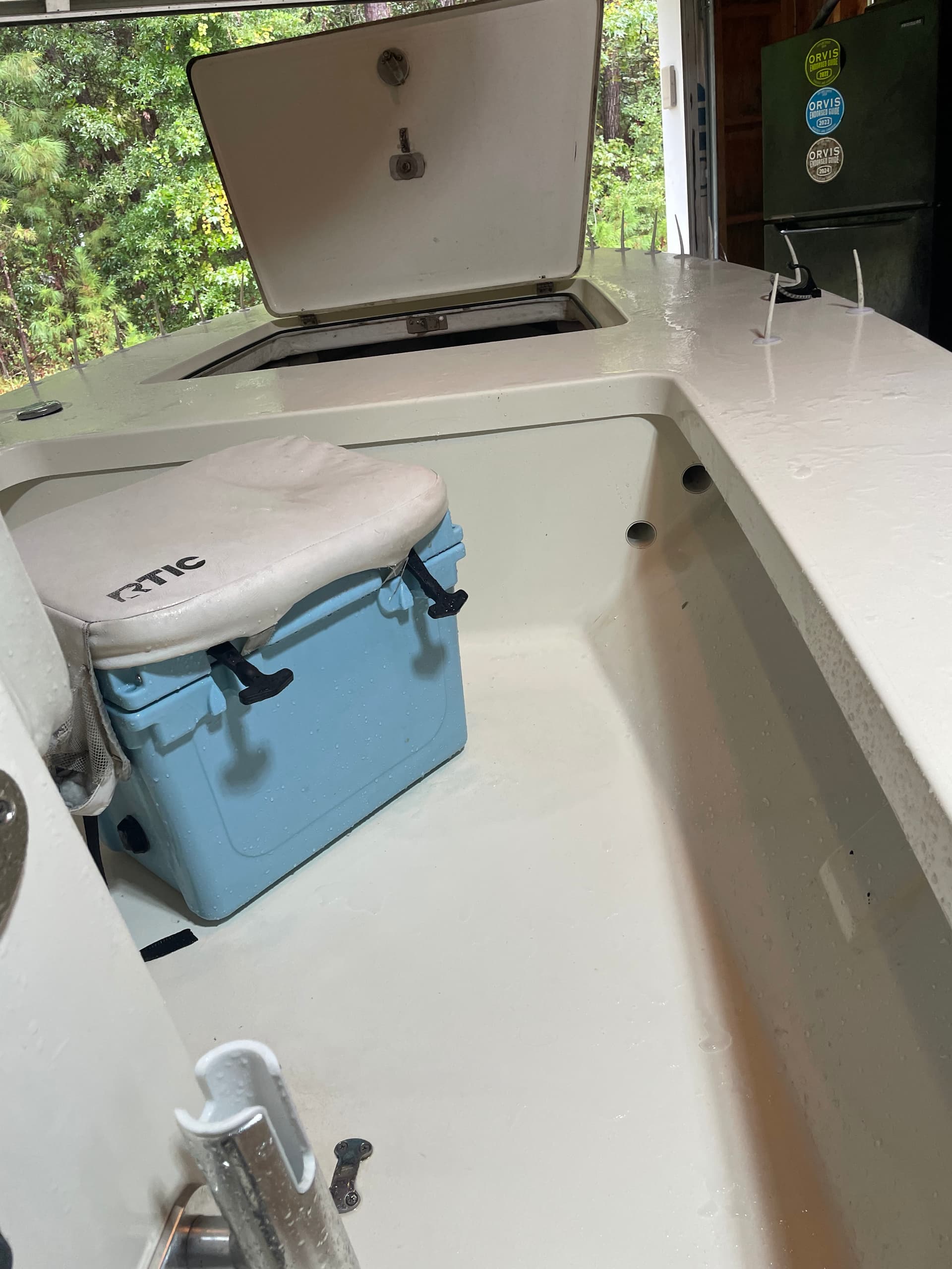

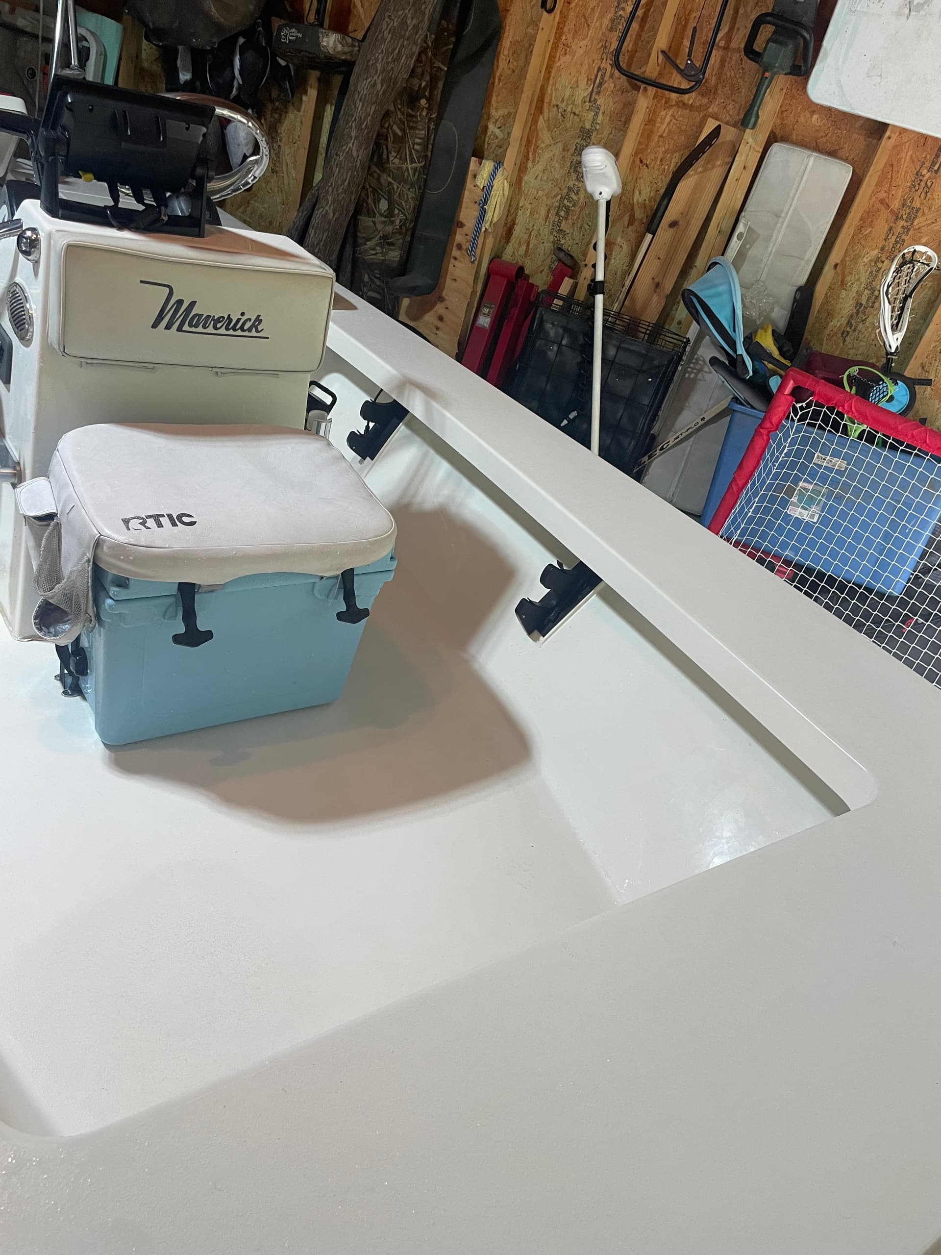

Sucky job but look good now.
done, will put on some small reel pad squares

Perfection is perfected! Looks great.
Looks nice!
