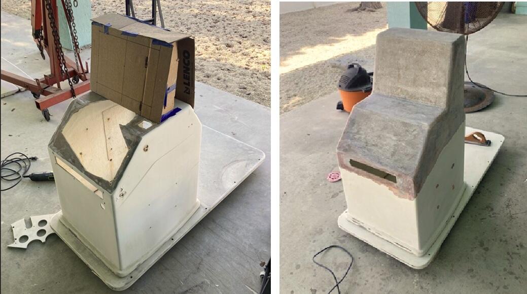

I’m not an expert, but I’ve been using 1 1/2 oz chopped strand mat and 1708 with polyester resin. The 1 1/2 oz CSM isn’t very thick or strong but give a good base, 1708 builds thickness and strength. Below are before and after of my console built with just those three items. It’s pretty strong.
