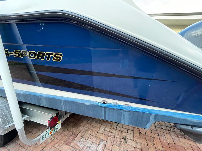

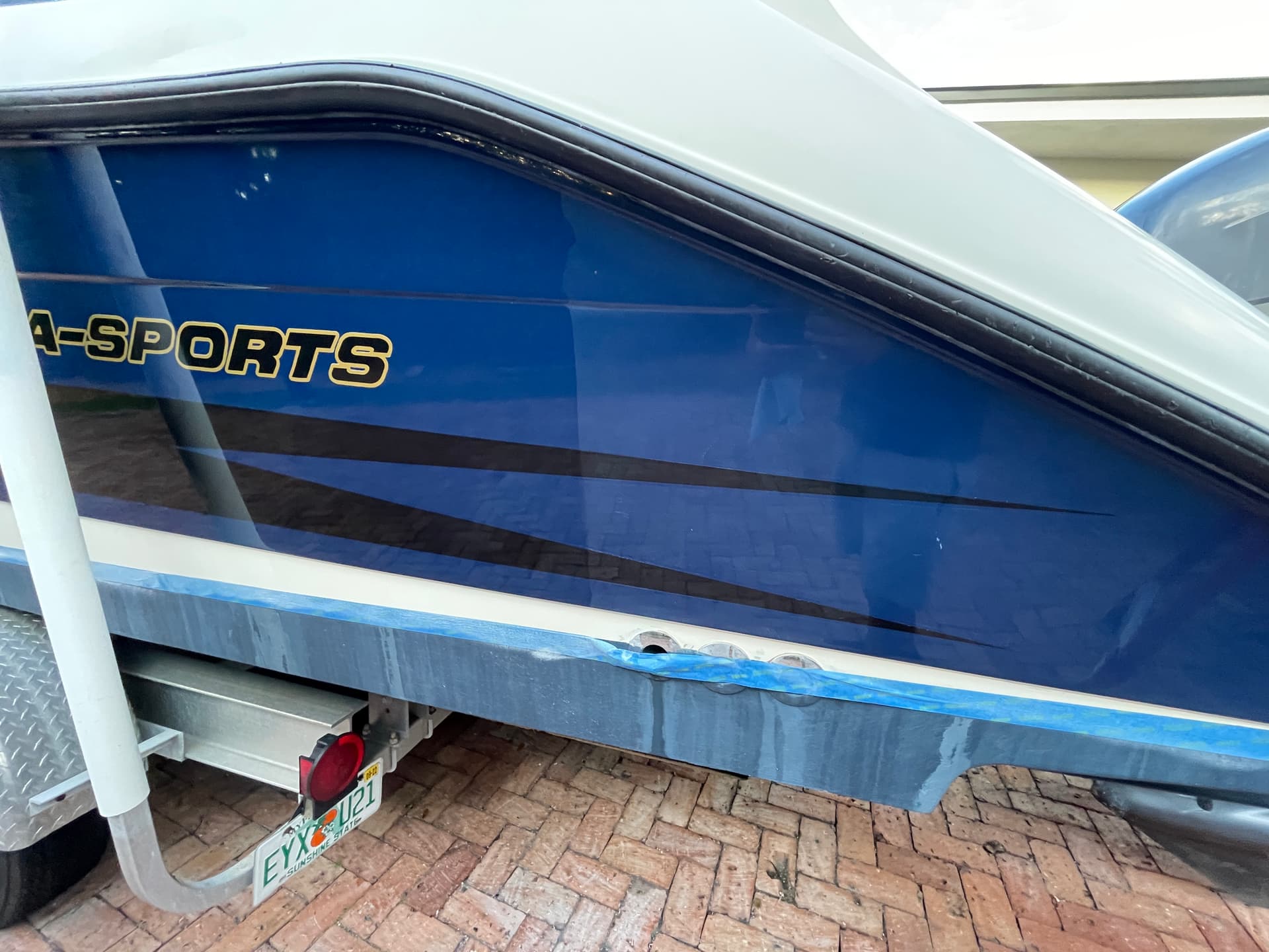

Here’s a picture of one I did several years ago with a quality China coating. The spot on the right has been preped with compound the spot on the left is simply ceramic coating on top after polish. This boat was very bad super faded old Hydro sport.
